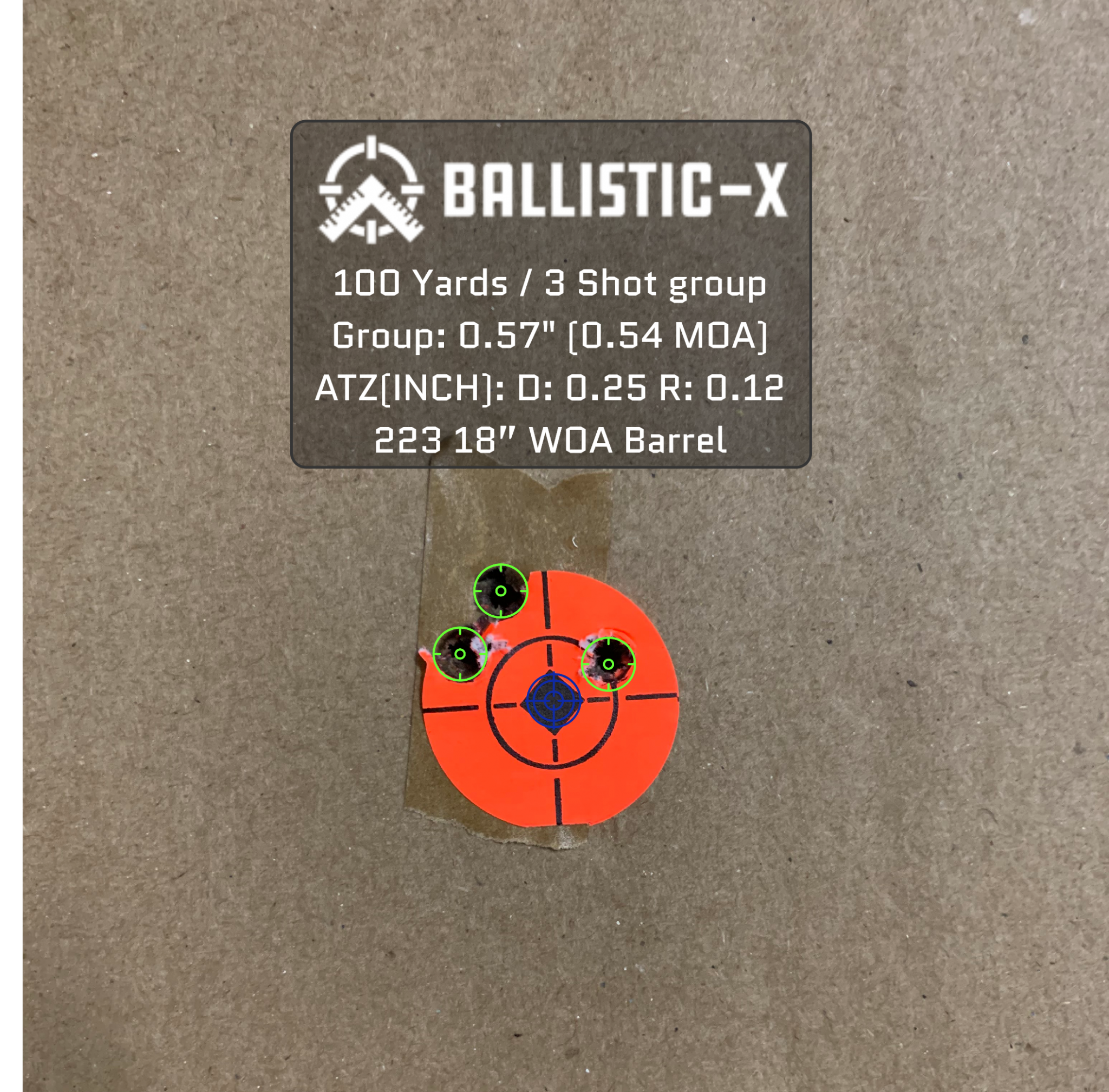

    So I was breaking in a new AR that I put together. I followed Hawk Hill's procedure for break in, then went on to zero the scope, so I had about 30 rounds on the barrel when I put the Magnetospeed on. It was only a 3 shot group, but it measured .57, so I thought I would get some pretty good numbers on the chrono.
    I was using Gorilla ammo, 77gr SMK, advertised velocity of 2750. I shot 2 5-shot strings. The first had an average MV of 2604, ES 96, SD 39. The second string averaged 2591, ES 67 SD 24.
    It was raining steadily, but I was under cover and the rifle and ammo were not wet at all. I know with this being a new barrel, it will break in and get faster, so I'm not really concerned about the MV, but those ES's and SD's are horrible-not what I expected from match ammo. I was planning on developing a load for this, but I assumed this would be a good starting point. At this point, I'm not so sure. Thoughts?
    Here’s that 3 shot group

    My thoughts are that two groups with one load is a pretty small data set. I think that trying to read anything meaningful into that data set is highly premature.

    In short No. Humidity isn't going to have a perceivable effect on your ammo performance. The ES/SDs you're seeing is likely a factor of unidentified variables of internal balliectis. Straight out of the gate the two biggest errors I see is (A.) Trying to chronograph a gun with only 30 round down the pipe and (B.) a painful lack of data points to draw from.
    Regarding chronoing new guns - I'd say wait till about 150rnds and then double back. I do like to get an early chrono reading just to see a rough idea of where a gun is at but often you'll see the MV and SDs take some time to settle in and solidify. Secondly on this point most factory ammo have MVs that are overstated often their testing MVs with 24-26" barrels or sometimes just straight up fudging numbers. If you're at 2600ish with an 18" I'd say yeah its a little low but its still in the ball park.
    Lastly regarding your lack significant data points - I can tell you are either a cheap frugal fellow or just down right inexperienced. I know reading that probably makes you mad and the temptation is to dismiss it BUT here you are contemplating the effects of weather on your MV/SDs after only firing (2) 5 round stings. Additionally you posted a single 3 round group even after hinting you probably knew better. Your results are inconclusive because you've failed to take the appropriate efforts in gathering data.
    Bottom line. Break your barrel in (at least 150ish rounds) then shoot a 20 round string (I'd recommend some FGMM) and conduct a 5x5 for an accuracy evaluation.

    All kidding aside, I know that my 30 round data doesn't mean much and the barrel needs a lot more to be broken in. That wasn't my point and I should have been more clear.
    I've chrono'd new barrels before, with factory and handloads and have not seen the large swings that I saw yesterday. I also know it doesn't mean much, as I need a lot more data to wring this thing out.
    I also know that 3 round groups don't mean anything, and I normally shoot 5 shot groups when working up loads, but I was limited in time as I was losing daylight. Thanks for all your replies
