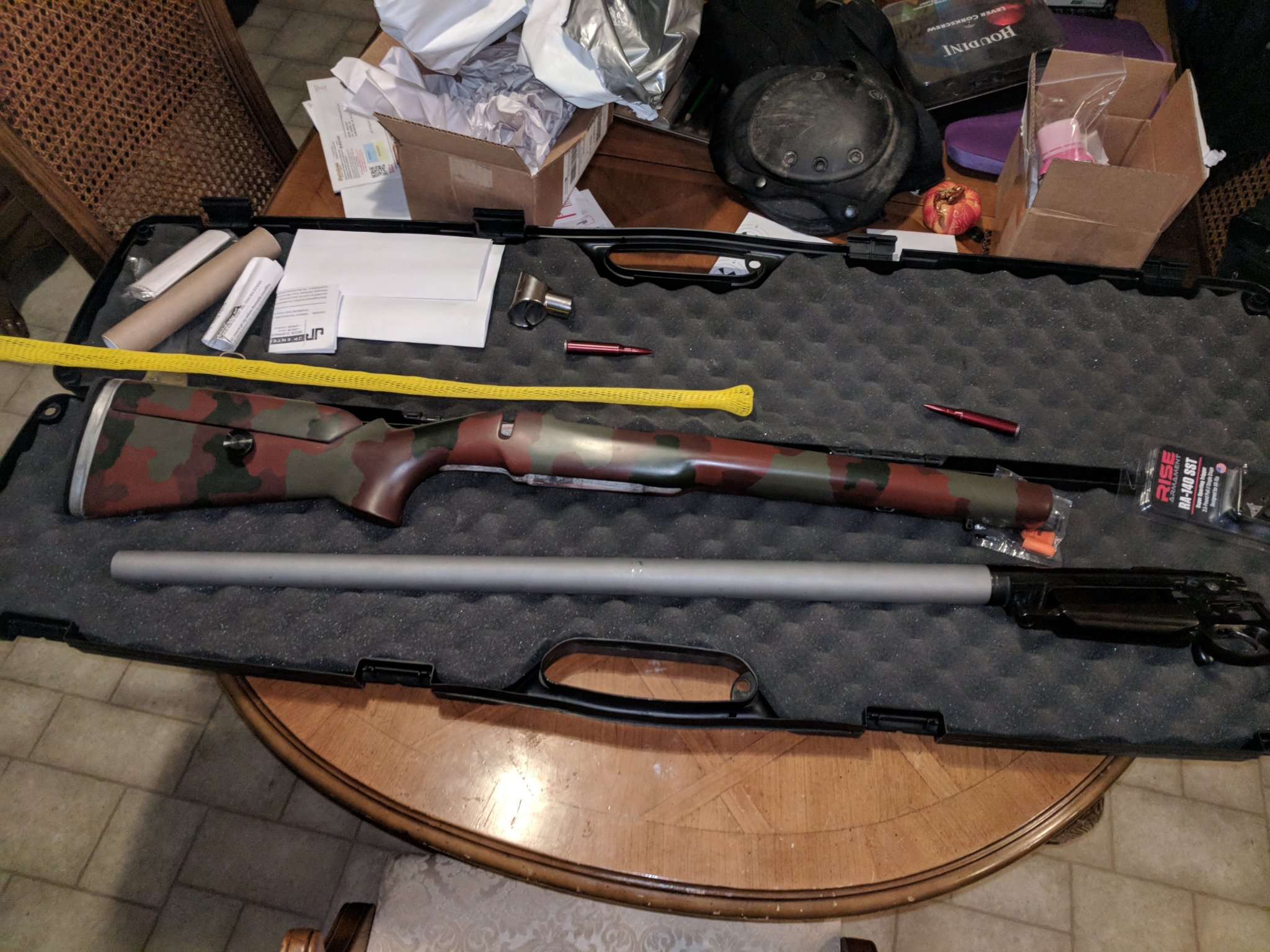

Well I went ahead and took a chance on it . It has never been fired so I am not sure how its going to shoot .
I am waiting on special rings to come in for the stupid 19mm rails that CZ uses . It came with a nice rail but it needs to be drilled and tapped and all the gunsmith in my area are busy and are telling me 4-6 weeks to drill and tap 4 little holes . IMG_20180328_204832 (1).jpg

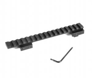

EGW lists this for a 19mm dovetailed 550 Magnum action:
http://www.egwguns.com/scope-mounts-rings/hd-cz-550-602-magnum-action-picatinny-scope-mount-20-moa/
CZ has their own rail: http://shop.cz-usa.com/ProductDetail/19018_Adapter-Rail-Cz-550-Magnum-19mm-Dovetail-20-Moa. But it's listed as weaver not picatinny.
Both EGW and the CZ webstore have fast shipping.
Put a 20 moa mount on top (40 moa total) and you should have enough elevation to get way out there.
And DAMN, you ain't got nuthin' for a recoil pad either. You and your orthopedic surgeon are going to have a lengthy relationship.
