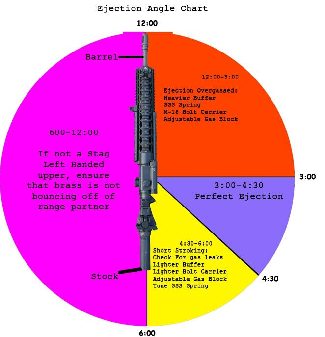

Can you describe the type of jam? What is the ejection pattern of your brass (when it cycles & ejects)?
