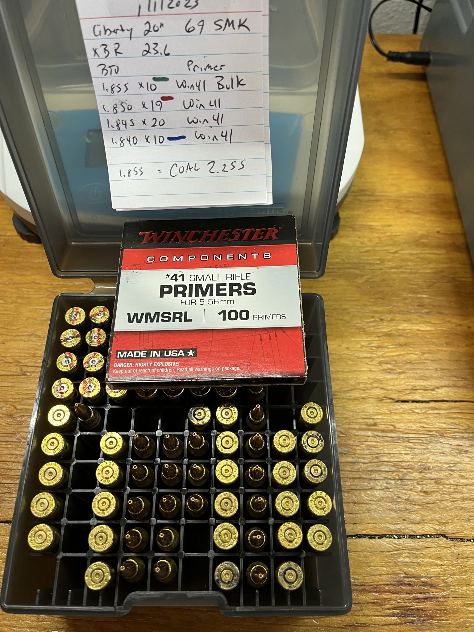

    my take on Win 41's
    my bad, but no. If you look close, you will see the 5 with holes blown in them.
    Ok I get it lol.
    I just played captcha and saw the 5 with holes...
    I don't have any experience with that, what's that a sign of? That's never happened to me, I've never seen primers do that and I've shot a lot of fucking guns over the years hahaha.
    I'm guessing pressure?

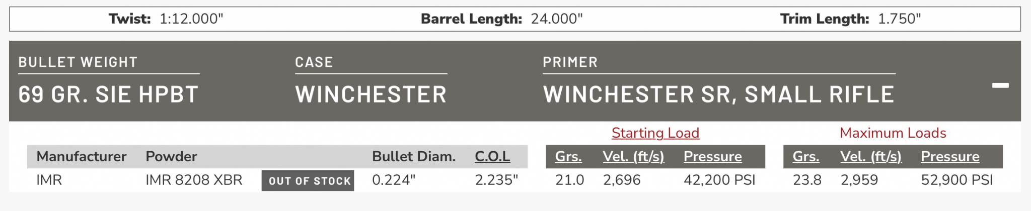

    Well, guess I'll find out lol.
    I never push pressure in any of my rigs, so maybe I'll have better luck (maybe not). I'm also looking at these for bolt-gun stuff which might yield better results (I honestly don't really know dick about loading for an AR because I've never done it).
    That said, looks like that 23.6gn XBR load is still just below Hodgdon's max (23.8gn)... in a 24", 1 in 12, which nobody shoots of course haha.
    Thats a 223 load based on listed pressure.....you have a ways to go before you see pressure issues......assuming you're using 556 brass not 223 in a 556/wylde chamber ar

    The dreaded pin hole primer failure. This was a problem with certain lots of WLR primers starting late 2000s. There is a recall on problem lots. I emailed Winchester my lot numbers, photos of damaged bolt faces, and they sent me 5000 new 2023 production WLR primers and $300 to replace two ARC Nucleus bolt faces.
    I was just researching these #41 Win primers and saw this photo of yours. Damnit!
    Lol, I sent them all the info and blown brass, leftover priced brass, and loaded rounds. They sent me a hat :).
