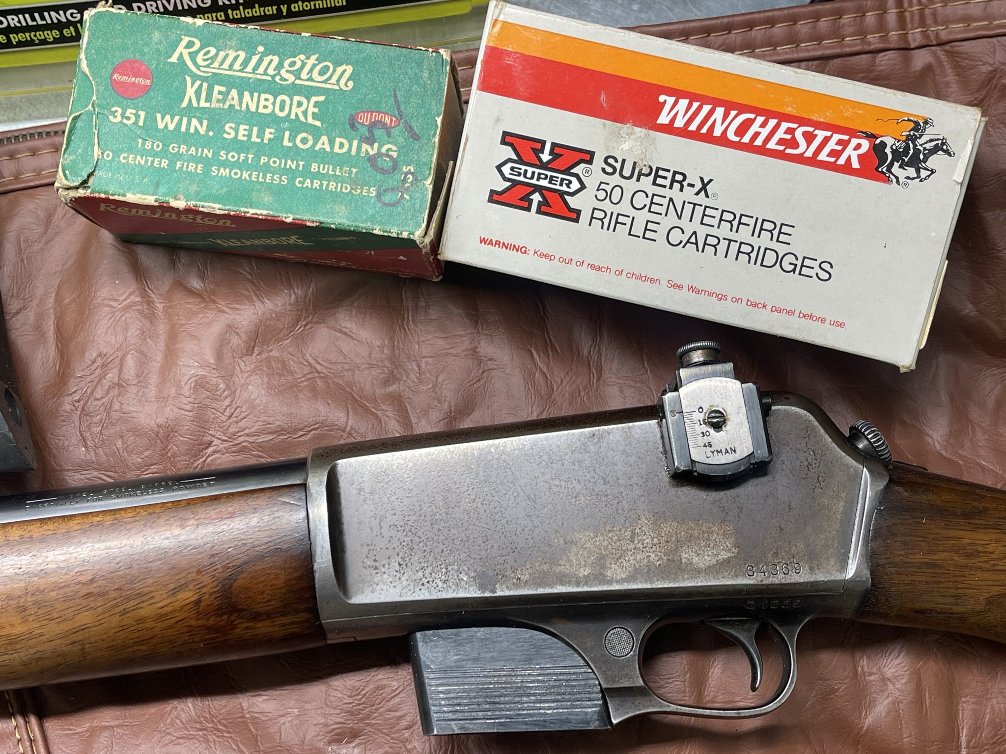

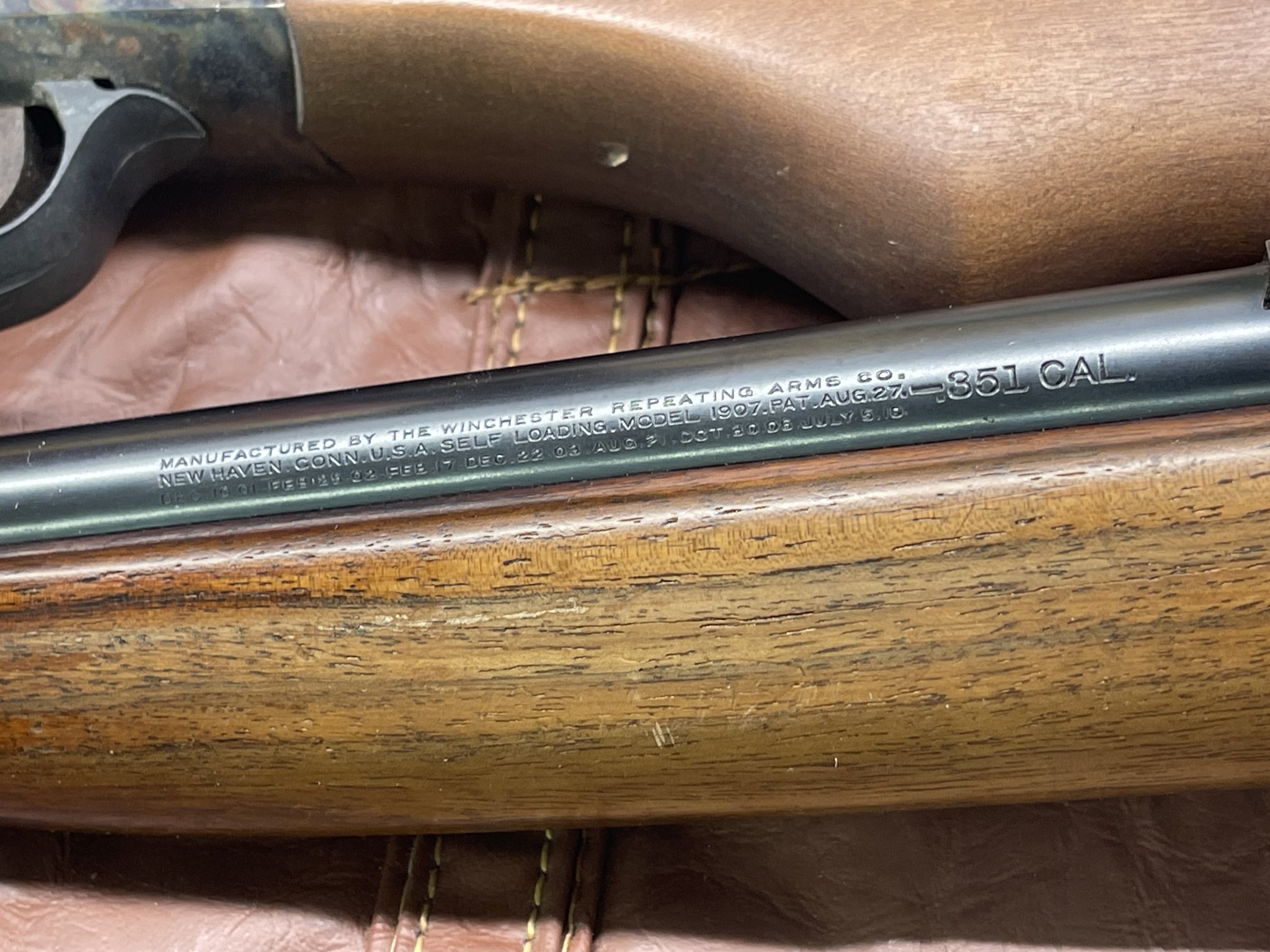

Posted this elsewhere but haven’t got many replies.

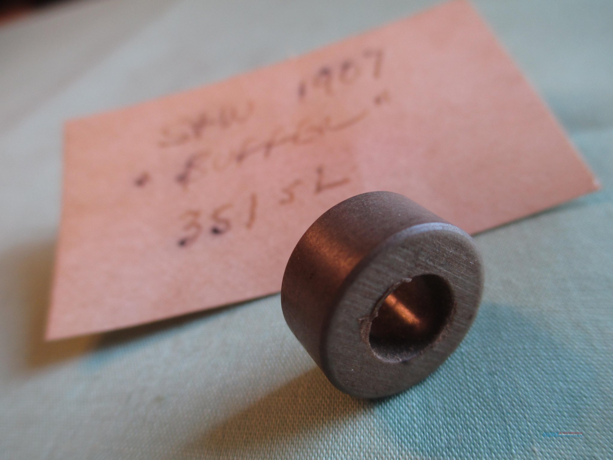

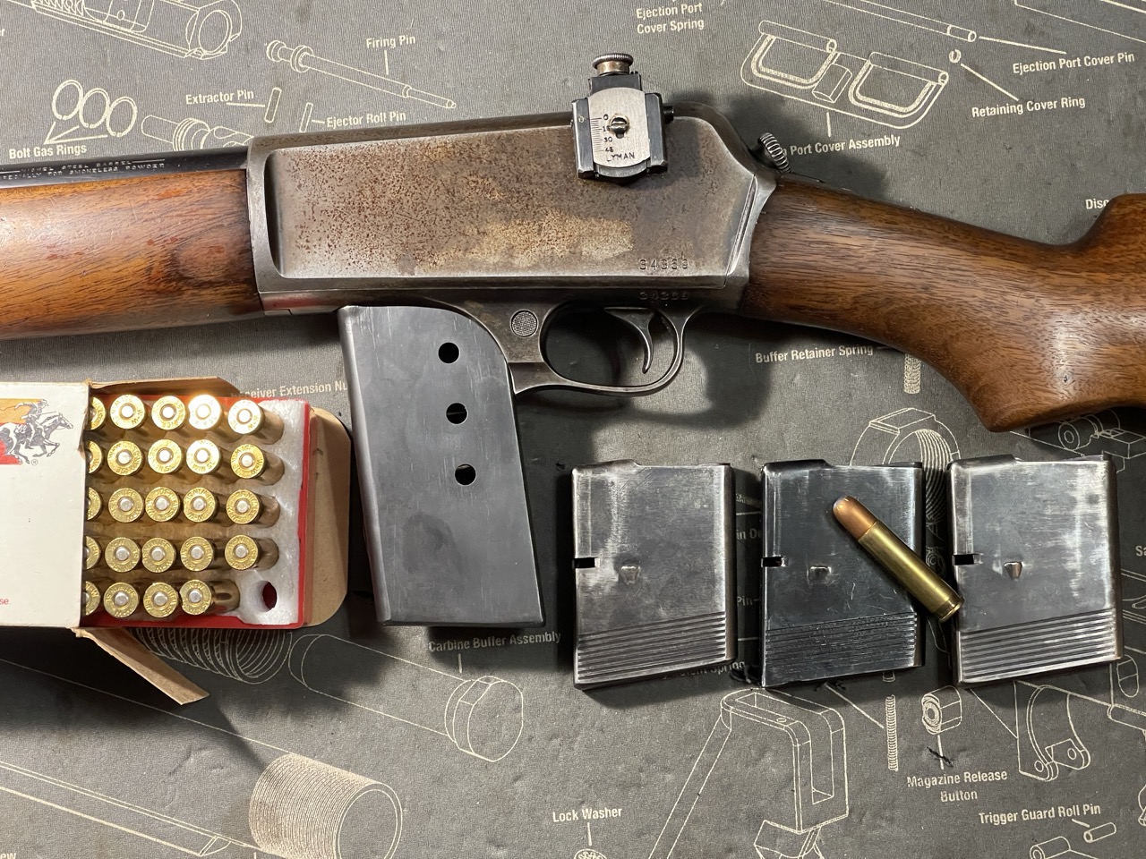

I acquired an old Winchester semi auto in .351. I shot it a year or so ago and it functioned fine. Plan to take it apart and clean it up.

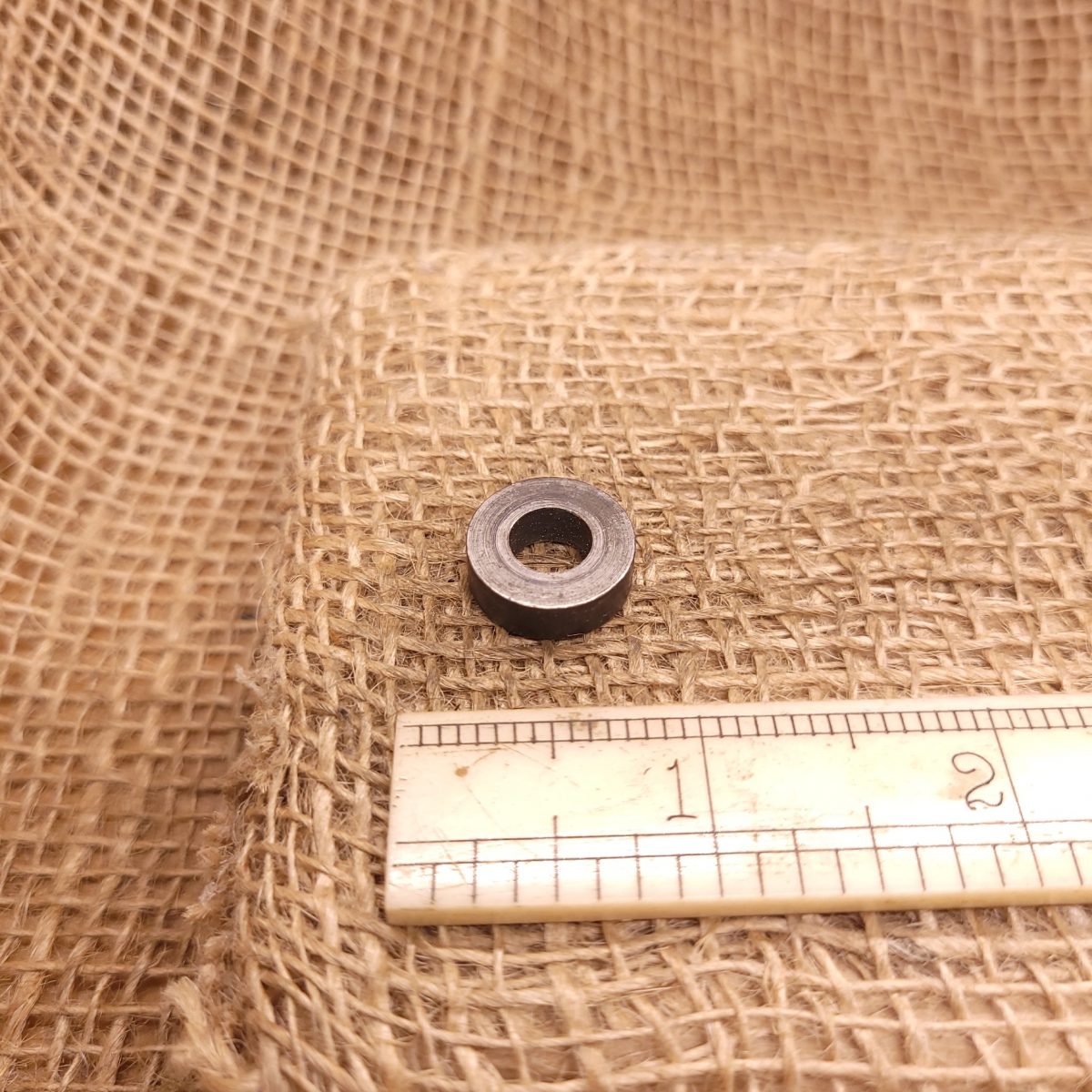

Been reading up on it and most say to replace the buffer which is no longer available. Can maybe make one out of something. Suggestions?
LINK to parts. Buffer is #5.

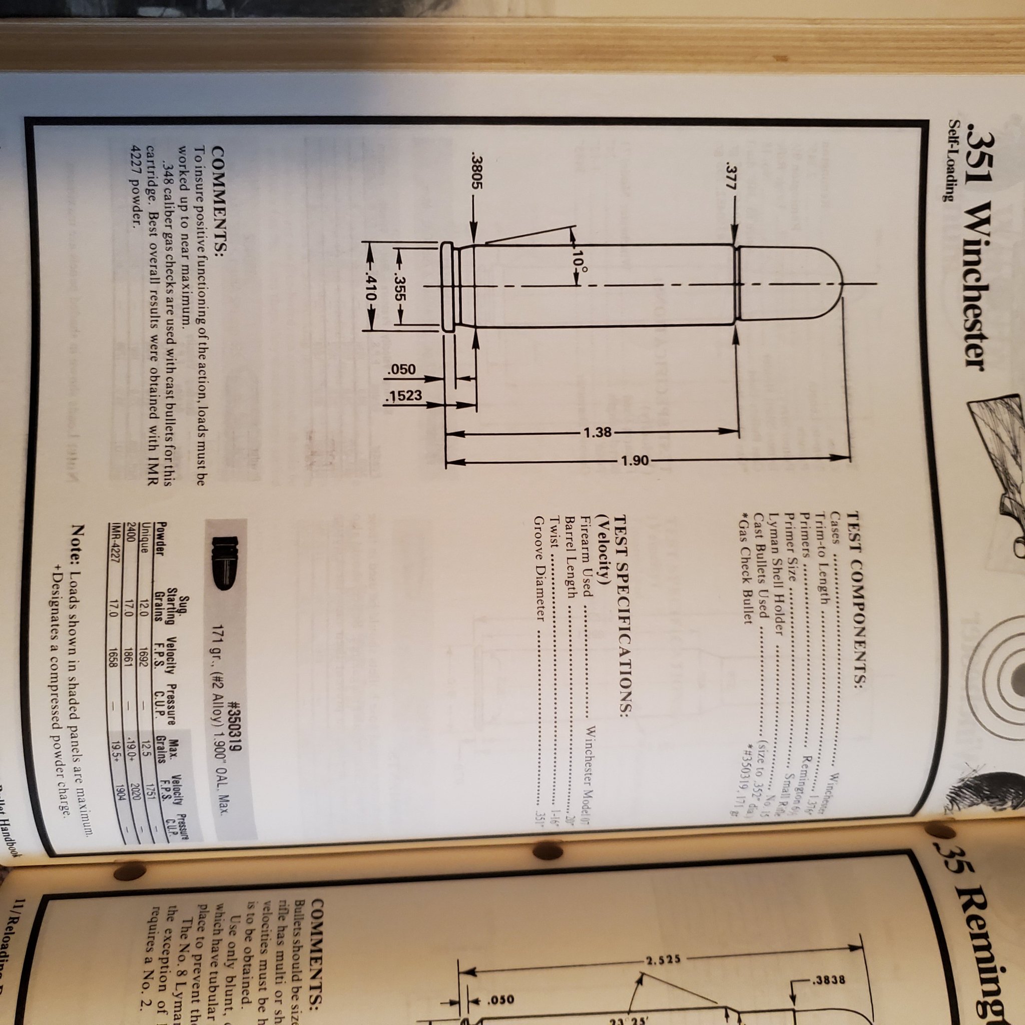

Would like to find some bullets and dies to try and reload. Some folks have used 556 cases which see like the least amount of labor to get to fit. It came with some ammo, little bit of brass, and a few mags.
Anyone have any experience with one? Tips for finding parts or reloading components?

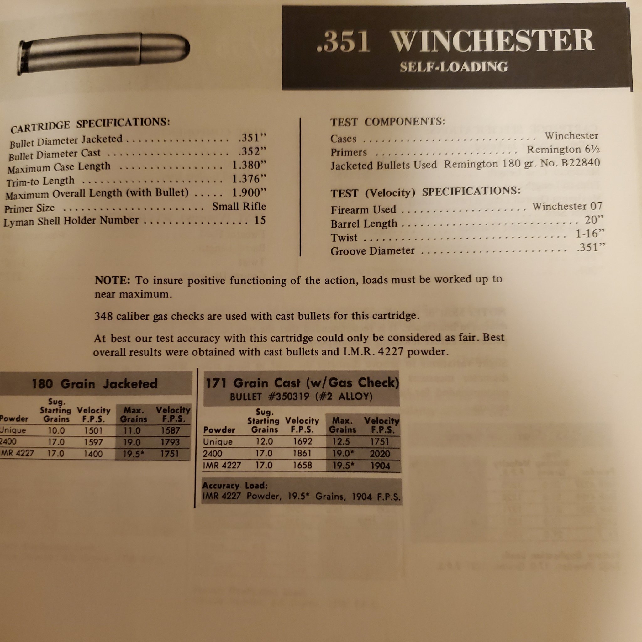

I'd shoot it, alot...here is some loading data.

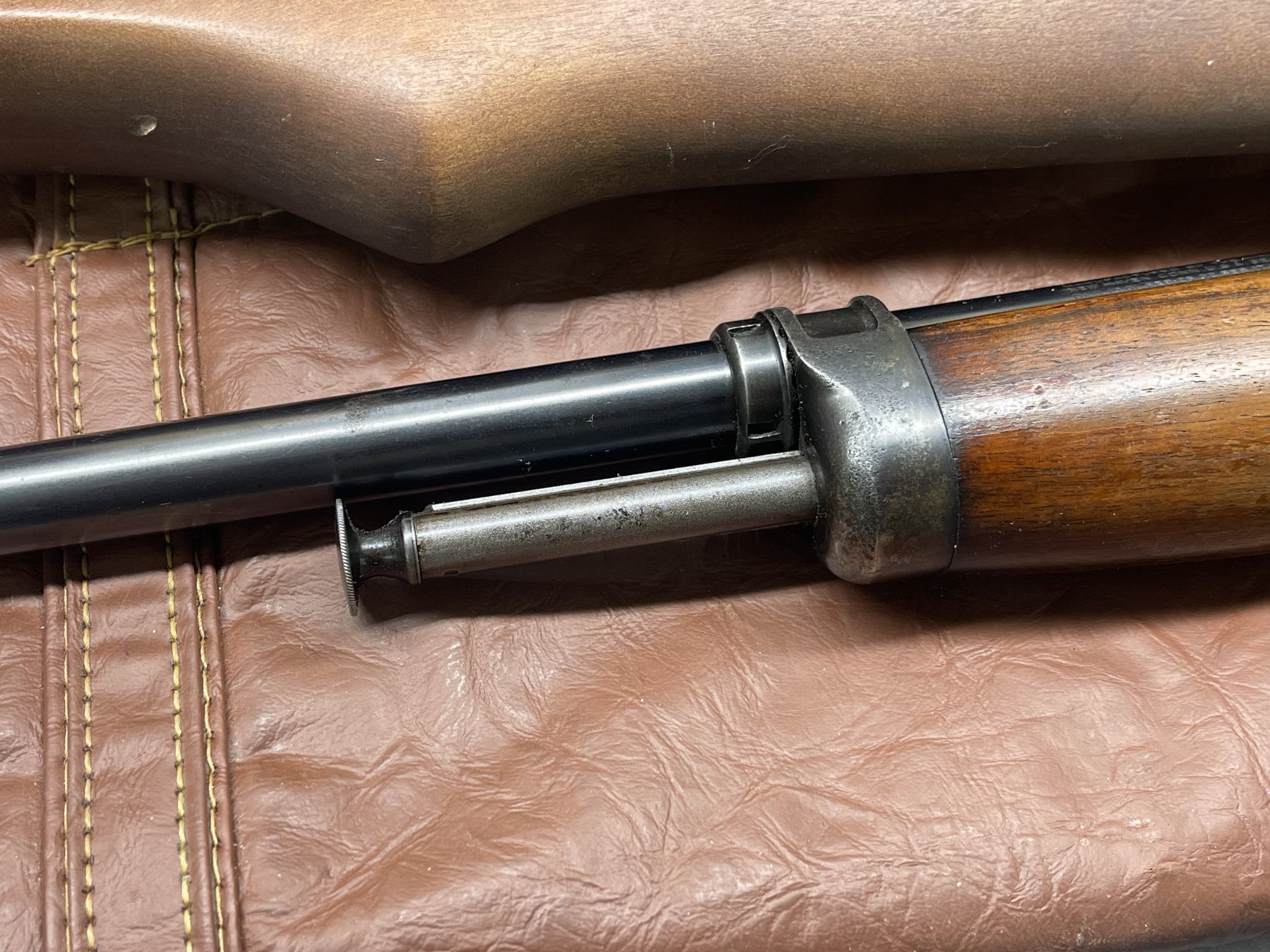

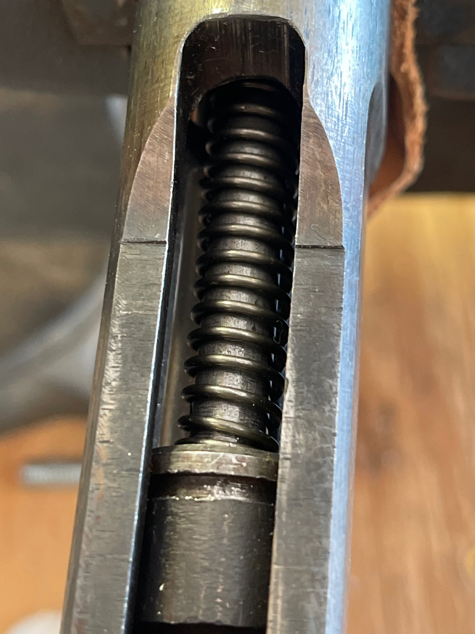

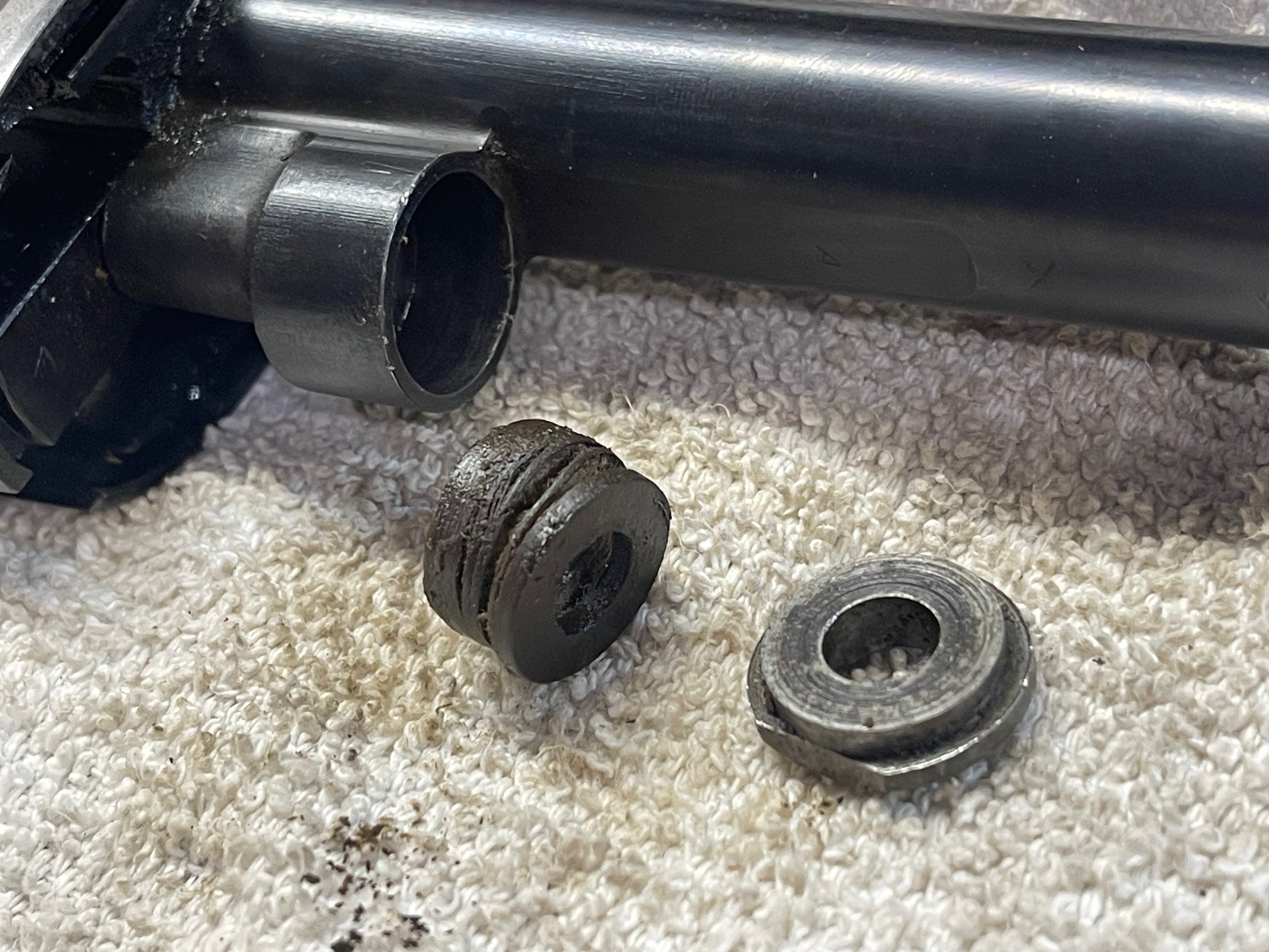

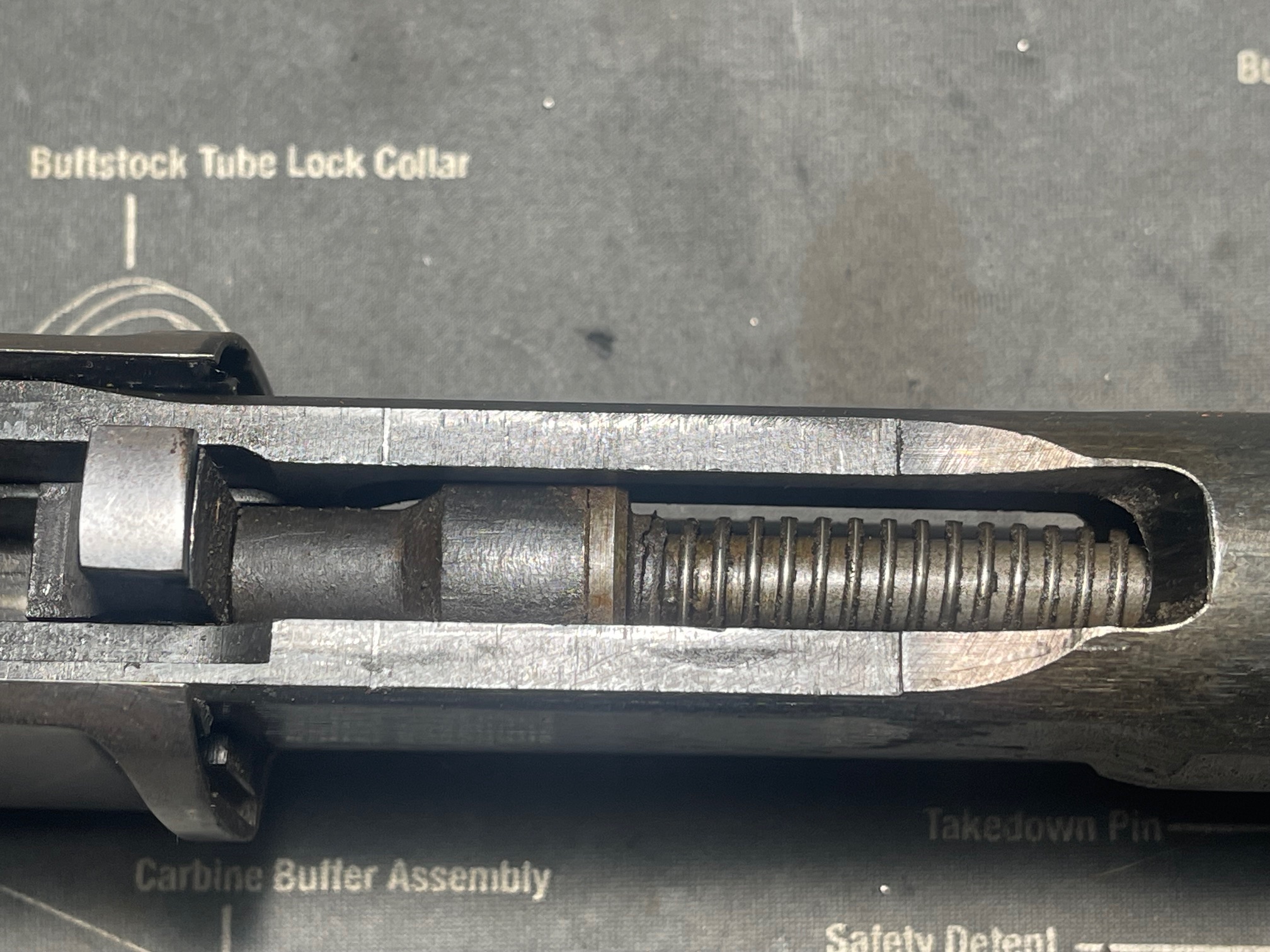

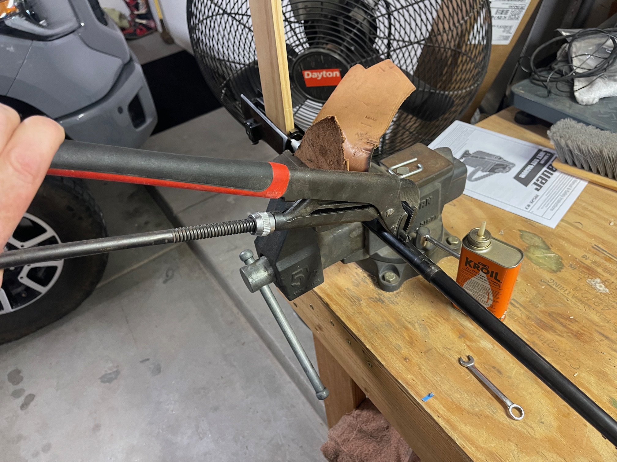

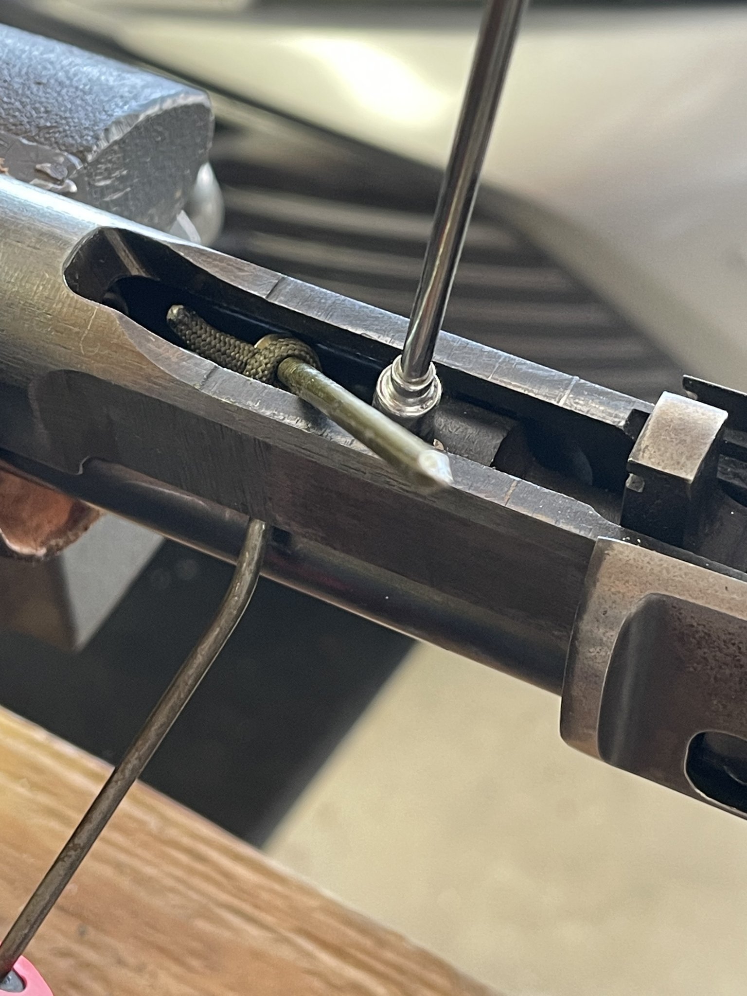

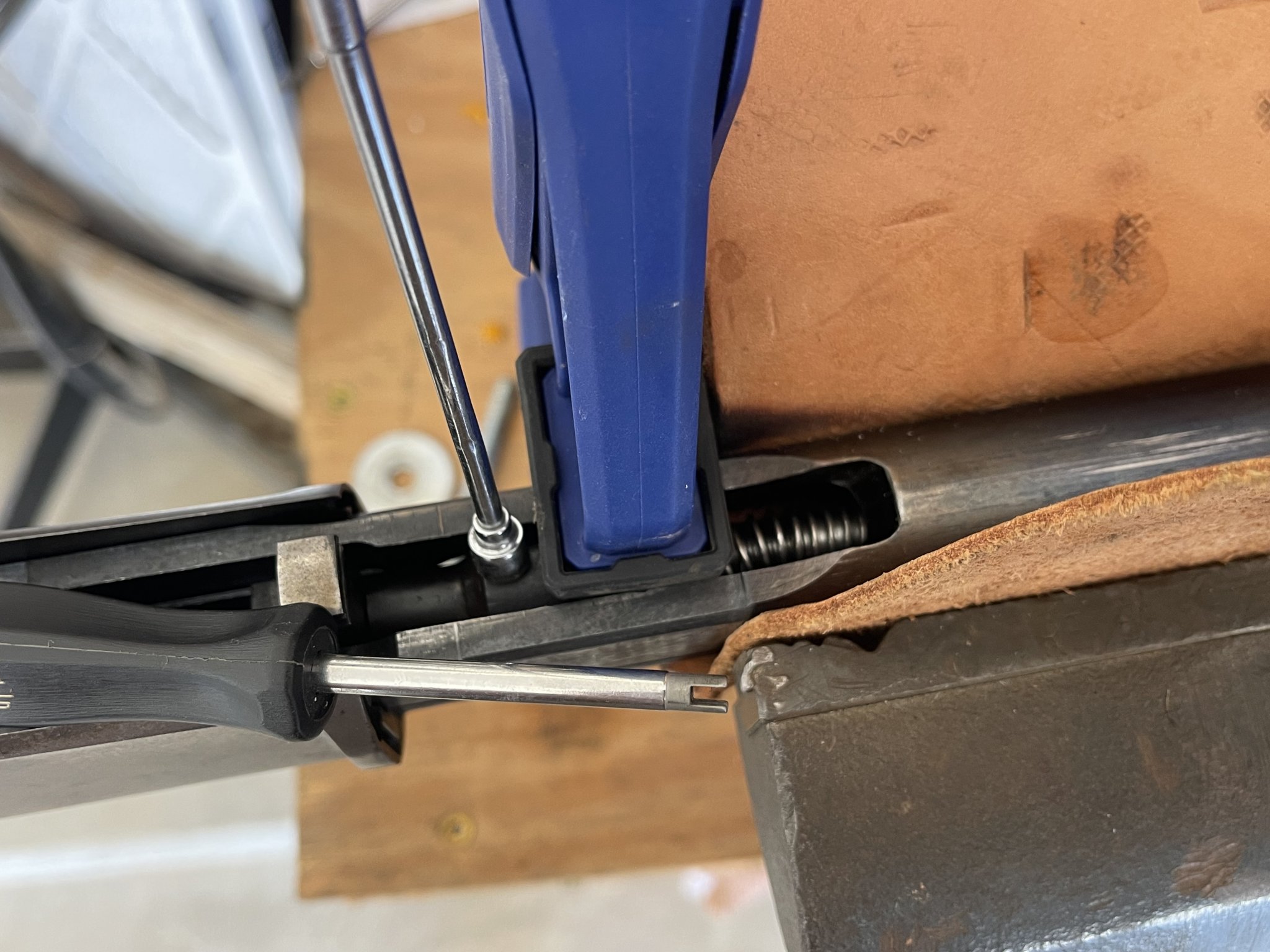

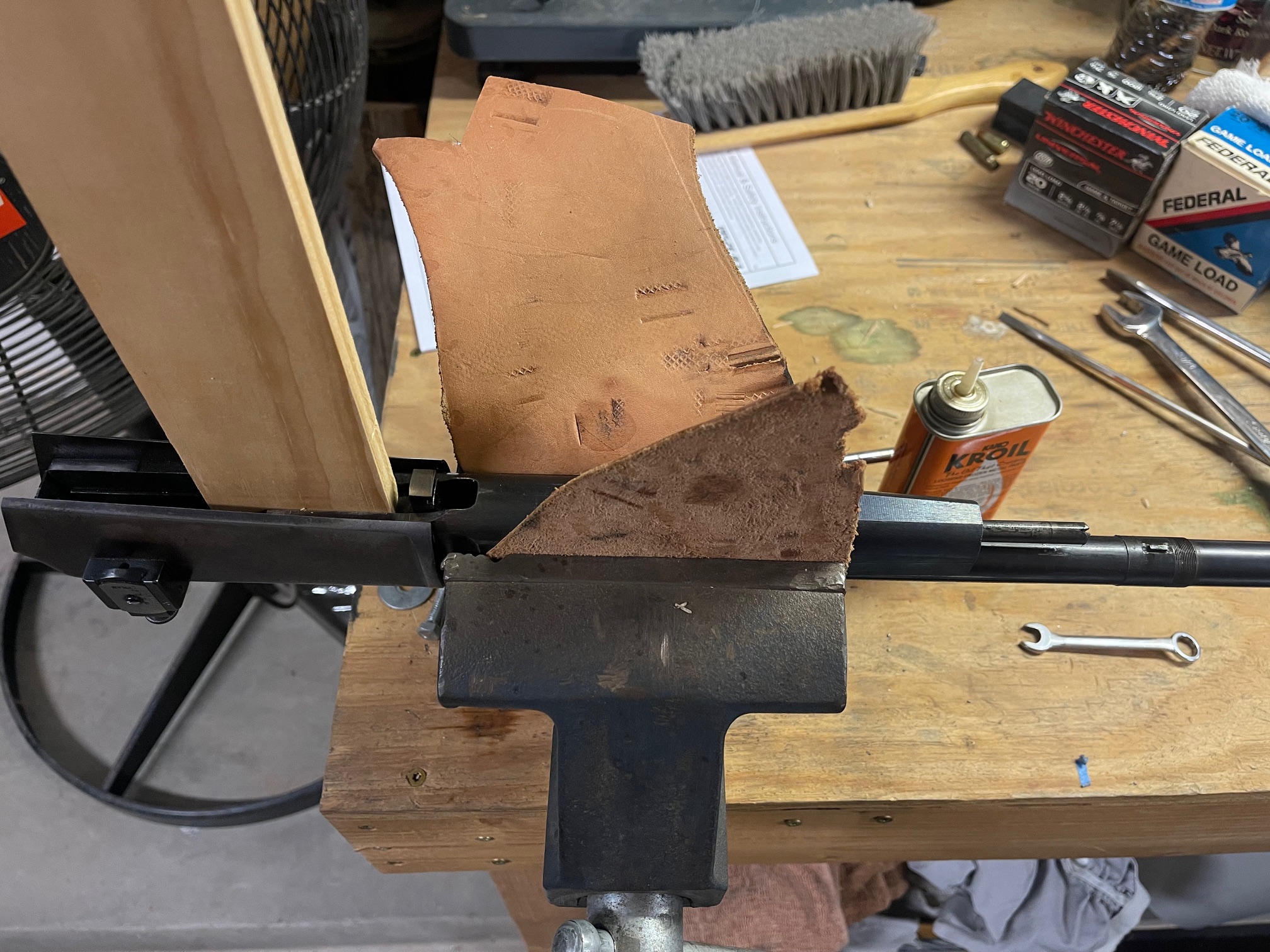

Finally got it apart and it took some doing. Probably hasn't been apart on 50 years :)
The rod was not letting loose even with Kroil and heat. Screwdriver would just slip out of the groove. Stuffed some wood in the action to keep the rod out of the end of the bolt and used a big set of vice grips to turn the rod. It'll be a real chore getting it back in!

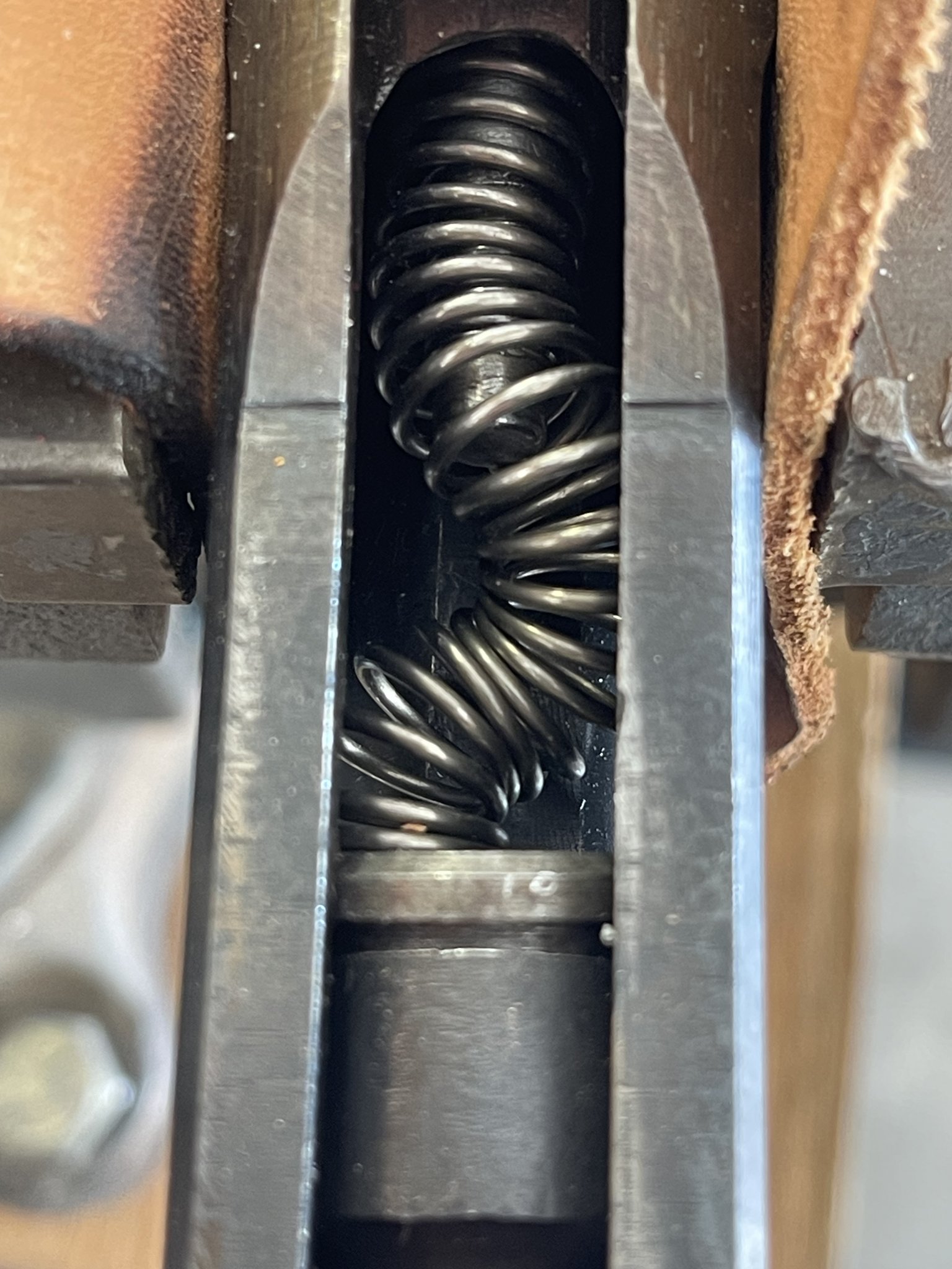

Before disassembly you can see no gap where the buffer should be providing a gap to prevent metal on metal during cycling.
Gun 'smif' tools ;)

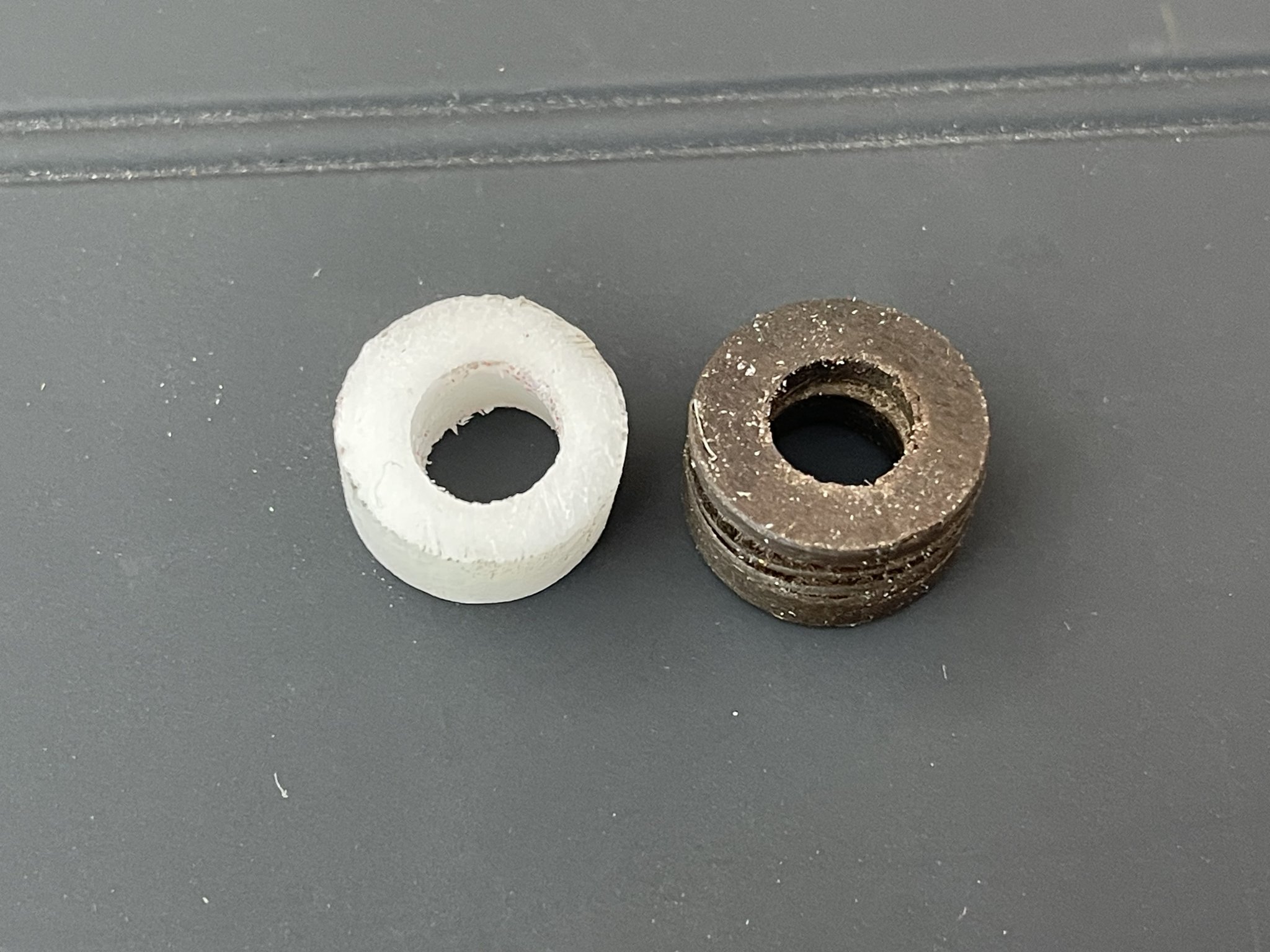

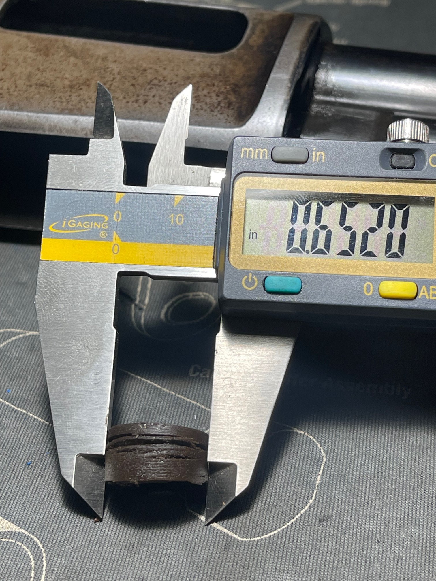

Buffer looked decent until I dug it out of there, then it came apart.
Will try and find some delrin to replace it.

Made a buffer out of delrin. Took 2 hours to get it back together and now I can't get the forend back on. The spring in the tube of the forend is not allowing the sleeve to slide over the rod that holds the spring and buffer in place. Will keep working at it.

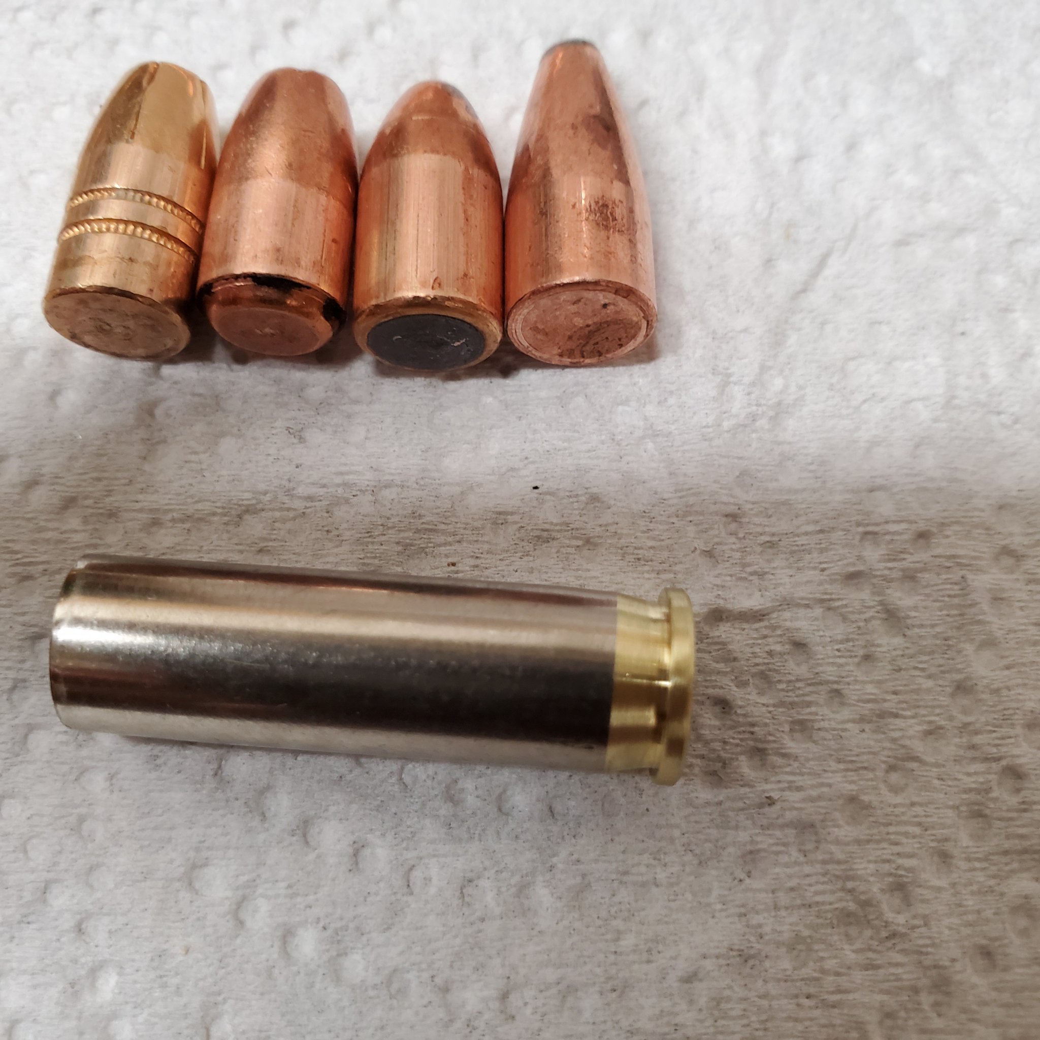

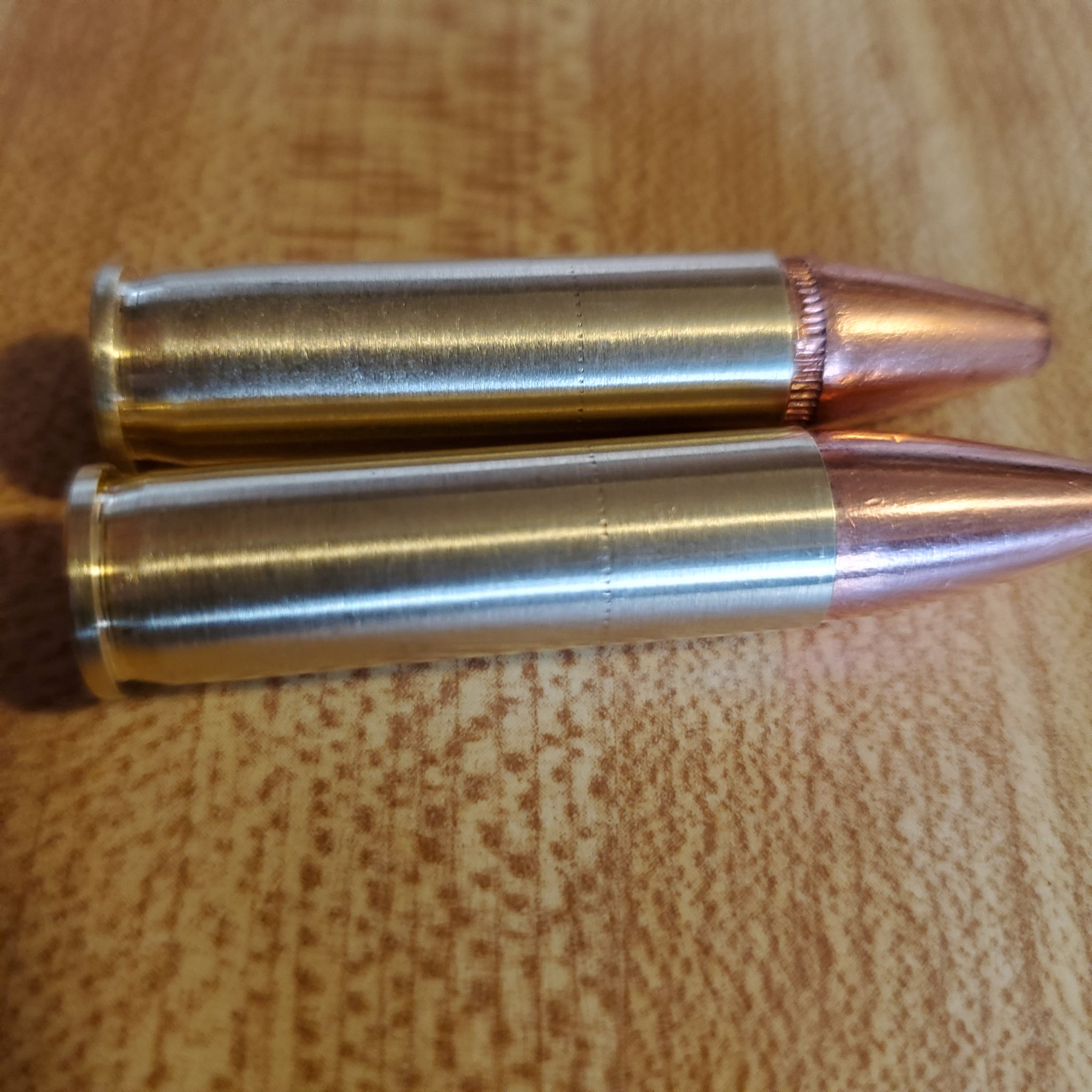

Just went out and made a couple pieces of 351 out of 357 mag. They would be short but headspace off the rim.
Have to have a .351 dia bullet, ...so resize a 170 gr 350 legend bullet, seat it out long, so it feeds and should be good to go on the cheap.

Just got home and found some bullets to put in the cases.
These will chamber and fire in the 351 SL chamber, headspaced off the case rim, with proper 351 SL FL sizing dies.
They are correct overall length, with bullets seated as pictured ..case heads are in print except cases are short on length .357 mag length, and not .351 SL length...be like shooting 38s in 357 chamber. Drop max powder charges a couple of grains.
And let the fun begin.
Remember to size your bullets to .351"
These are 350 Legend 160 gr and 358 Win 200 gr. I saw the dies in stock, but other dies might work like 357 mag then a partial 9 mm, and seat with 357 die and light crimp.

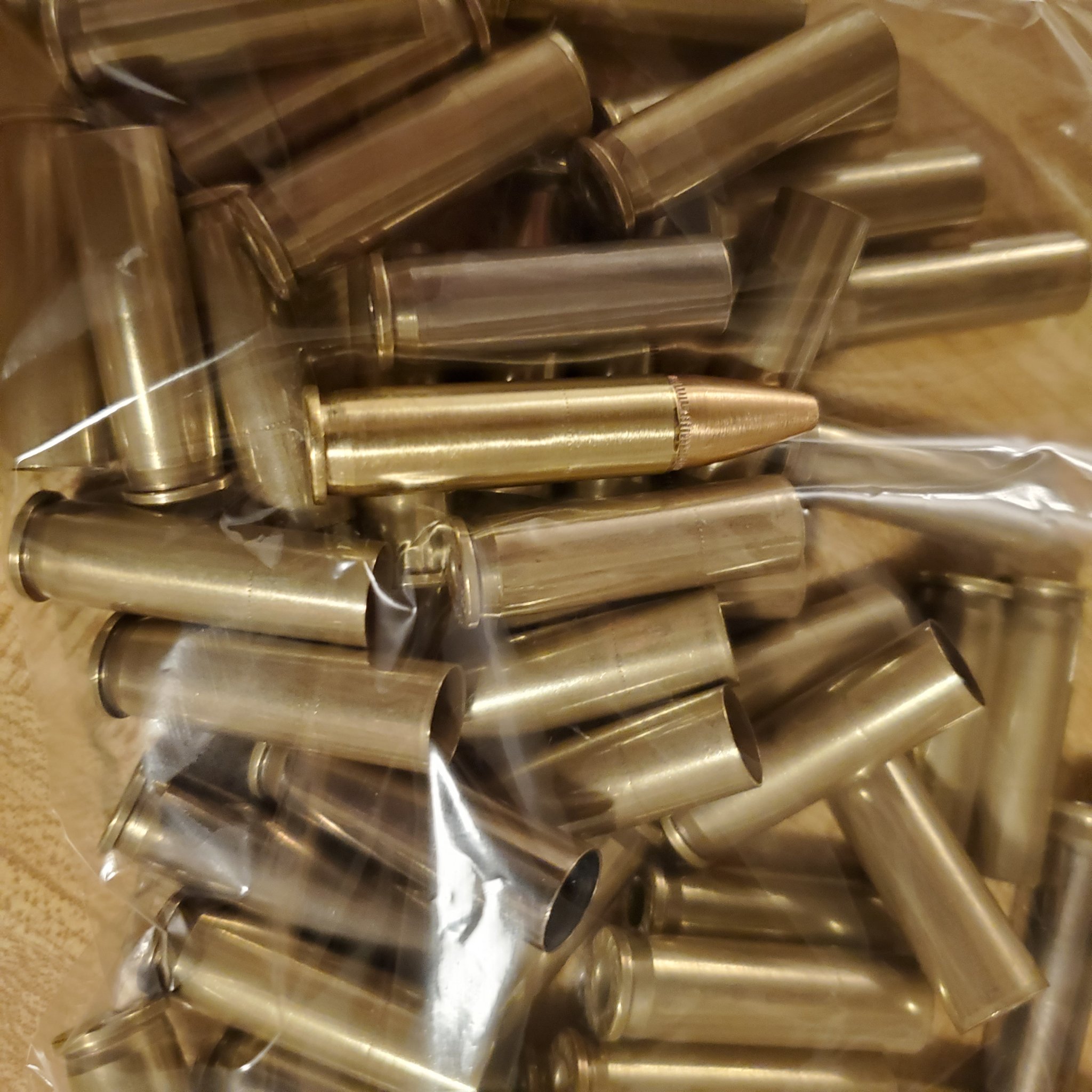

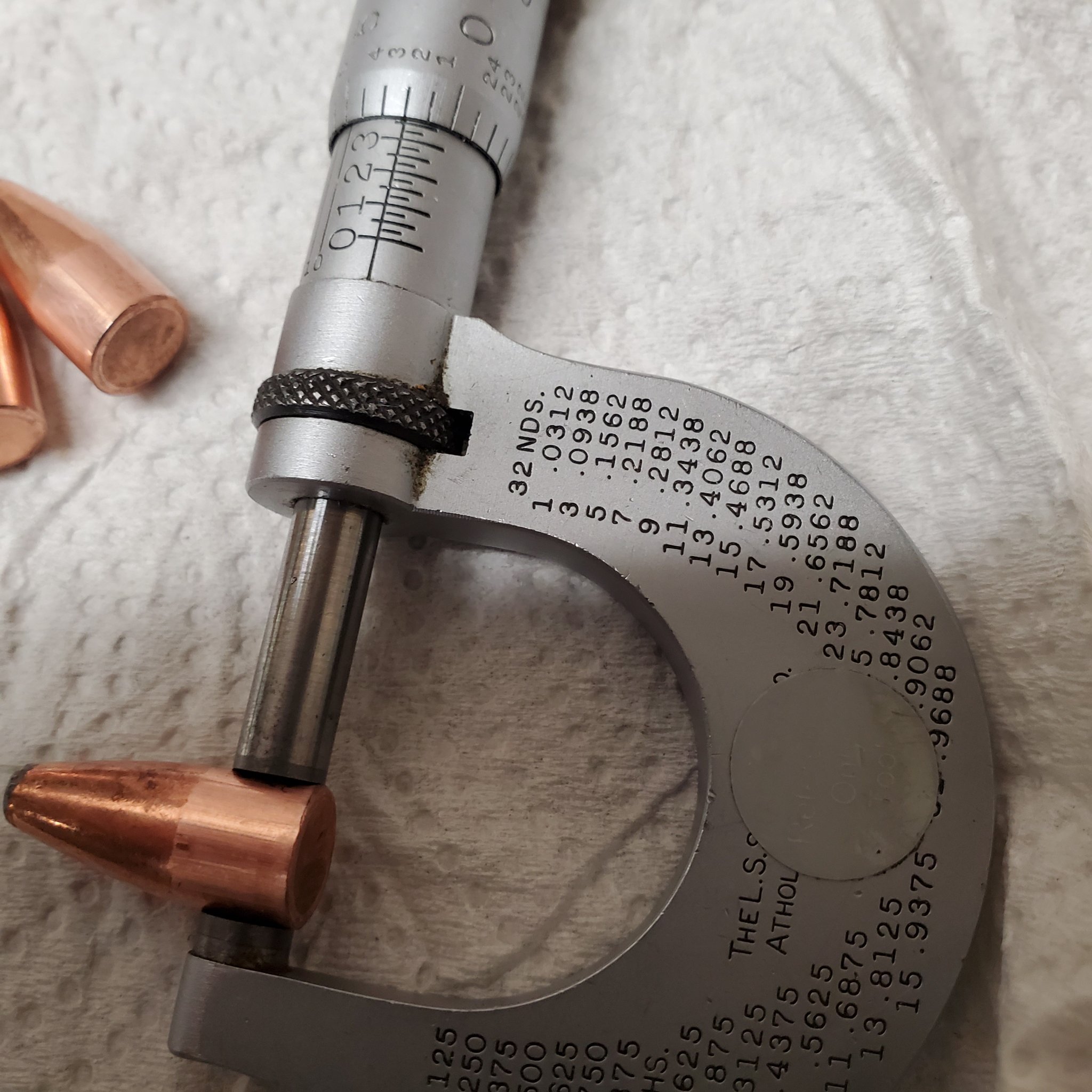

It was raining, so I made some 351 cases out of 357 mag, 53 pcs.
Made a sizing die but was off a bit on spring back of the bullet...they came put .352", but .352 could be used, and is recommended for cast bullets.
Hawk bullets sells jacketed and other sources for lead bullets, on line.

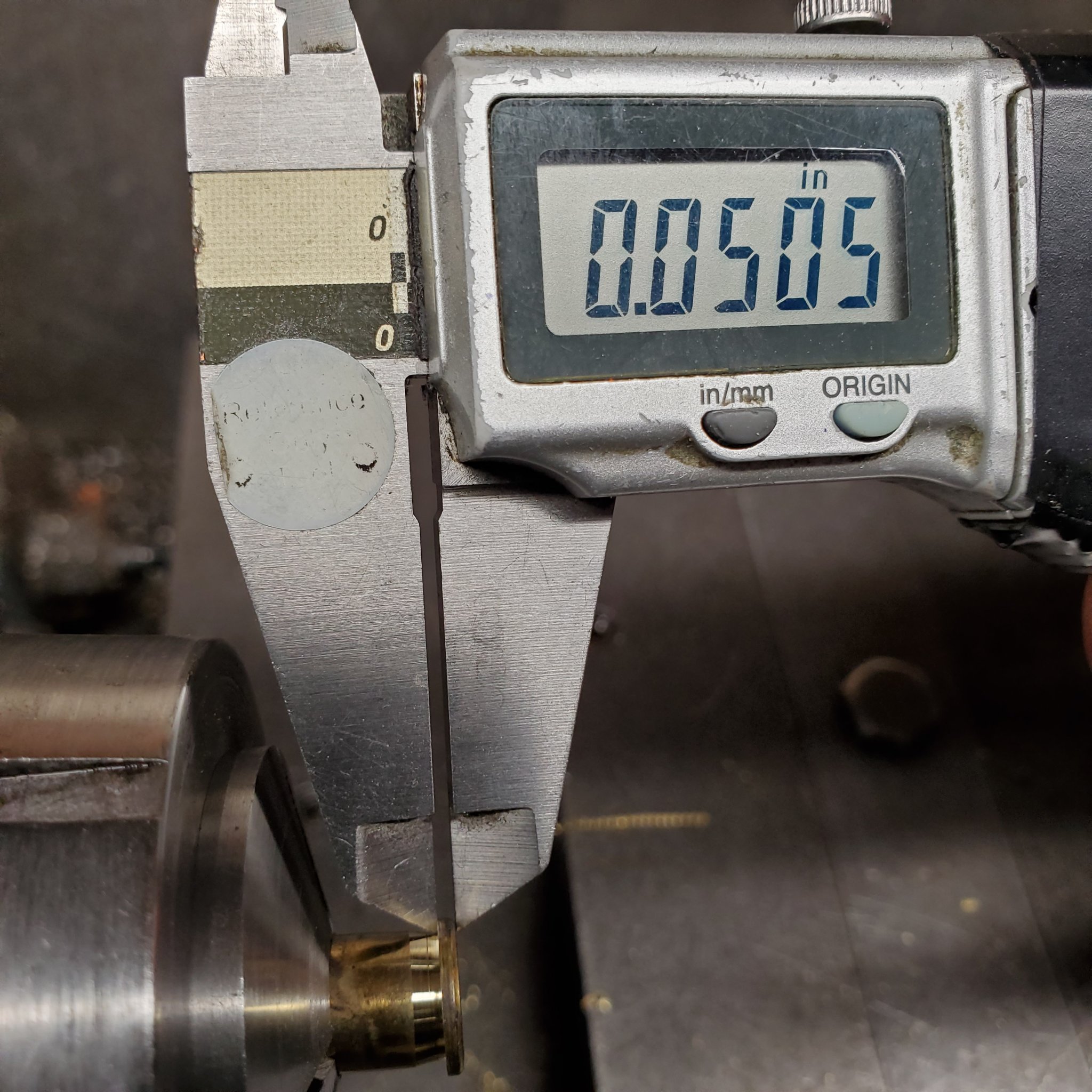

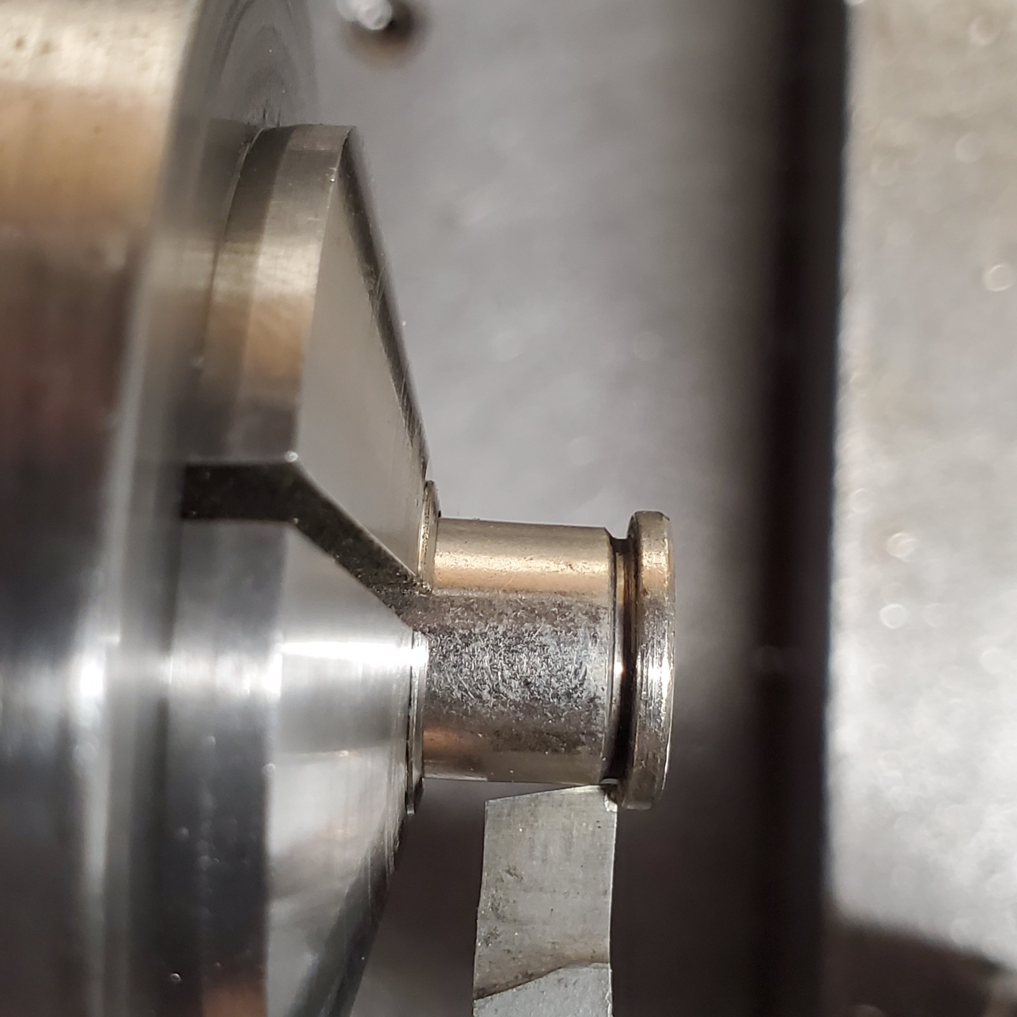

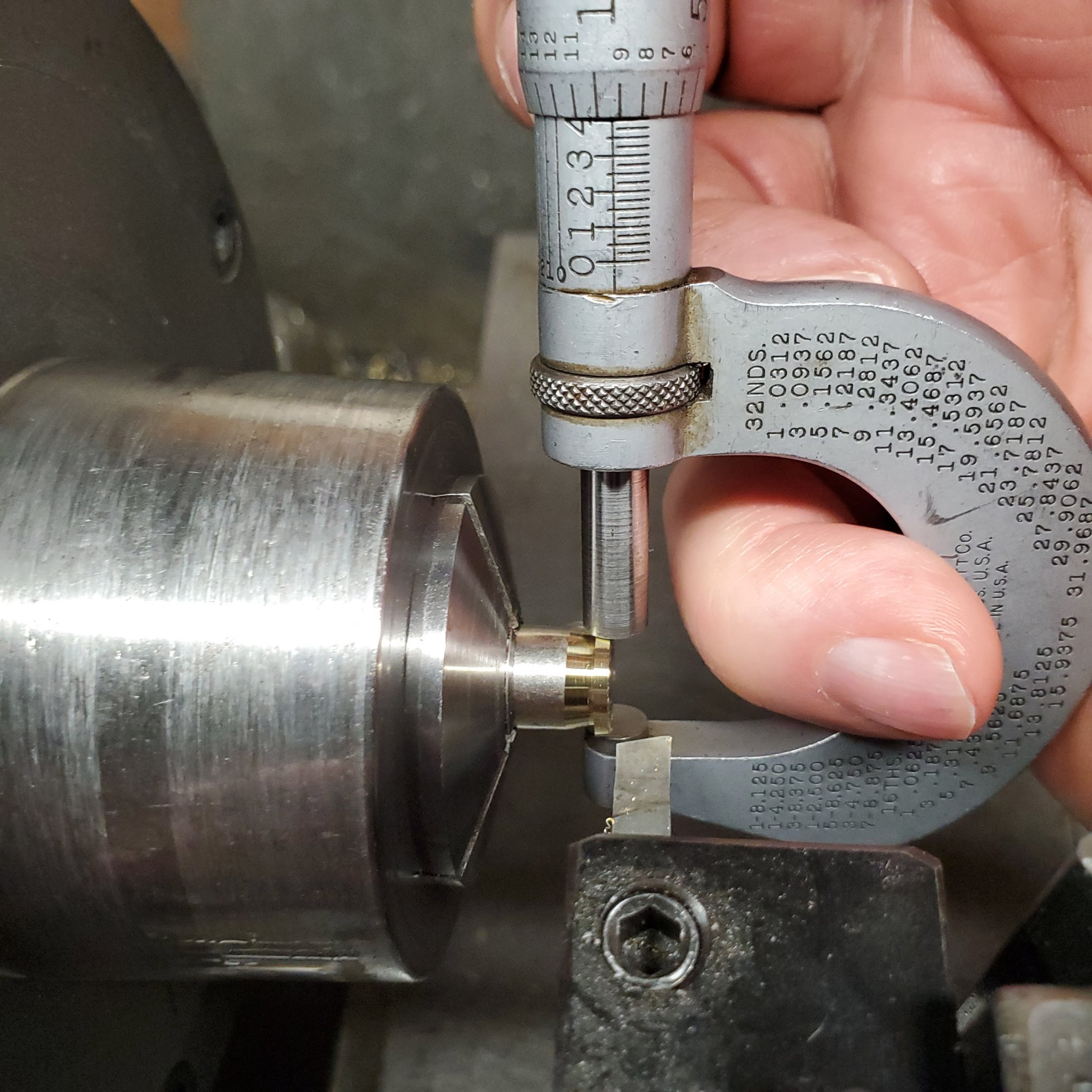

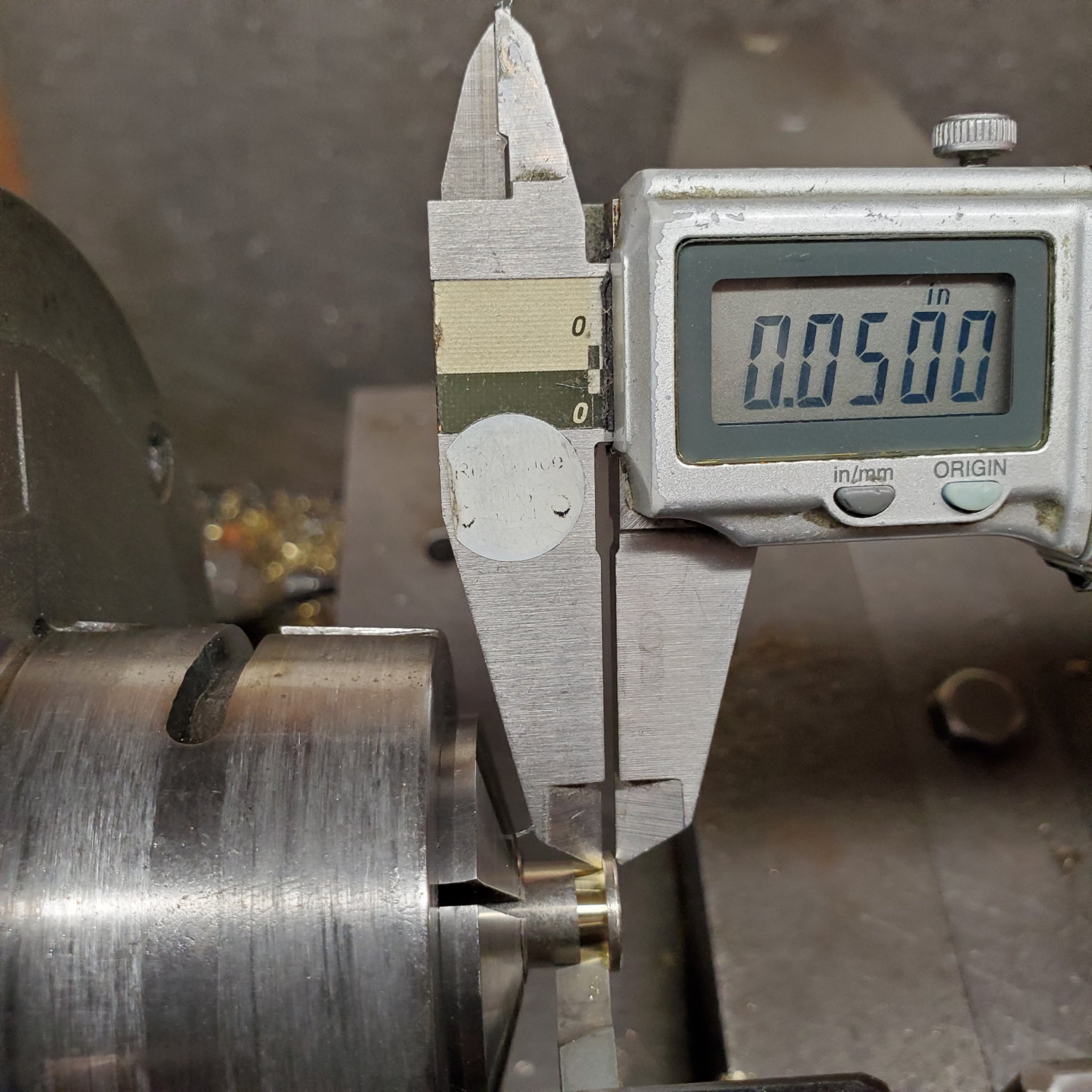

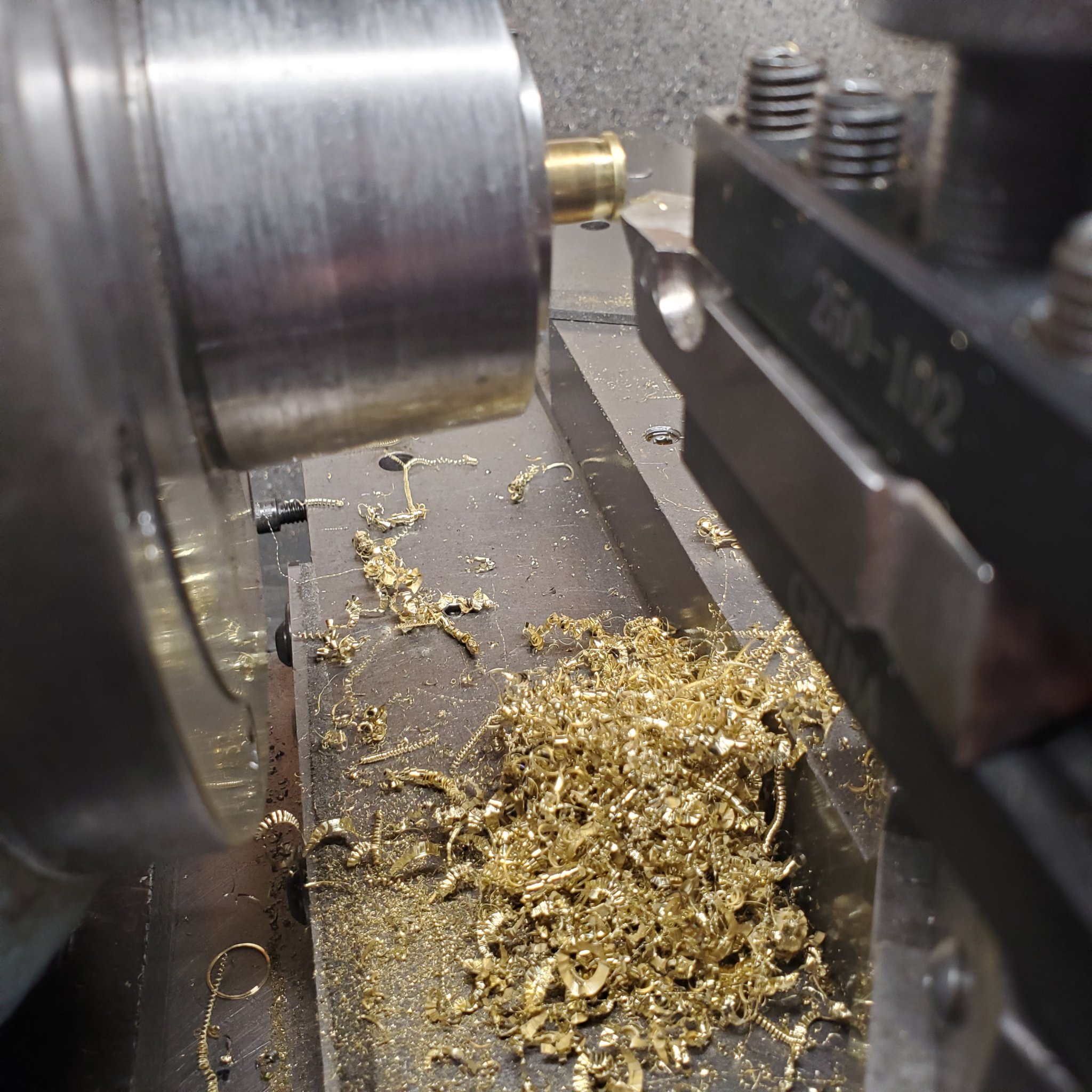

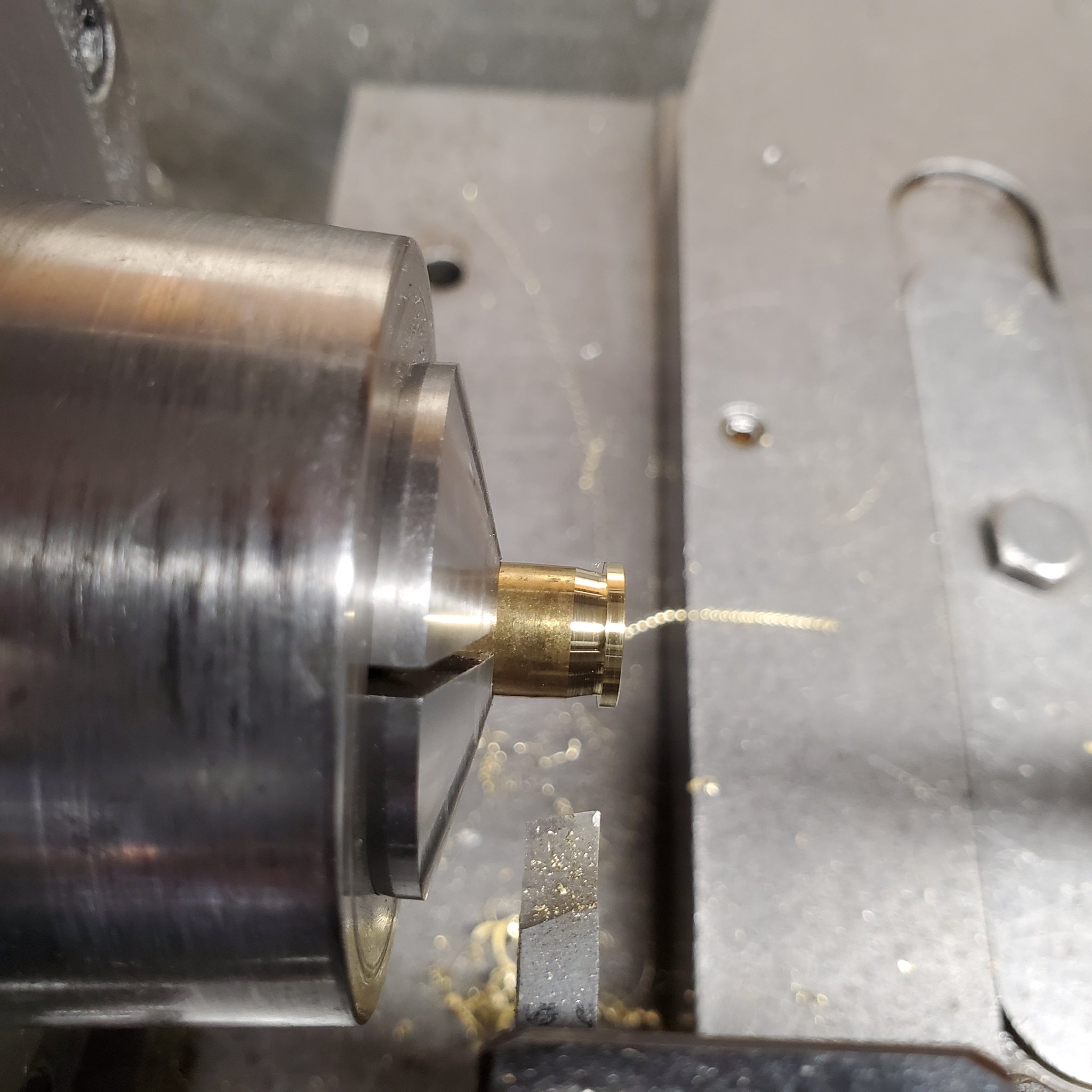

Went out and cut one and took pictures to post for anyone interested in just learning or curious in doing so.
Start with a precision lathe and collets with a collet a top installed.
The carbide tool is ground at 10° and the 357 rim is .004" or .005" too thick.
Plunge cut the extractor groove at
.355" dia and cut the .050" rim thickness headspace in one cut.
The 357 mag rim is too large use the same tool to cut it to .410" some manuals say .408"
Champher with 45° tool and done.
One can resize any .358" or .355" 9mm bullet to .351 or .352" to have a large variety of jacketed bullets to choose from.
The 9 mm 147 gr HST resized to .351" to .352" would make a great close range varmint round for this cartridge.
You have to work up with these old blow back semi rimed designed cartridges.
Like an AR start low and increase the powder towards max, until it starts functioning correctly, with a little to spare on the top end.

Many seem to like IMR 4227,for accuracy and 2400 for speed...

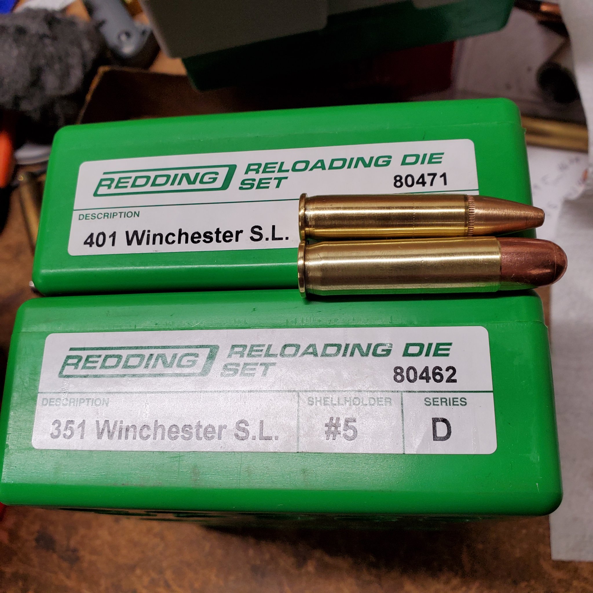

So I ordered some dies and made a few cases for 351, and 401 WSL rifles.
This is 308 Win to 401 WSL not the easiest but it can be done, with a lathe.
A lot of brass is unavailable, at this time.
The 351 WSL is 357 mag brass.
Now all I need is a rifle to fire em in....
Reactions: mtrmn and bfoosh006
Wow! Dies for a rifle you don't have, that's dedication.
Maybe you need mine?
Yep, before even buying one of these old guns, I spent $294.14 on dies for two rifles I do not own, just to see how much trouble it is to make brass from other calibers, where brass cases are still available.
