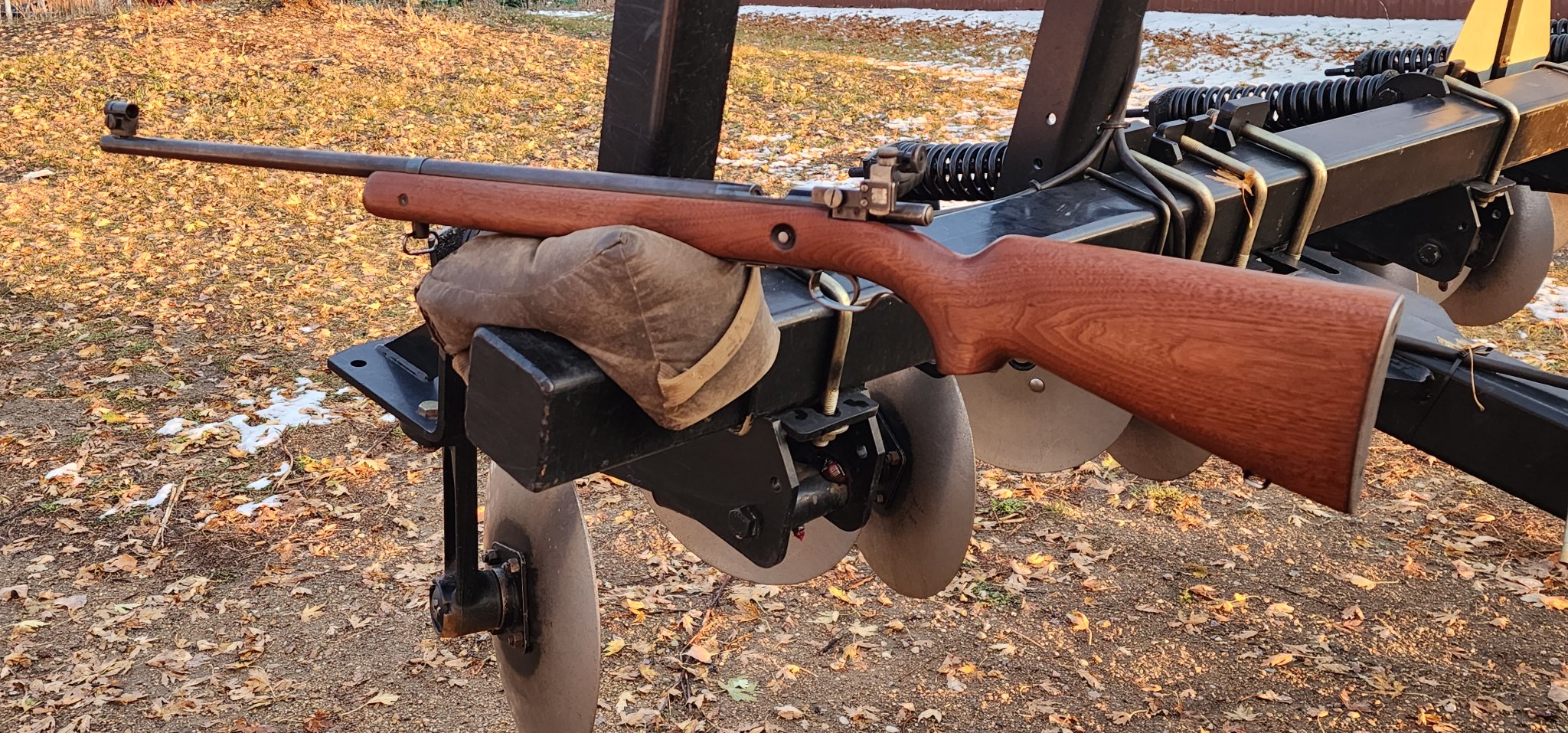

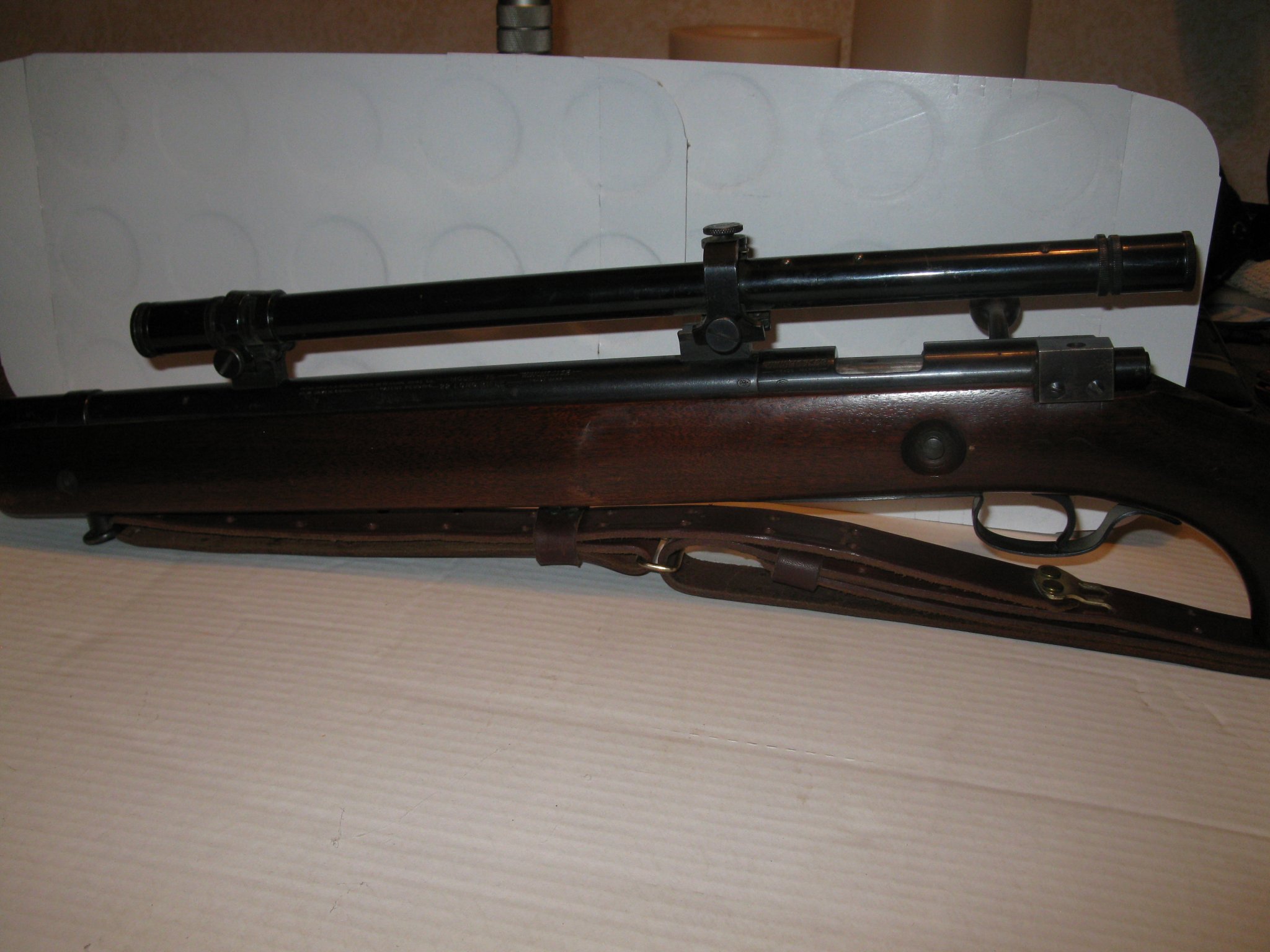

    I recently acquired this winchester 75 made in 1948.
    It's rough, but it's on my list. After a barrel band screw, sling screw, barrel block screws and trigger guard screw its complete.
    The Redfield sights are nice but the rear just spins. Will adjust up or down from 35-40 and then just spin.
    I'd like to put a barrel mounted optic on it. I've looked and the prices go from 400- 5000 for period correct.
    What do you experienced people think would be a good choice. I just want to shoot it. It will be a shooter. If I could actually dial an old scope enough to shoot in a nrl/prs match that would be awesome and I would use it. But I don't think that's possible.
    Or do I just find a EGW or similar scope mount and put a modern scope on it?
    Budget is 700-800 for period correct'ish scopes. I've got modern scopes I can use and the egw rail just looks sold out, but I'm sure there are other options.

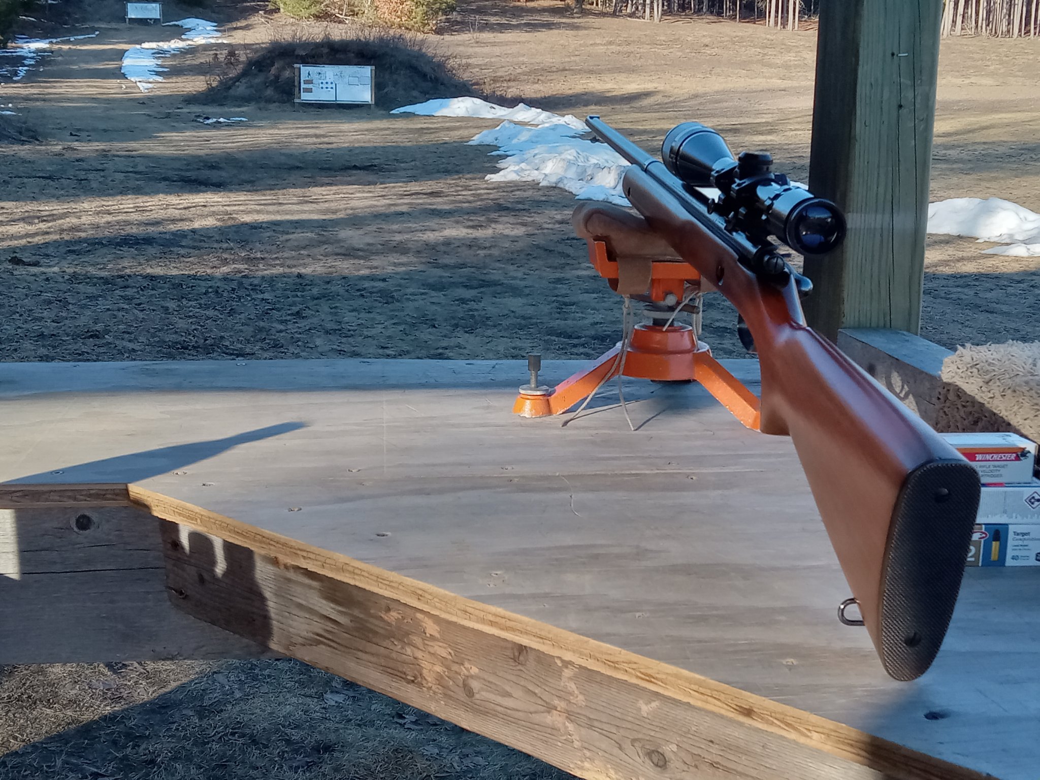

    Thanks for all the messages and knowledge. I've decided for now to aquire scope blocks for the barrel just to have. Then ordering a EGW base from gunbroker to put a modern scope on it. For now I think that will be great until I save up to buy a period correct scope.

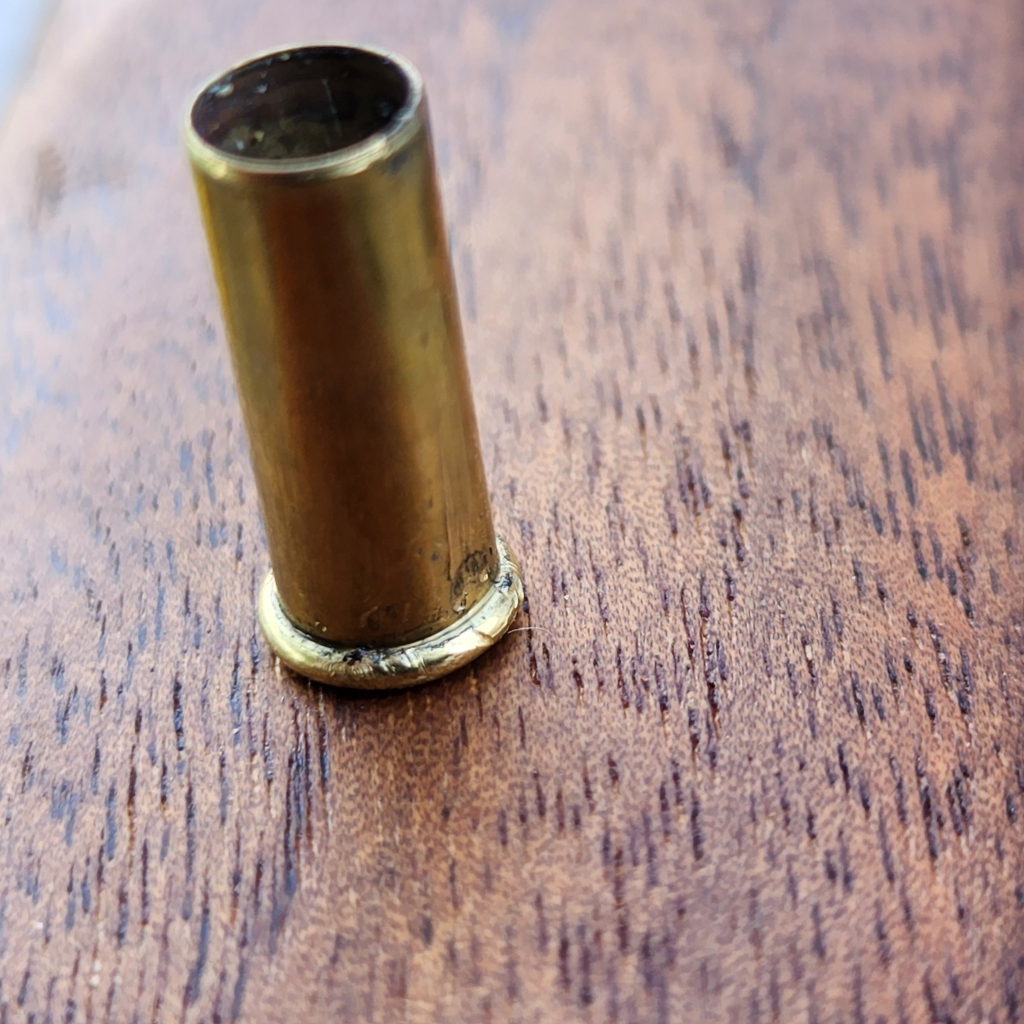

    Also some more negatives about the rifle. I went to shoot it the other day. Could not get a round to chamber.

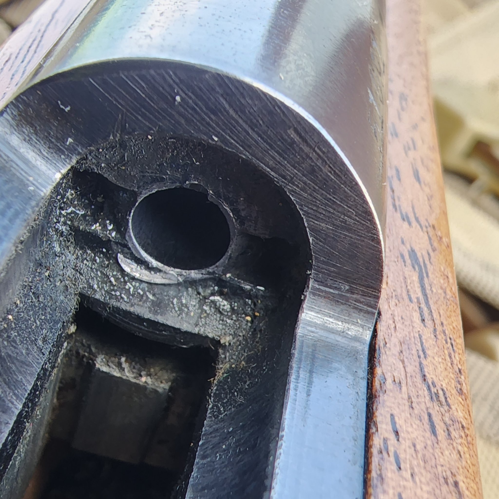

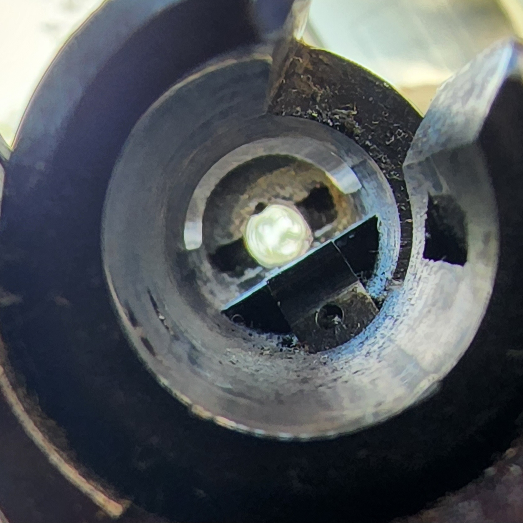

    Checked the chamber and was greeted with this dimple from some one dry firing on an empty chamber I assume. I know some guns it's forbidden because you will do exactly this. It's got a divot of metal displaced into the chamber from the firing pin.
    Maybe what I did next was wrong. But I took a small round chainsaw file and just barely scuffed only the displaced metal. It cleaned it up. I was able to chamber a round.

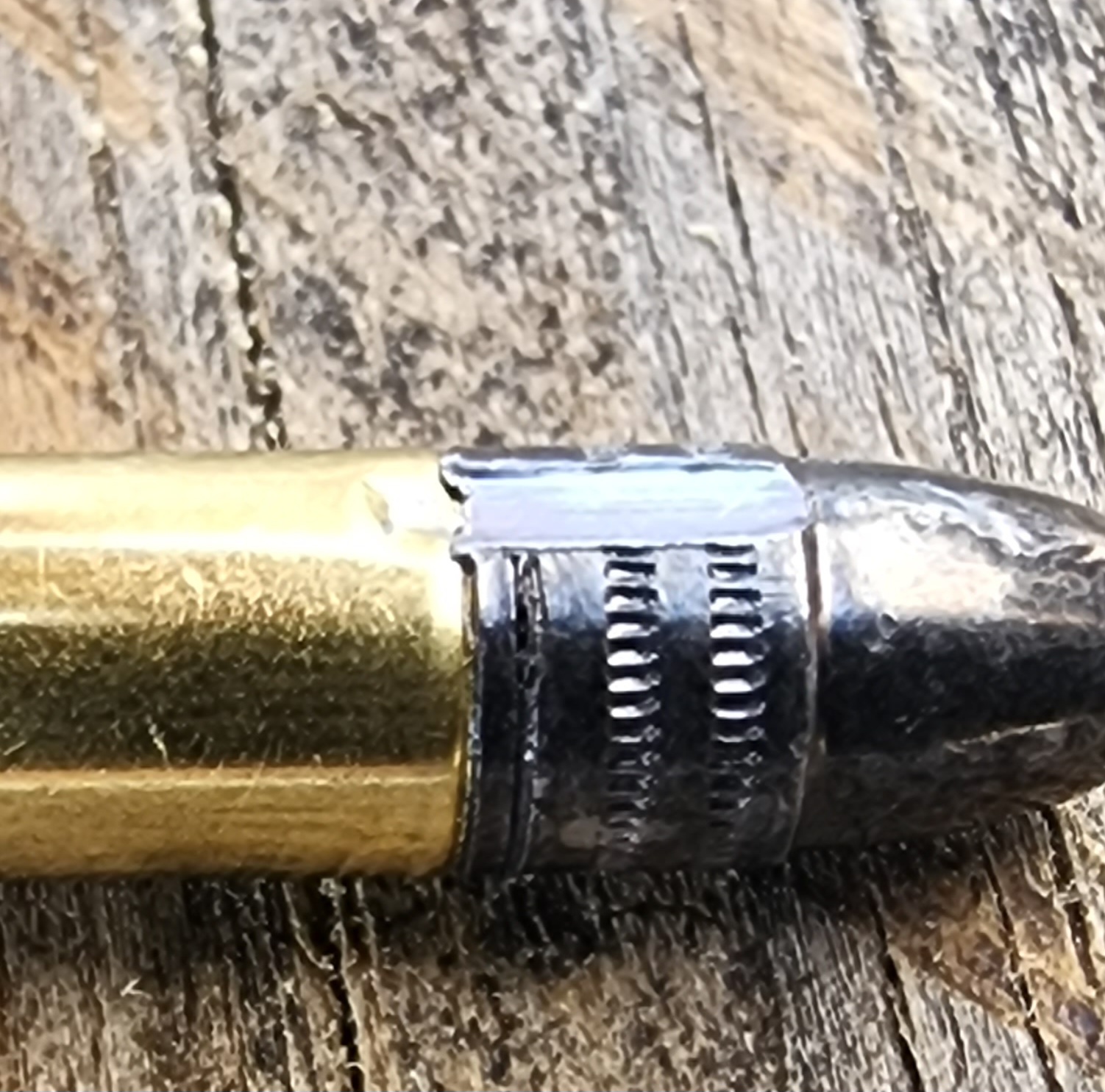

    First attempt at firing it did not go off. Re-cocked it and it went off. I could not extract the case. Grabbed a cleaning rod and tapped it out. The case is forming to the metal that is still goobered up in the chamber.
    So I am definitely disappointed. I didn't dry fire the rifle and it wasn't disclosed. Nor did I notice it in pictures when I purchased it off gunbroker.
    View attachment 8160203View attachment 8160204
    Talked to the gunsmith that does all the work for me. He said he's fixed this before. He has to swage the chamber. So off to him it goes.
    Well that's where I'm at with it so far.
    That’s a shame. I’ve heard that it can be fixed via swaging or using a chamber iron such that it’ll be fine to shoot.

    These are a few pics of my model 75, not good pics, but they were on my computer. It is a 1936 model, low serial number. If I remember correctly they were first made in 1935, and not that many the first year. It has an original Malcolm & Sons 3X scope, the trigger is very light and it shoots to beat all hell!
    It sucks big time about yours being damaged like it is, that is a shame. I agree with your decision to put a modern scope on it. If you want to collect and look at it, pay out the ass and get an original scope. If you want to shoot it, and really see what it is capable of, get a decent scope!! The Malcolm and Sons 3X wire crosshair scope, .750 diameter , does not qualify as such. Maybe in 1936 it did, but not today. I can shoot nice groups with it, but it isn't easy! I had to send a lot of e mails to guys who know these things and were nice enough to respond to be able to make the scope even usable! They did also have a 6X scope on some rifles, that may be interesting??????

    @sjmpcc022 that looks gorgeous. I need a leather sling for mine. Was the Malcolm scope something that you could buy as a package deal back then? Or just another aftermarket scope?
    I'm really not sure? From the research I did years ago I was under the impression that it was standard on some of them, that may be absolutley not true also??? The story is my mom's uncle gave it to my dad, for helping him out with some things when he and my great aunt moved. He was old as dirt when I was a kid, so he may very well have bought it new, will never know that one. At least I'm not going to do the research to find out!;)
    It was always in the house when I was an older kid, I shot it a little bit. There was also an old Winchester pump action .22 on the wall in the dining room, kind of looks like a model 12. I shot the shit out of that gun, it's still hanging there, still could! When my dad built his new shop, the model 75 hung on the wall in there. I took it down one day after he passed away, looked it up and said, "Holy Shit!" I had no clue what it was before I did a bit of research, in decent condition looks like 1500ish or so! I started digging, got the scope so you could see through it and started shooting it. Damn does it shoot!
    Truth be told, that rifle is what got me started on the road to my B 14R and shooting PRS/NRL with a .22. That old Winchester is fun, but it wouldn't do what I wanted it to do. It's back at my mom's house where it started, at least for me.

    Another option to take care of the chamber ( if you can find a suitably skilled gunsmith to do it and not take 5 years!) is to shorten the barrel from the rear and rechamber.
    Reactions: camocorvette
    @sjmpcc022 that's awesome. Glad that old gun got you into it more. Hey throw some oil on them and just let them hang up for show.
    @MajorD I hope it doesn't come to that, but that is an option.
    @Charger442 that's what my gunsmith is talking about. I haven't dropped it off yet. But he said it's pretty simple to do. After hornady prc match I'll drop it off. I've got like 3 guns for him to work on.

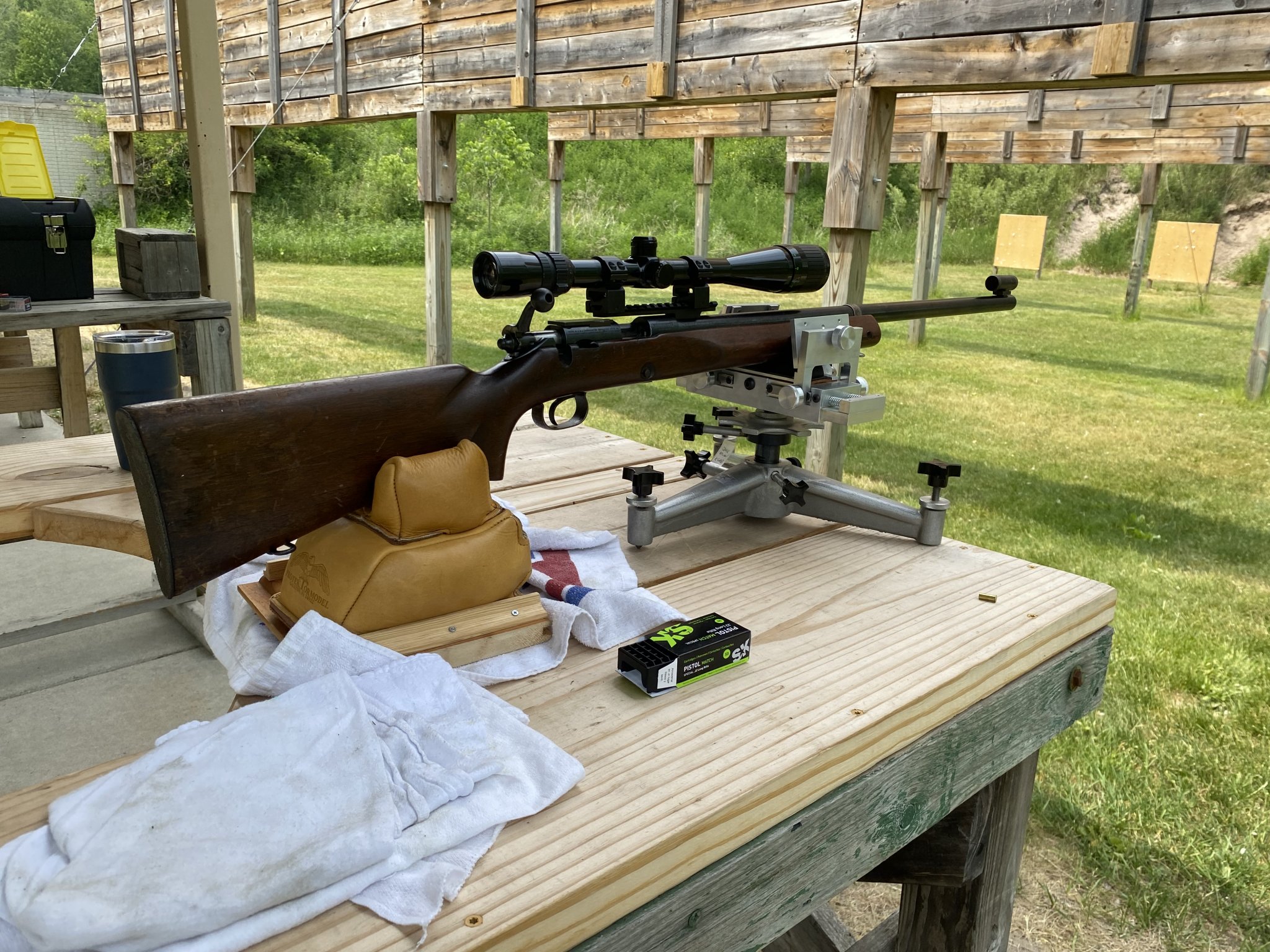

    Got it dropped off at the Smith a couple weeks ago, got it back last weekend. Shot it today for the first time. About 100 rounds total. This is just with the Redfield irons.
    Top left and top middle off a bag and barracade @50 yards.
    Top right prone off backpack + bag and rear bag
    Bottom three targets off backpack + bag and rear bag. The last group on paper (Bottom right) is probably 1.25-1.3 moa.
    At about 440 pm sun was shinning in my face and targets where in the shade. But I enjoyed shooting it and learned a few things.
    There must be a sear engagement issue or something. I would chamber a round and pull the trigger to get nothing or mush like it had been fired. But if I pulled the bolt back and put the safety on, closed the bolt on a loaded round and put the safety on fire. It would fire a round every time.
    Not sure what that is so that's gotta get sorted out.
    My 2nd issue is magazine retention. If the mag wasn't sitting on the bag, 50% it would fall out. Even after it's been seated and the mag latch clicked in. When I would cycle the bolt and load it, it would pop the magazine out. So maybe some fitment issues there.
    Other then that, I'm happy with the gun for what I paid. I'm going to get a rail and mount a modern scope. I know the groups will tighten up.
    Also the 15 round mags you can get for these are garbage. It doesn't lock into the rifle. I think it just needs some filling to fit hopefully.
