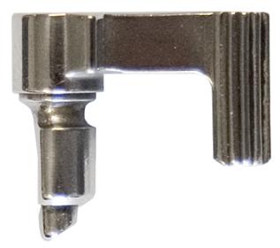

This is the part:
They aren't "prone" to breaking unless you force them into position when they aren't fit right.
You'll notice there is a front/back groove machined into the rear tang of the receiver, to provide a "track" for the cocking piece to move through. There is ample clearance, so the striker is free to twist a little.
I suspect your problem manifests when the striker decides to twist a little clockwise, decreasing the clearance between camming surface on striker and safety cam....binding them together.
I suspect your "fix" of recocking is simply, by chance, reorienting the striker in the shroud a little.

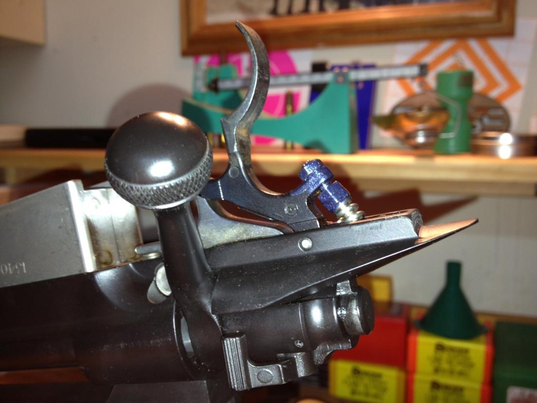

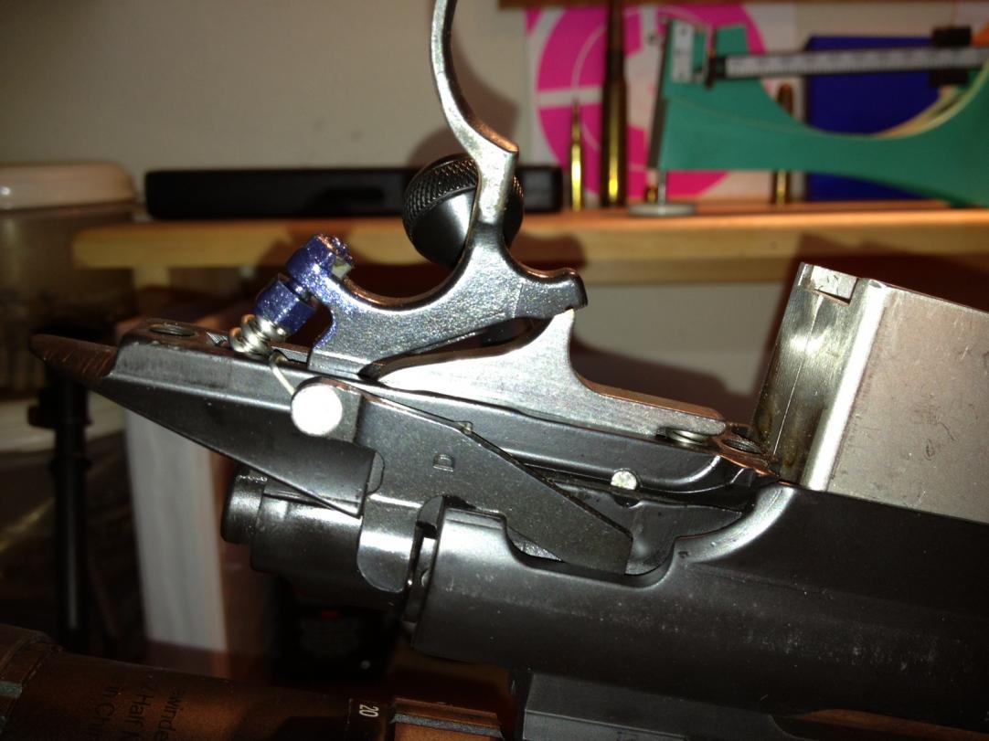

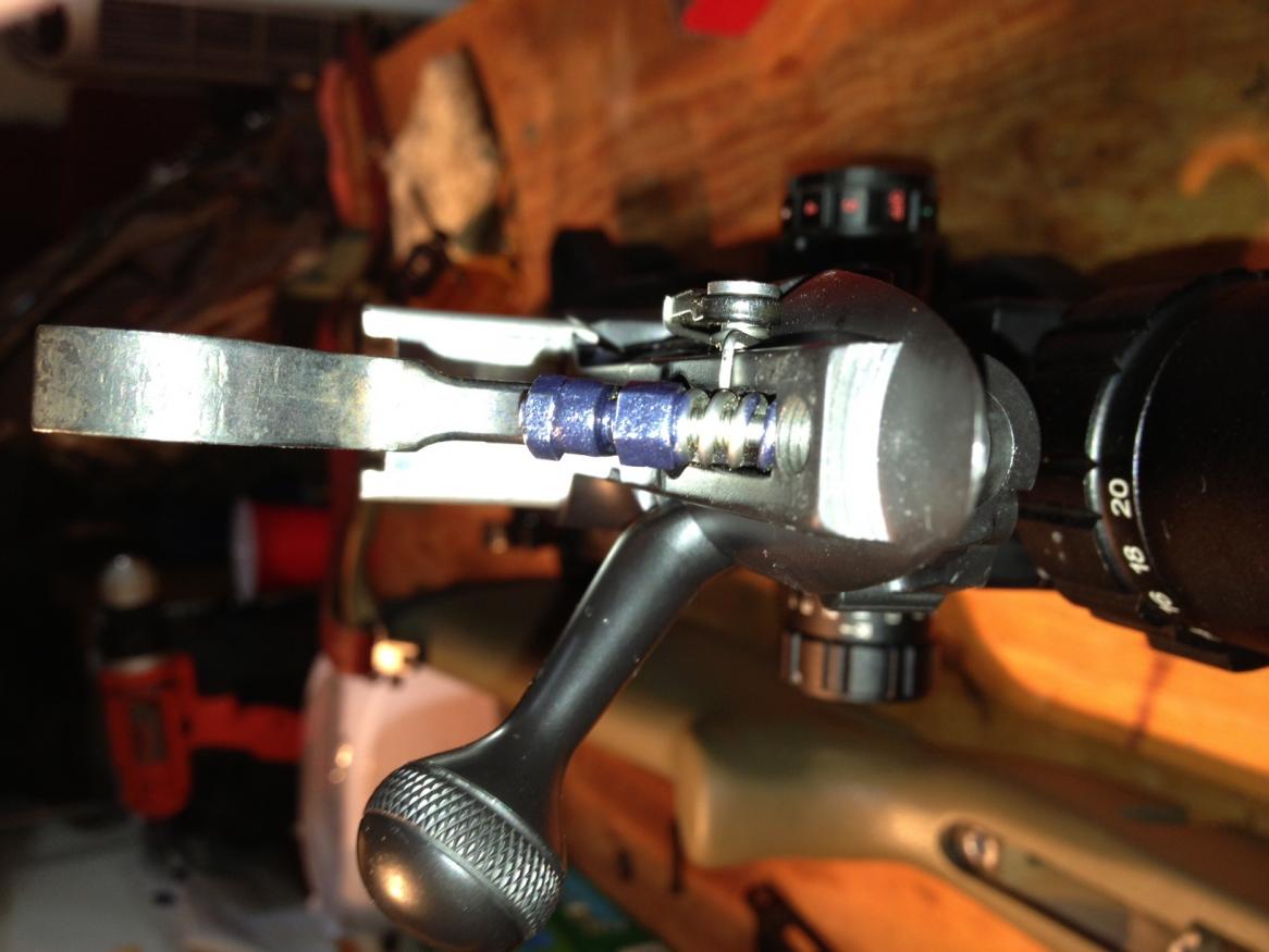

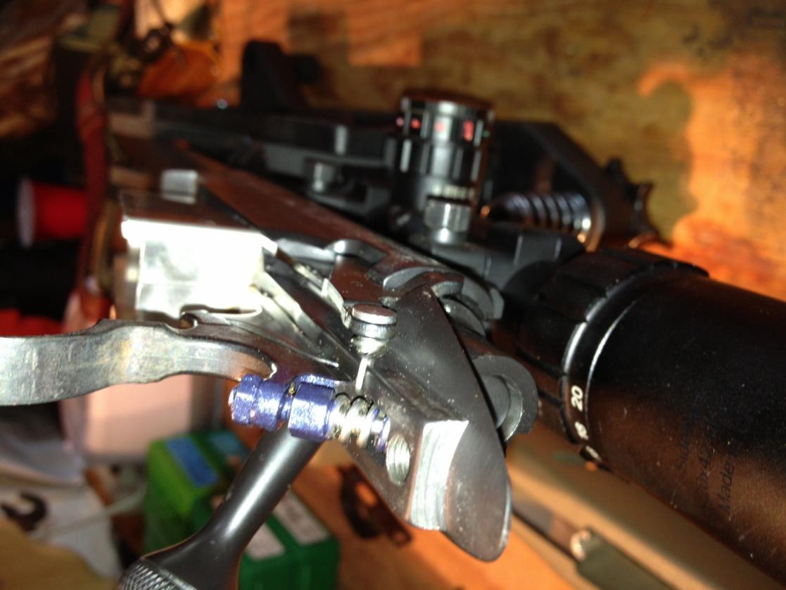

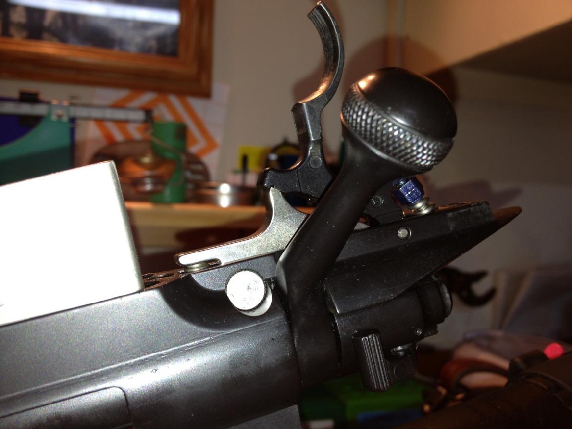

Here are some pics (probably unhelpful), like I said, I know nothing about Winchester triggers. Also, there is very little to no overtravel. I guess I'll call George tomorrow and see what he thinks. I appreciate everyone's help with this matter. Y'all are great!
Sear pin is seated. Pull the trigger and manually make sure the sear moves freely. The pin is serrated and if driven in too far it can bind the sear and cause the pin to not drop. Shouldn't cause a prob with the safety though. If it does move freely, I'd take the trigger pin out to make sure it isn't broken. Don't worry, George can reassemble it.
Have you function tested it out of the stock? Could tell you a lot.
I checked what I could while it was out of the stock and everything seemed to work fine. I've never been able to replicate it here at the house. Like I said before its sporadic.

The barreled action is already boxed up and will be heading to Moon at Crescent Customs soon. Talking with him on the phone was very pleasant and he seemed to have a handle on the problem.
Talked with Moon at Crescent Customs today and he said in order to fix my problem he was going to recut the trigger. From what I understood,which is very little, it sounded like he was redoing the trigger job because he asked me what Lb I wanted the trigger set at. He said something to the effect of "you can't do a trigger job on these without recutting the triggers".He also said he was going to recut my cocking detent as well.
It's the first time I've dealt with Tim "Moon" and let me say it was a pleasure. When I do my next build he'll be getting my business.
