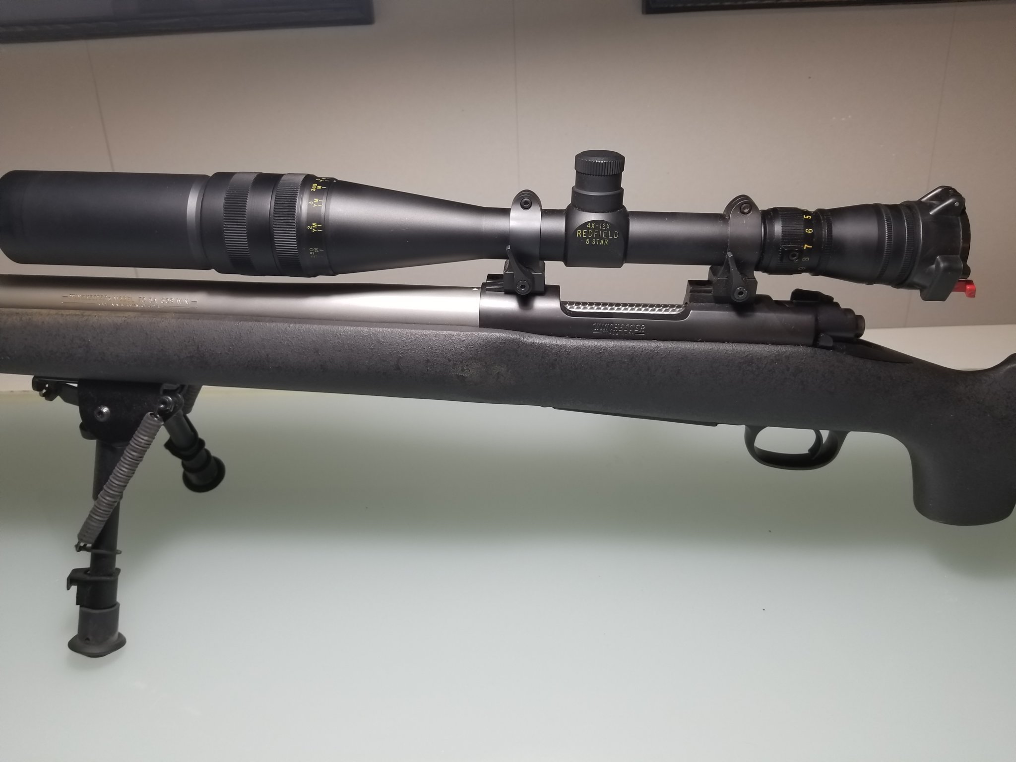

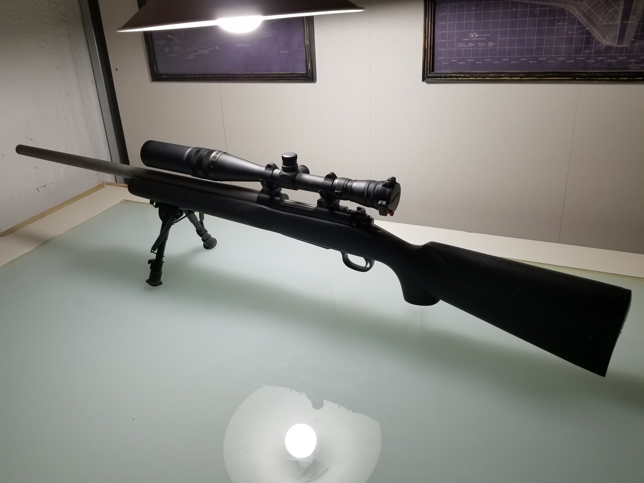

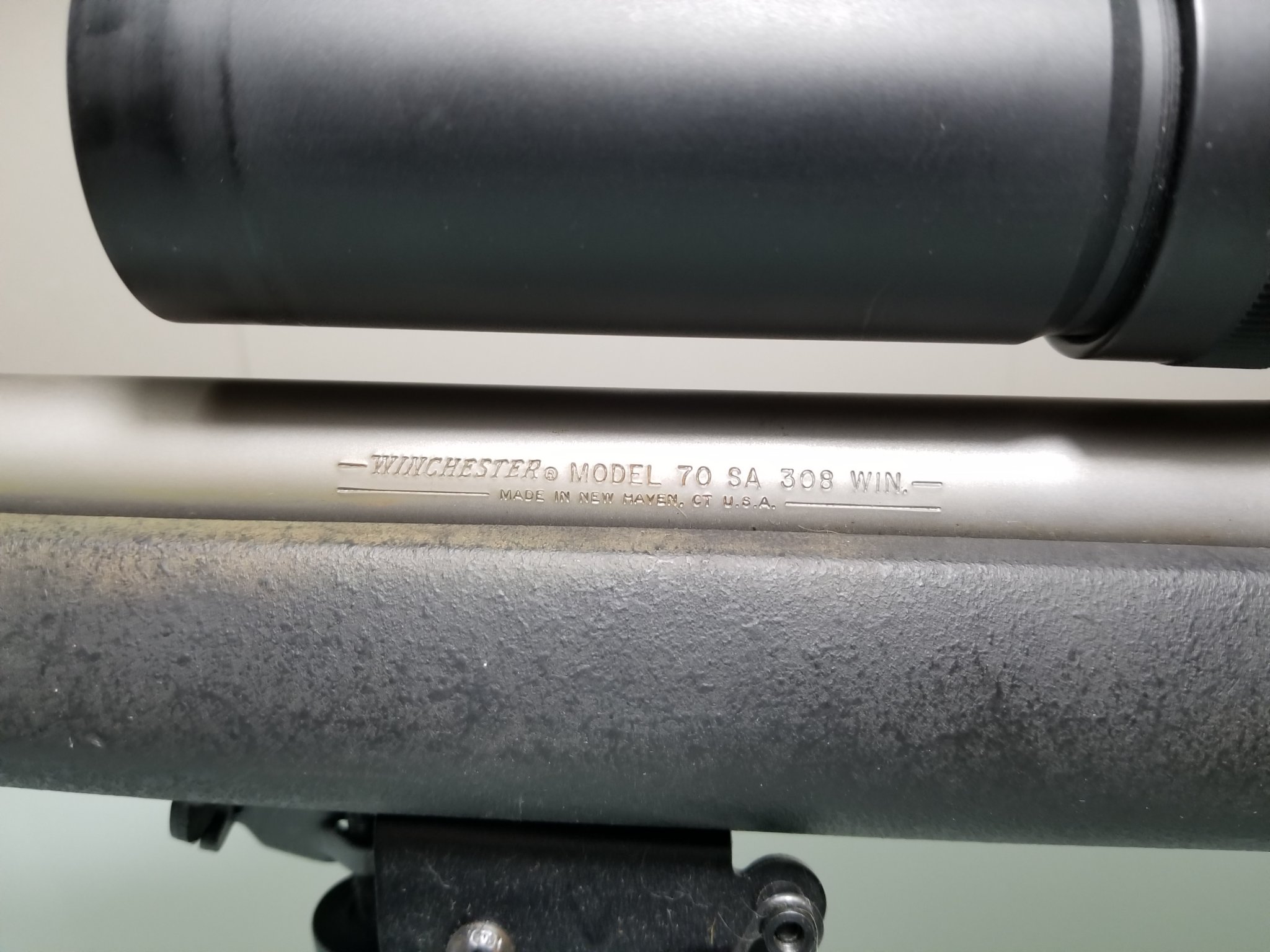

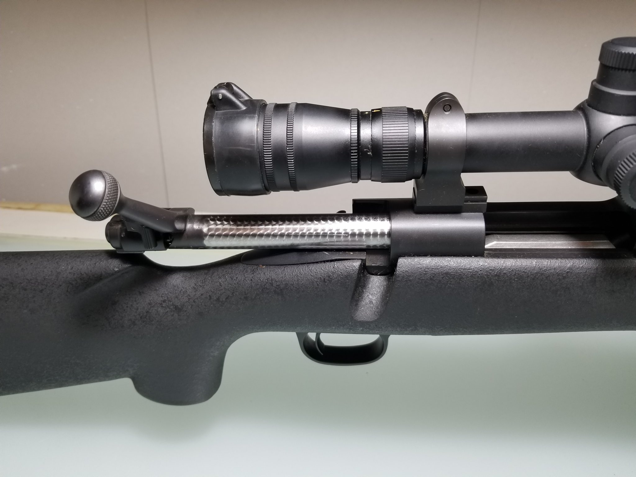

I have, for a long time now, wanted to get into precision rifle shooting. I have a Winchester (Heavy Varmint) Model 70 SA in .308 with a Redfield 5 star 4-12 optic. It's nothing flashy for sure but it's what I have to work with at the moment and I don't want to wait any longer, I've burnt enough time with waiting and what ifs. I have not had the opportunity yet to take it out beyond 100 yards so I am not sure how it will perform when I get in the 300-600 yard range but what I do know is that I desperately need to upgrade the glass. This is where I am really overwhelmed and at a loss. I just picked up the "Everyday Sniper" podcast this week and I'm starting from the beginning and I am only like 6 episodes in but so far the names I keep hearing are: Vortex, Night Force, and Schmidt and Bender. On a side note I REALLY love the MSR reticle on the Schmidts. I am willing to save up what it takes to get a proper optic but I lack the knowledge to understand where the overkill line is for a rifle like this. It feels silly to drop 3K on an optic for a Winchester but maybe I'm wrong, I just really like the Schmidt and Bender optics. Any advice/input would be greatly appreciated!

Great rifle! I've got one just like it that shoots amazing. Not sure where you are at but I would recommend trying to meet up with some other shooters that are knowledgeable and get your hands on their optics to see what you like. If you can get to a match, take your rifle and see how you do, there will be many willing to share insight and let you put your mitts on their equipment. You won't find many that would turn you away from Schmidt but there are many options out there and after fondling several you may develop your own opinion. Personally I'm not a huge Schmidt fan but there is nothing wrong with them, just personal taste. If the MSR is your favorite reticle (and its a great one) Schmidt, Kahles, and Steiner all offer the MSR so you have at least 3 choices right off the bat. Good luck, its a fun ride.
Glass upgrade is in need. An S&B/NF/etc are great, but so is a NF SHV/SWFA HD/upper end Athlon/Burris XTR3/etc. Look into the 1k-2k range for your best value.
The stock looks to be an HS Precision, which is very serviceable.
Winchester 70s (CRF or non CRF) are solid actions, send it to any of the gunsmiths on here and let them build anything for you out of it. Assuming the the barrel ain’t shot out, I’d throw on some better glass, add a bipod, and burn the barrel down.
Thanks for the advice, it's really appreciated! I am in St. Louis, which so far does not seem to be a great place to be for precision rifle shooting. Thus far I have found only one range which has a lane that goes beyond 100 yards and it's an hour drive just to get there. I have an email out to them to see about coming out there for a tour. On the bright side I have a buddy who is moving to Denver in June so if nothing else I can fly out to visit him sometime when a match is going on.
The barrel is in great condition, only like ~200 rounds through it. Thanks for the glass recommendations!
