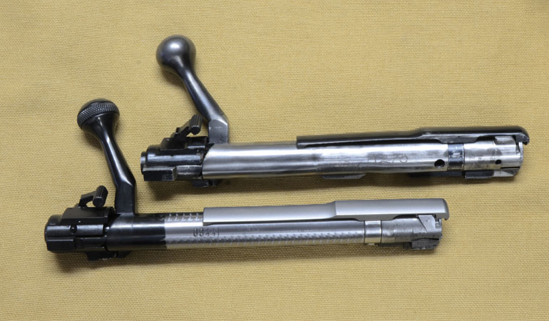

Anyone know of any guide or manual describing how to disassemble and, more importantly, reassemble a Winchester Model 70 bolt?
Particularly, how to remove the claw, the bolt face, ring, etc. Not a field strip.
Rotate the claw around the bolt body until it is out of the exterior guide groove in the bolt nose.
Push the extractor forward off of the spring steel ring.
