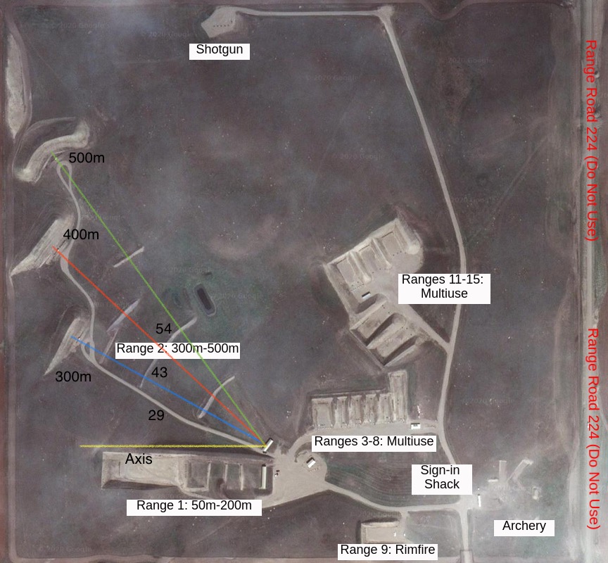

Look at the attached picture of the range. It shows 3 targets: one at 300m, one at 400m and another at 500m. The numbers between the colored lines show the degrees from the “axis” line.
If the wind blows in a constant direction, how much would it effect calculating the wind call for each target if all 3 targets were engaged from the same shooting position?
i am finding that my wind calls are off at 500m and I think it is because I am not taking into account the relative angle of the target when I engage all 3 targets from the same position. My angle in relation to the wind changes but I am just considering the direction of the wind from my initial engagement at 300m. I pan my rifle to engage the targets at 400m and 500m and I disregard the wind direction relative to those targets.
Could this be a contributing factor for the misses I am seeing at 500m? How much of angle/wind speed would require a recalculation of wind (call). Thanks.

Yes. Angle of the wind makes a difference. Depending on the initial angle of the wind to the shooter a fair change could be seen. Note each target is about 15 degrees different from each other, this a 1/2 hour change on a clock system.
Example 1
A 10 mph wind is at 12 o'clock to the shooter when starting on the 300 yard target, This is no wind hold.
Transition to the 400 yard target will need a 1/4 wind hold (wind at 11:30) - 10mph x .25 = 2.5 mph (about 0.2 mil for a 6.5 creedmoor)
Transition to the 500 yard target will need a 1/2 wind hole. (wind at 11:00) - 10mph x 0.5 - 5 mph (about 0.4 Mil for a 6.5 Creedmoor)
If you don't correct for at the 500 yard target you will miss by 7 inches with a 6.5 creedmoor
If you are shooting a light 223 round your could miss by 12 or 13 inches
Example 2
A 10 mph wind is at 9 o'clock to the shooter when starting on the 300 yard target, This is a full value wind hold. (about 0.5 mil for a 6.5 creed)
Transition to the 400 yard target will need a 96% wind hold (wind at 8:30) - 10mph x 0.96 = 9.5 mph (about 0.5 mil for a 6.5 creedmoor)
Transition to the 500 yard target will need a 86% wind hole. (wind at 8:00) - 10mph x 0.86 = 8.5 mph (about 0.4 Mil for a 6.5 Creedmoor)
If you don't correct for at the 500 yard target you will be 1.8" from the center of the target with a 6.5 creedmore
If you are shooting a light 223 your could be 4-5 inches from the center of the target.

Depends where it's coming from. If it's along the axis line probably not going to change your life at those distances.
Like Sheldon said, if it's coming down the 400 in your face and switching back and forth you better be paying attention.
