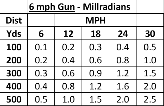

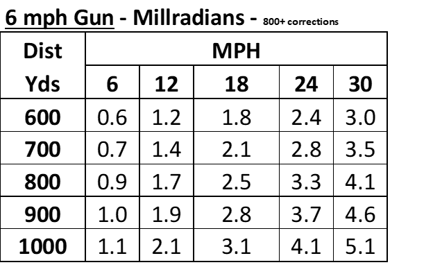

But, have you not found any of the articles on Gun MPH for wind holds. Basically the first digit of your G1 BC is your Gun MPH. In my case its 6 and this is the quick chart for that ammo. At 800 and beyond, add another .1.
If your BC starts with a 7, then the columns would be 7/14/21/etc.
And the velocities are full wind value...i.e. 90 degree cross wind. Use your wind rose knowledge to know cross wind value of your actual wind based on its direction.
Here is one thread but I believe that there are a number of them...search for Gun MPH and see what you can find
