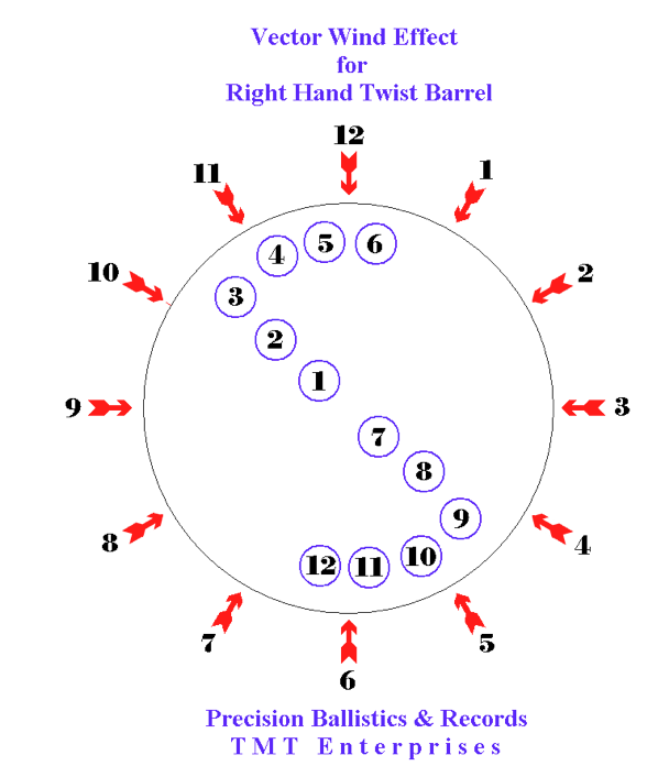

This may be of assistance in reconciling one component of observed wind effects. Screen Shot 2017-08-18 at 1.16.44 PM.png

My Kestrel with Applied Ballistics says it does. Here's data on a 147 ELDM @ 2715 fps. There are significant differences in elevation from wind, and significant differences in windage from spin drift.
1000 yards, 10 mph @ 9 oclock: 8.52 mil Elev / 1.98 mil Left
1000 yards, 10 mph @ 3 oclock: 8.25 mil Elev / 1.40 mil Right
dont count on that ;)
Terrain is the biggest factor effecting elevation.
Wind is like water and Terrain acts like a stream to create turbulence adding to the unpredicatable nature of the movement. (After all it's invisible)
Compare a sandy bottom stream to one full of sticks and rocks, that is what happens when your shooting location as terrain features there or about.
Ditto on the Kestrel, that stuff I turn off ... it's wrong, the real world rarely aligns to those numbers.

The difference in elevation data from 3 o'clock and 9 o'clock wind is built in to David Tubb's christmas three reticle. Just look at the elevation difference in the windage dots at range in the reticle. Spin drift is also accounted for.
