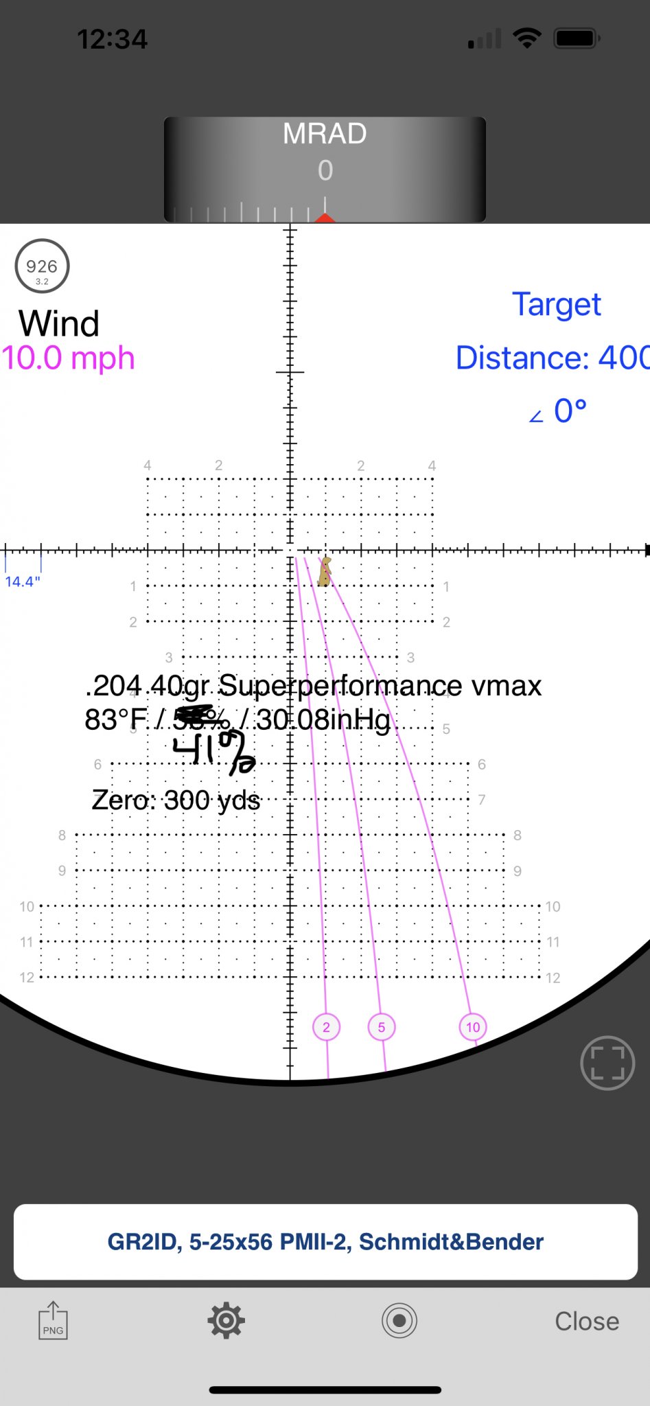

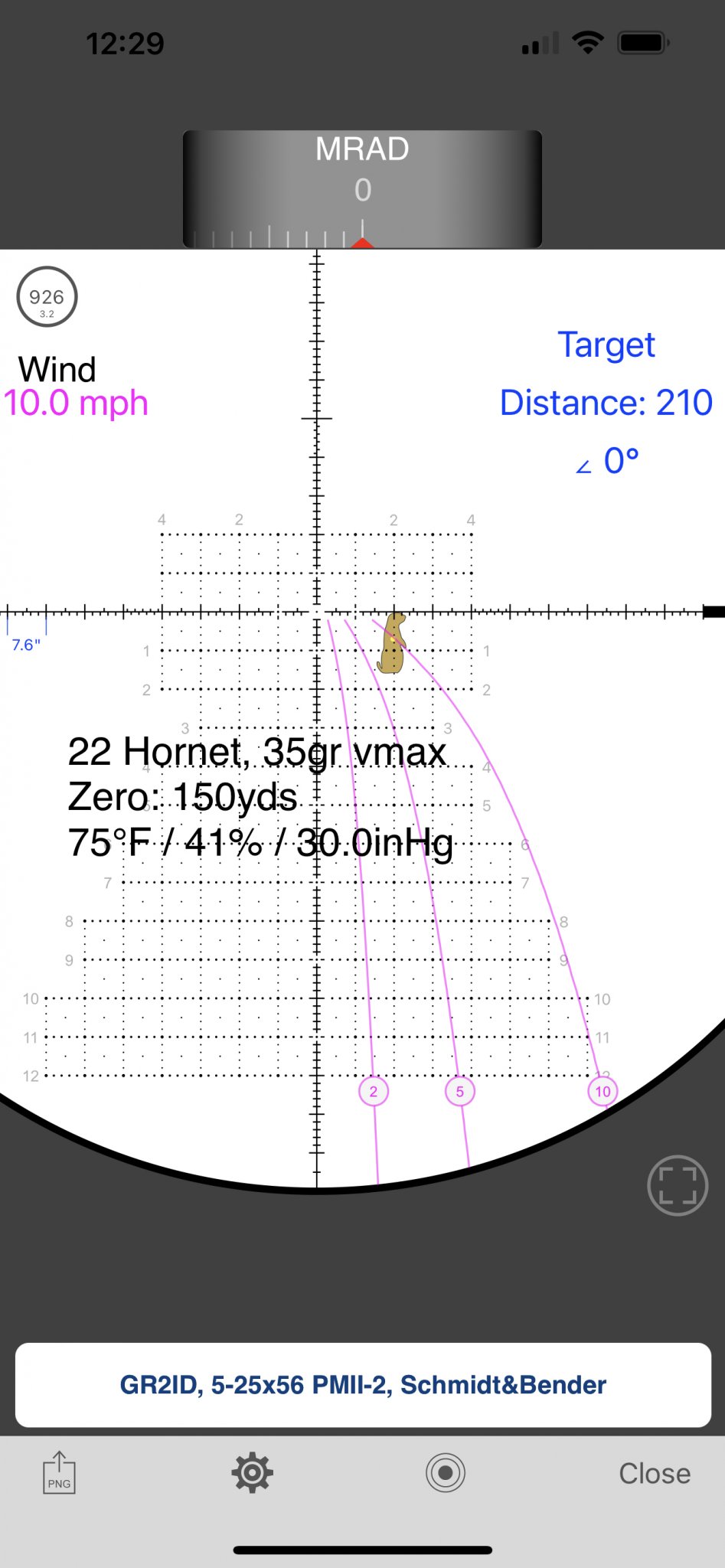

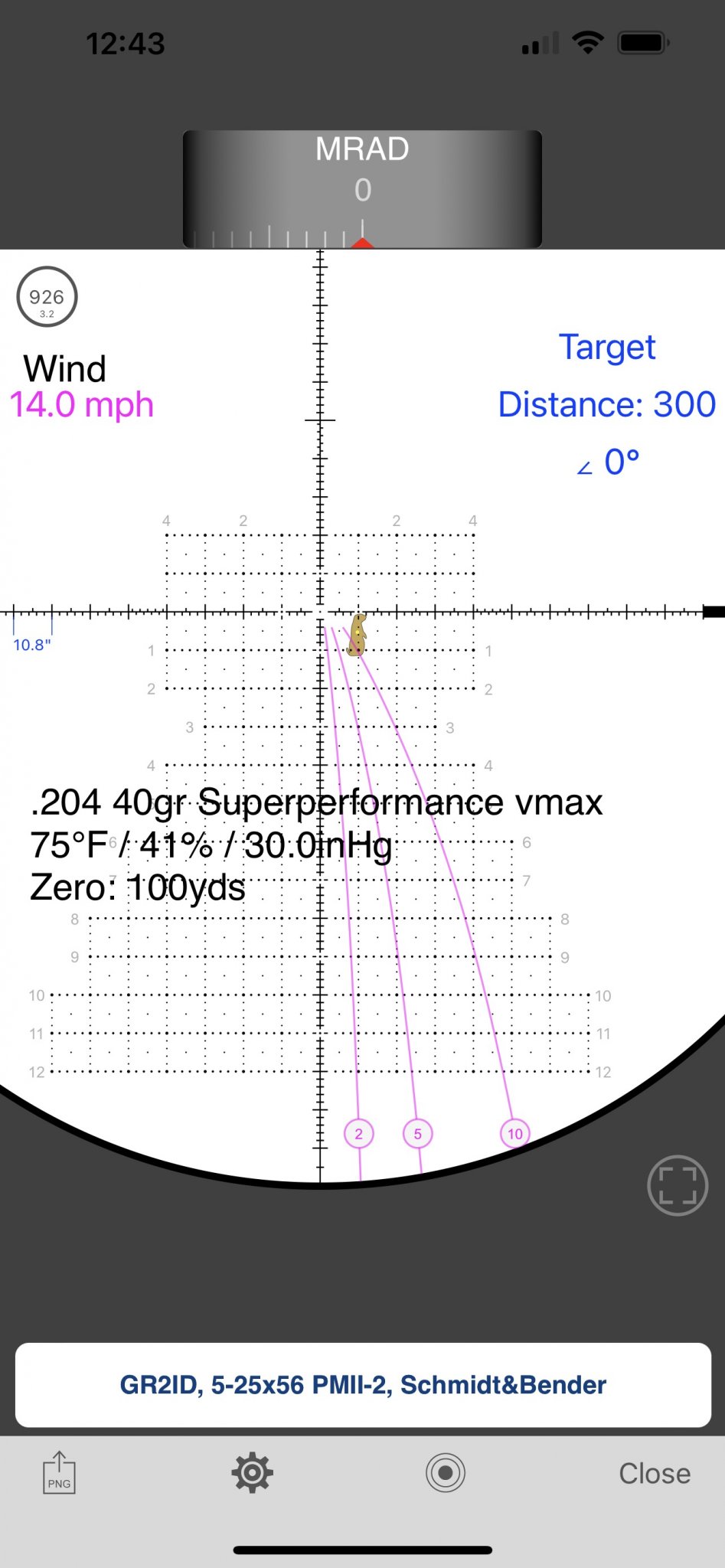

It’s probably because I shoot little(r) weird fast calibers in high winds in the Dakotas and you don’t, I’m guessing. Also shoot 221 FB and 17 Hornet. See below the typical scenarios that I’d run into the numbers overlapping the pdog. I also sometimes run different zeros than 100yds, but the problem can still easily occur with a 100yd zero.
Note I used the S&B Gr2id reticle in Strelok for mockup because the Horus doofus threatened legal copyright action against the app dev so the dev pulled Horus reticles from the app. The grid reticle gives a clear idea on what I’m taking about.
If you try to replicate this in Strelok, be aware that I have different zeroing weather on some mockups but it shouldn’t make much diff.
Leaning towards 100 yds zeros after learning about weaponized math, gunMPH, etc to really nail down what the zero is without relying upon apps to theorize a 300 yd zero or if shooting 300yds IRL, giving environmentals more time to goof with the bullet.
