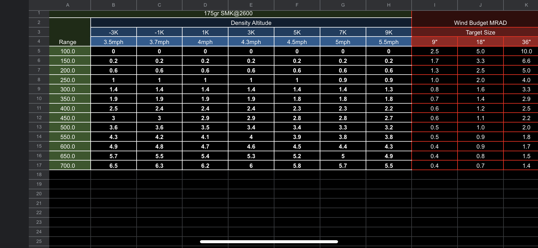

These podcasts got me thinking it would be nice to have a wind budget chart on my “sheet” to understand my wiggle room for various sized targets at different yardages. I havent tried it out yet so well see how it goes next time im at the range. In theory you could use it to determine hit probability for max and min wind speeds. Again havent tried it out yet, see how it goes. Its the red column on the far right.
So looking at the chart in red at 700 yards. i could be off a little less than 2mph on a 9” target, a little less than 4mph on an 18” target and little less than 8mph on a 36” target for my wind read accuracy. Btw this is based on a 4 mph rifle at my home DA. In my dumb brain this would potentially get a touch on target as long as my verticle was good and my inital wind estimation was good. Again i think this is right based on listening to the podcast but we will see
Although thinking about it now should the error budget be the full width of a given target size or half of it? 🙃
Well if you want a center hit then it would be half the size. However if you just want a hit, hold the upwind edge of plate and you have a few more mph of wind (budget) to play with. But the right answer is half the width for a center hit.

Copy that Frank. I guess by playing with the error budget concept on a table, at least it gained me some perspective on probability for varying ranges if I misjudged the wind. Its been neat to learn about all this stuff thank you.
