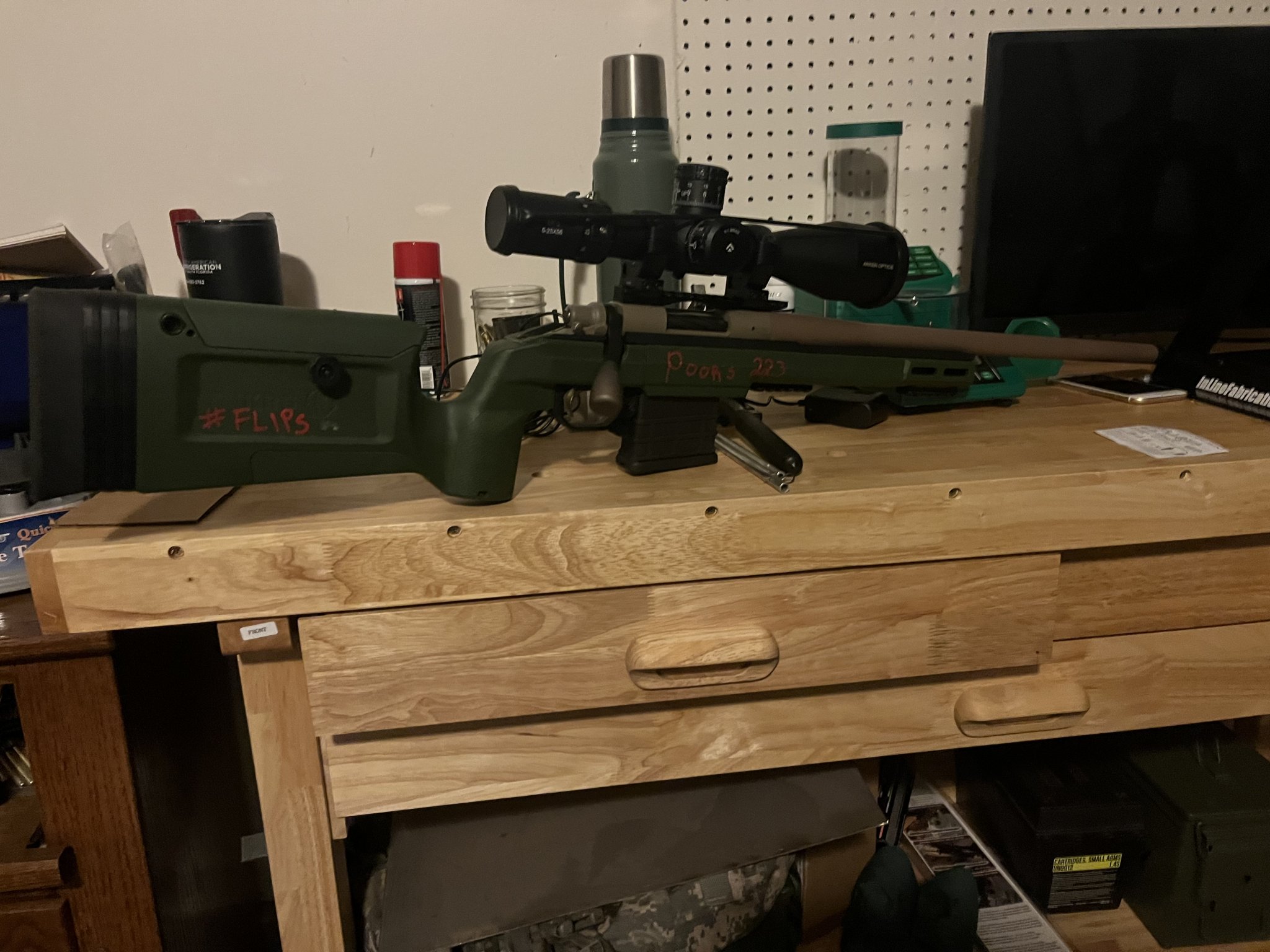

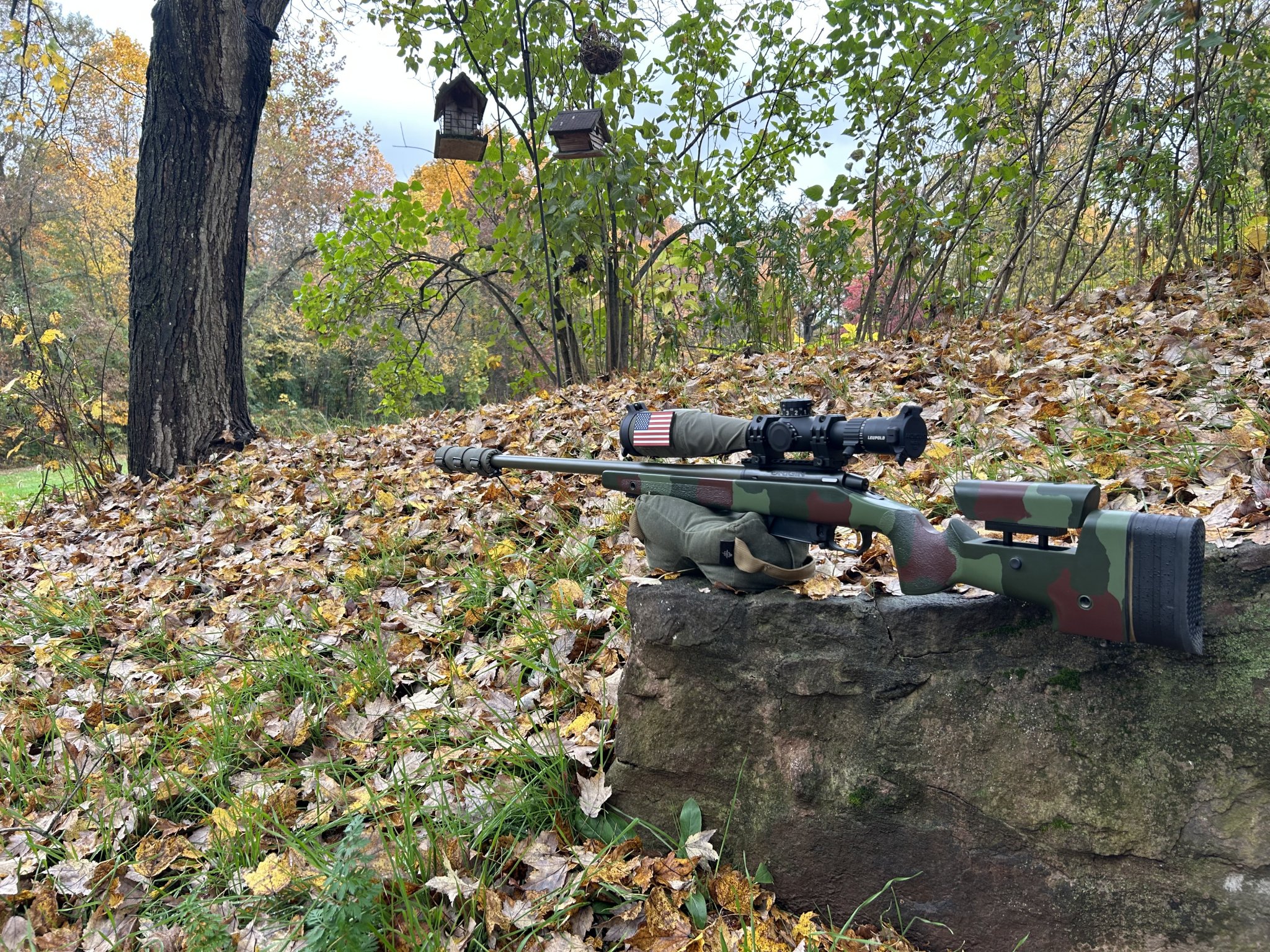

A tikka ctr is the obvious answer here. Here is mine. Its not a factory ctr it just has the ctr barrel. You can leave it stock or you can go crazy like i did. Shoots most loads pretty well but loves the 52gr smk and pounds them 3/4moa or better quite consistently
Nice stock. What is it? Looks like Bob Ross had a seizure on it. I like it.

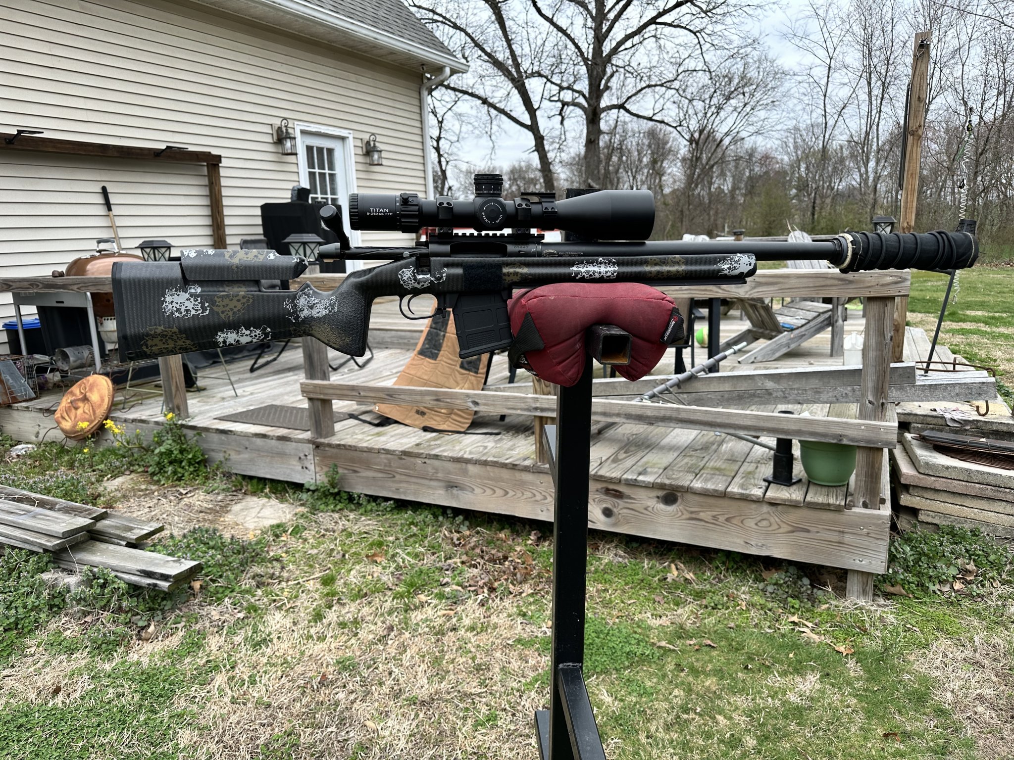

I have bolt guns in 22LR, 223, and 6x47L. The 223 gets shot the most with the 22LR coming in second. They are a ton of fun and you'll be surprised at how far you can go with a good bullet.

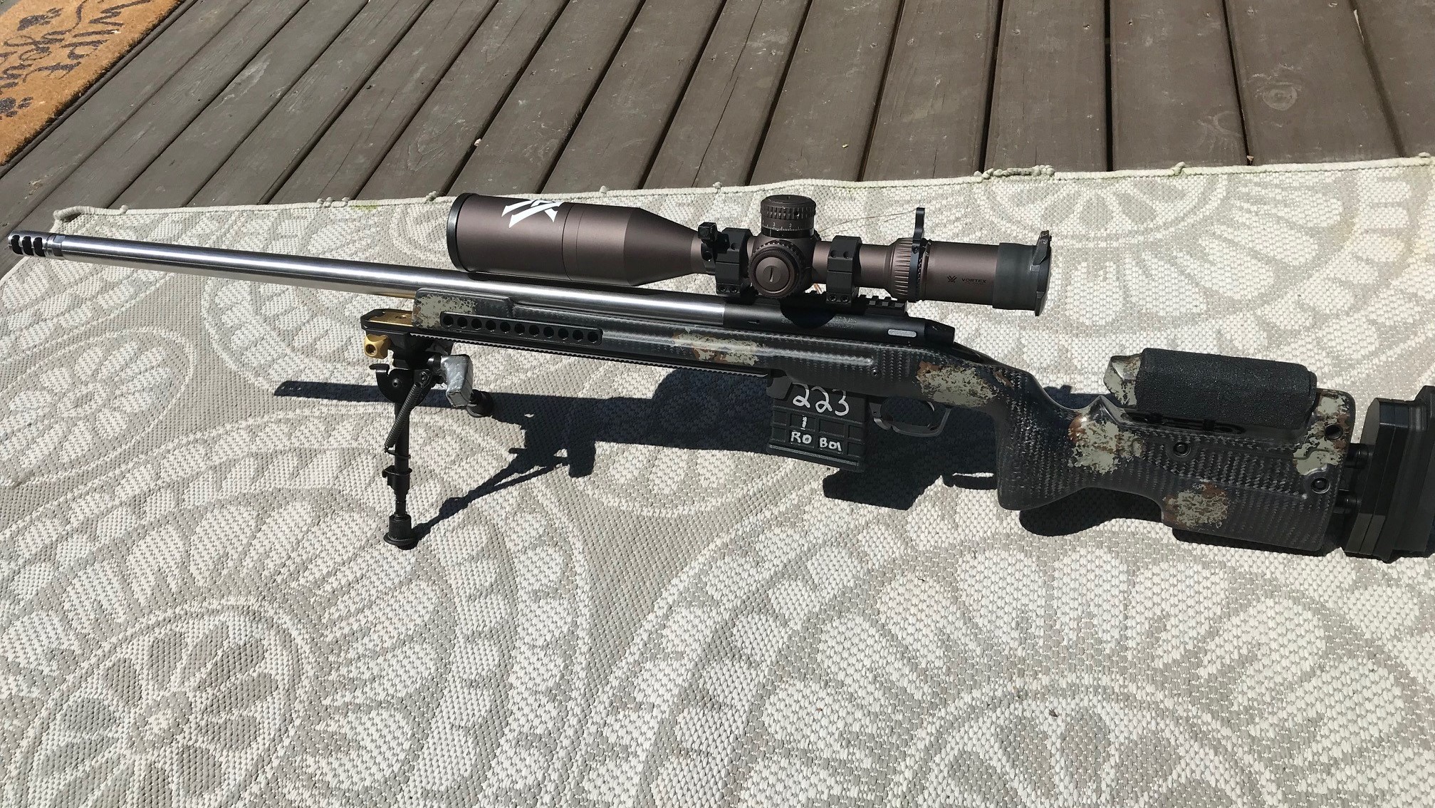

This was my .223 that I swapped a bolt face and barrel on my 6 Creed to put together. Different stck and scope now but same barreled action.

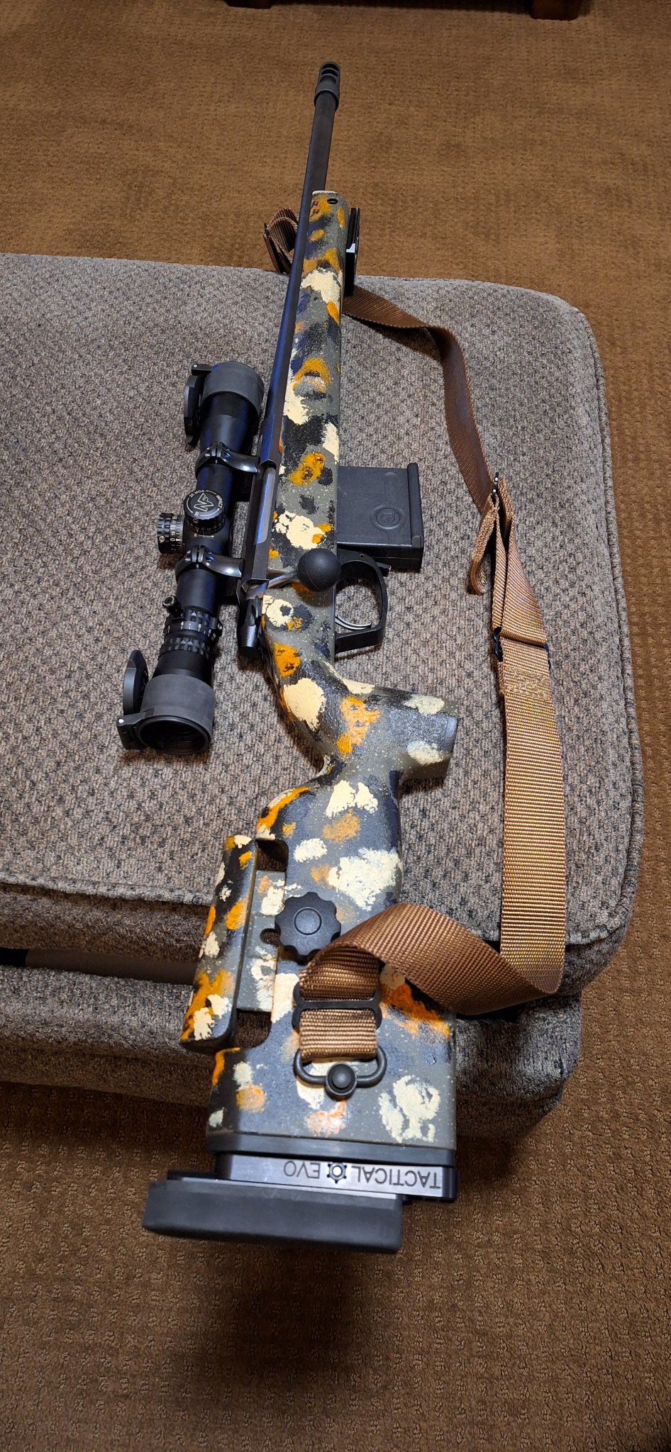

Another origin with pva prefit here. I’ll get a 6br or 6.5 creed for it soon, but I’ll always have a .223 barrel for it. Cheap(er) and fun.
Patriot Valley Arms does great work! All the prefits I have now for my TL3s were done by Josh @bohem and now with the new shop they should be able to get them out faster too. Their Osprey barrels are very accurate! I’d highly recommend them.

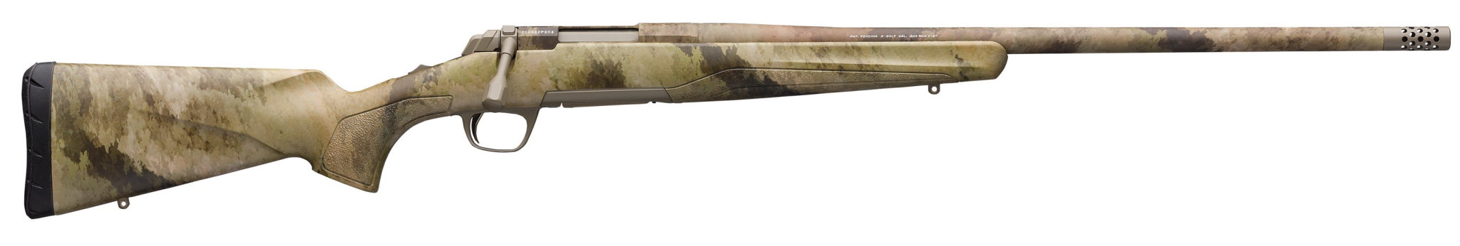

Browning from the website
Both 22" barrels, Browning has a dedicated mini action for their 204/223 rifles, was already threaded 1/2-28, already had aluminum bottom metal. There is tons of aftermarket support for the Tikka, non-existant for the SSA X-Bolt, aside from a trigger spring. No stocks that I am aware of.
