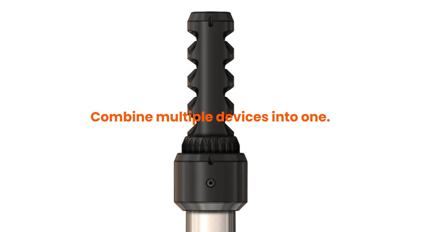

The original four-port 45-degree self-timing, directional muzzle brake with an integrated 24-position, adjustable and locking harmonic barrel tuner, that simply threads onto your muzzle like every other self-timing muzzle brake on the market currently (tuner body fits over the barrel and requires no modification to barrel), just got better with the Generation 2.
Industry leading recoil reduction. Outperforms the industries best by a minimum of 10%!
Generation 2 changes include; 3/4x24 thread option now available due to change in diameter of threaded interface between brake a jam nut, removed top ports, tweaked side ports to compensate for removal of top ports, tuner moved closer to muzzle for more influential movements of the tuner and new re-designed spline-drive tool, as well as other manufacturing and back of house changes.
For more information check out the WITHOUT WARNING website.
https://www.strikewithoutwarning.com/
AISI 4140 Alloy Steel with corrosion-resistant and hardened black satin nitride finish.
Fits contours up to and including benchmark VCC contour barrels (1.05 inches in diameter, 1 inch behind the shoulder) with a standard 5/8x24 UNEF 3A or 3/4x24 UNEF 3A threaded muzzle and up to 0.75 inches of thread engagement. Will not fit threads that have been matched by a gunsmith to a 5/8x24 UNEF 2A threads. (Do not do this, it limits your compatibility with other products.)
Works with all calibers up to and including 338 caliber magnums. (Provided brake is appropriate caliber.)
Comes with torque wrench compatible spline-drive tool for installation and hex tool for 8-32 set screws. (Torque to 25 ft-lbs, if you never want it to come loose during a match or hunt.)
1 inch diameter muzzle brake, 1.58 inch diameter barrel tuner,
4.33 inches long, 2.77 inches added to barrel length,
Weighs 11.5 ounces.
No nonsense lifetime warranty.
Patent Pending.

In the picture it looks like it might have top ports along the entire length of the brake, but don’t see them on the renderings, just the forward pair. Could you confirm? Thanks.
I know it comes off as kind of vain to be worried about looks on a rifle that is about pure performance, but have to say this one looks visibly the best out of the recent options, to my eyes anyways.
Yes that’s correct. Apa was granted a patent for that style of ports after that prototype was made so I had to remove them and redesign the brake.
