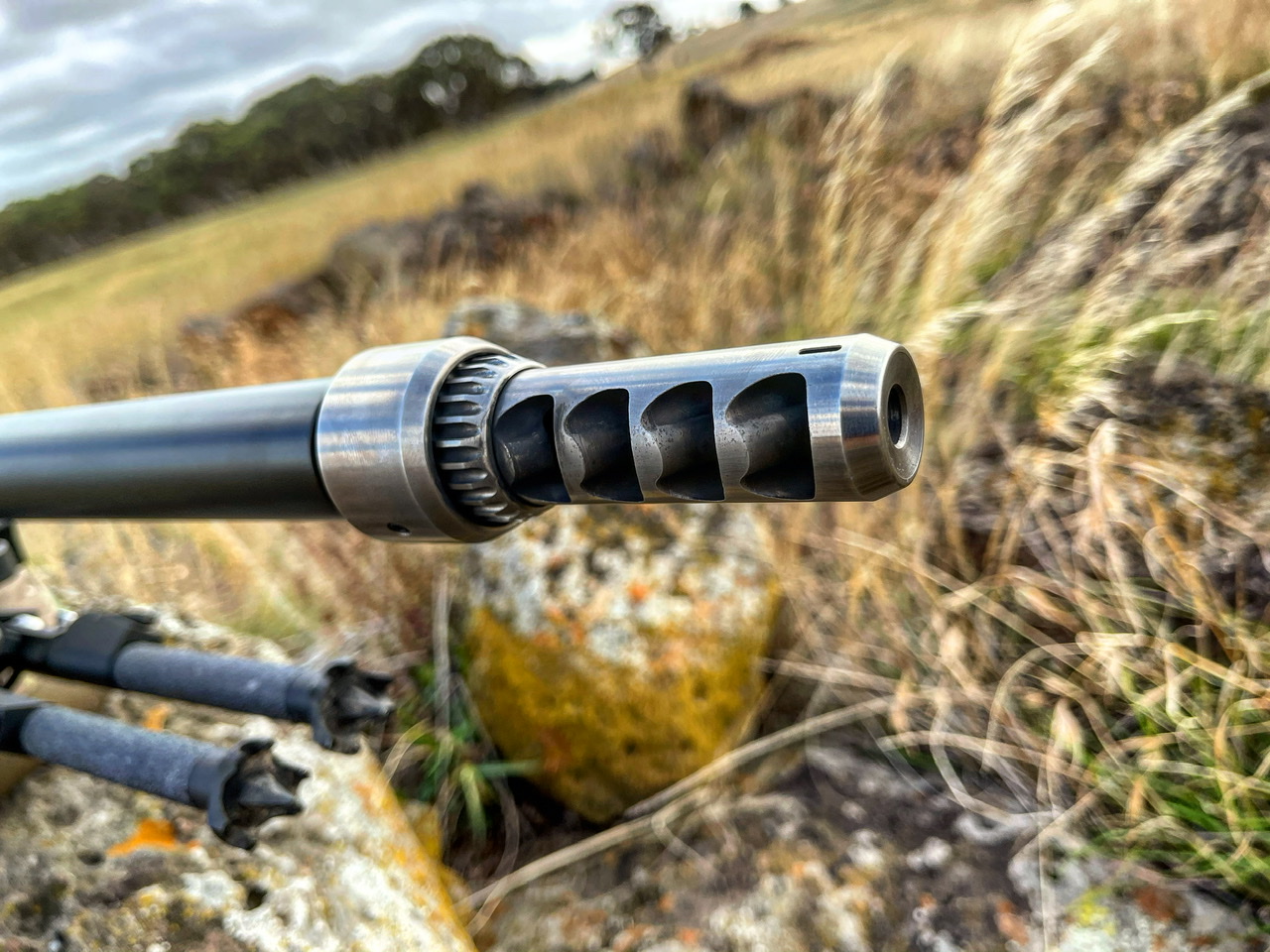

I set out with the intention of making the tmb the sphur of the scope mount world. Overbuilt, full featured, modular and adaptable (which I’ll be announcing soon), premium offering with no compromises.
I didn’t want any laser etching, I wanted all the markings machined into the device so they couldn’t be scrubbed off/be removed with cleaners or get coated, which also meant I needed to make a proprietary tool to include with it to install the device.
The tuner had to be able to lock in place which meant 24 machined valleys under the tuner for the set screws to lock into.
The muzzle brake had to perform as good or better than the other top offerings (so you weren’t compromising on the brakes performance just to get a brake/tuner in the one device) and that meant complex internal geometry to beat the top brakes I was testing.
The design has only angled edges with a smooth radius so that it glances off of objects if it’s hit on things.
It’s also nitrided to increase its wear and corrosion resistance.
So there’s a lot more going on with the tmb and I think because of that the tmb would cost twice as much to produce.

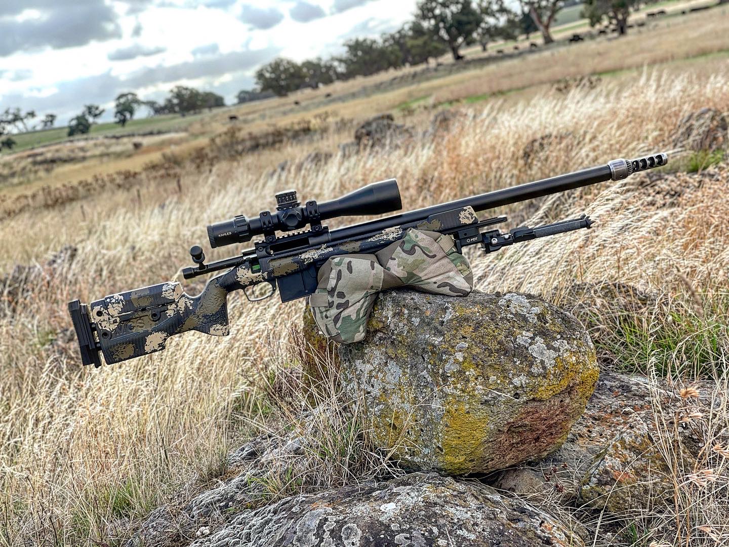

First prs match of the year for me was today. The tmb worked really well, hardly any recoil, hardly any muzzle rise, easy spotting shots. Everyone that tried it out really enjoyed it.

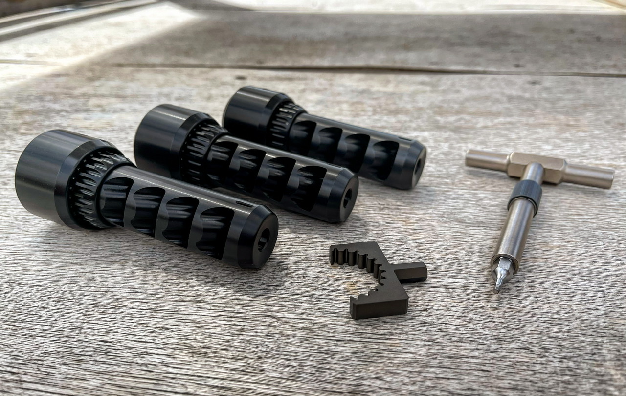

Manufacturing samples are finally in.
Few small things I had asked them to tweak so you guys are getting the best product possible but very happy with them overall. Can’t wait for people to finally get them.
These ones are headed out to reviewers/pro shooters so look out for feedback from some trusted sources on the tmb soon.

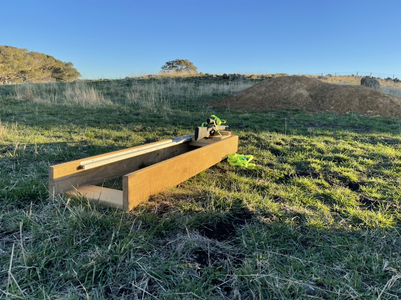

Recoil test video is finally up.
Rifle used for the test was a 16 inch 308 firing federal gold medal 185 bergers.
There will be a follow up video soon with the focus on muzzle rise and staying on target and what it looks like to the shooter to use the best performers.

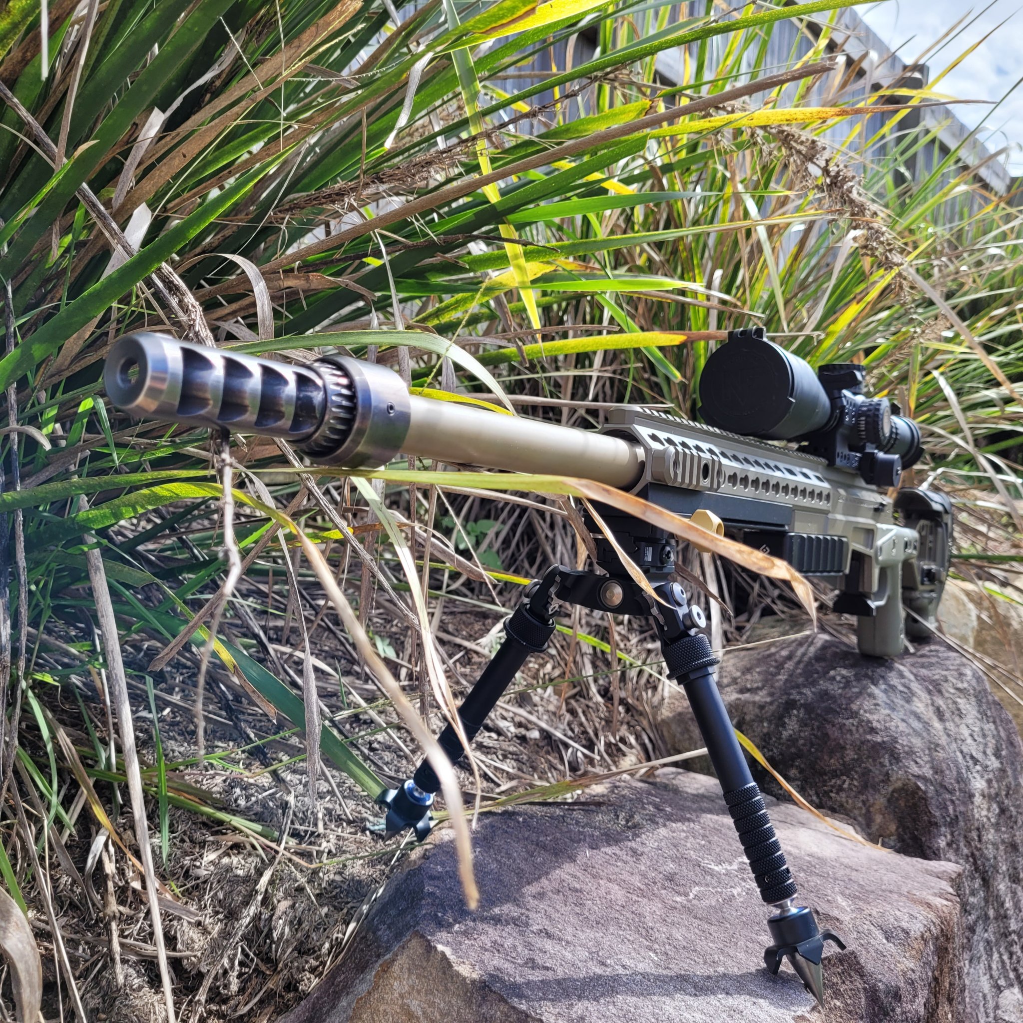

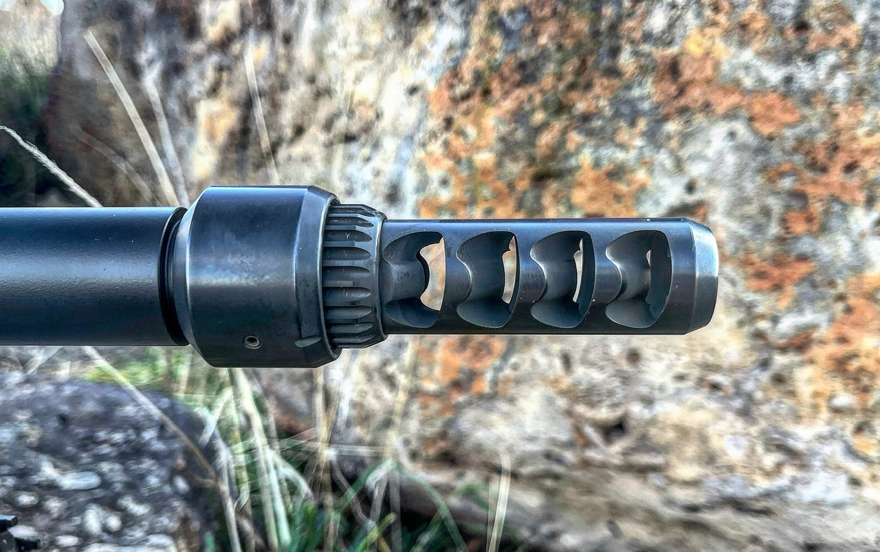

BJ was good enough to send me a prototype TMB to test and evaluate at an upcoming PRS Australia match. It is a very well made unit and very solid. Im far from the best shooter or reloader and hoping the TMB helps me get the last little bit of precision I'm looking for from my system. The rest is on me to not be shit and perform on the day.
I'm going to the range tomorrow to dial in a load and will report back followed in a couple of weeks by a full independent review.
Here the TMB can be seen on my Accuracy International AX with a Bartlein 6.5 Creedmoor barrel which was spun up by APRS down here in Australia 🇦🇺.
Very happy to support another Aussie company.
Cheers,
Craig

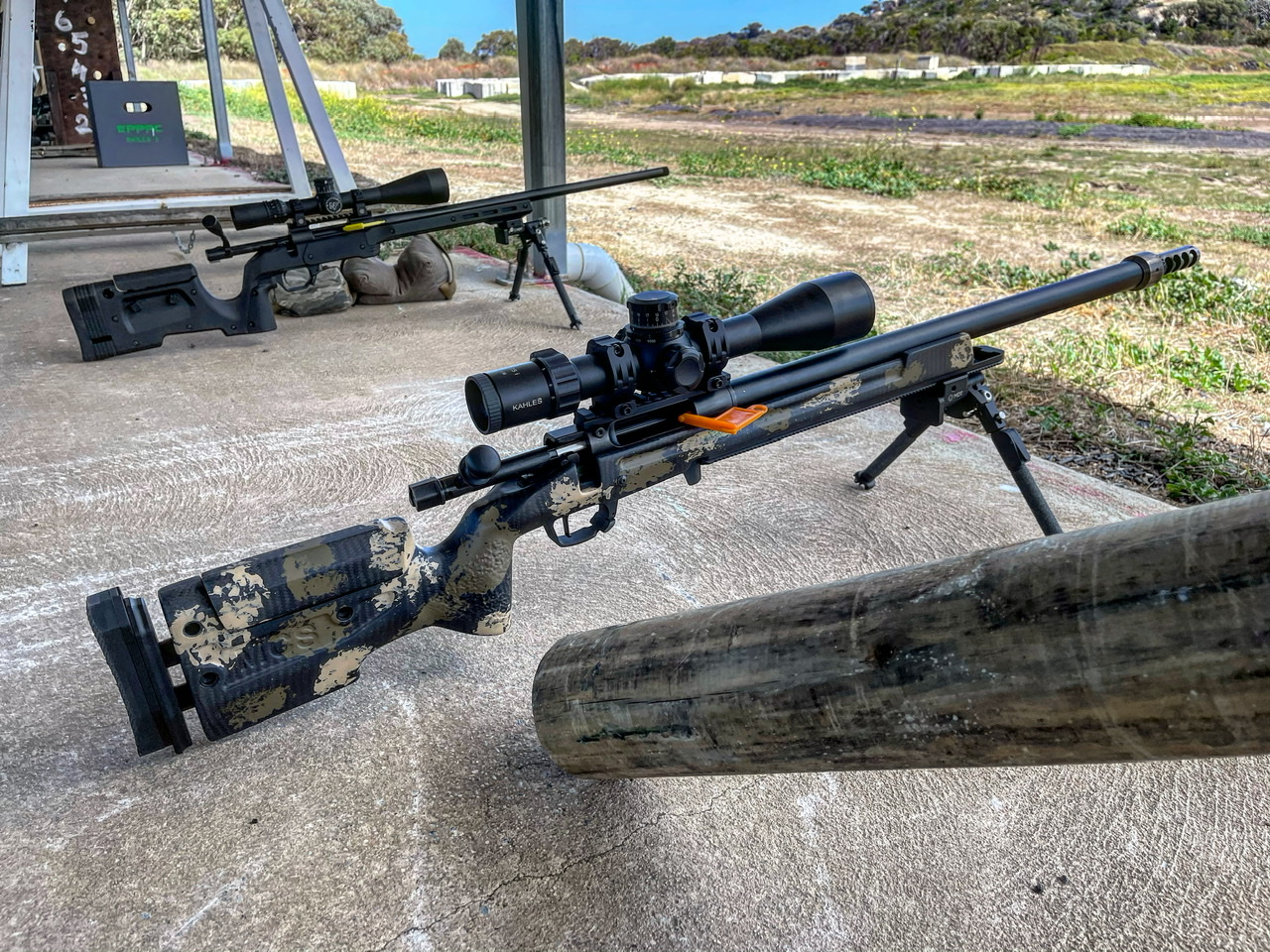

The tmb and its 4oz tuner is optimised for heavy barrel contours and even works well on carbon barrels.
The bergara hmr pro I bought just for those load development videos that can be found on the website/our YouTube really worked well with the tmb and its barrel was quite thin. I think they run a number 6 contour.

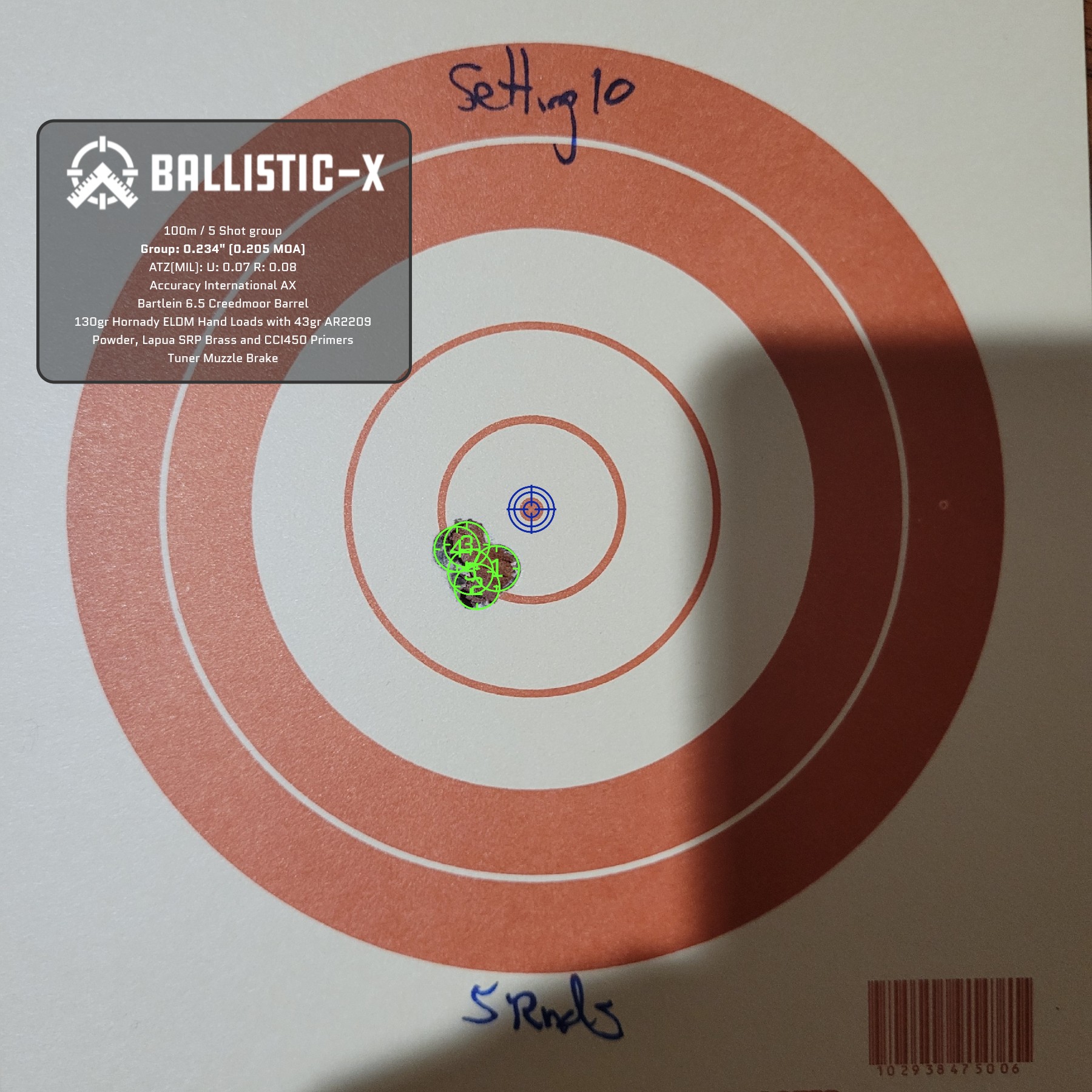

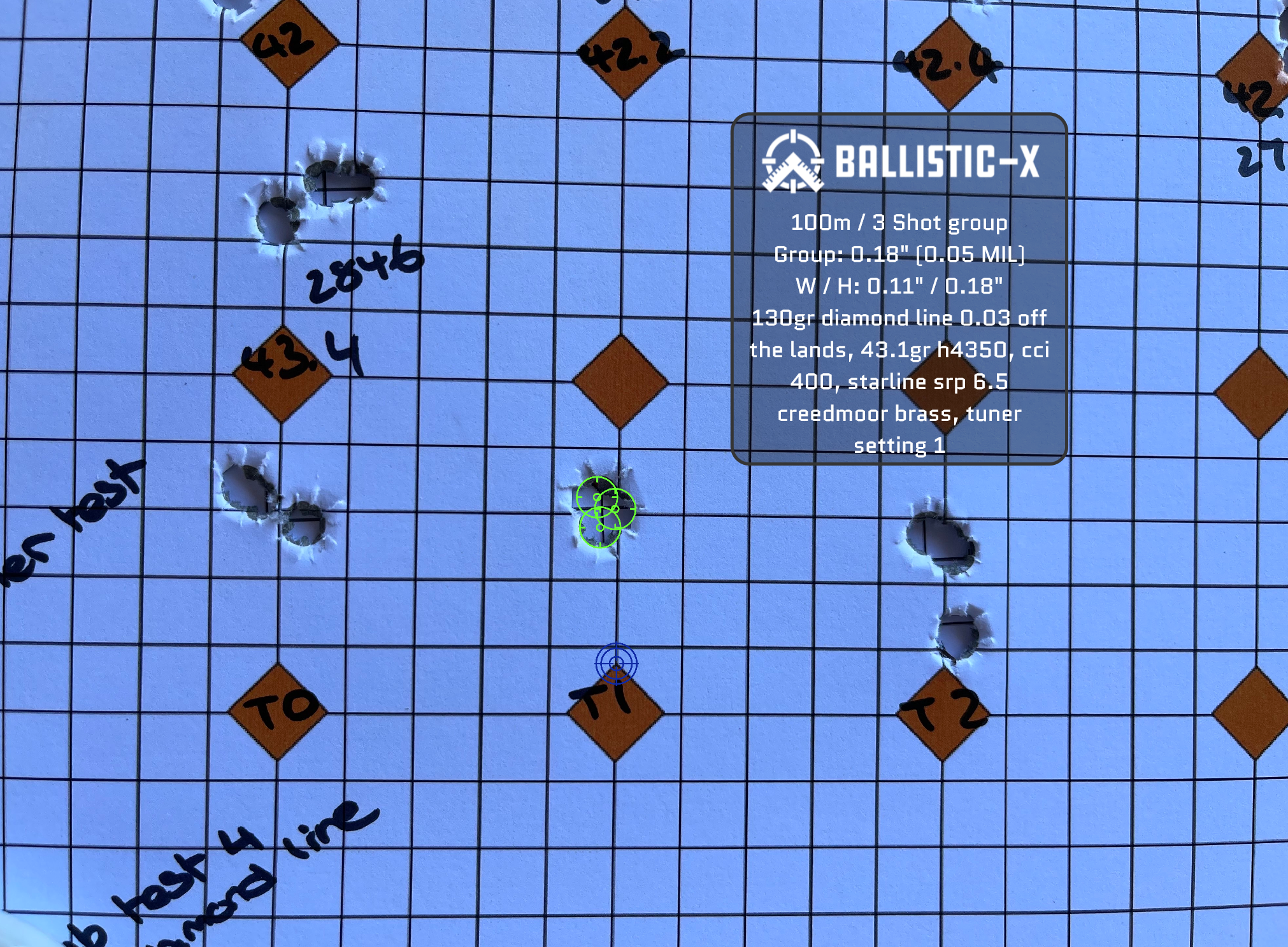

Today I had a chance to shoot a TMB on my AX with Bartlein 6.5 Creedmoor barrel.
The load I was shooting was made up of the following:
130gr ELDM
Lapua SRP Brass
CCI 450 Magnum small rifle primers
And
43gr of ADI AR2209 Powder (H3450).
Ive got to say I'm impressed so far.
Previously I had done an OCW test through this barrel for this load. I found a velocity node at the 43gr stated above. I loaded up a bunch of that and set to work with the TMB as per the instructions.
Setting 0 as the control group and worked in increments of 2 up to setting 16. I found 2 nodes at setting 2 and setting 10. Checked the two nodes again and settled on setting 10.
It is interesting to dial away from a node and fire groups then come back to it and find it landing in the exact same pattern as before.
Pictured here is setting 10 with a 5 round group. This is repeatable over and over again. Now to take it to a PRS match.
Further, I shot this off a bench with bipod and rear bag single loading due to some pretty terrible range rules. And I never shoot well from the bench compared to prone.
The group is 0.205 MOA as measured by ballistic x. It is 0.464 inch edge to edge.
Ballistic-X-Export-2021-05-20 20:30:55.945419.jpg
130gr ELDM
Lapua SRP Brass
And
Excellent result mate! Love it.
