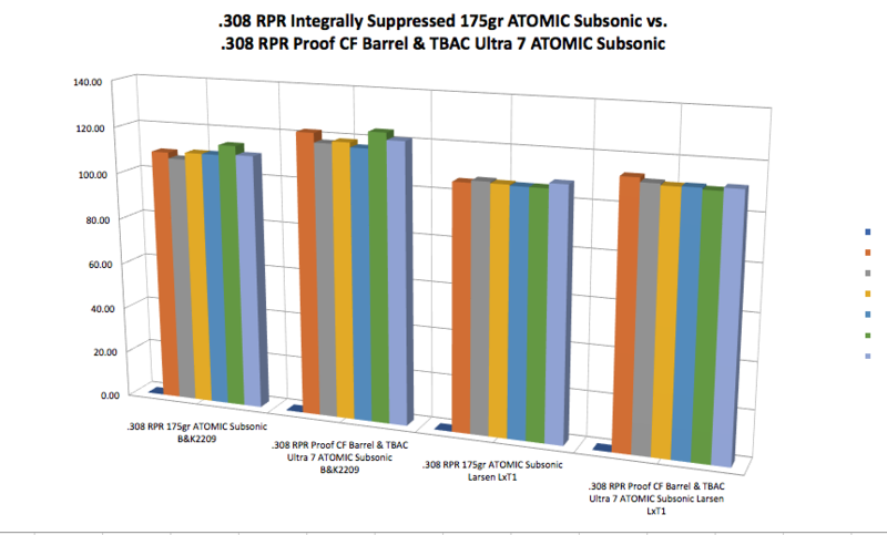

The subsonic round are quieter than most 22lr tests out of bolt guns, The supers are quieter than anything I've seen. I get that it has a large volume but something seems amiss. Were the meters calibrated before and after? I know TBac knows their stuff so I'm hesitant to question much on protocol but thats 6-8 dB less than 22lr with the quietest screw on cans and subs.

Both meters were calibrated, the TBAC was just certified and the Larson had the calibration unit too.
It's volume ... it's a lot of can, and that volume quiets things down. The trade off is a lot of can, and uncovered you get a lot of mirage if you shoot too fast.
It's not voodoo... it's volume.
I purposely asked them to bring RayDog in to help, as I know TBAC knows their stuff and I had used their Meter with them before. The numbers are solid, and were consistent
The difference between an Ultra 7 and the Witt was about 12db when you consider it's 3x more volume with a Witt it makes perfect sense.

I think it's safe to call foul, but this isn't rare. Stick to third party testing if you want comparable, mil-spec data.

We learned a couple things. The QRP meter as tested is no good for gunshots and the integrally suppressed RPR is pretty quiet. We can get together again and do some more testing.

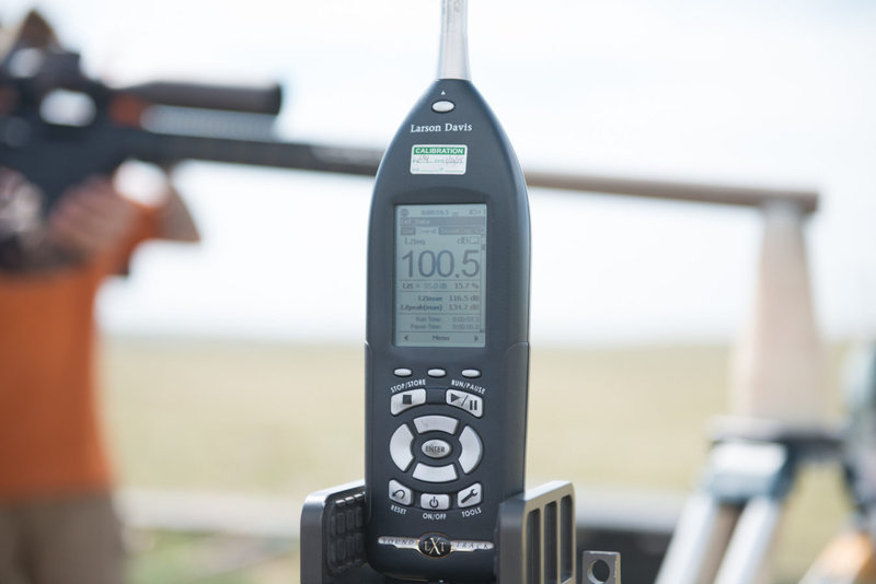

Just a small point to make here (I'm not commenting on the validity of the data in this case; I wasn't there) - it's completely possible, and even very likely, for data like this to be consistent but wrong. Poorly calibrated equipment for example will usually give consistent but wrong data. Again, not saying that's what happened here, but consistent numbers are not an indication that they're correct.
Could you clarify what that means for the data above? Are those numbers bad, or was a different meter used besides the QRP?
I admit to being skeptical as well about some of those numbers, especially the stuff around 100 dB since dry firing is often louder than that.
There is some serious tedium and expense in metering cans. For instance, the duration required for the meter to read. Shorter than mil-spec, your numbers will tell you the can is louder than milspec would. Longer than mil-spec will tell you the can is quieter than mil-spec would. There's also the mic specs.
No anger towards TBAC or Witt from me. Just saying to trust 3rd party testing if you want repeatable, comparable results. Mil-spec testing getting 100db out of any gun would blow my mind. 22 shorts, even.
The common thread here is, the meters were not calibrated, ... that is story line with the guys not recognizing the volume of these cans

The numbers are the numbers, just because they meter different than your typical 8" can should be a given, this is 3x more volume on display

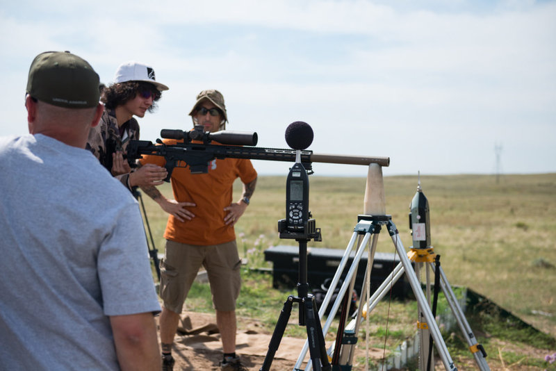

Two meters were used together
21082791_10155642438937953_3306152323436999828_o.jpg?oh=aa4116e46be43011014c68fc6199ddb3&oe=5A...jpg
Two meters to compare the numbers, each meter was recorded and we saw some variations between the two,

I don't have a dry fire number from the same position in front of the muzzle,
There is a difference between sticking a meter at the receiver vs at the muzzle
It's not this is "quieter' it' the measurements are from a different location, guys are doing the snap check at the ejection port
