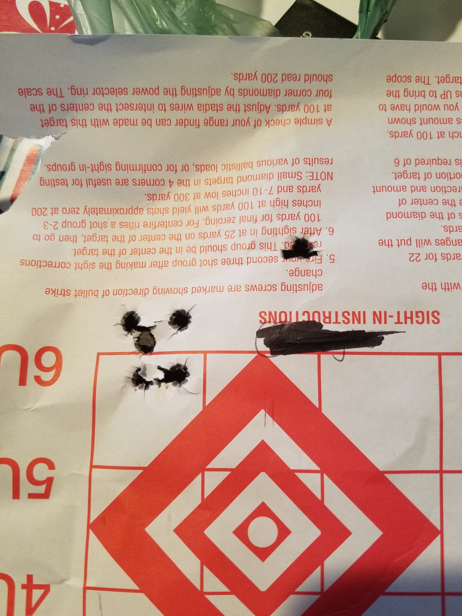

I have been trying to find an accurate load for my WOA SPR 18 inch barrel but am having no luck. Best loads have been around 1.5 MOA at 100 yards. I am starting to get discouraged, so I thought I would ask and see what others are thinking.
Vortex 5-15x
RRA upper (from last build, ~4000 round count). Lapped with a PTG tool
chrome BGC (from last)
WOA 18inch 1/7 rifle length gas
JP adjustable gas block
Silencerco ASR brake
Geissele Trigger
For loads I have been using 77SMK and 77 Nosler CC paired with Varget and CFE223. I have been aiming for 2650-2750 FPS. My last test of 3 5-shot 100yd groups were 1.4, .8, and 1.7 inch. 2720fps 15.6 std dev. I know I could try different powders, but I have stock piles of this to use up.
Also, when I throw on my Saker 7.62 the groups open to ~3 inch at 100 yards.
Going to try a different BGC since that’s an easy try, perhaps it just doesn't like this bolt
Any ideas or am I chasing accuracy that’s not going to happen with this barrel and bullet? Just looking for closer to 1MOA consistency, nicer 1MOA with the suppressor.
Thanks.

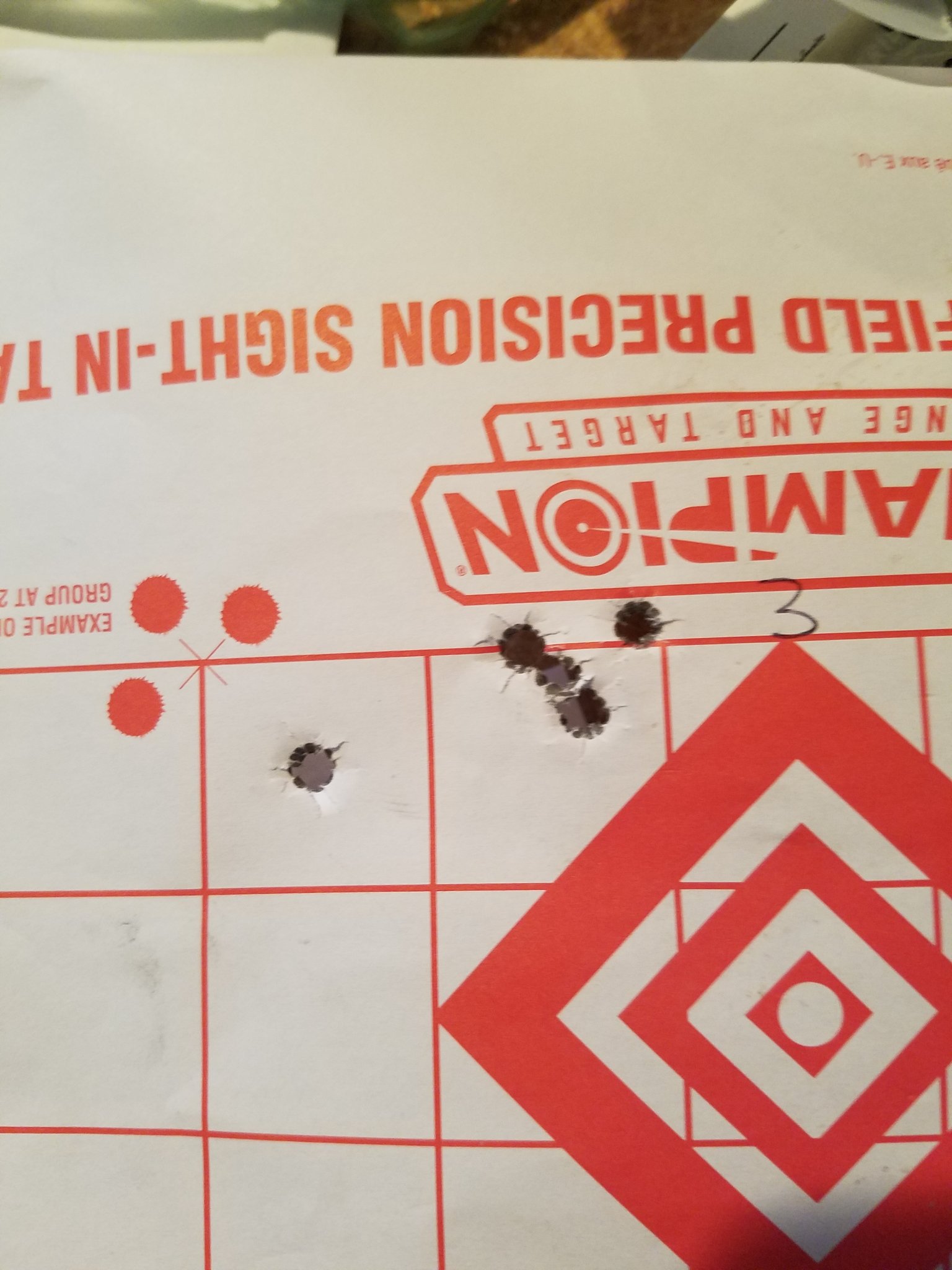

Thanks everyone for the help and suggestions. I tried backing it down a little and seating the Noslers in a bit. Best results so far, well if I don't count flyers. :rolleyes:. 2660fps. I agree and am not one to dismiss technique or fundamentals, always room for improvement. Either way I think I am going to stick with this for now, Its not match quality brass prep anyways. I have a lot of CFE223 and 77 Noslers to burn through.
Going to test some Black hills 77gn soon and see how it groups with the suppressor.
