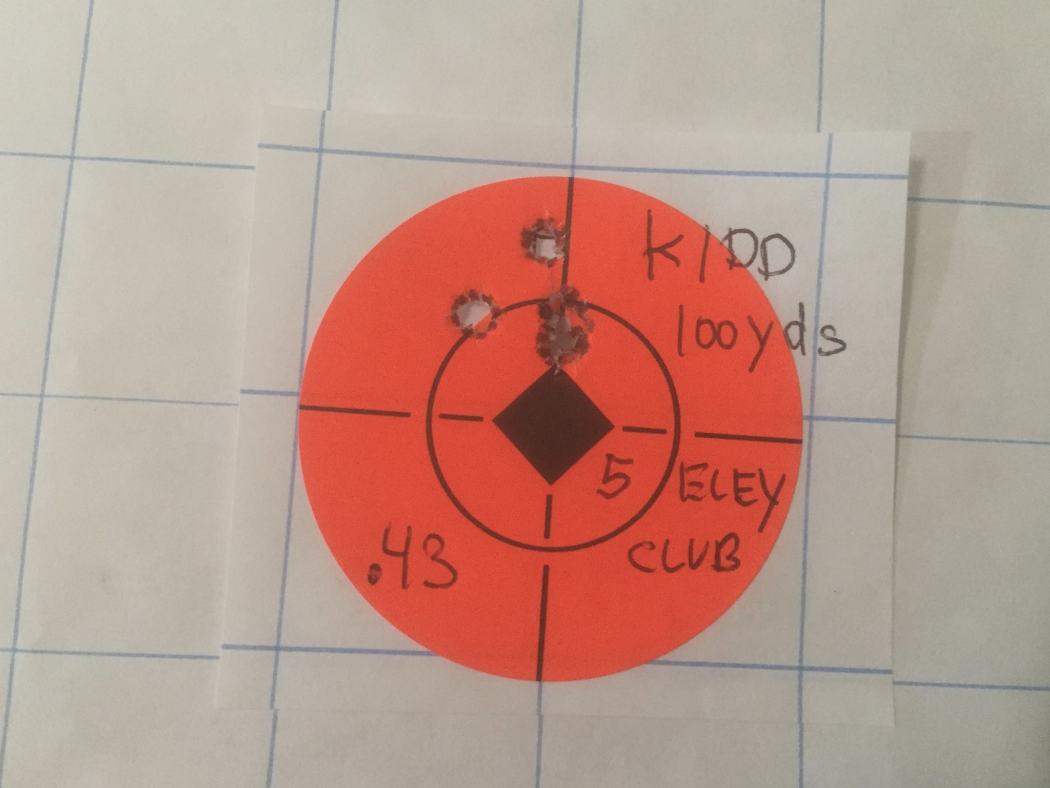

status, but their lower grades like Club didn't shoot well in my 40X
My KIDD 20" straight taper barrel likes ELEY Club. This group is from 100 yards. Mostly get this kind of group at 50 yards. ELEY Club has been very consisted over several different lots and shooting sessions for groups.
