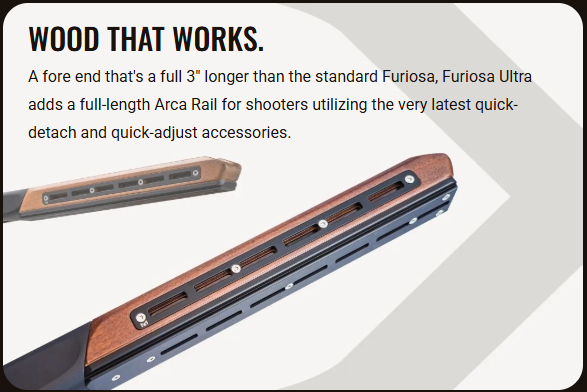

Why not just get their ARCA Forend from the Furiosa Ultra? You can mix and match any forend and buttstock combo they have available. You might have to call or email to get the exact setup you want, but they're very responsive about it.
Reactions: Big Phish
I have a Furiosa, got it before the ultra came out. It's pretty tall with an arca rail under it, get the ultra forend if you want an arca rail. It's also a bit tail heavy unless you have a heavy barrel
