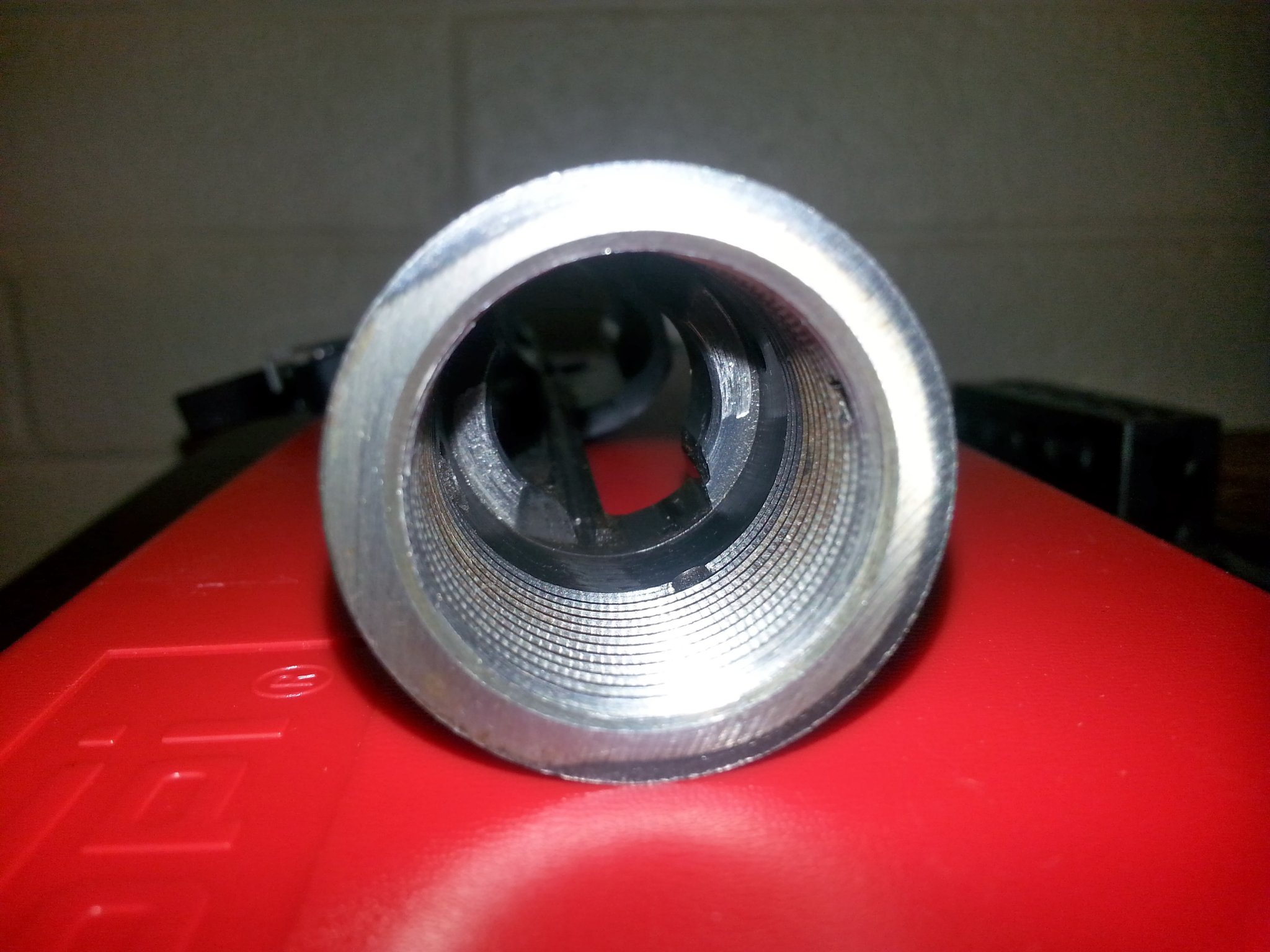

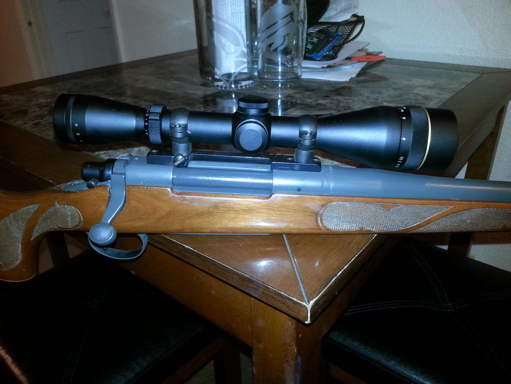

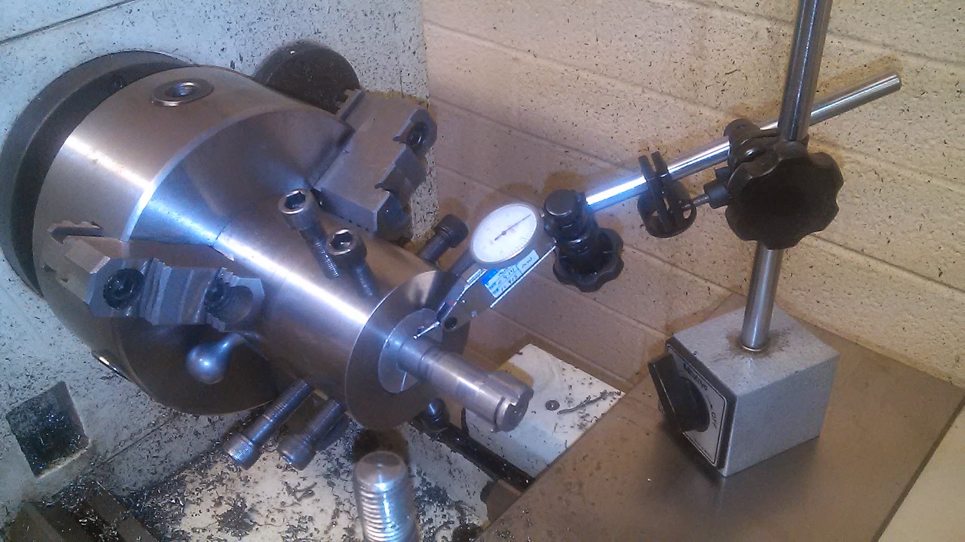

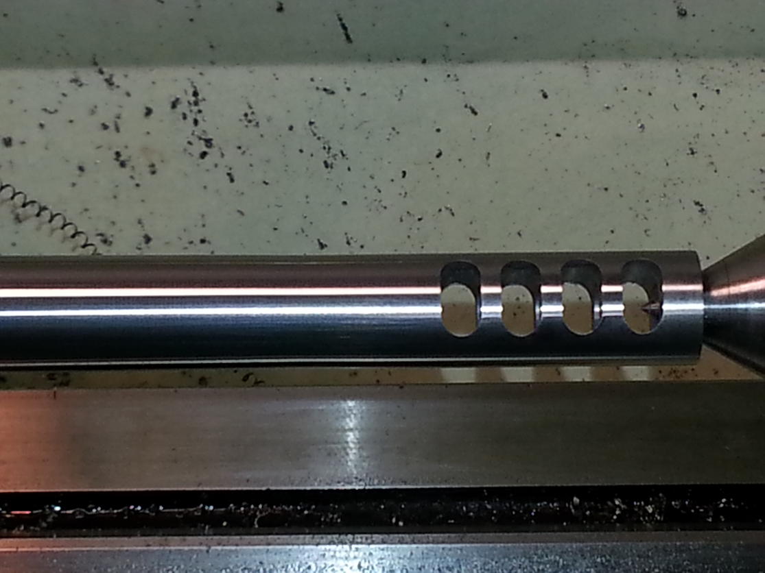

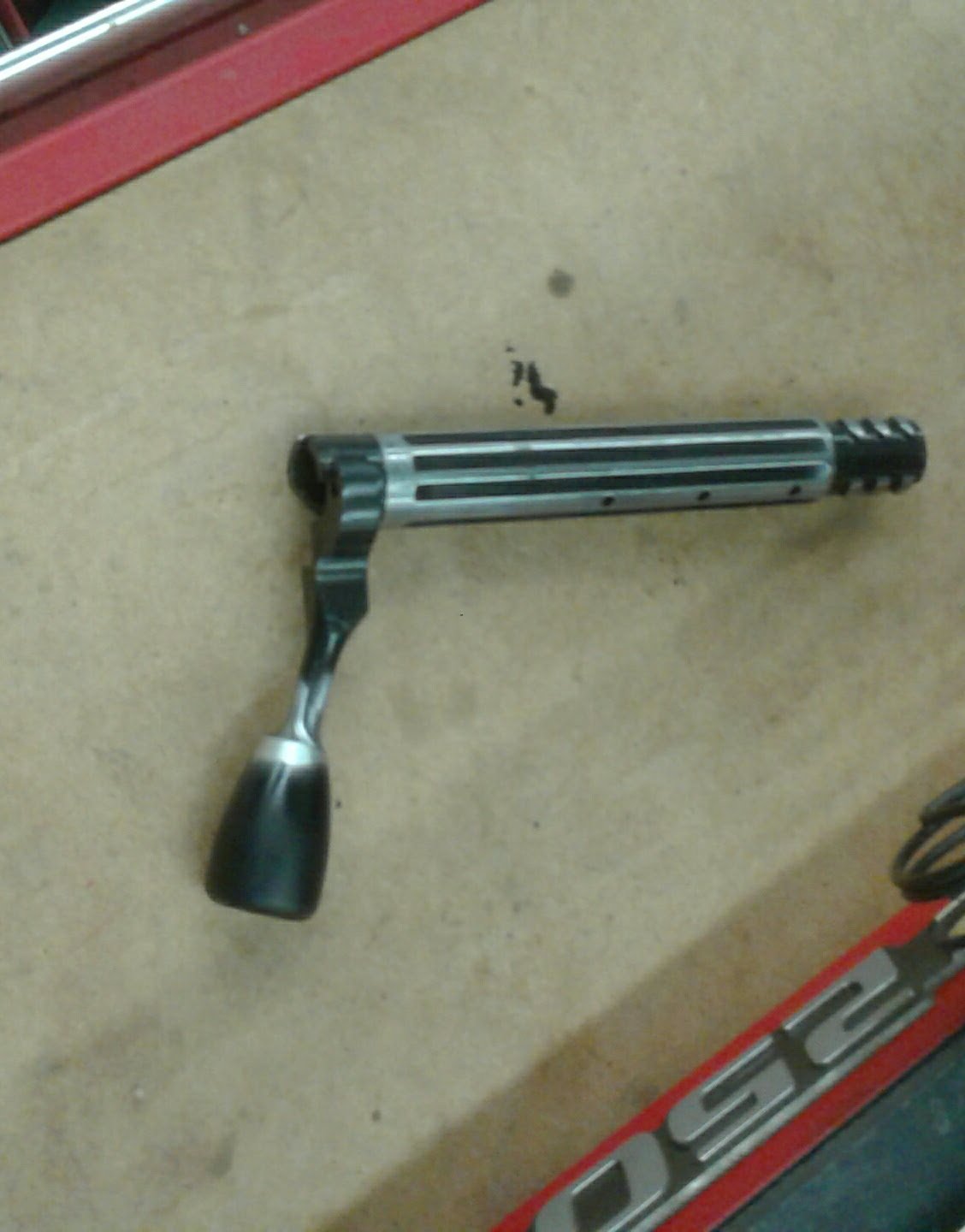

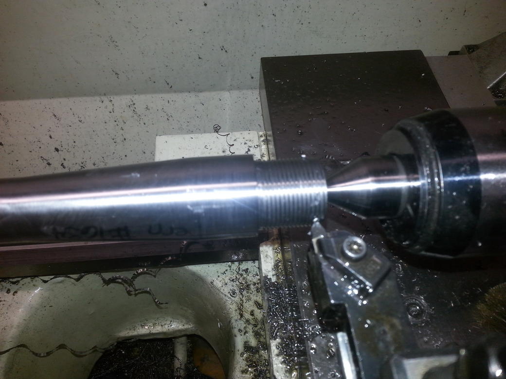

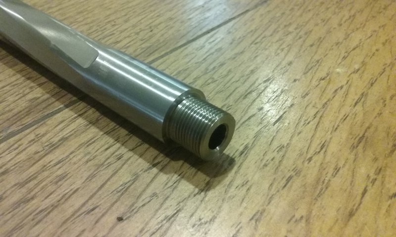

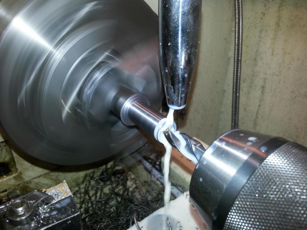

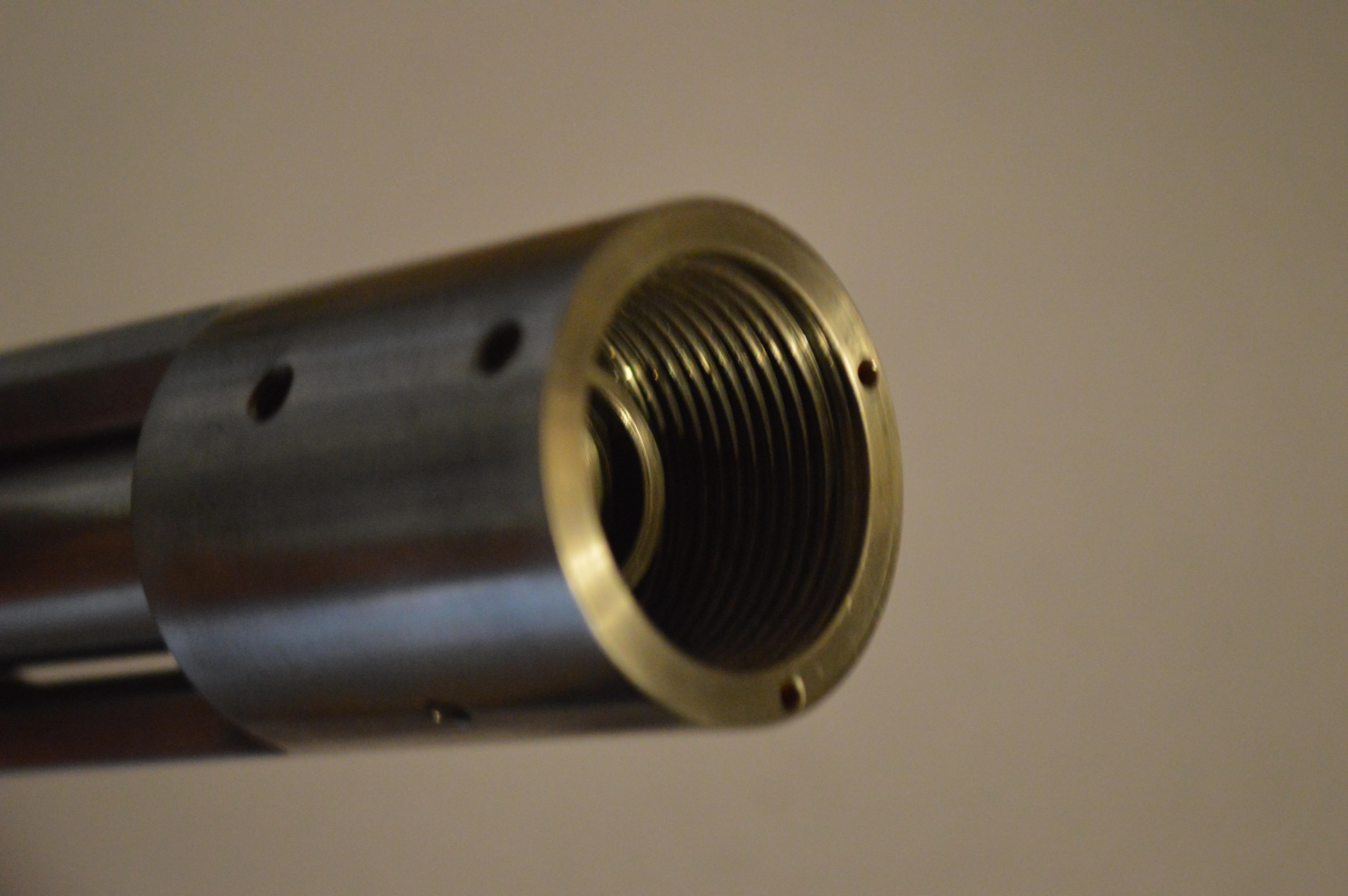

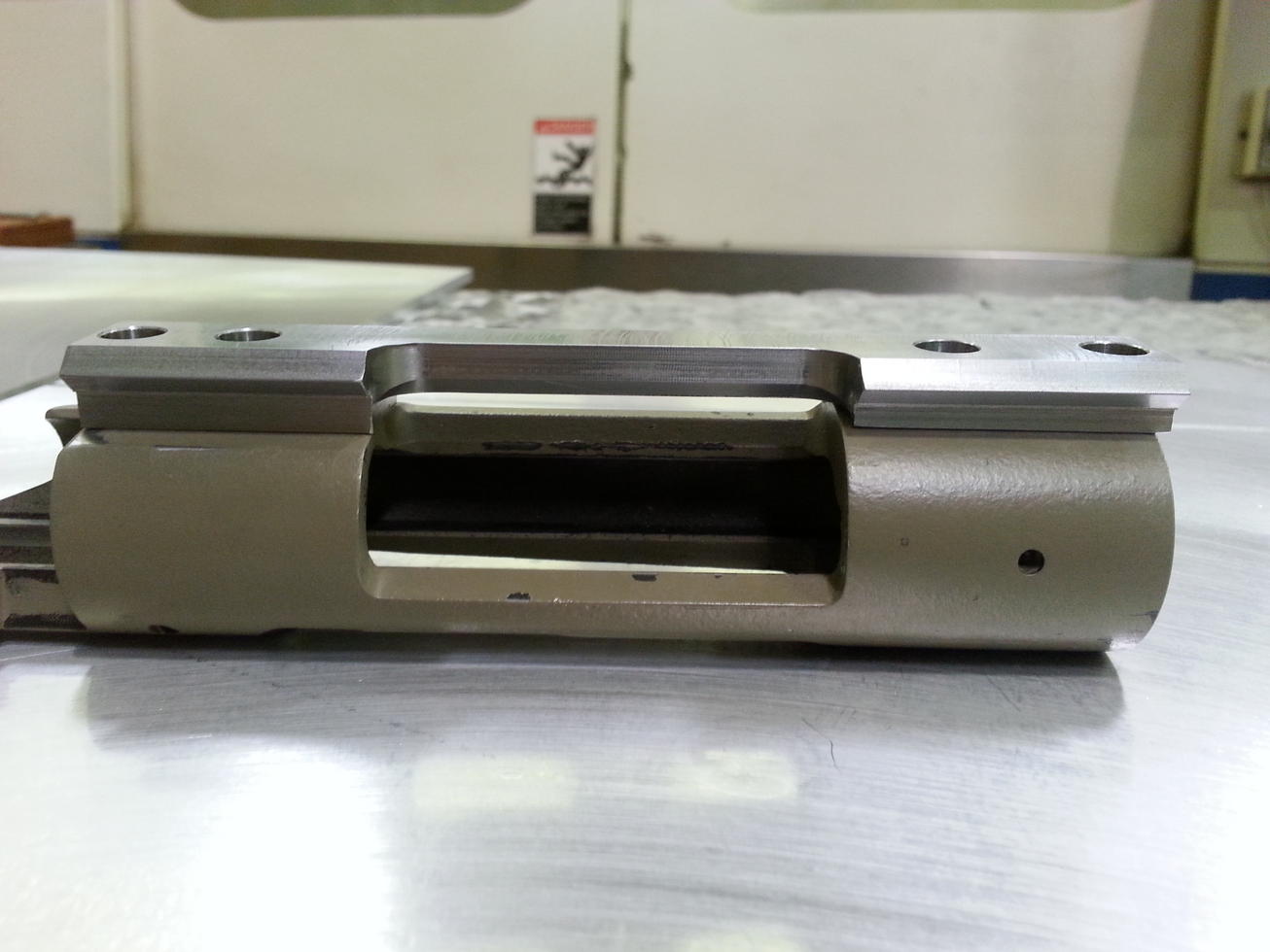

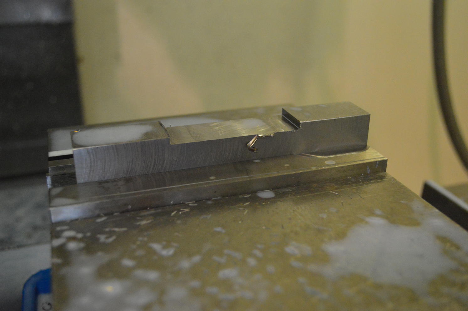

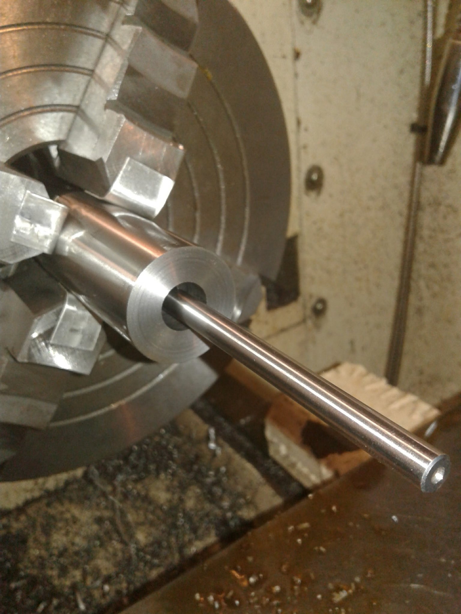

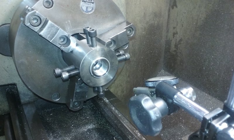

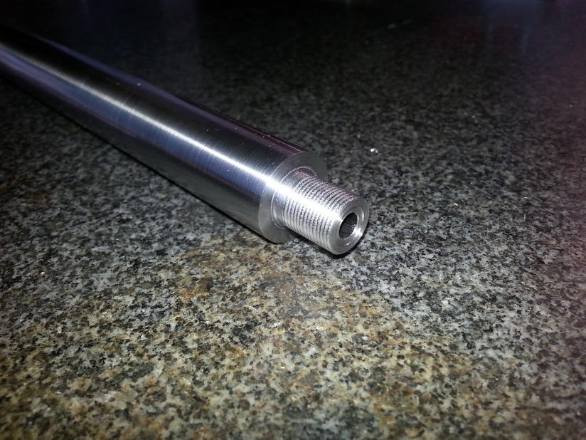

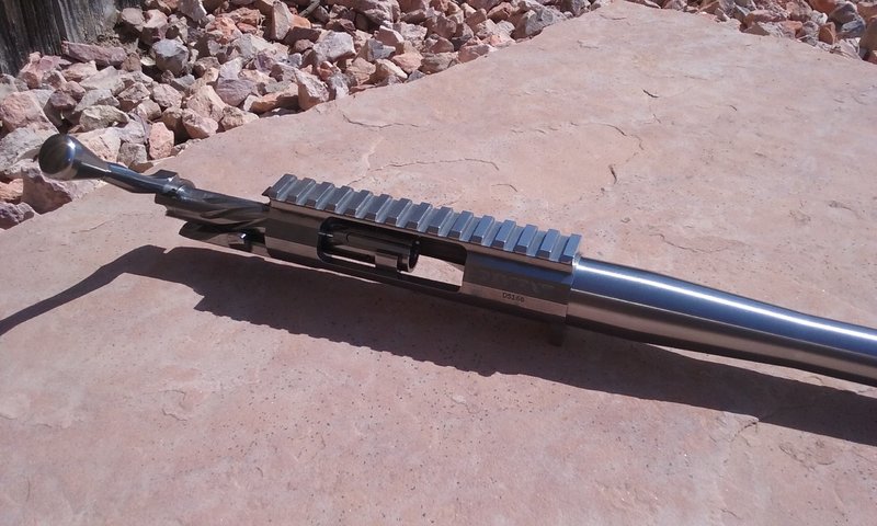

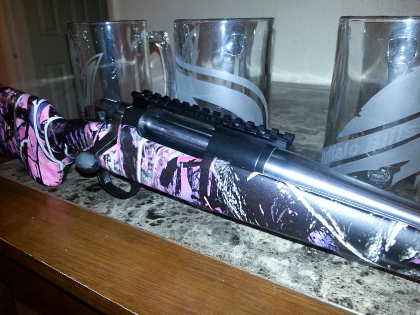

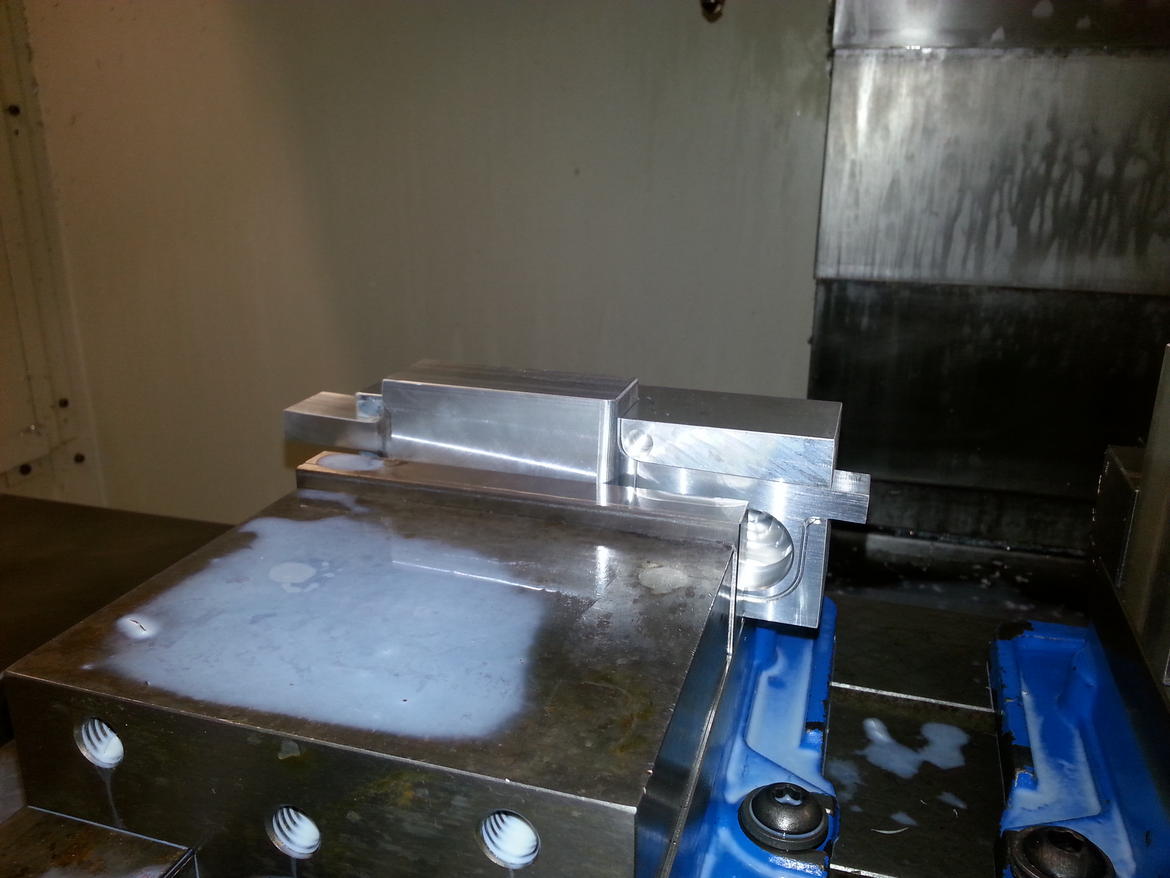

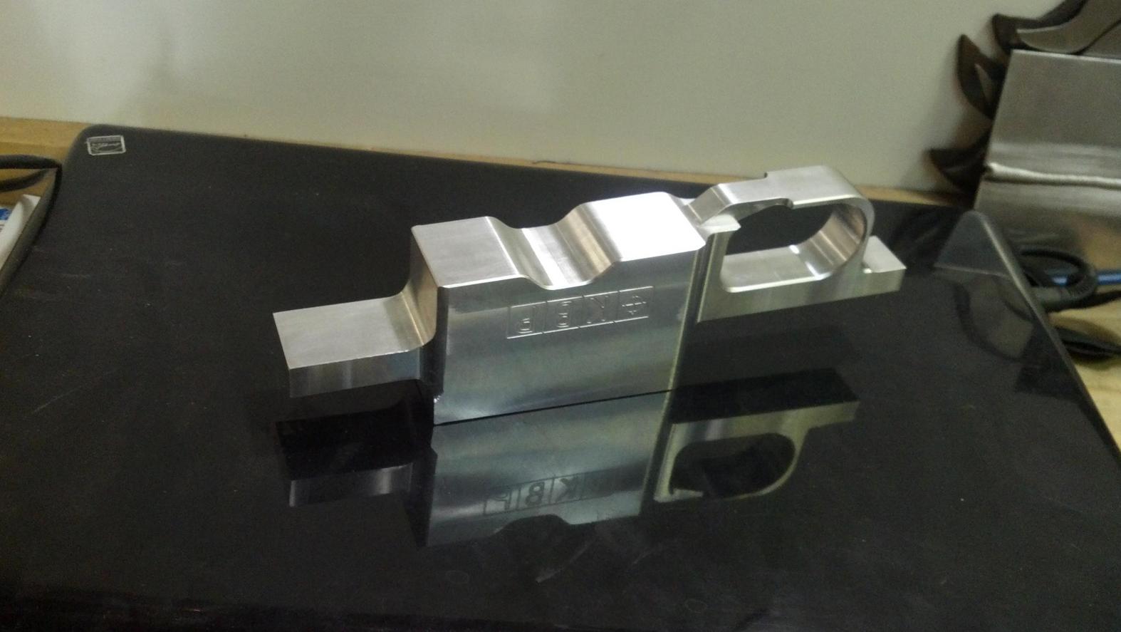

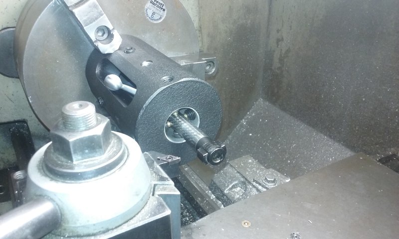

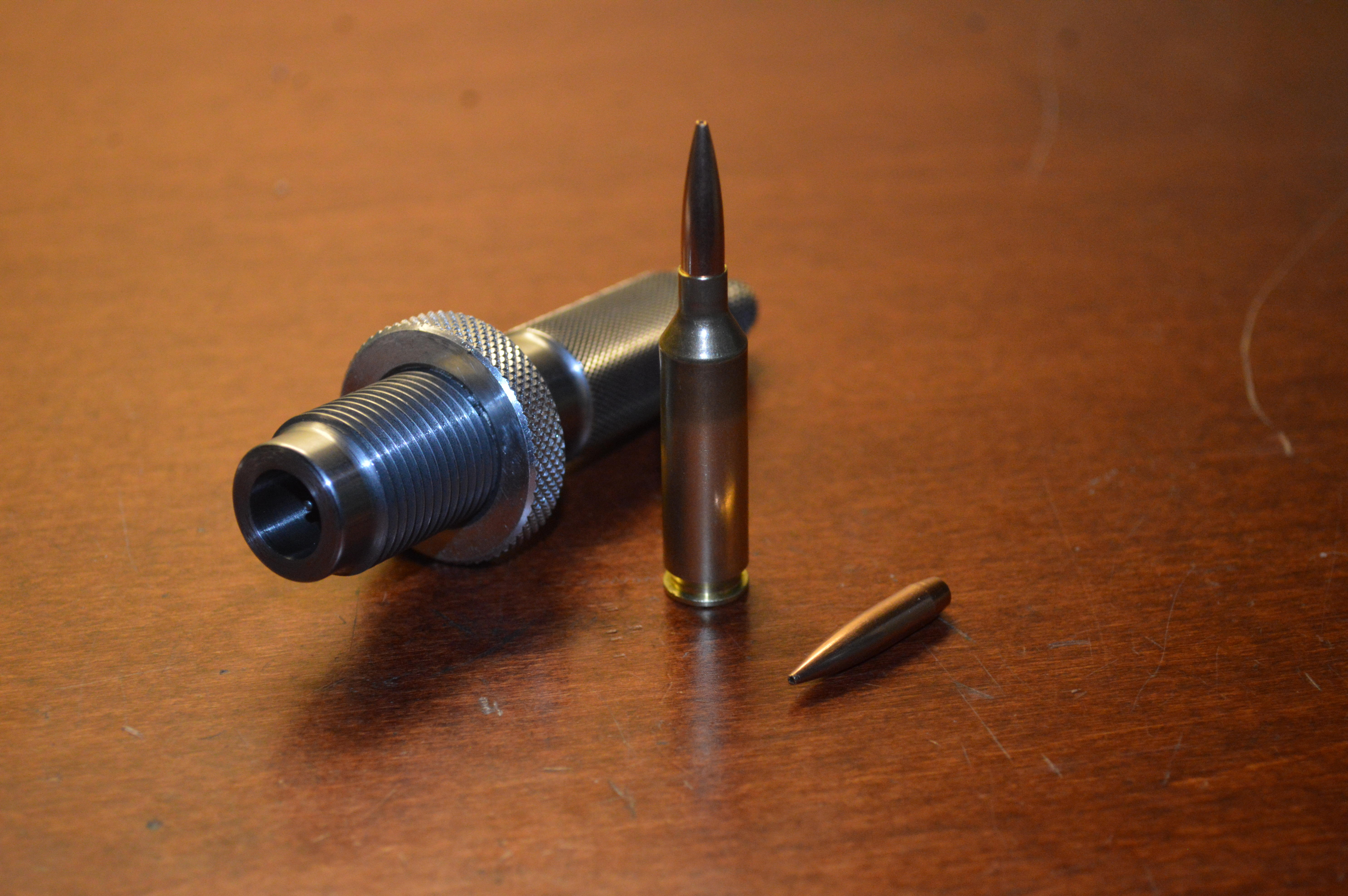

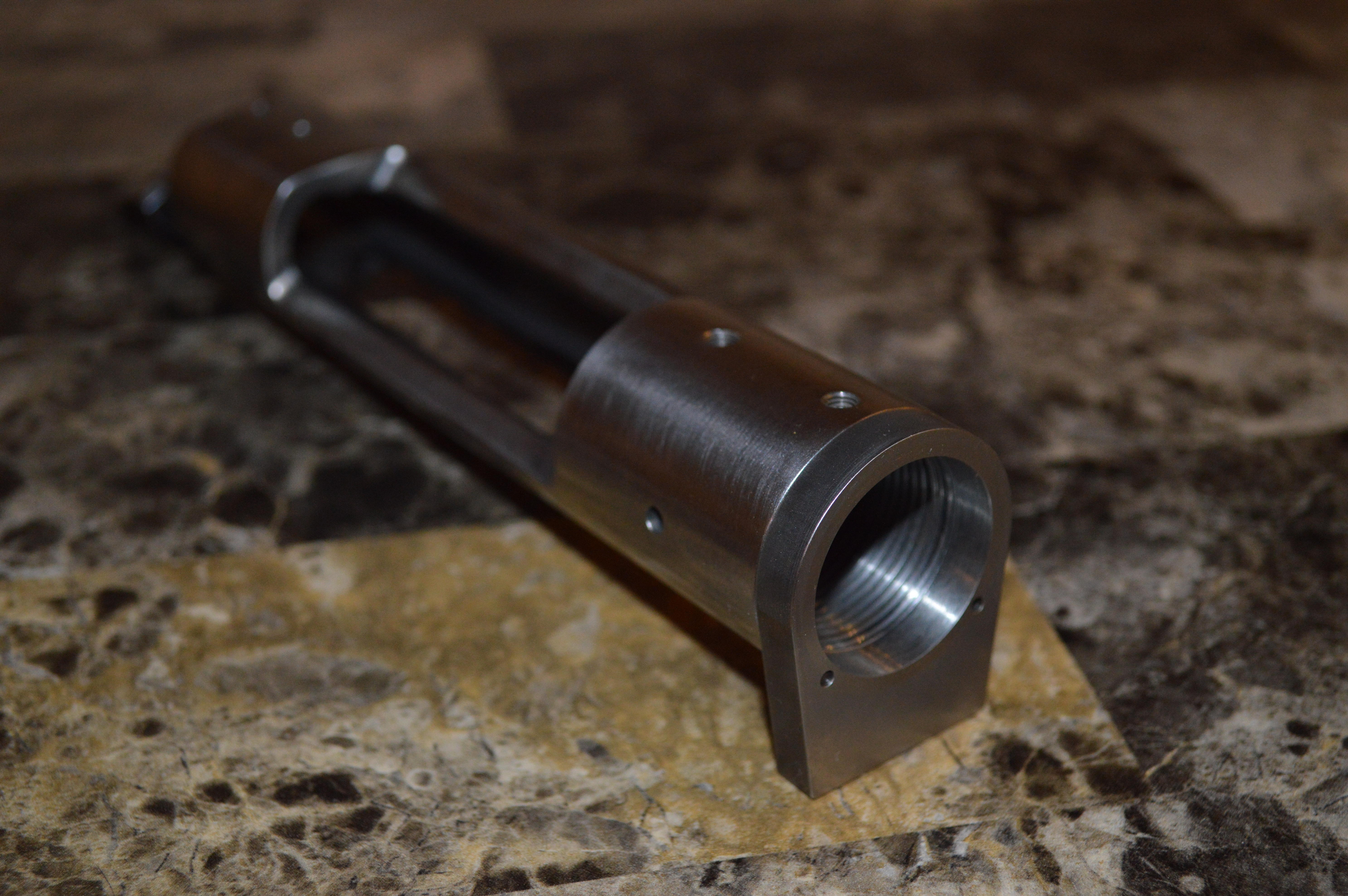

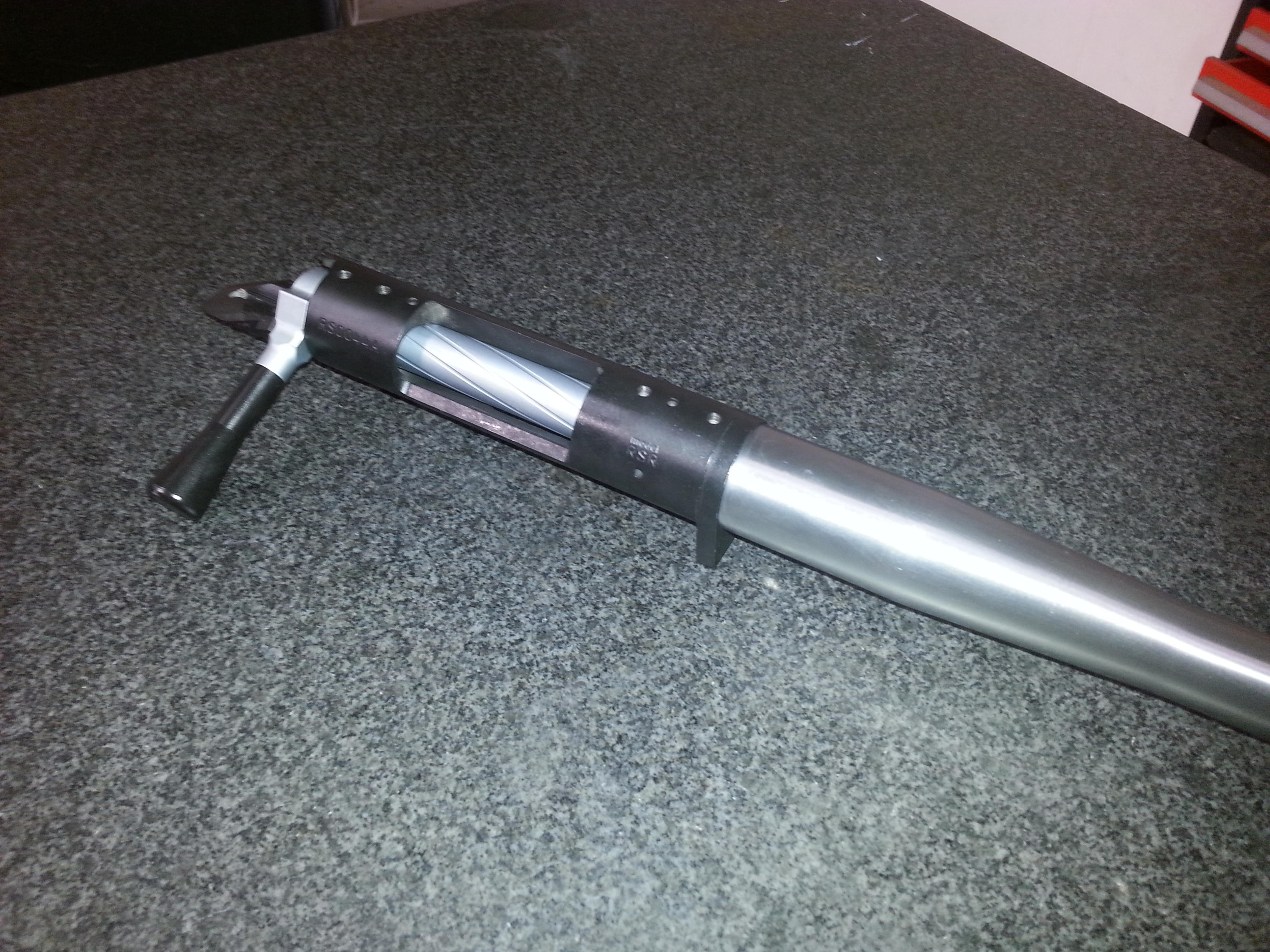

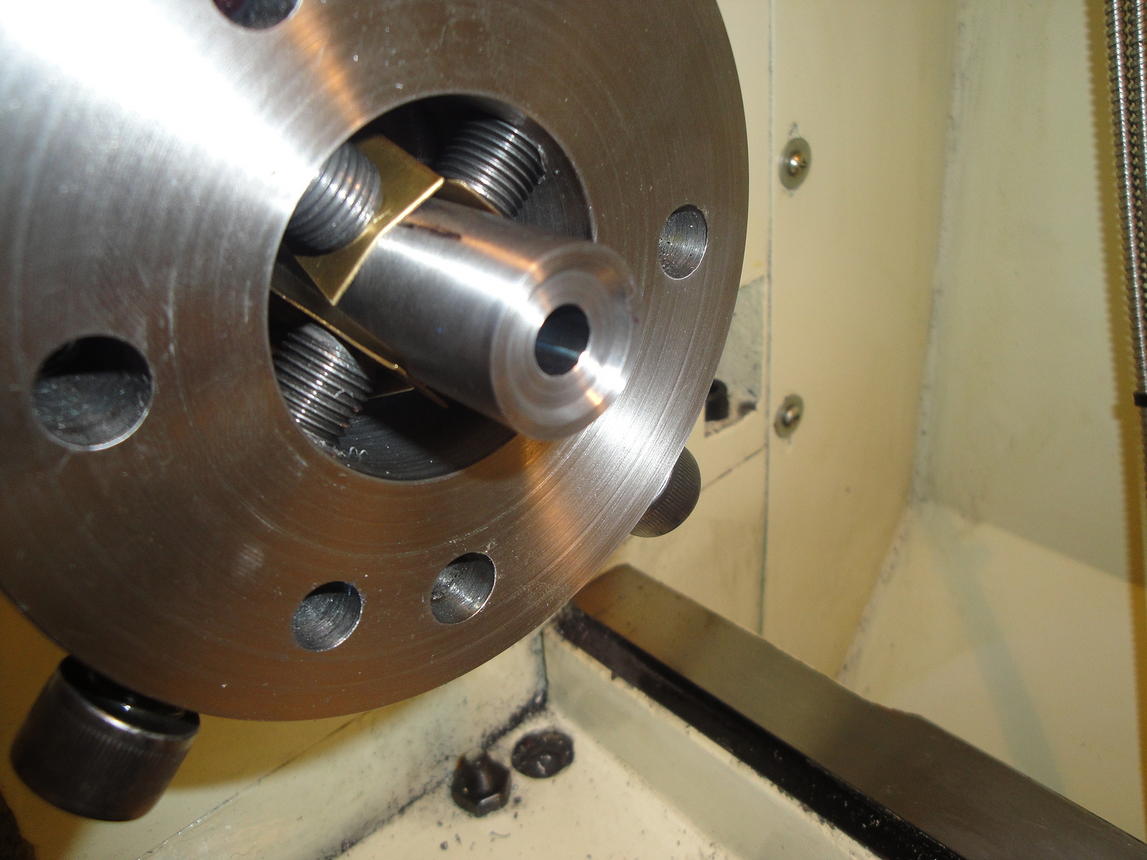

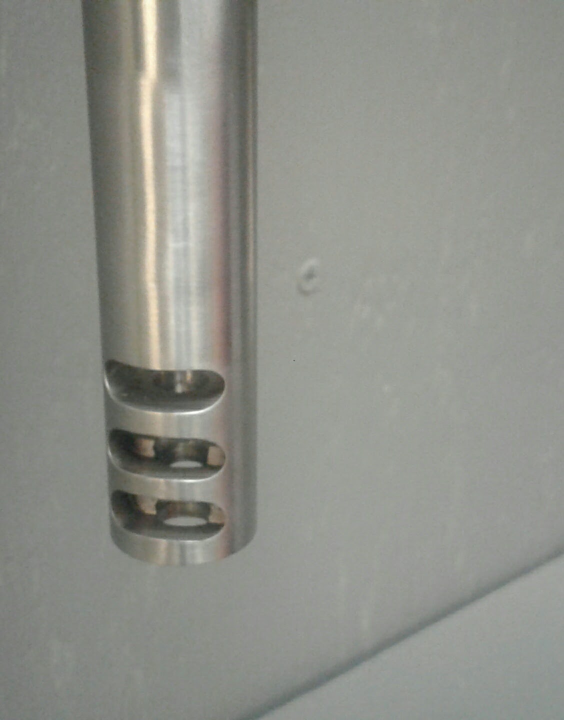

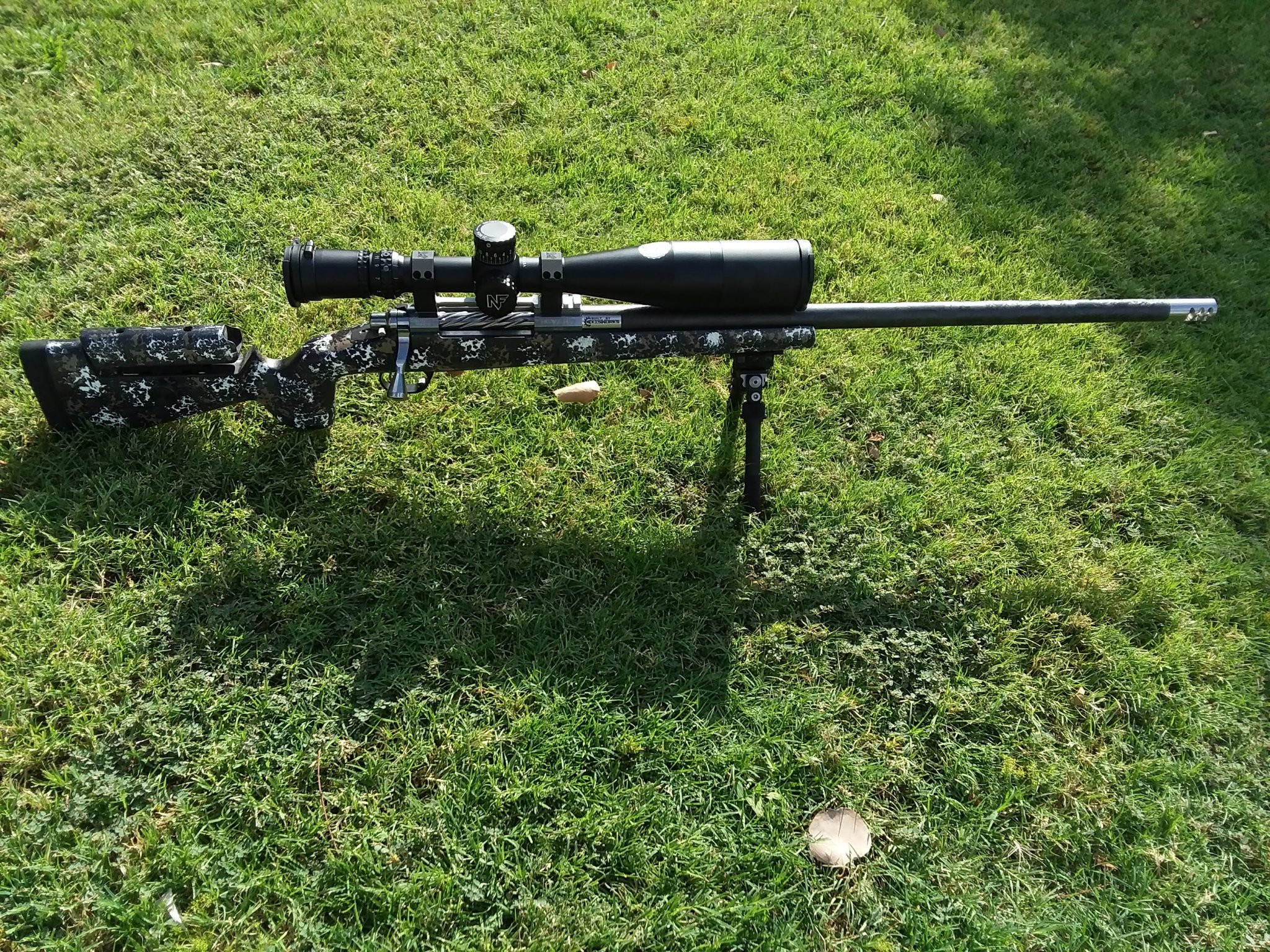

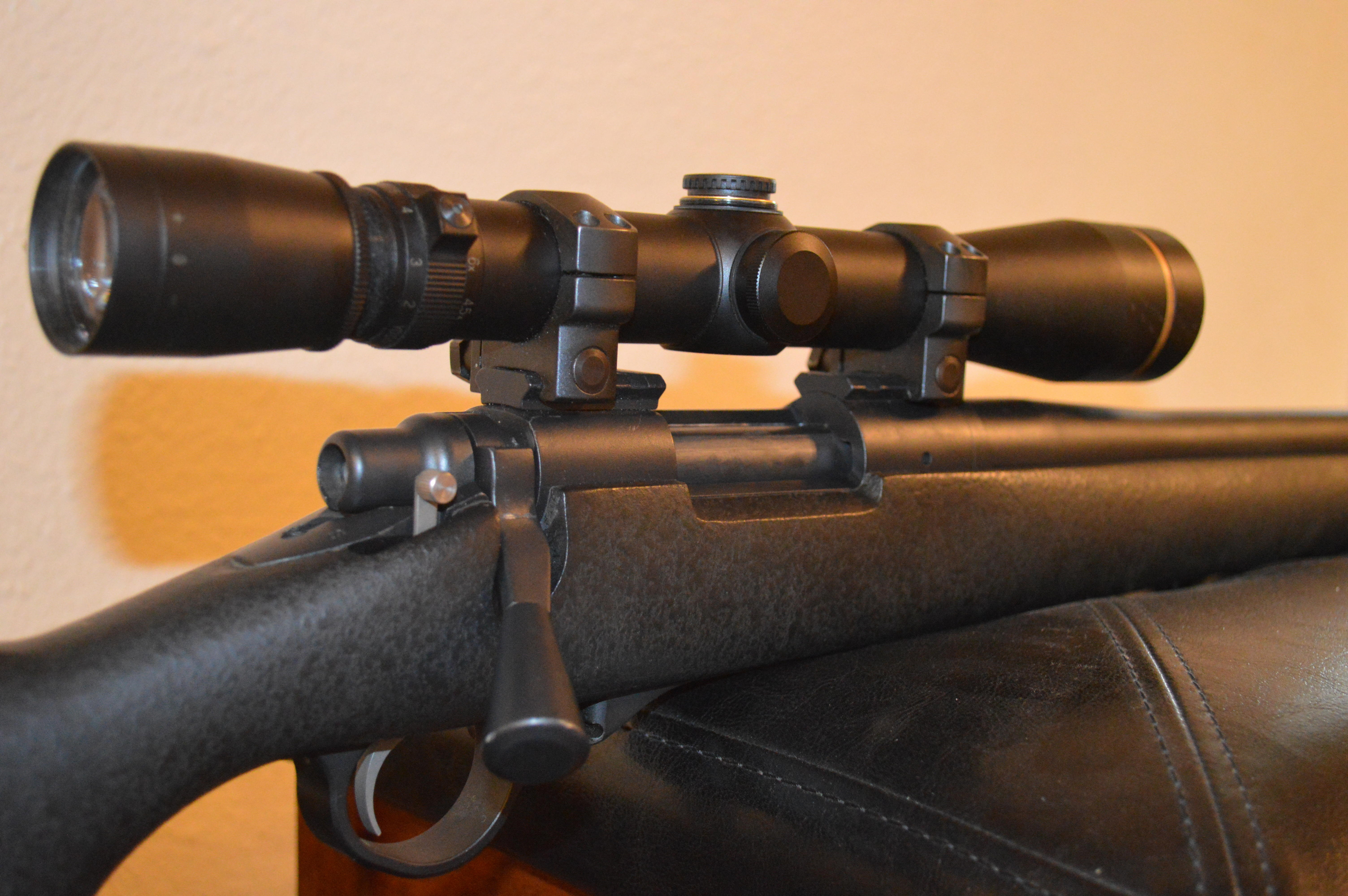

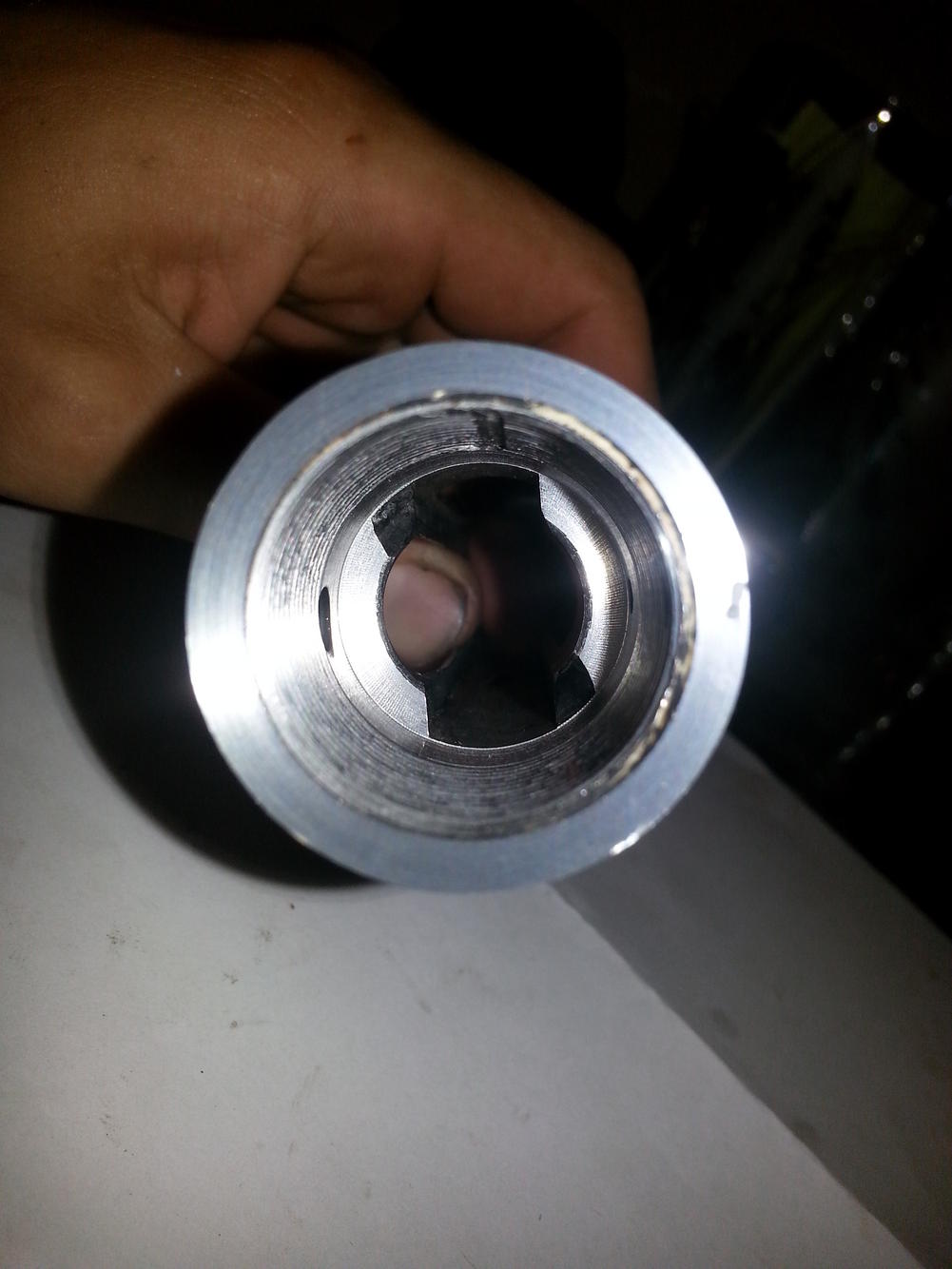

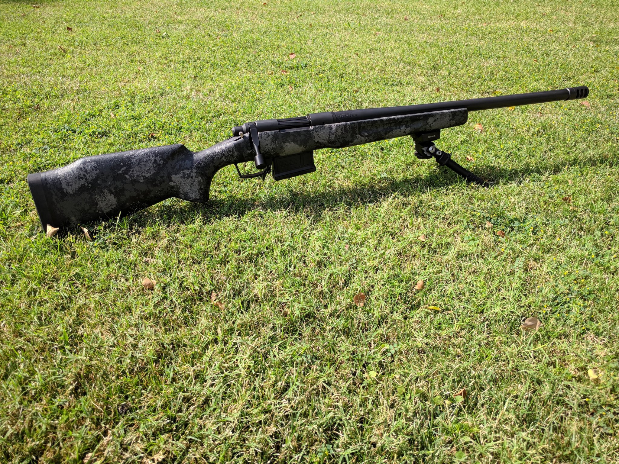

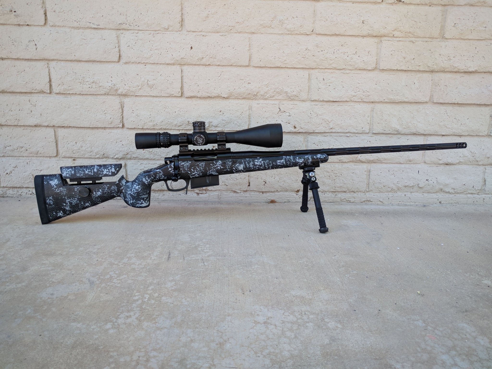

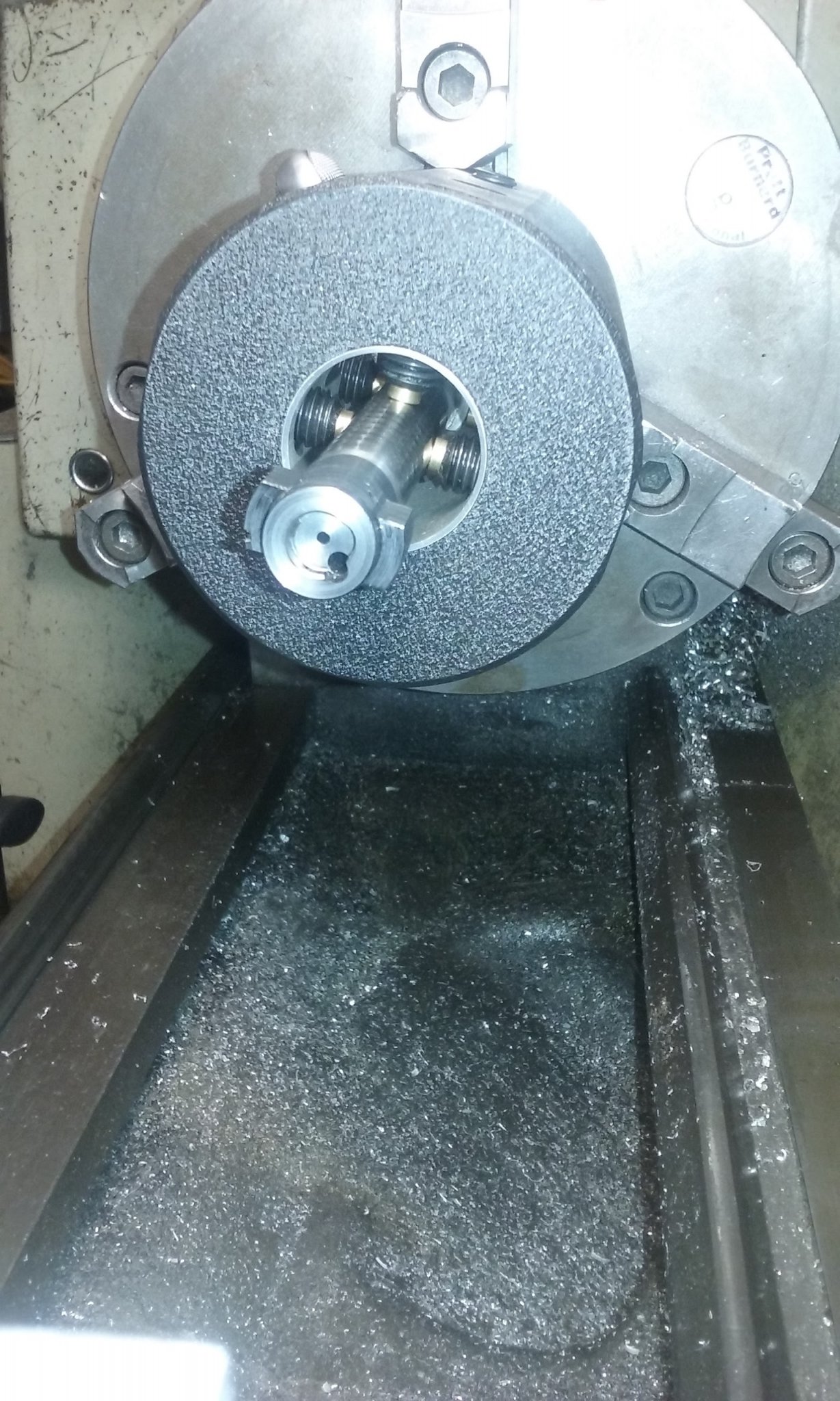

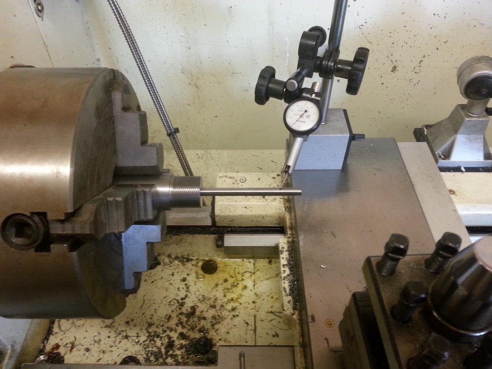

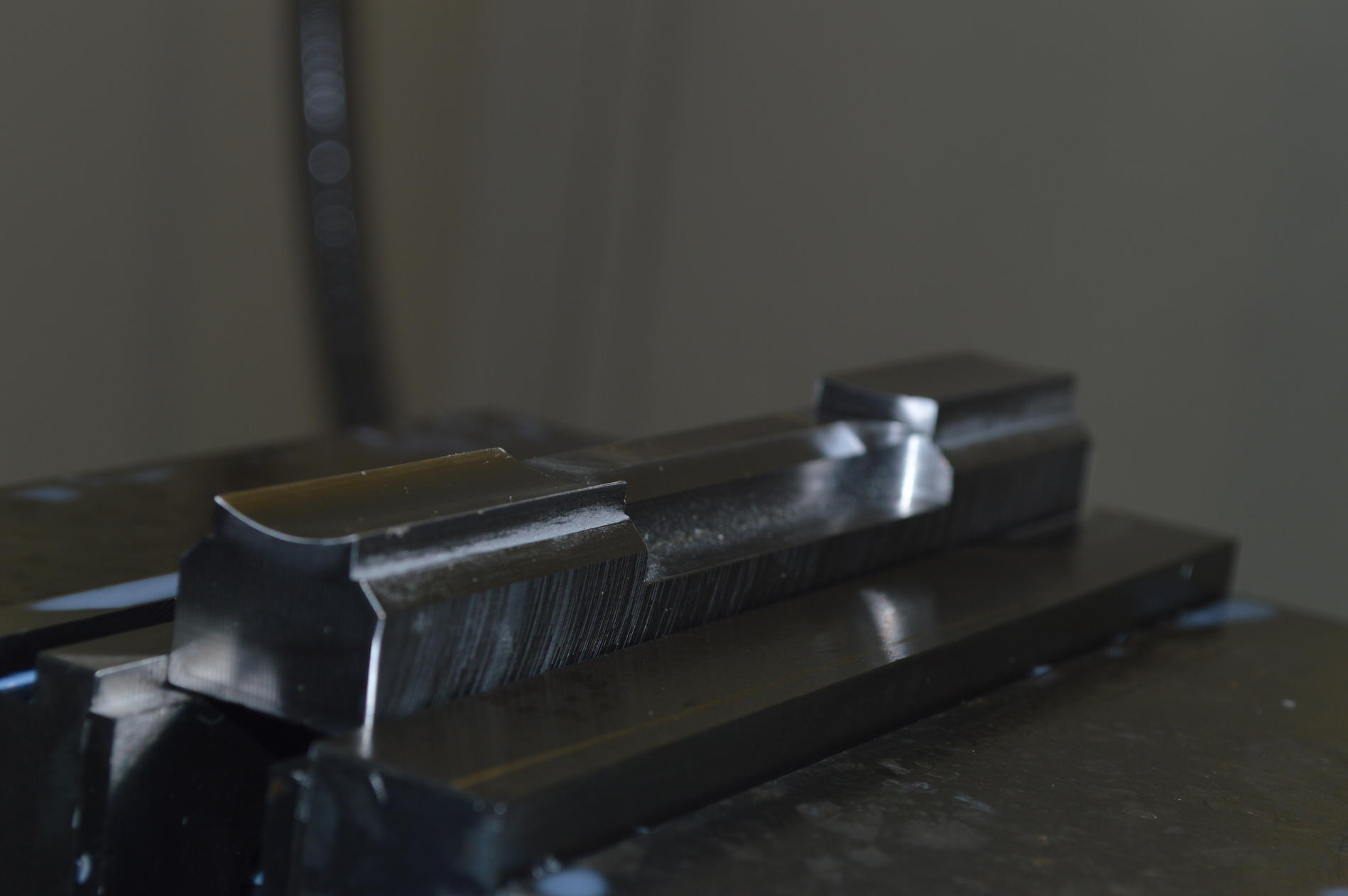

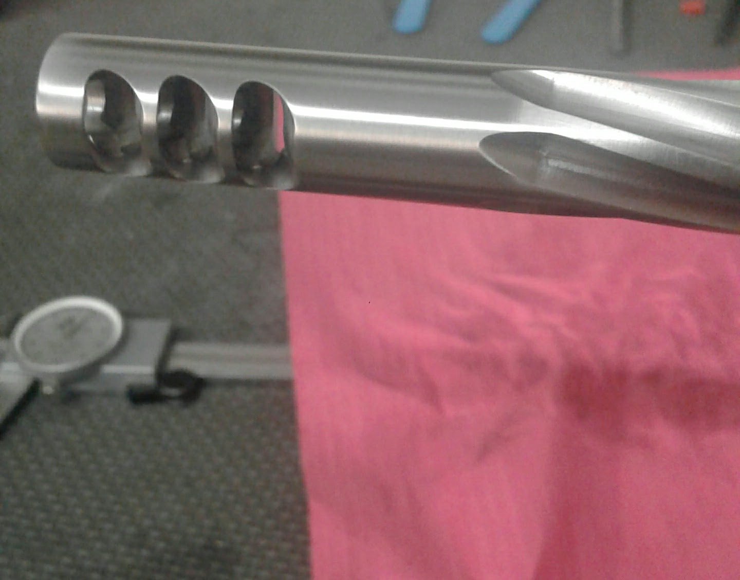

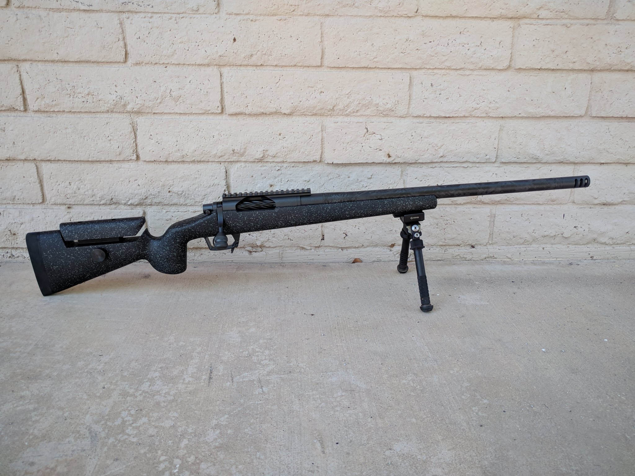

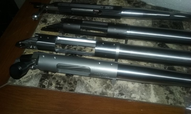

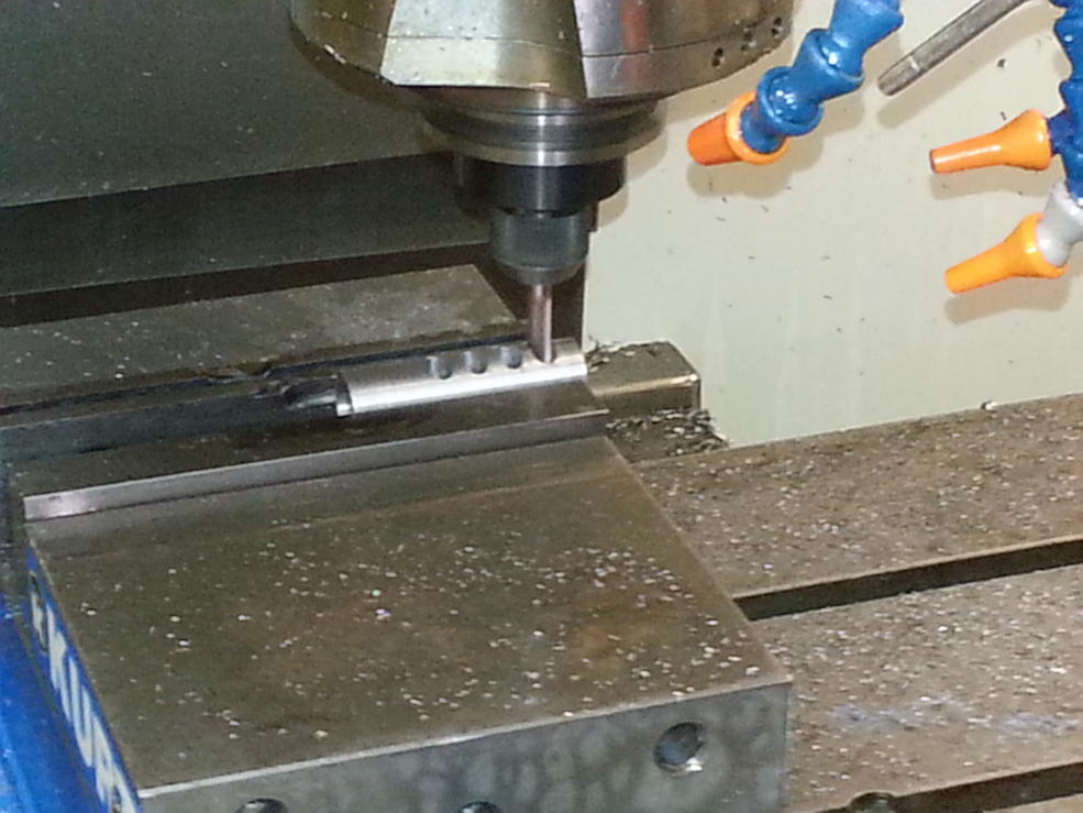

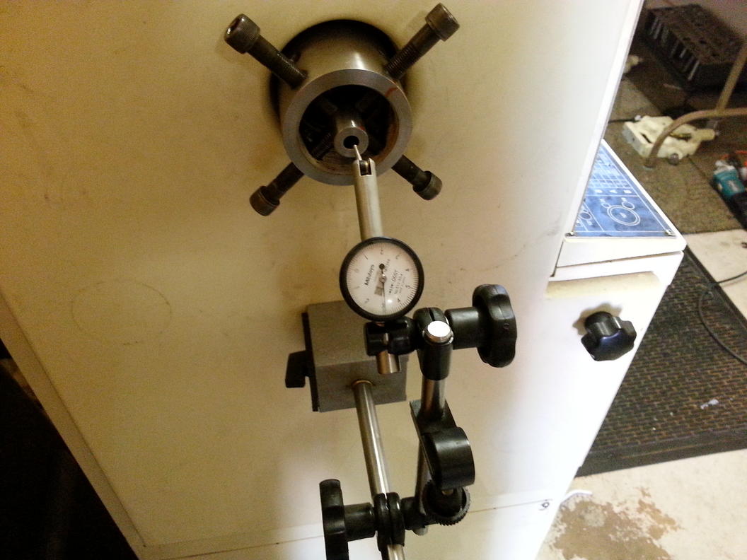

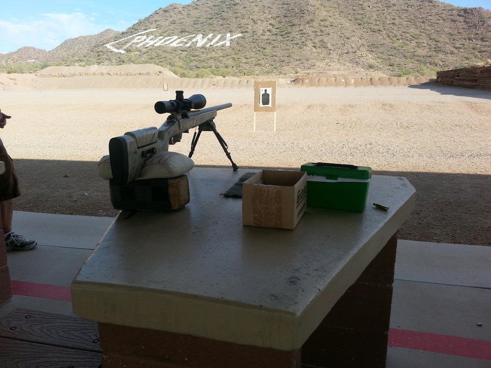

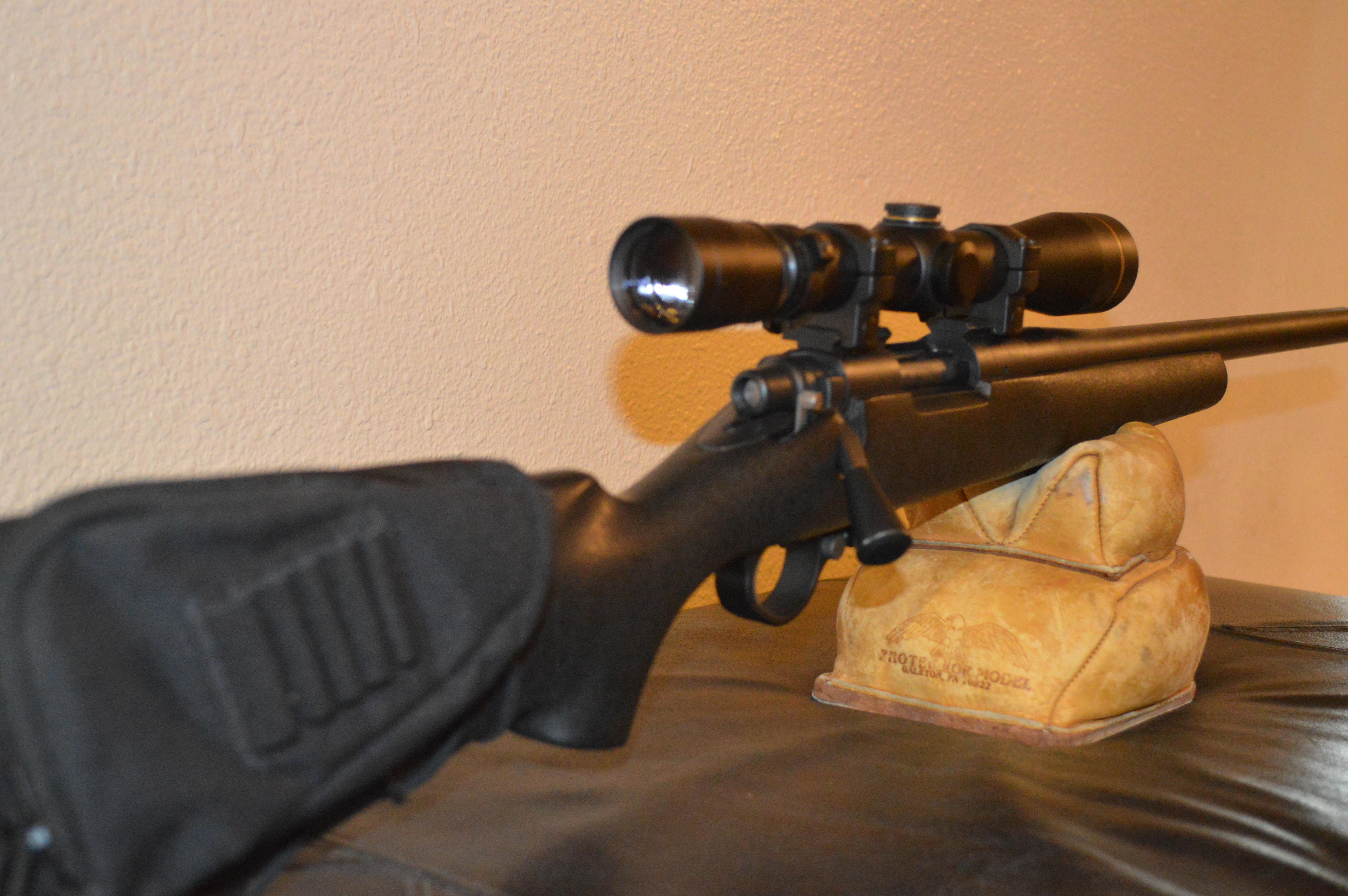

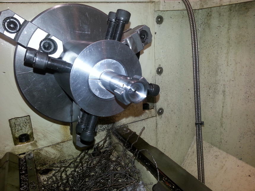

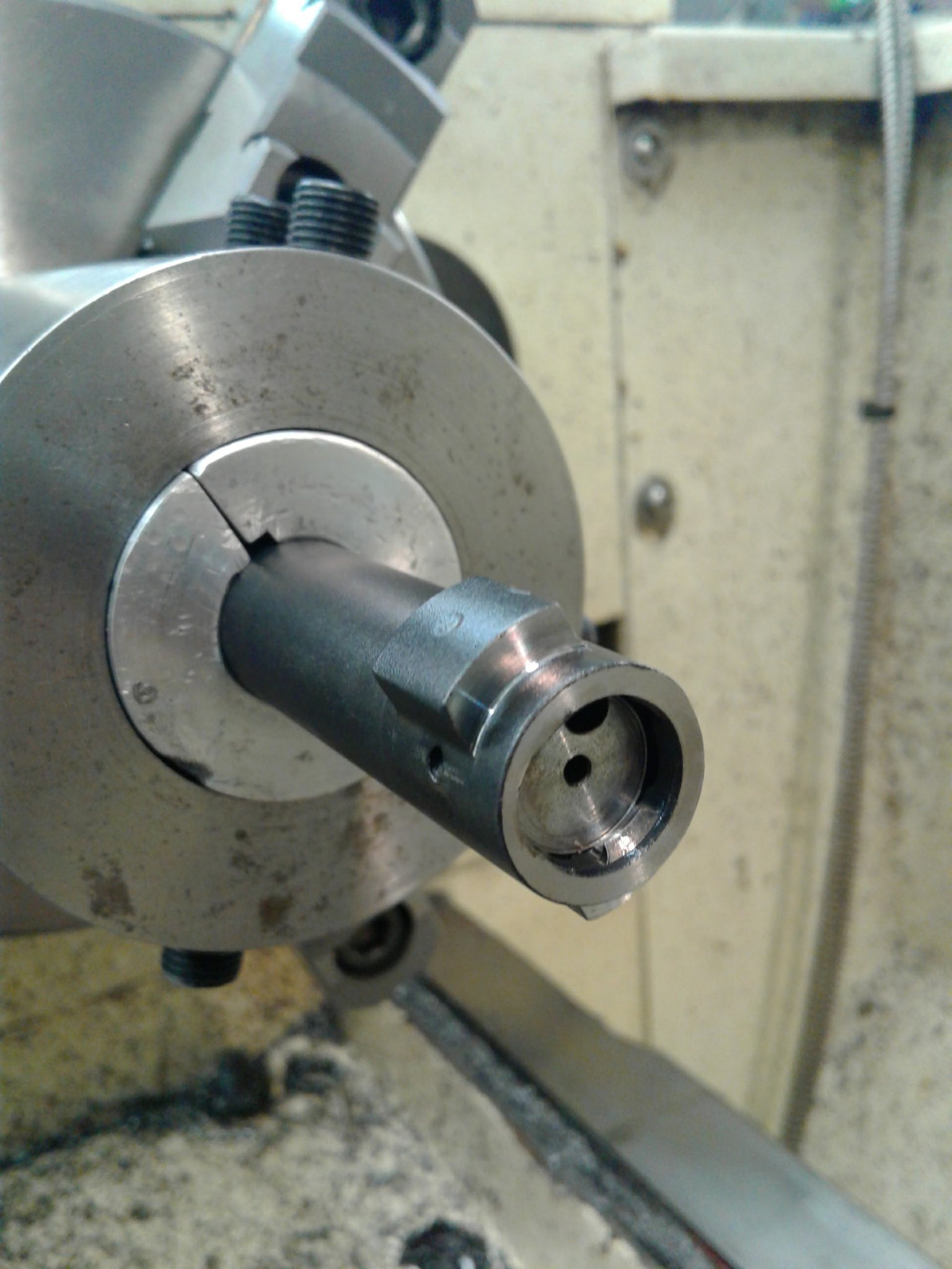

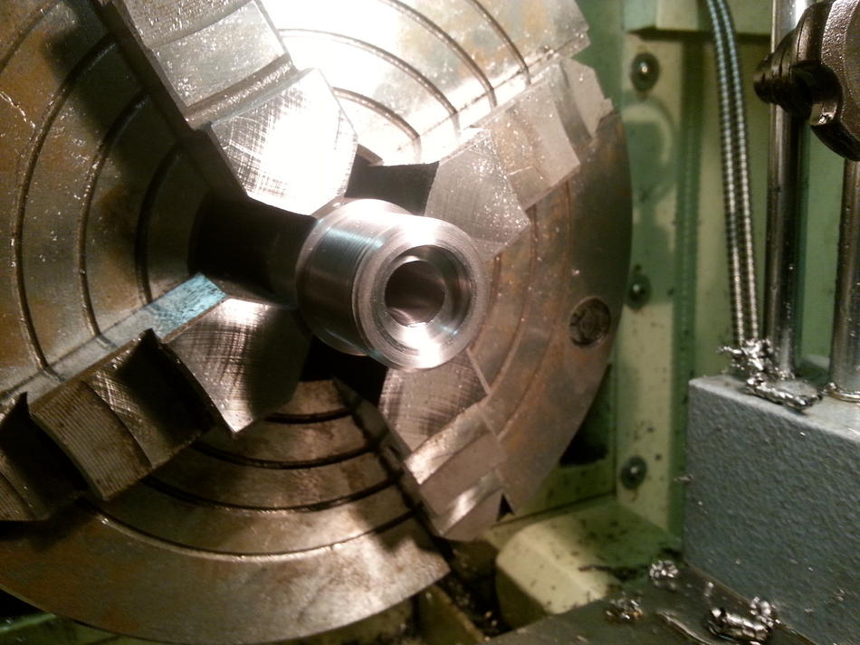

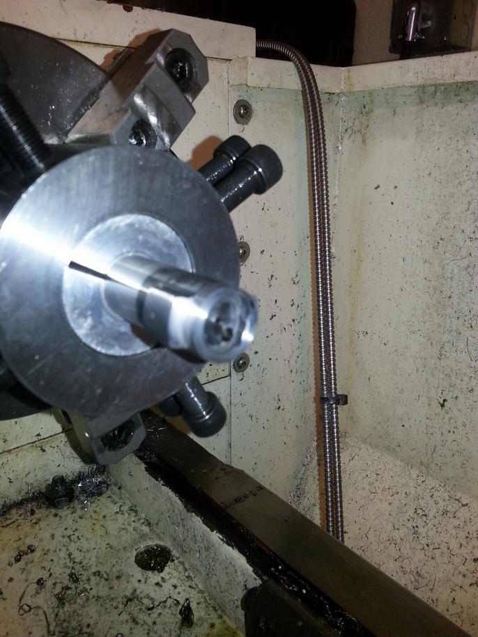

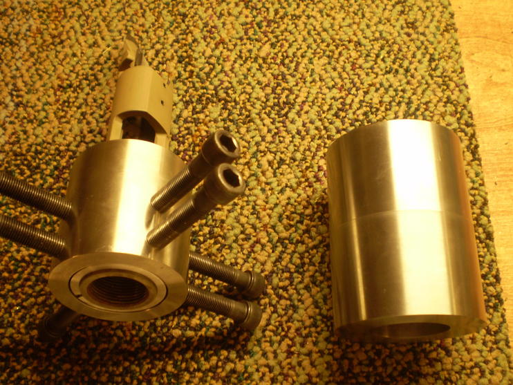

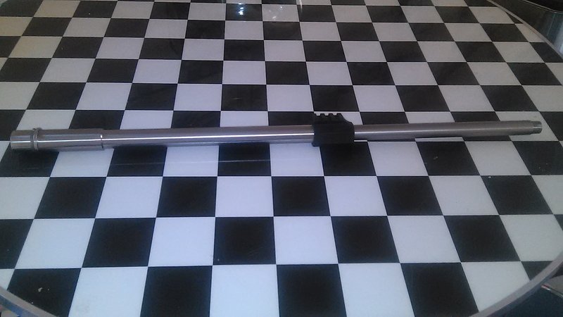

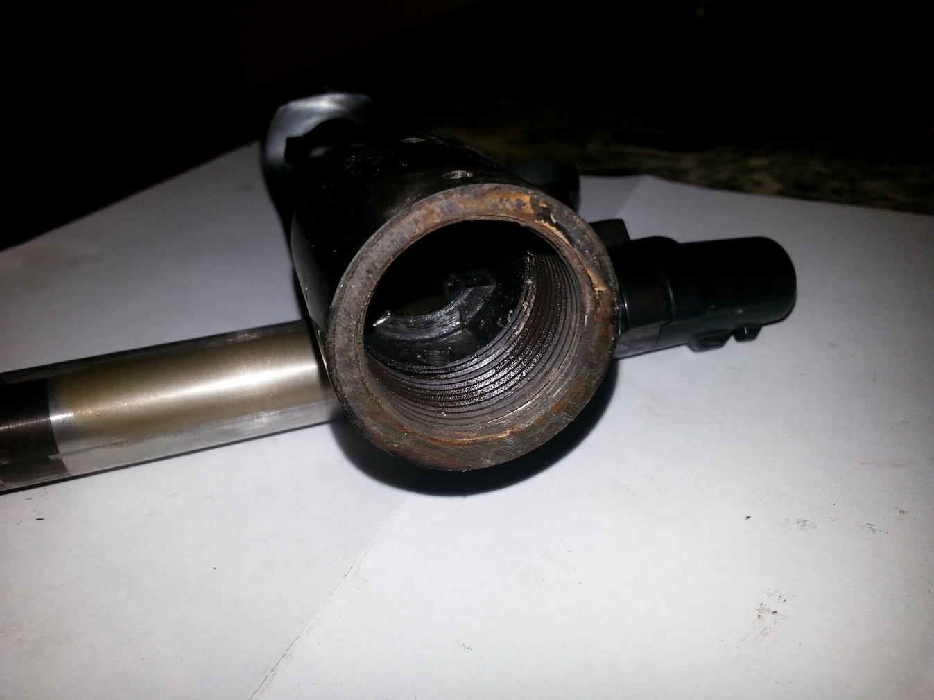

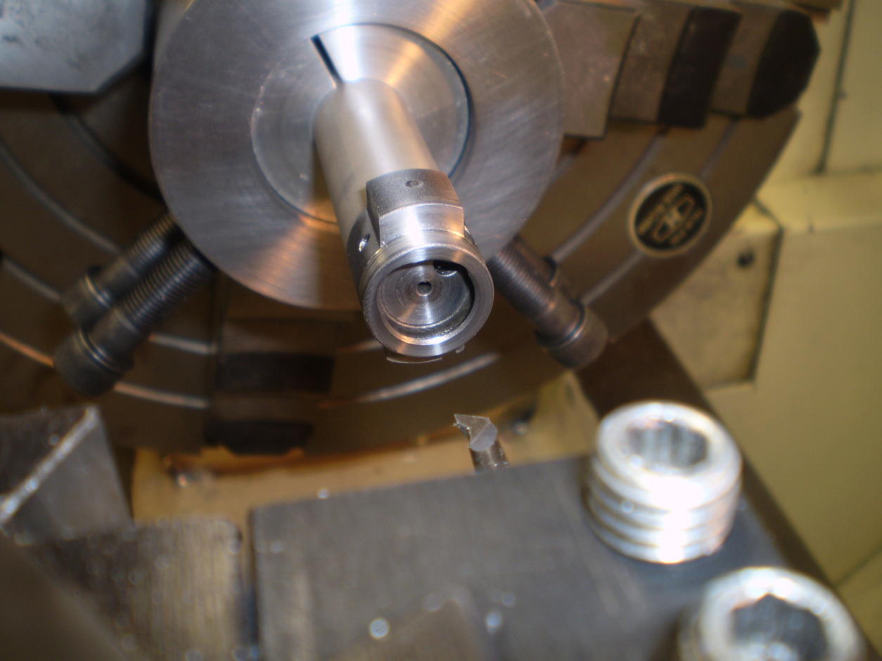

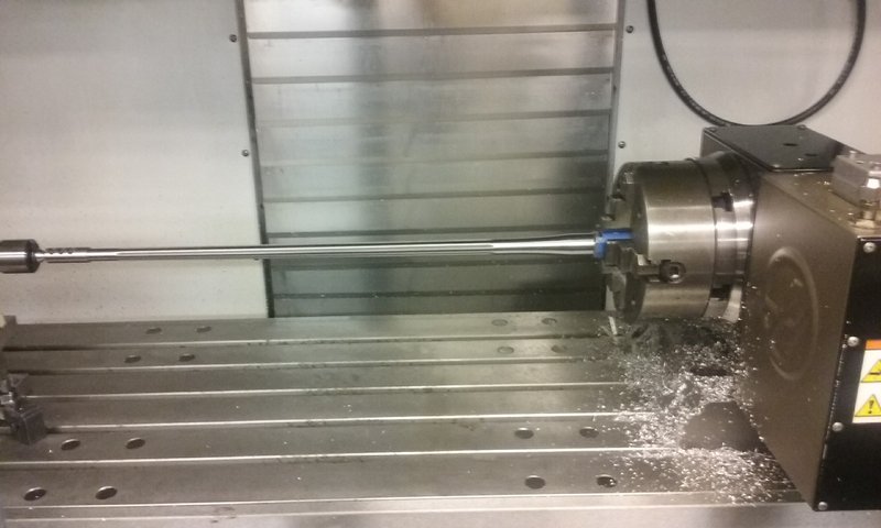

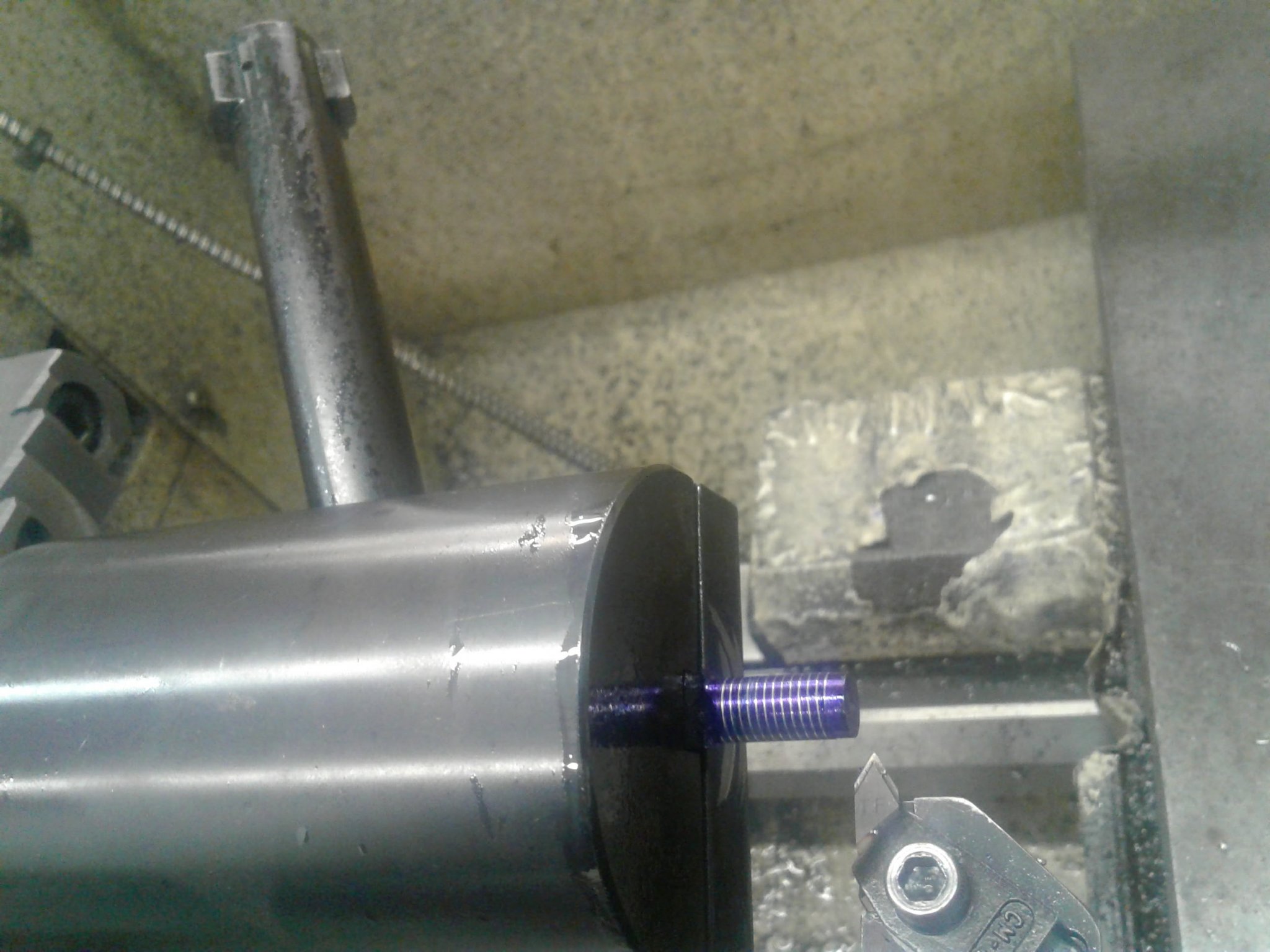

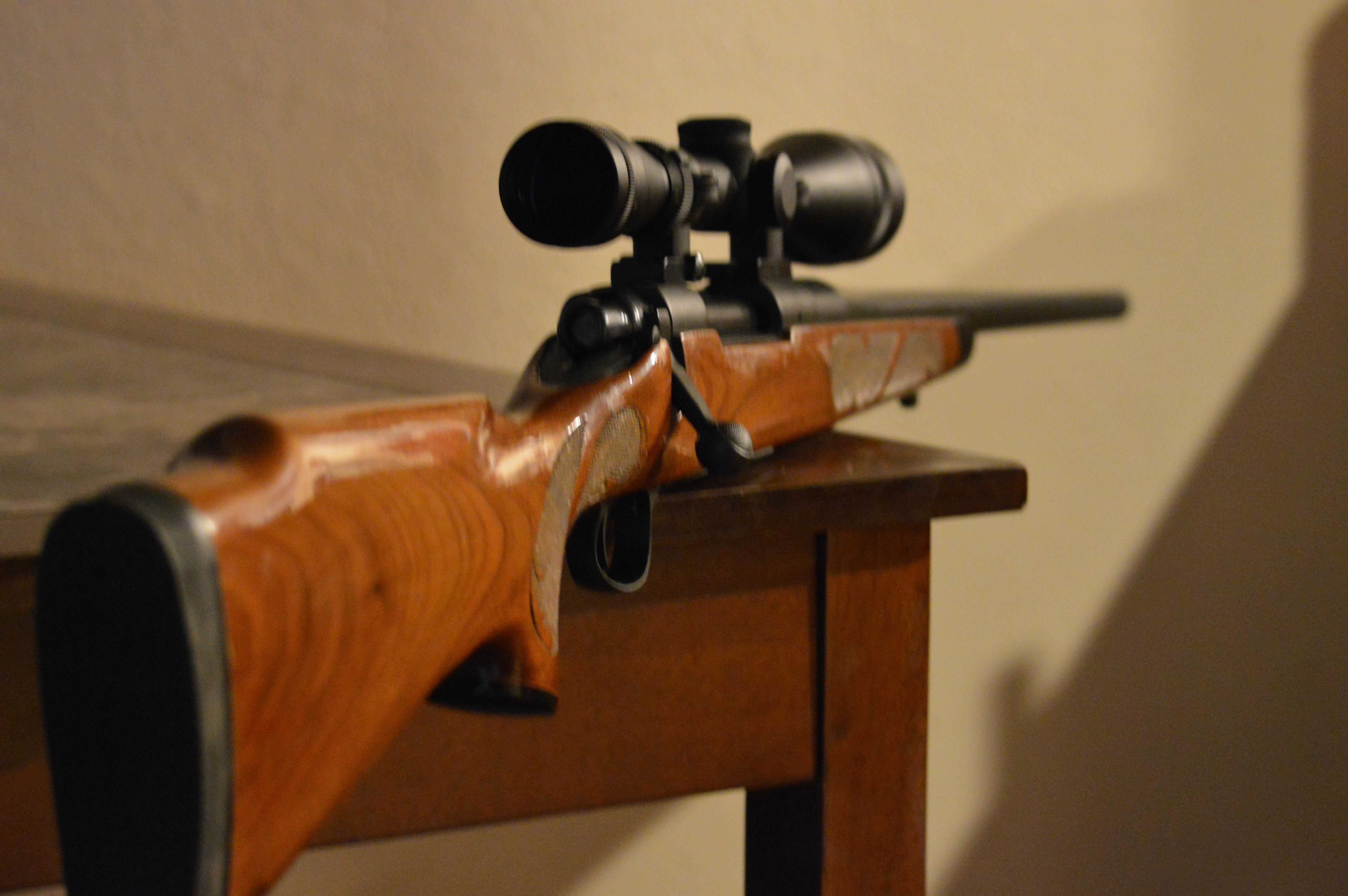

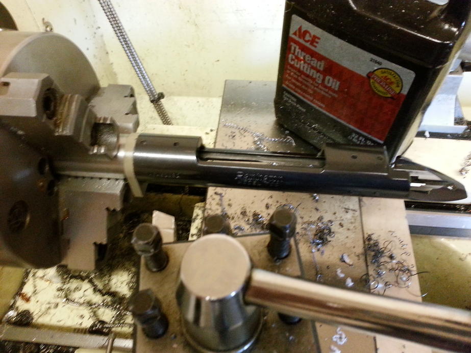

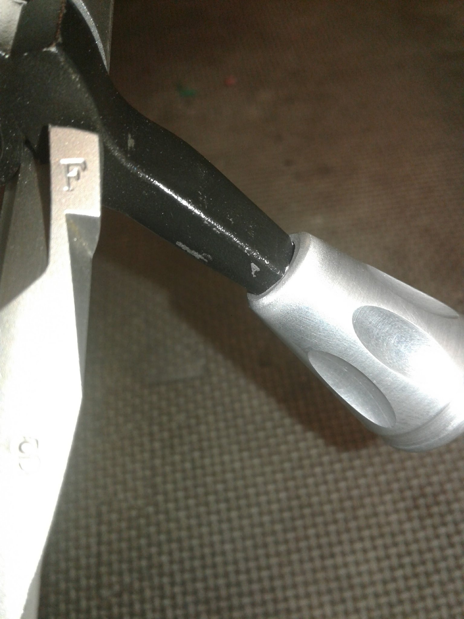

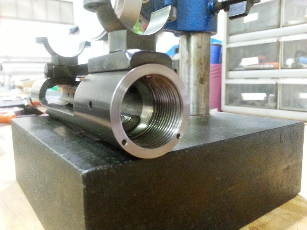

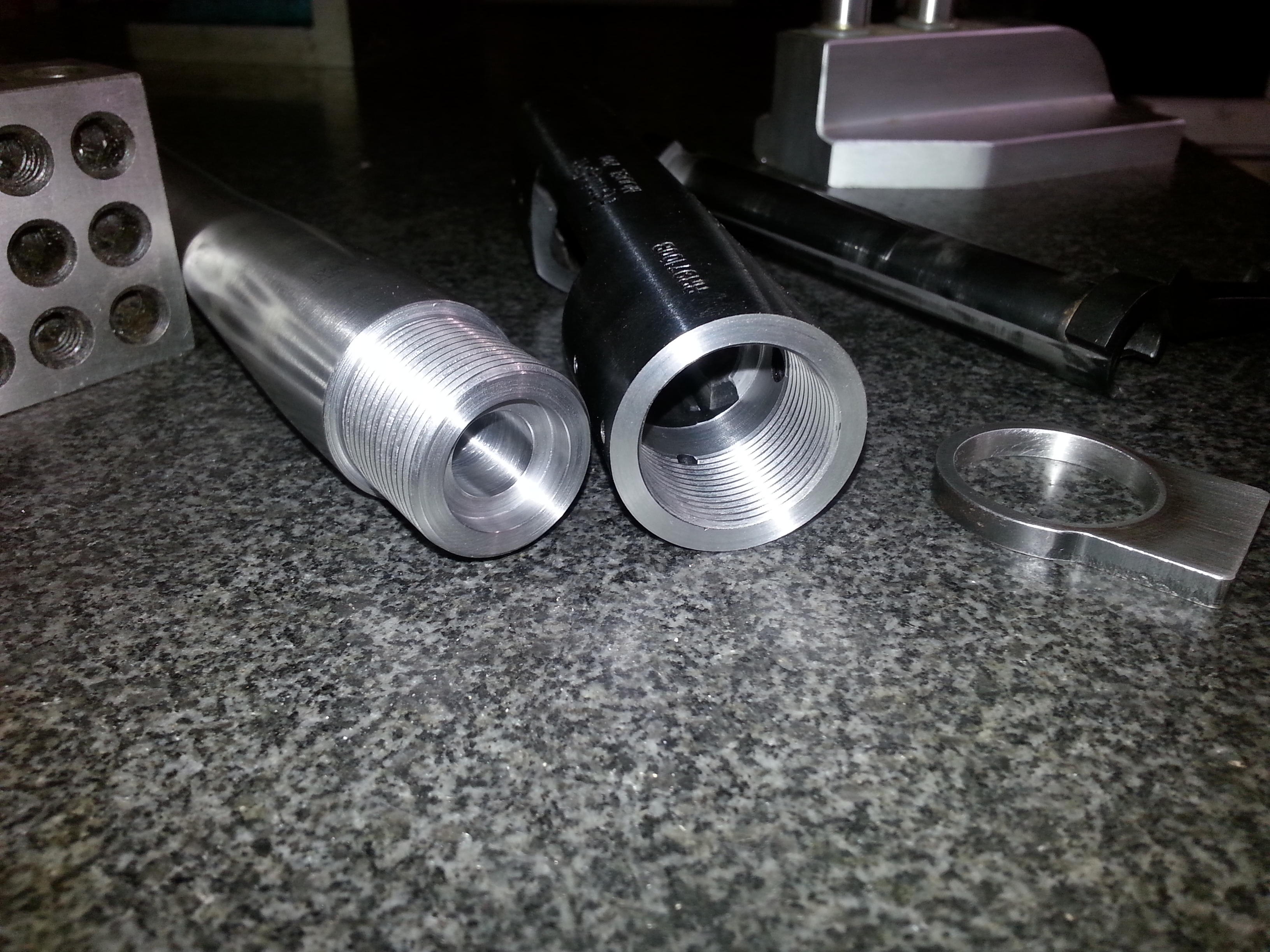

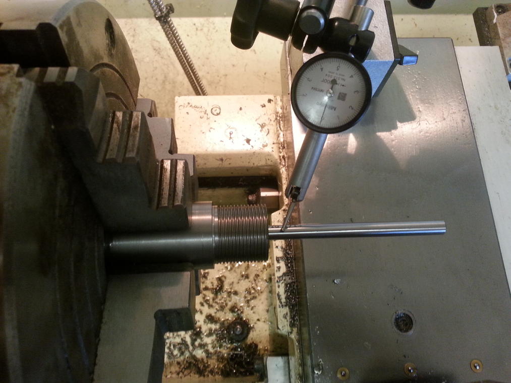

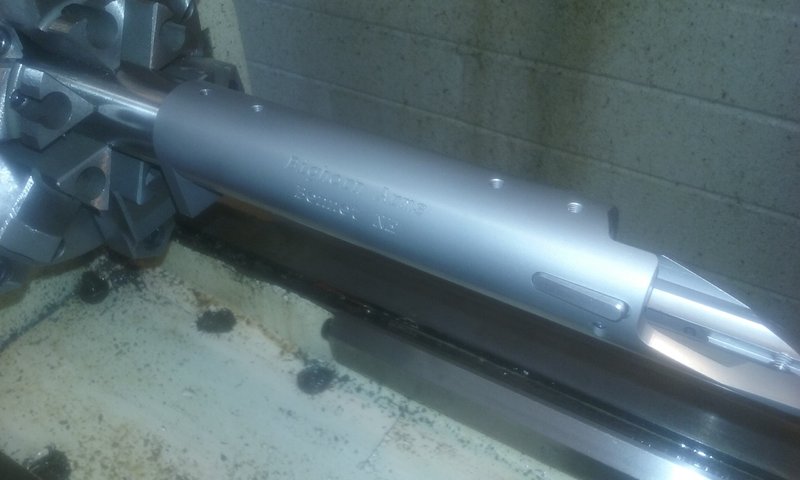

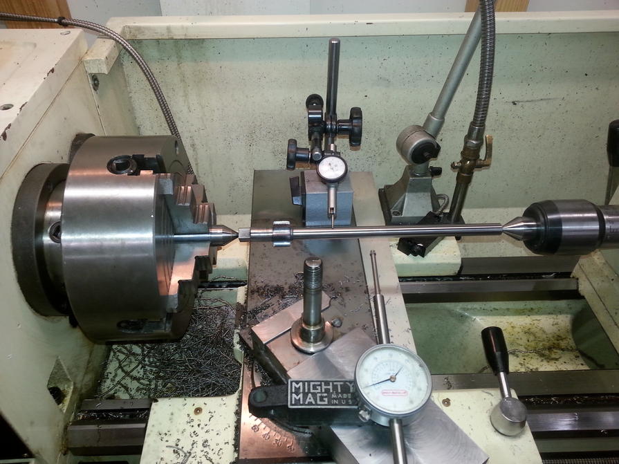

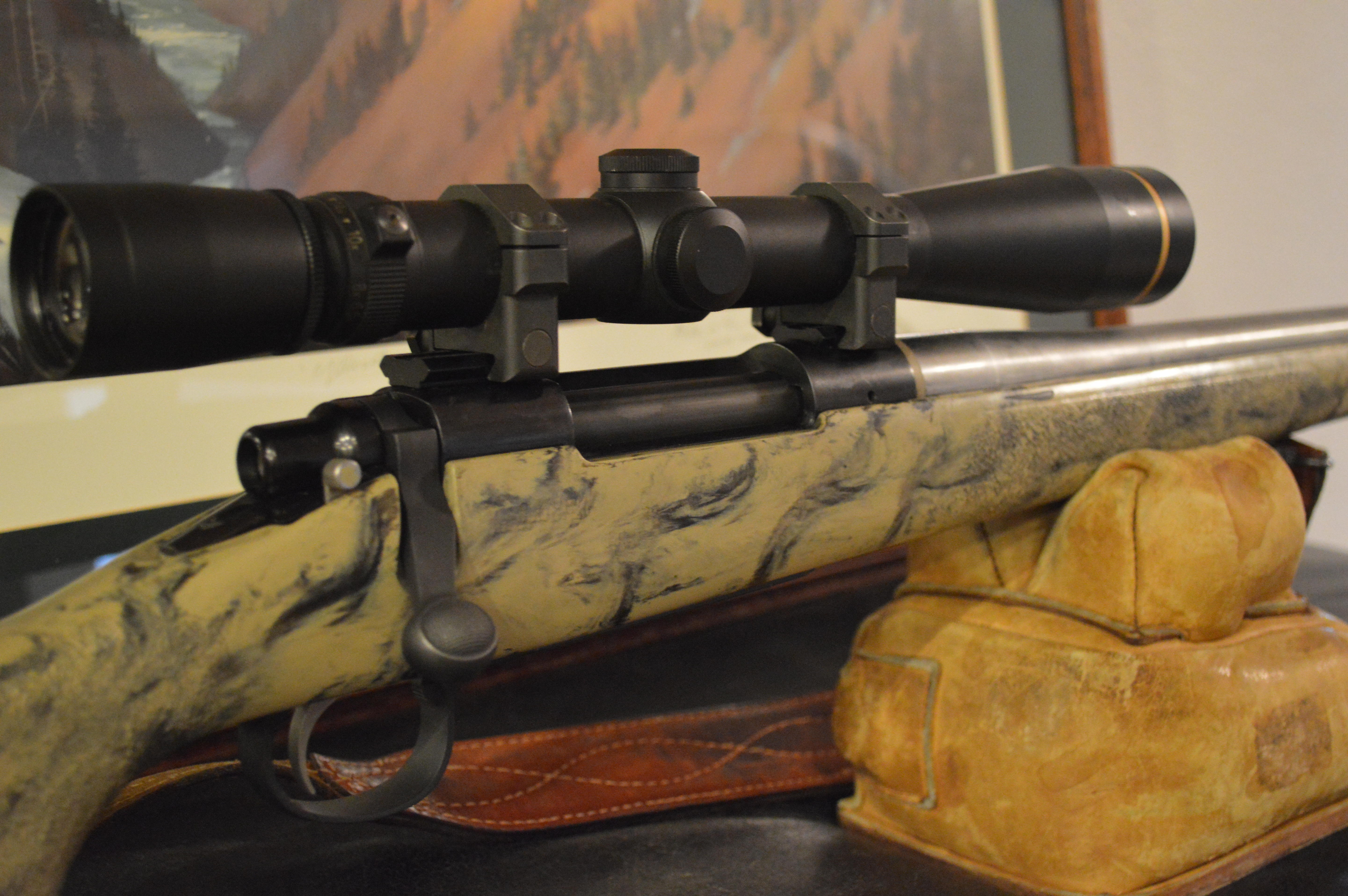

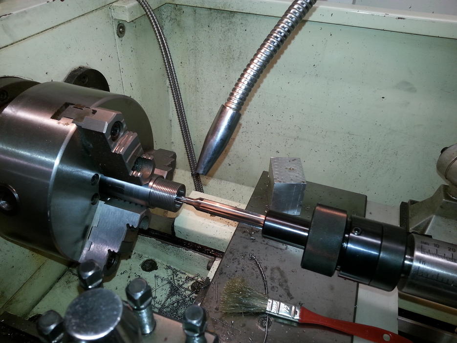

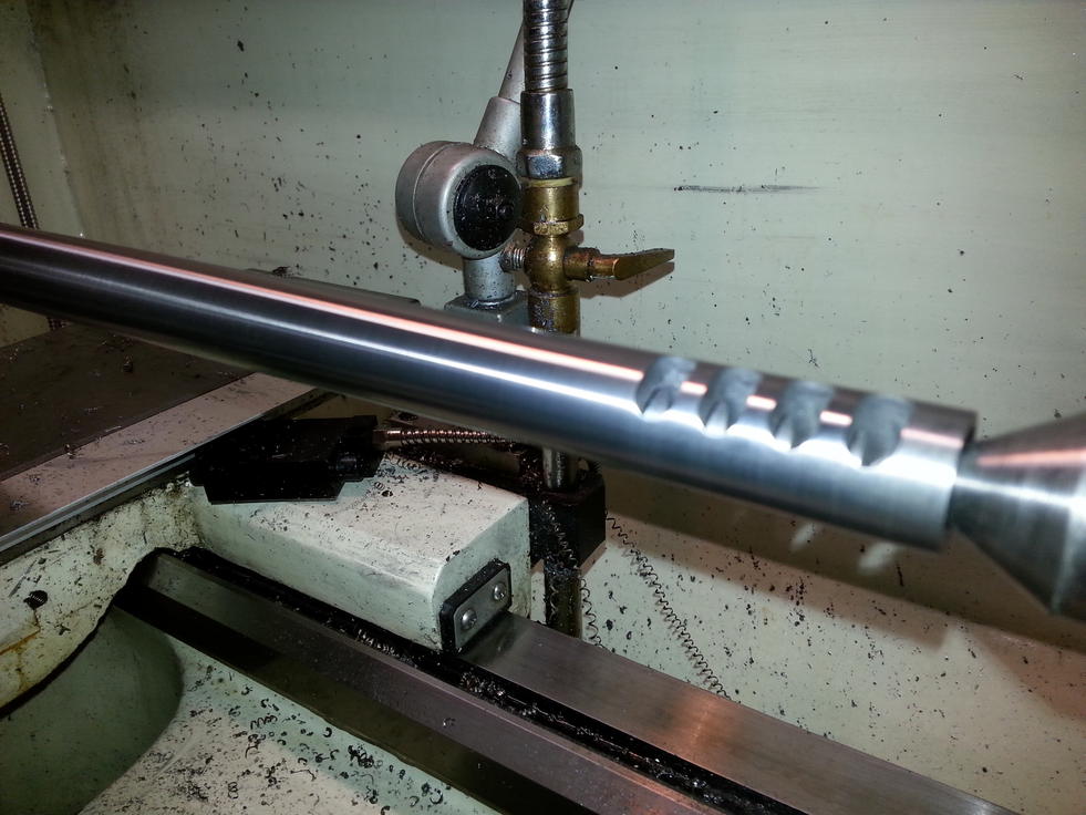

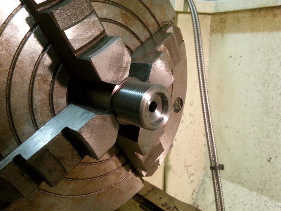

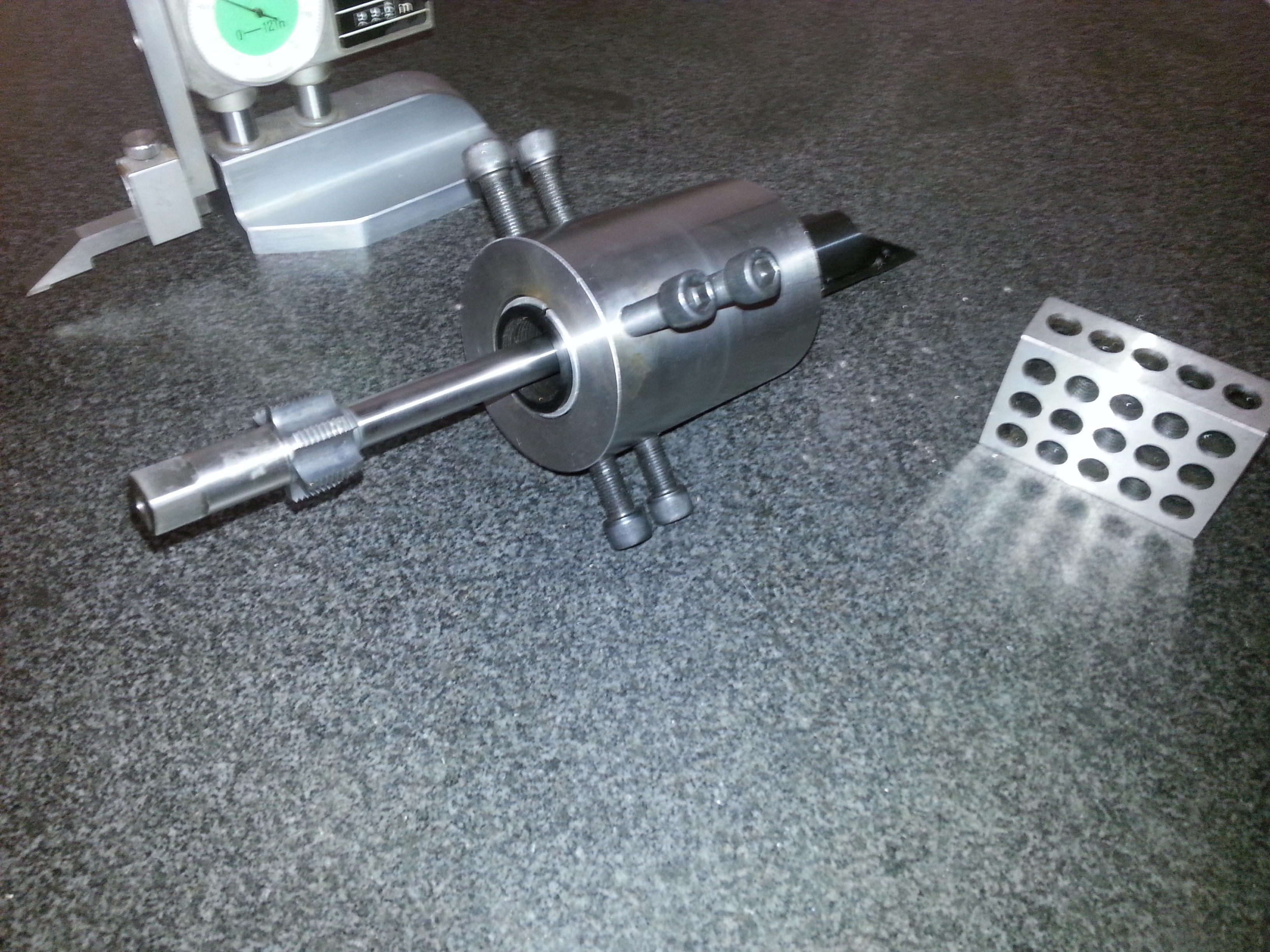

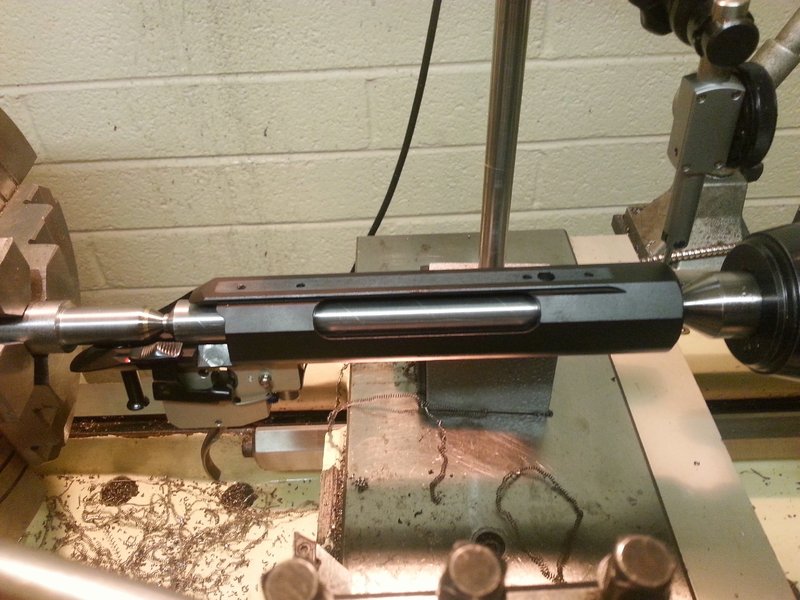

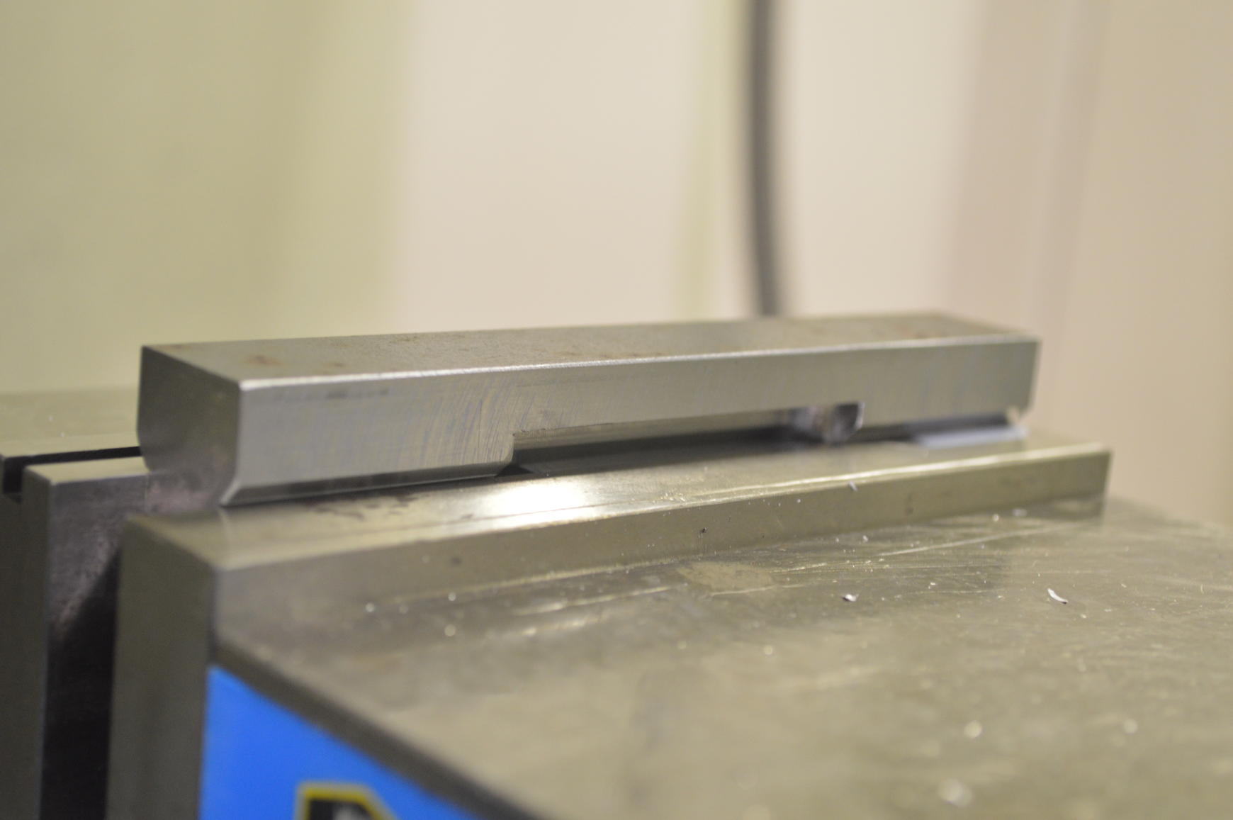

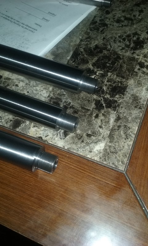

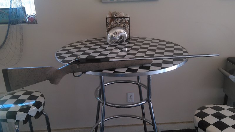

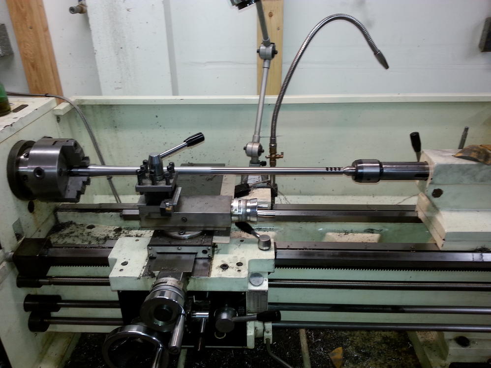

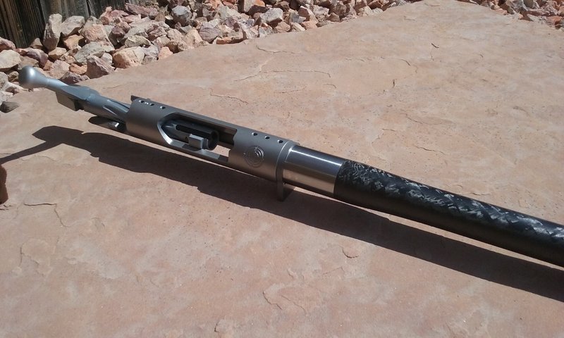

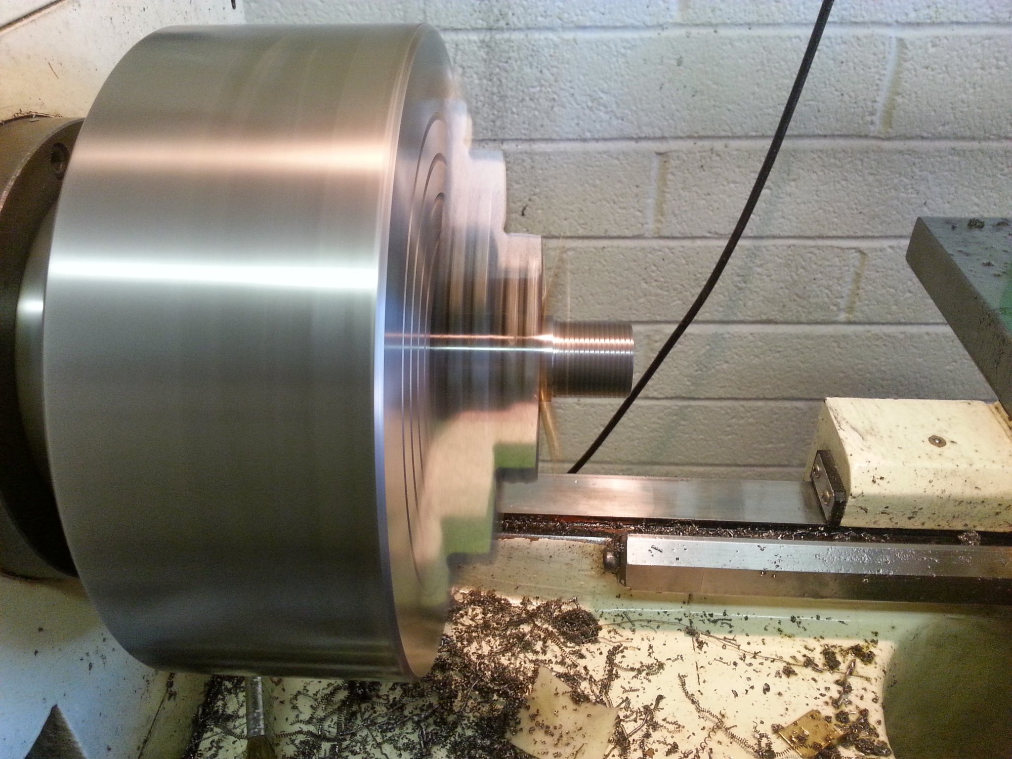

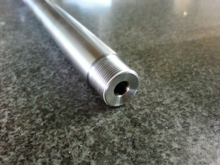

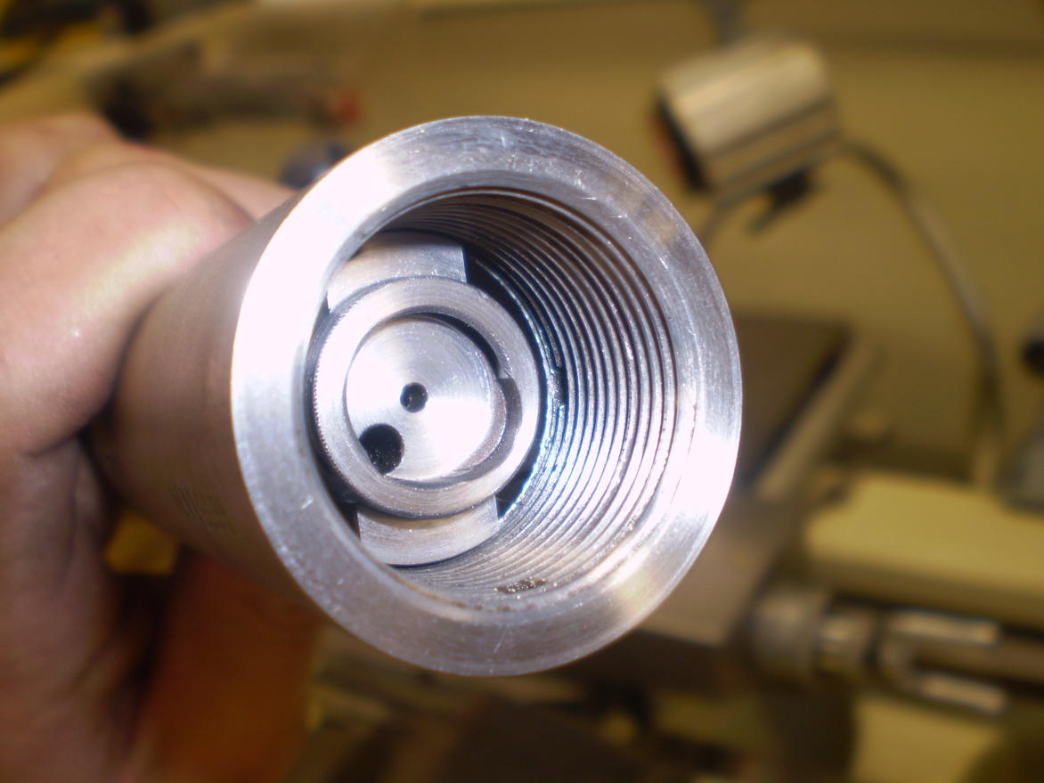

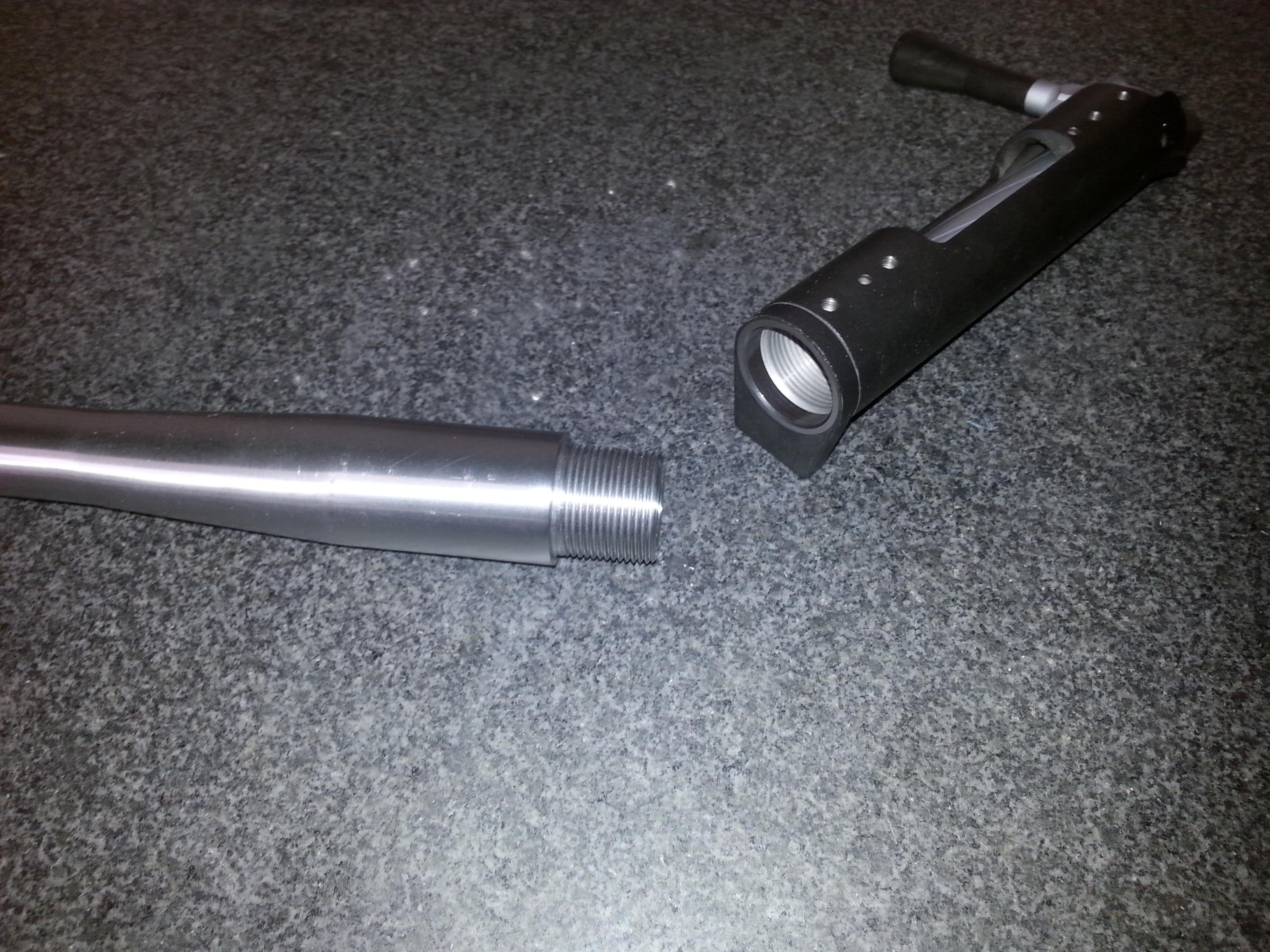

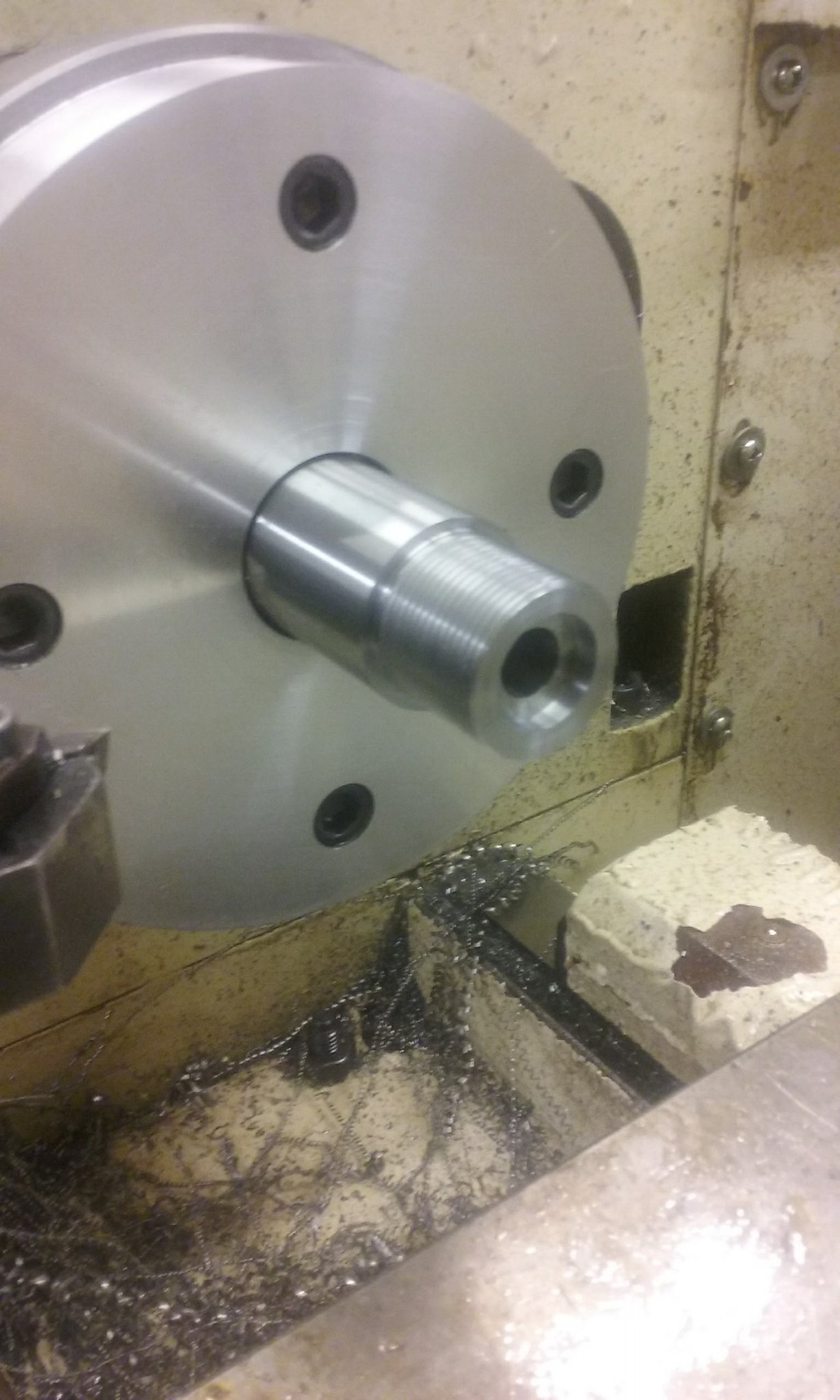

had a few pictures lying around and thought id show some of them to the fellow enthusiasts.
An old model 7 Remington spruced up and chambered in 6.5 creedmoor. Stock is hydro dipped in muddy girl cammo, full length bedded and free floated, scope base holes are now 8-40, rear action screw is now 1/4-28, ptg lug double pinned, brux # 4 barrel 1:8 twist 26" . The girly loves it :)
Dude that is fantastic! I'm a hobbiest armorer and basically assemble rifles for my own use. I'm a Savage junkie because they don't require the kind of work you do. I own a healthcare consulting company as my real job but plan on selling out someday and doing real gunsmithing (not that I'll make the same amount of money! LOL) Willing to take on an apprentice! :cool:

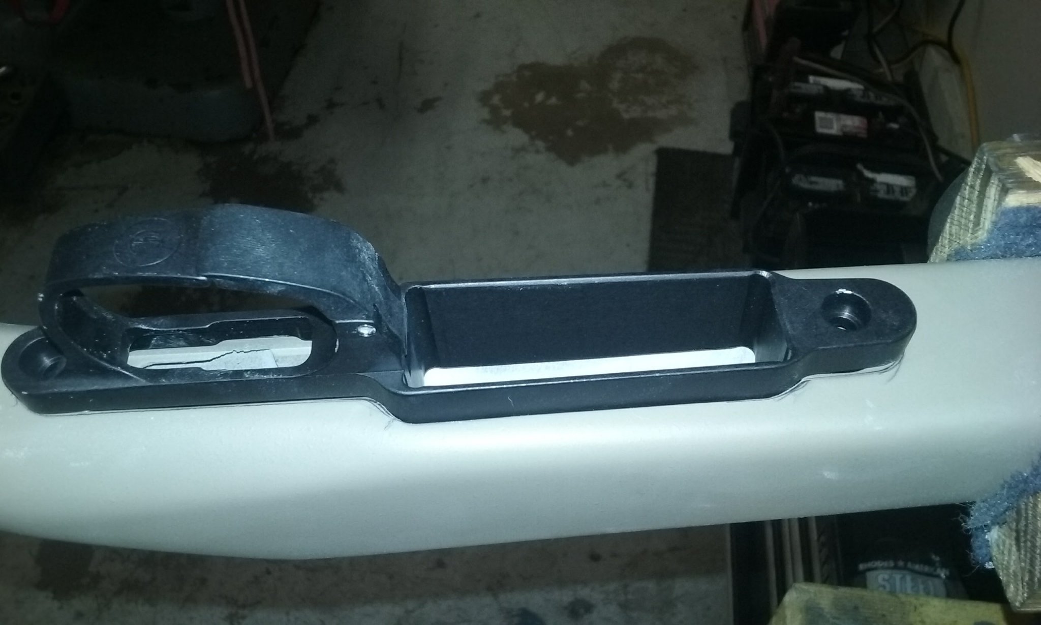

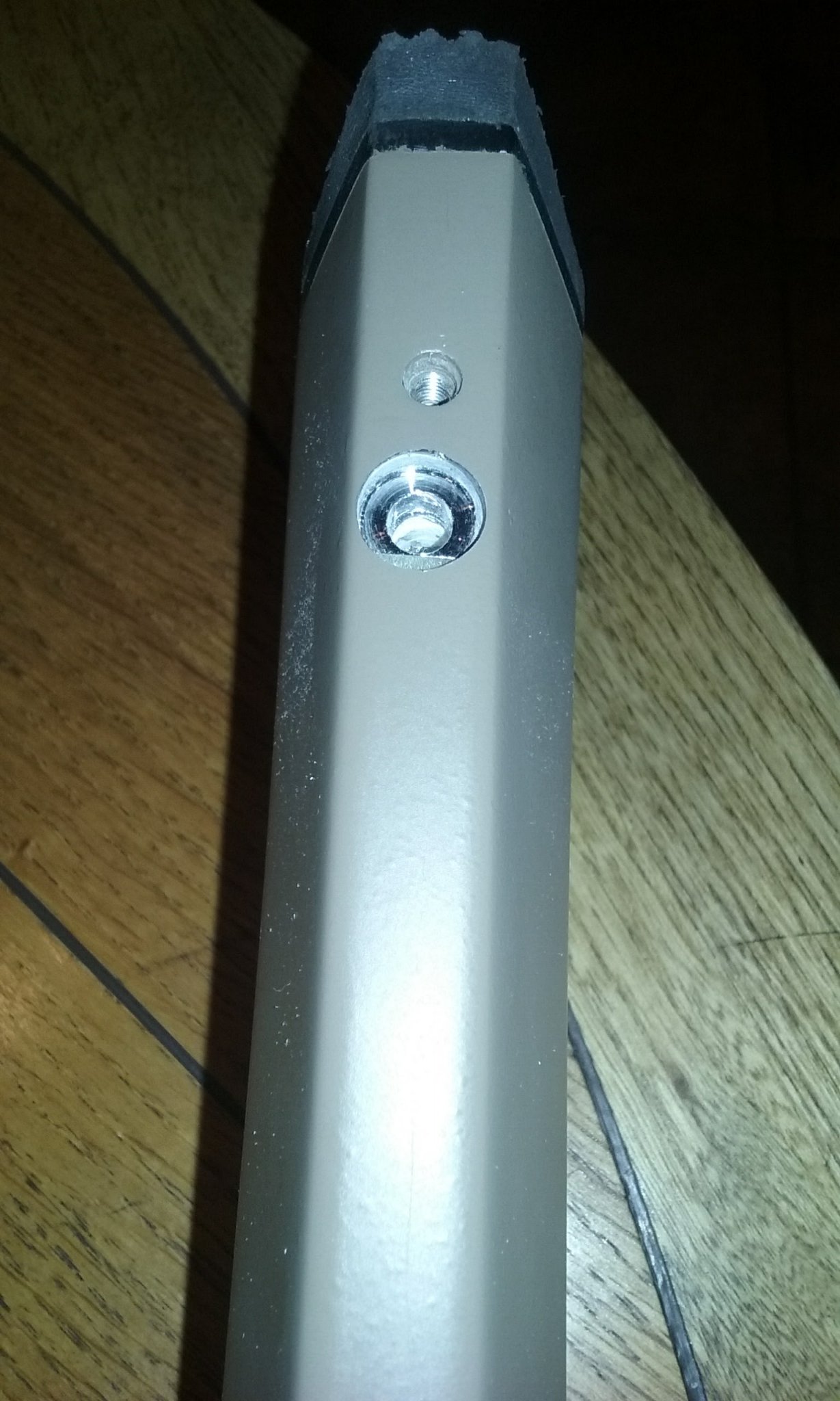

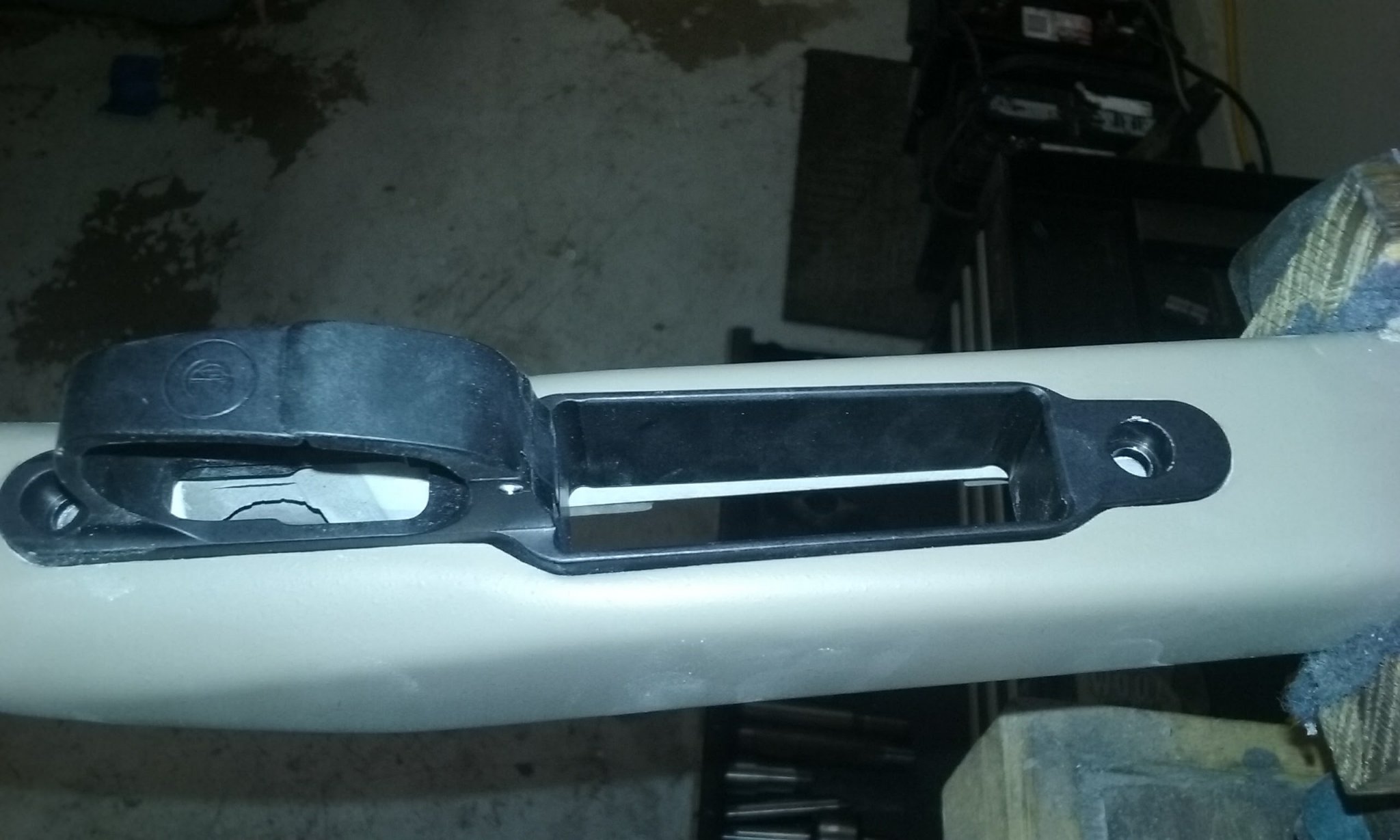

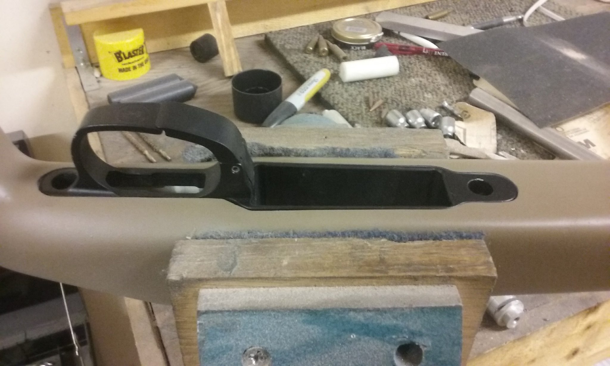

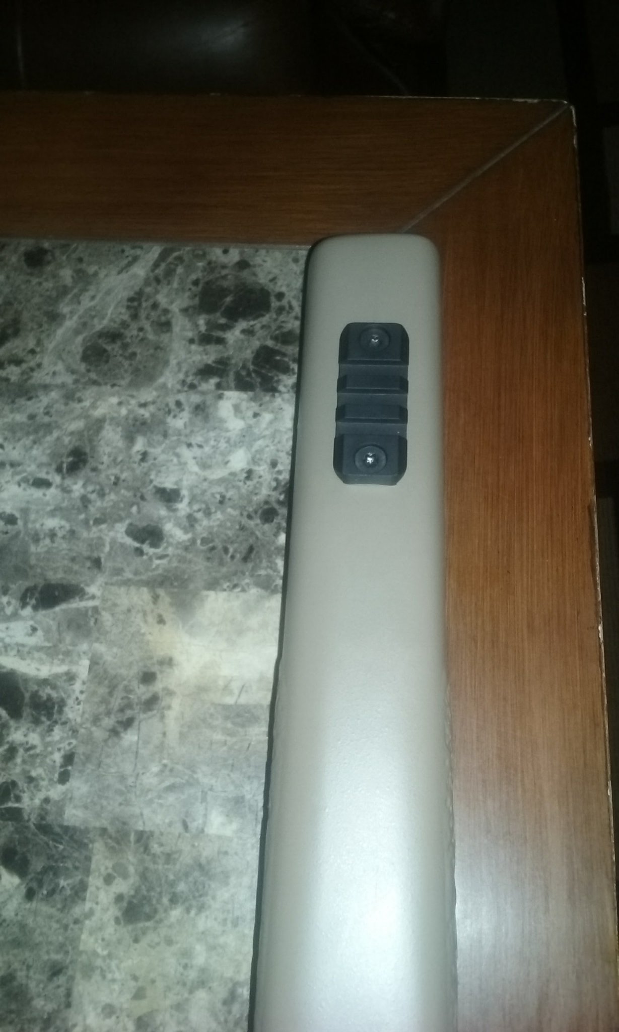

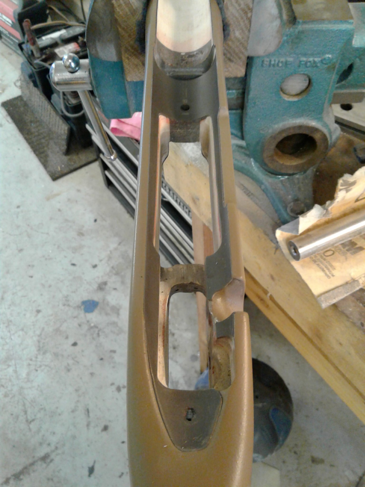

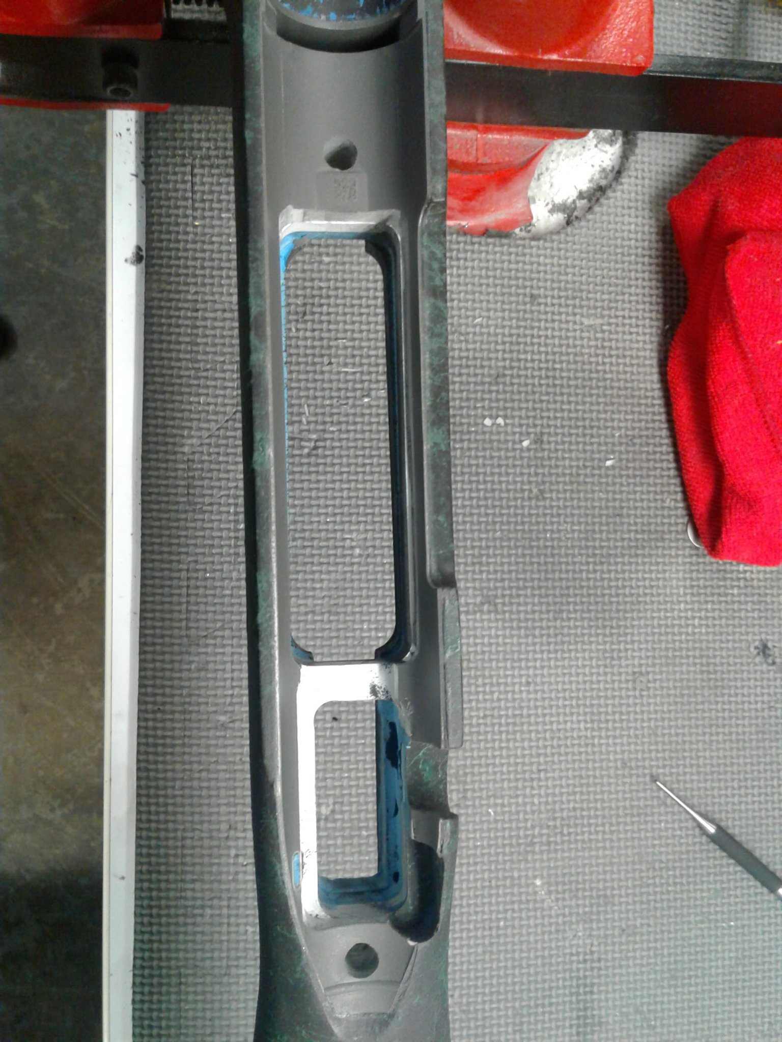

Doing a little stock work.
fitting bottom metal, adding a pic rail for an atlas bi-pod and a quick detach sling stud.

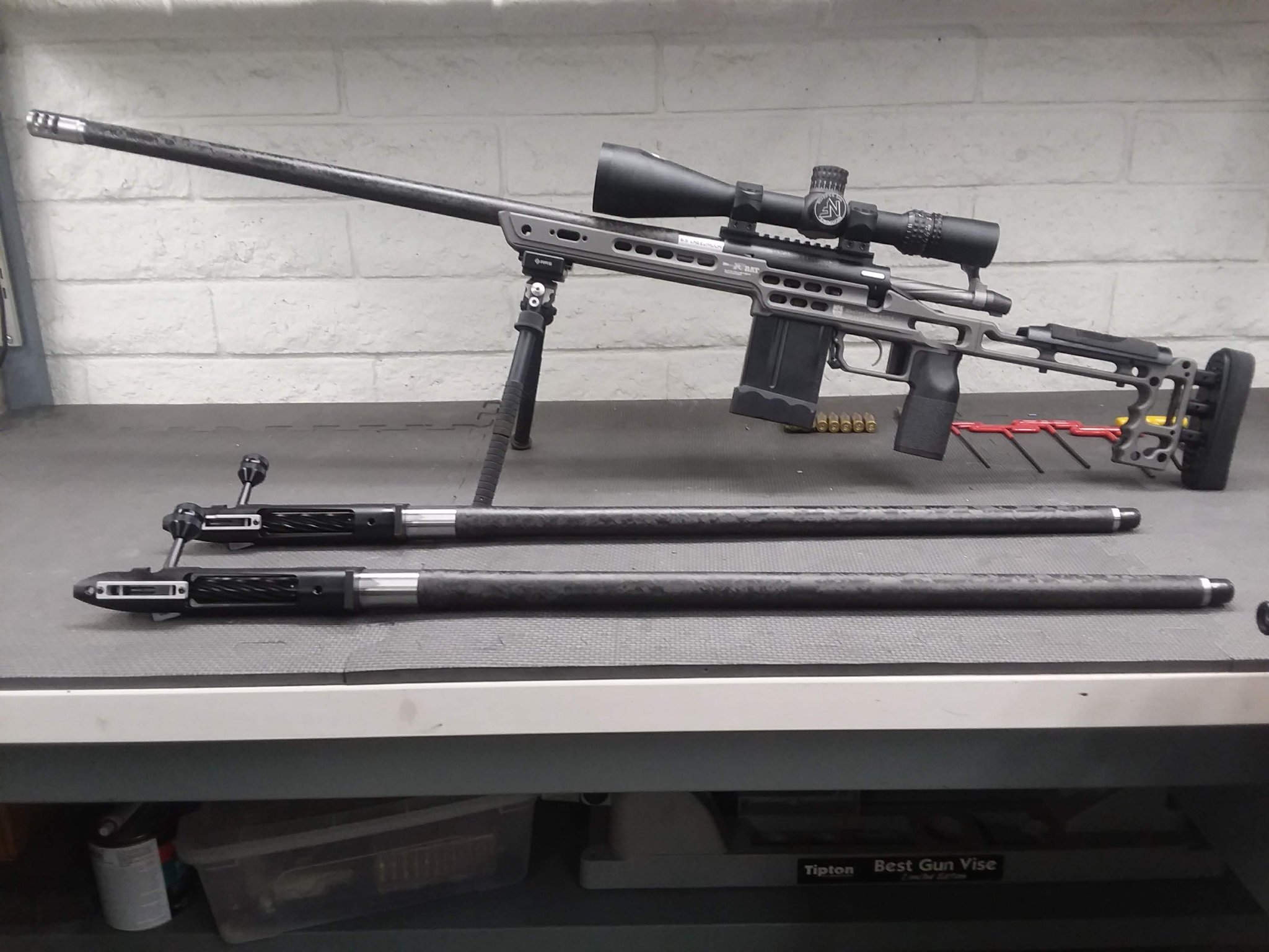

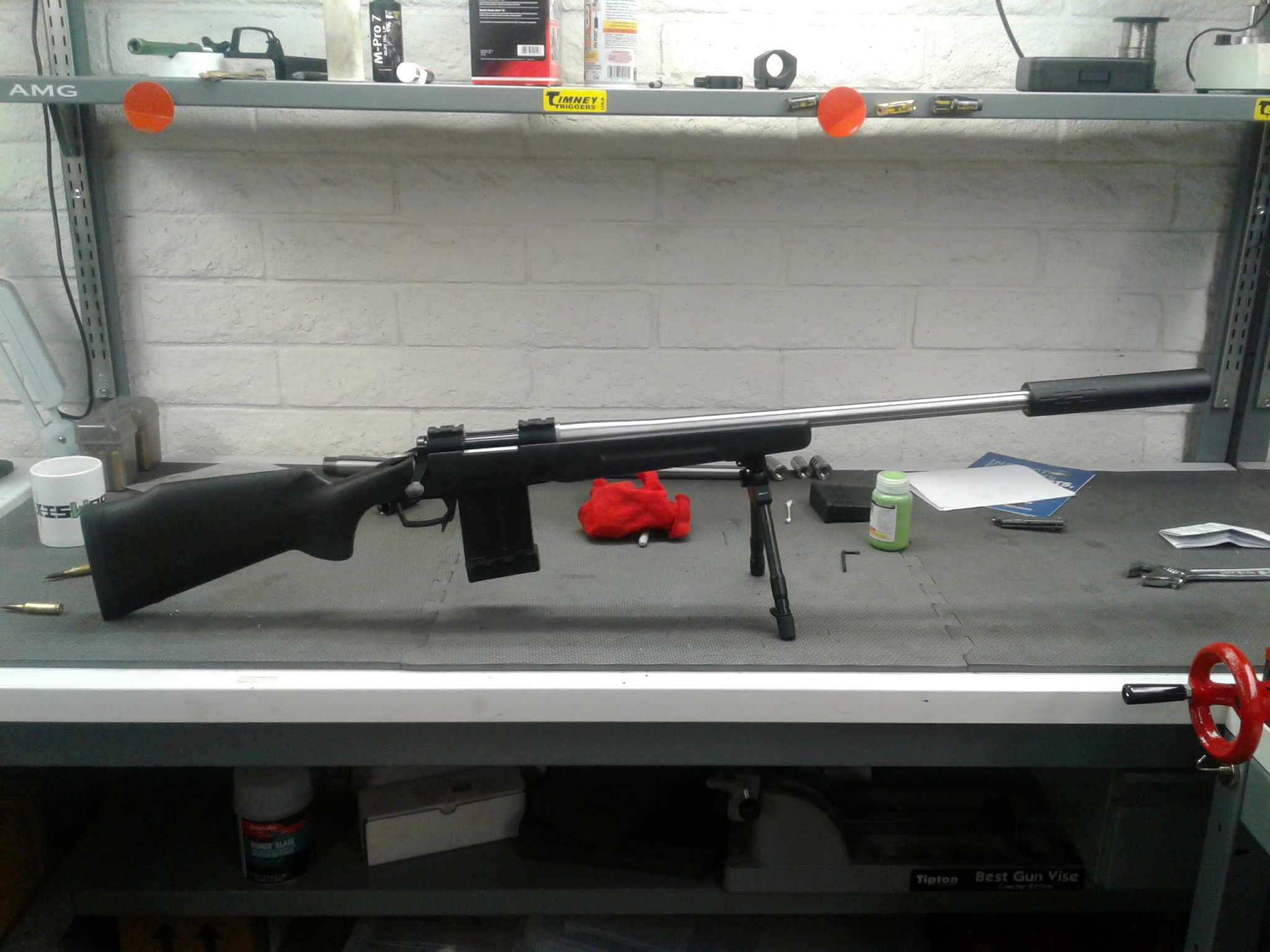

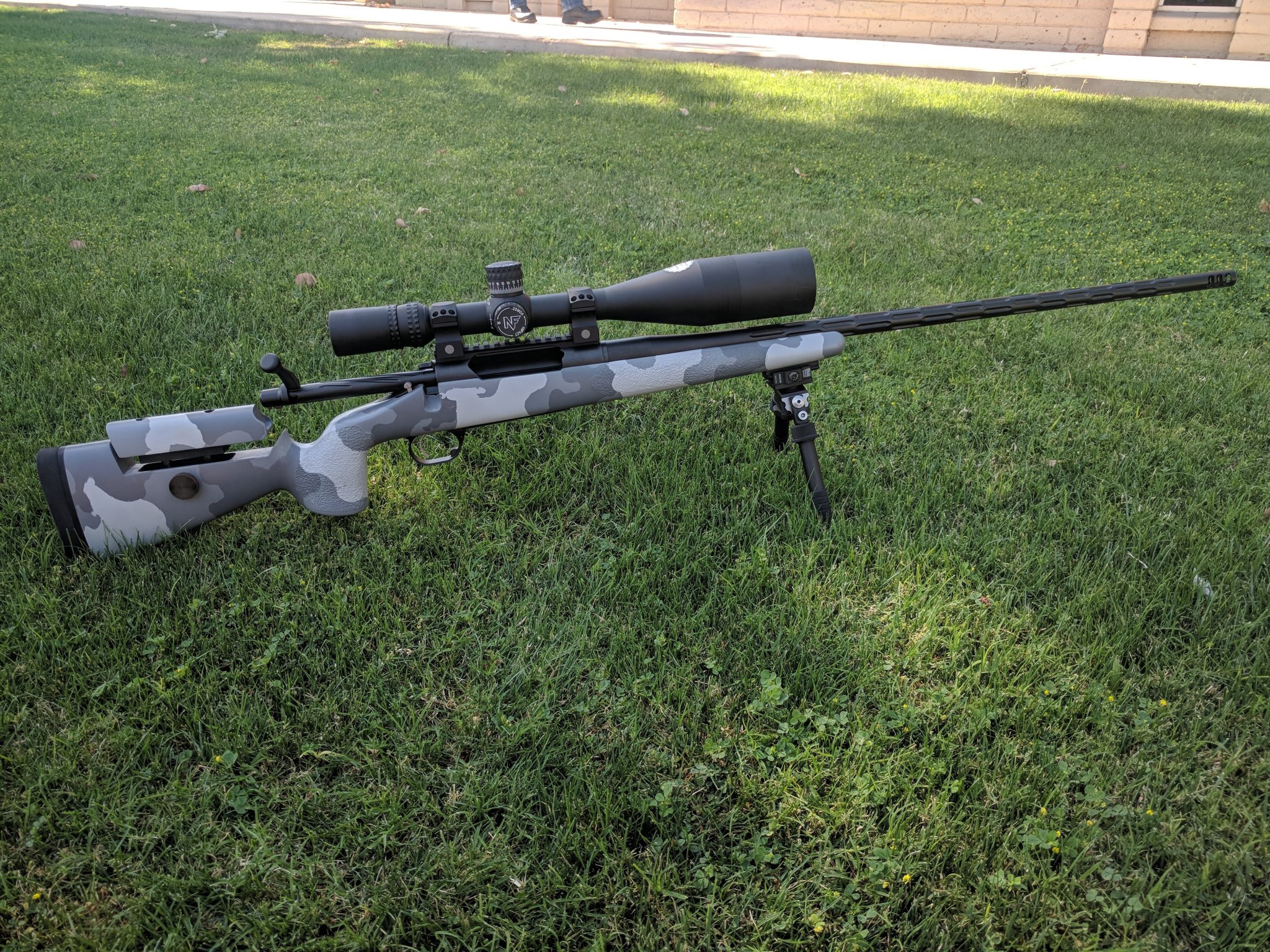

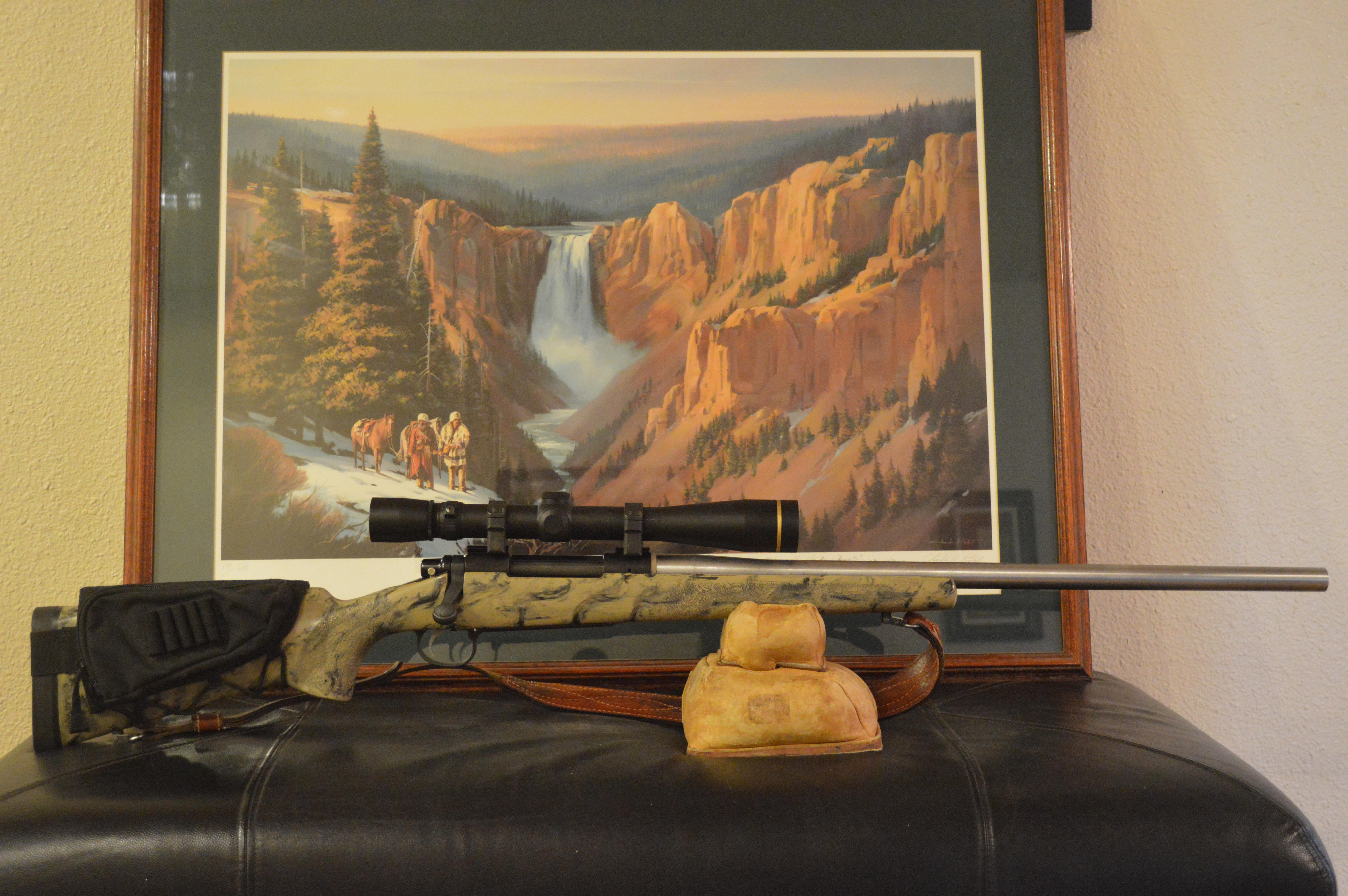

digging through the photo album.
