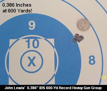

World record 600 yd. 5 shot group.
Are bench rest groups in competition really shot that quickly??
Yes most are. In good to moderate conditions nothing is gained by shooting slowly as a subtle unseen change can move the bullet a long way. In tough changing conditions I'll slow down and try and read the changes and hold accordingly. There is a winner for group size and one for score. In good conditions you go for both. In bad conditions I go for score and get zeroed so that any change will, I hope, improve my score. That means a zero favoring say 3 o'clock knowing that in a change or let up in this case the group will move across the target towards the 9 o'clock position. I'll get to measure that target the end of the year to certify the record.
It's a totally different technique than a field rifle but I am no less impressed by the accuracy. Didn't someone at that club shoot a group slightly larger with a 308 and 155 Scenars a few years back?

This is the group I was referring to:
John Lewis Shoots 0.386" Group at 600 Yards with Home-built Gun « Daily Bulletin
I didn't realize how well those rifles tracked in the bags- that was amazing. It looked like little or no correction for each shot, just push the rifle back forward to the start position, take a quick peek, and let the next go.
Not exactly point and shoot. Those are sand bags front and rear. No rails on that rifle although they are allowed on the forearm. Has to be a regular sand bag on the rear. Good actions, FL dies and technique make it smooth. Then tuning the rifle is another skill set.
