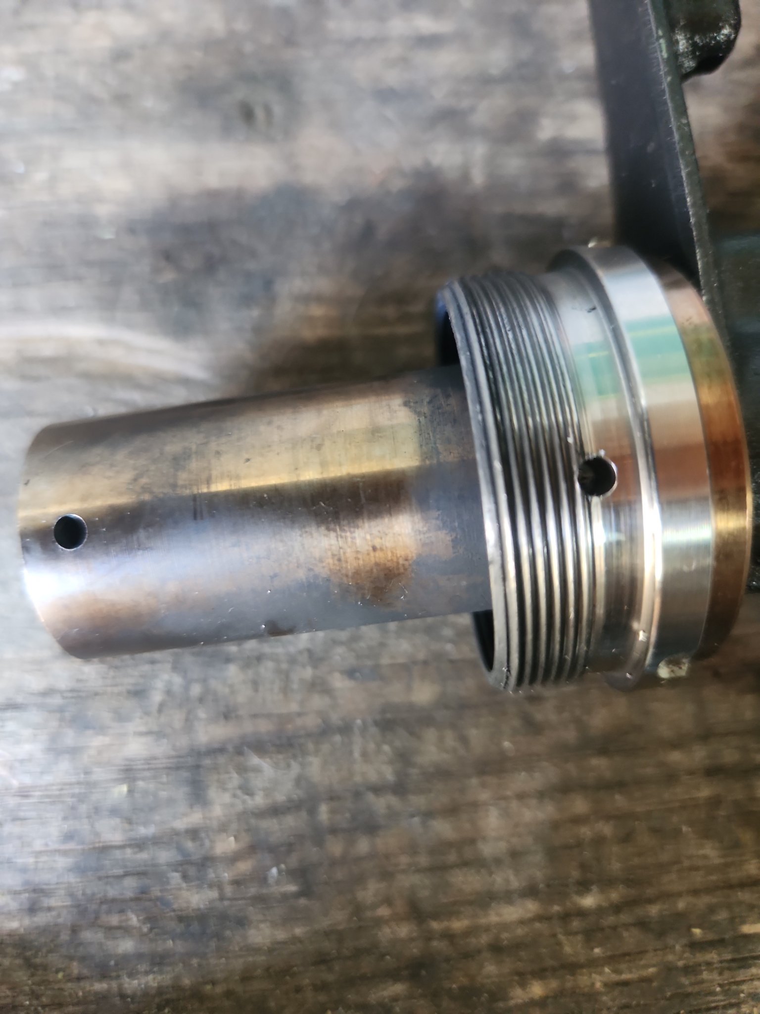

Pinned one of mine (6.5" F1) on a reflex type adapter, to a 11.5" upper. Couldn't be happier that I did it. It's my Gordon type rifle, so it fits.
Wouldn't do it to all of them; but some of them.......absolutely.
Mine in particular, can remove the distal end cap, and pull the stack from the front.

This is what I used:
https://quelltech.shop/product/asr-otb/
I had to grind off the bayo lug, and custom make my "timing shim" to get things perfect. The can I used is 1.5" ID, and had a large blast chamber, so I volume loss was not too concerning. It also has a 17-4 diffusion wall as the first baffle, so reflexing the muzzle deeper was also of little concern.
Here it is, pre lightning stick:
