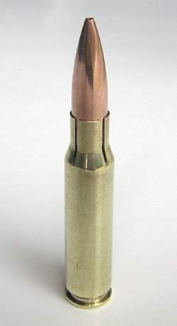

No need to disassemble the bolt.
FL size a fired case and bump the shoulder .002”
Cut a slit lengthwise down the neck into the shoulder. Deburr the slit.
Insert a bullet into the neck. It will slide in and out with moderate resistance.
Chamber the round, push the case all the way into the chamber until the shoulder bottoms out. The rifling will seat the bullet.
Push the round out of the chamber with a cleaning rod carefully.
Measure the OAL.
Measure the OAL.
For illustrative purposes
