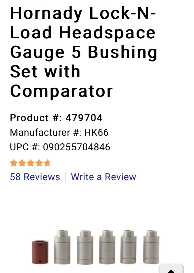

@OP,
Do you use a headspace gauge like this one from Hornady, or something similar:
Other companies make them too.
Vernier: My original $13 made-in-China vernier was very inexpensive and very inaccurate, and could easily be off by 2 thou.
Dumped it and got an absolute origin type of vernier (“i-gauging” model), which is super consistent. Mitutoyo makes a similar vernier. These absolute origin verniers are both accurate and consistent. A little pricy ($45), but worth it imho.
