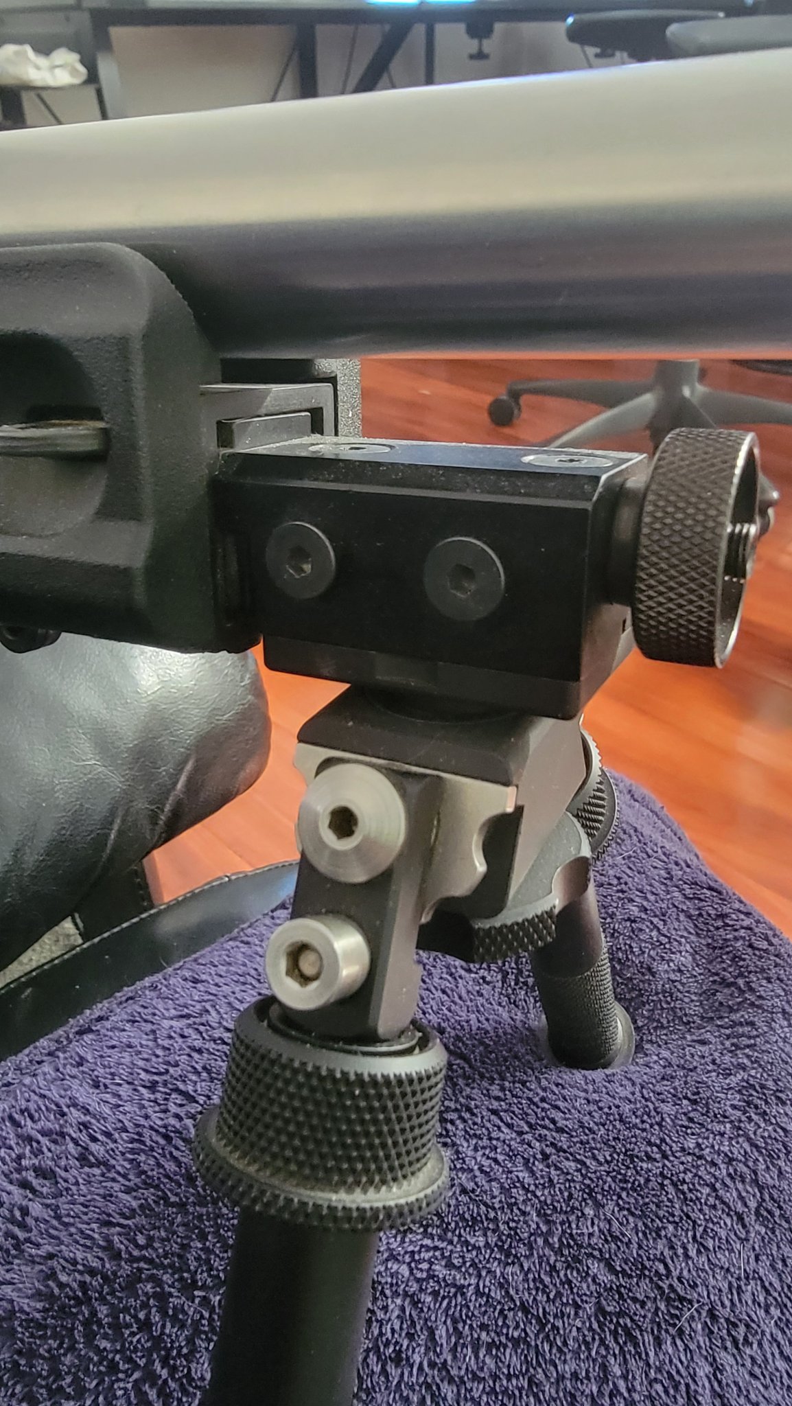

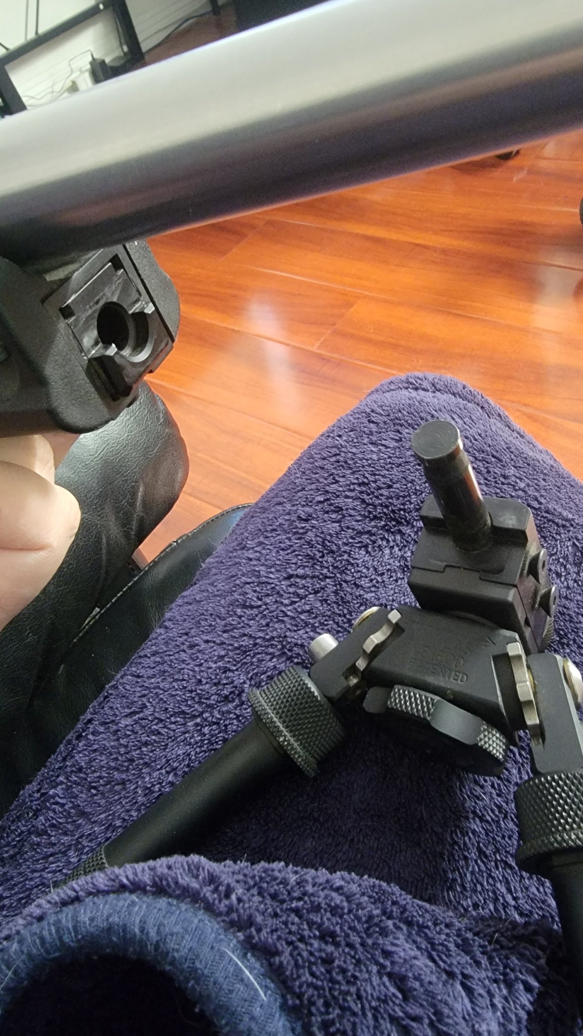

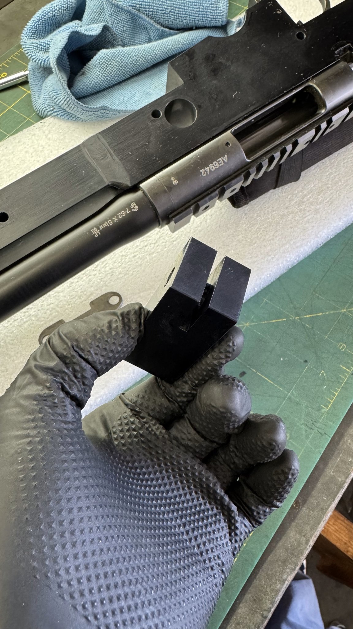

I'm looking for the factory AI spigot mounting block with male or female arrangement to use with Parker Hale bipods.
My rifle came with the solid block for use with a Harris bipod via sling swivel.

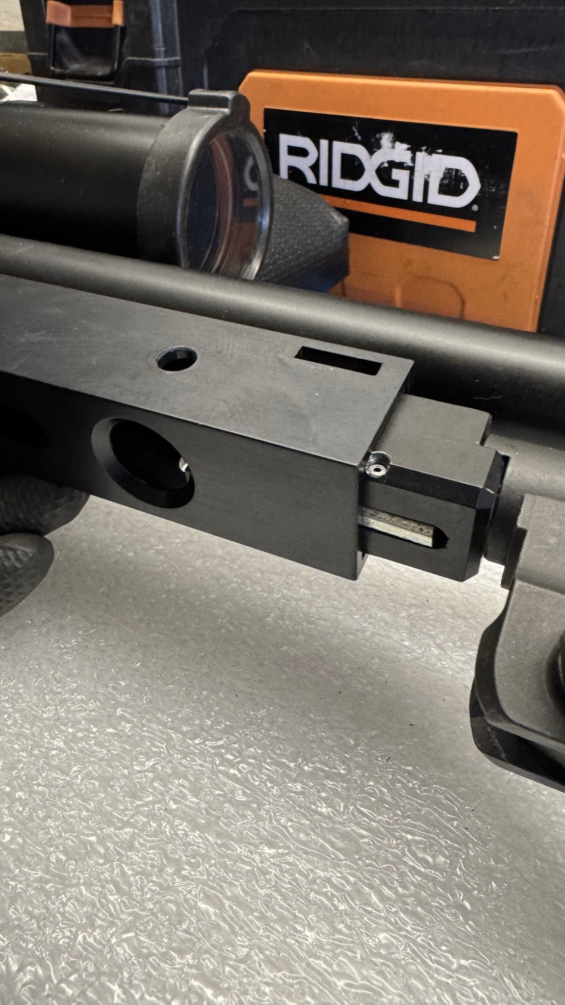

Hard to tell from your photos, but is your chassis set up for a regular AI spigot block, which are all “female” end only and require a spring loaded latch to secure the male end of Parker Hale style bipods. The bottom of the chassis fore end needs to have a slot milled out of it for the latch to slide through. I don’t think I see this slot in your chassis?
I do have a long slot in the bottom of my chassis. as well as a circular hole below the spigot mounting block.
HOWEVER, I do NOT have a slot cut in the bottom of the chassis as part of the square opening for the mounting block.
So effectively, there is no space for the latch unless I cut one.
The Parker Hale bipod I have is male. So it can only be used with the AI spigot mounting block as far as I know.
My friend suggested drilling a hole in the Harris AI block to add a spigot and then looking for the female Parker Hale bipod.
I'd really like to run the PH bipod even though I am aware there are better performers. I'm going for a quasi "period correct" look on the rifle.

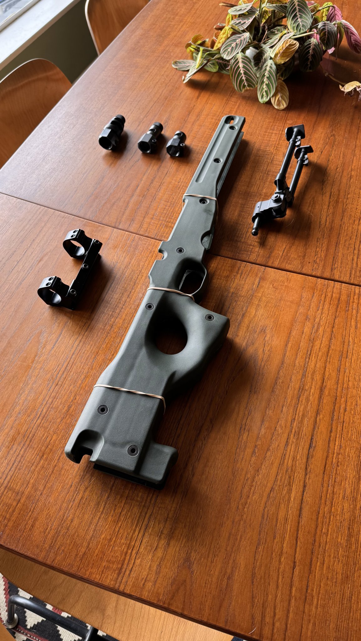

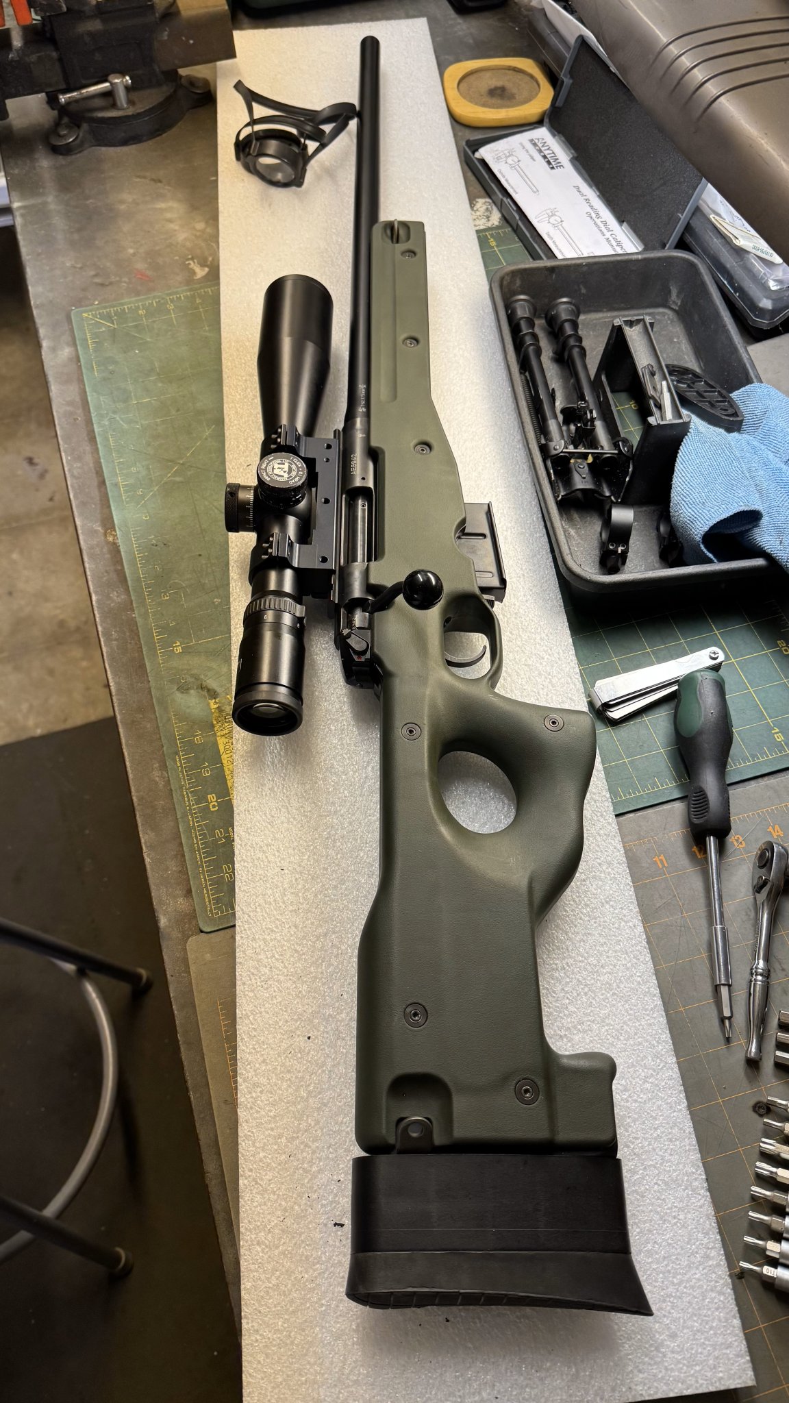

I mounted a S&B 4-16x50 in the AI unimount and I'm going to thread the barrel for an AI brake.

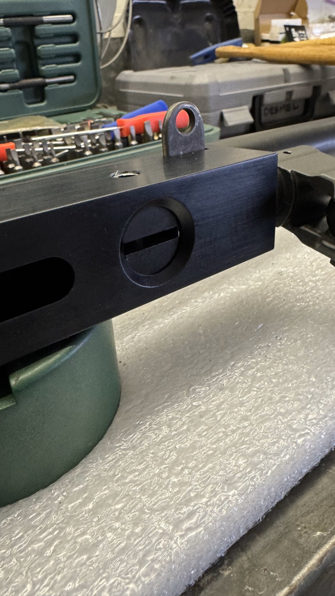

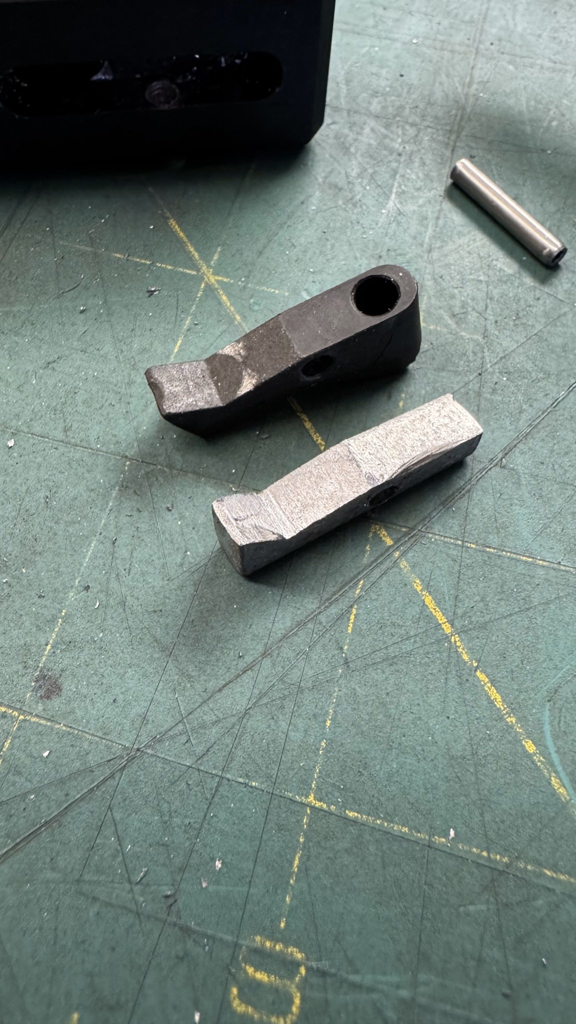

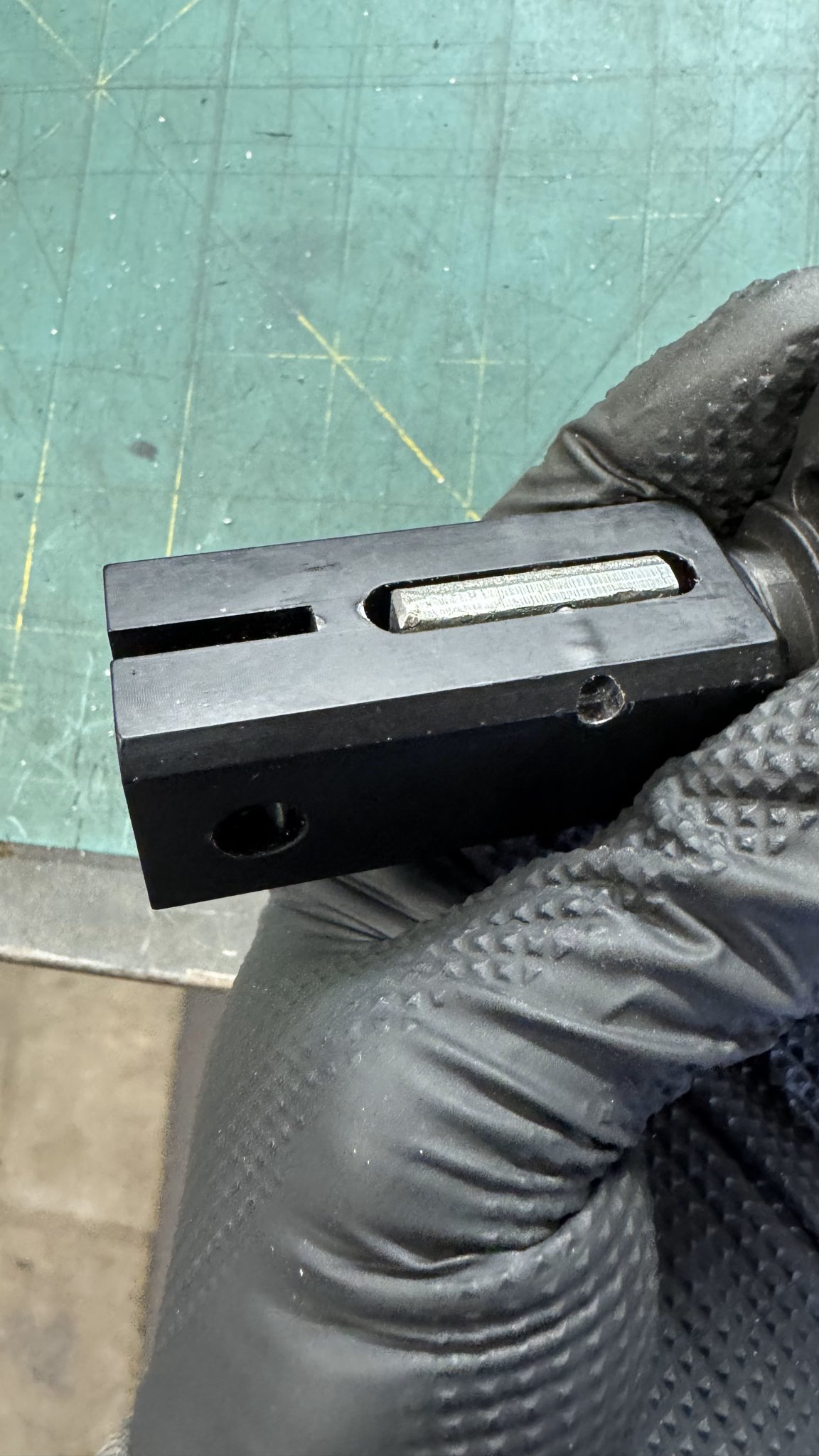

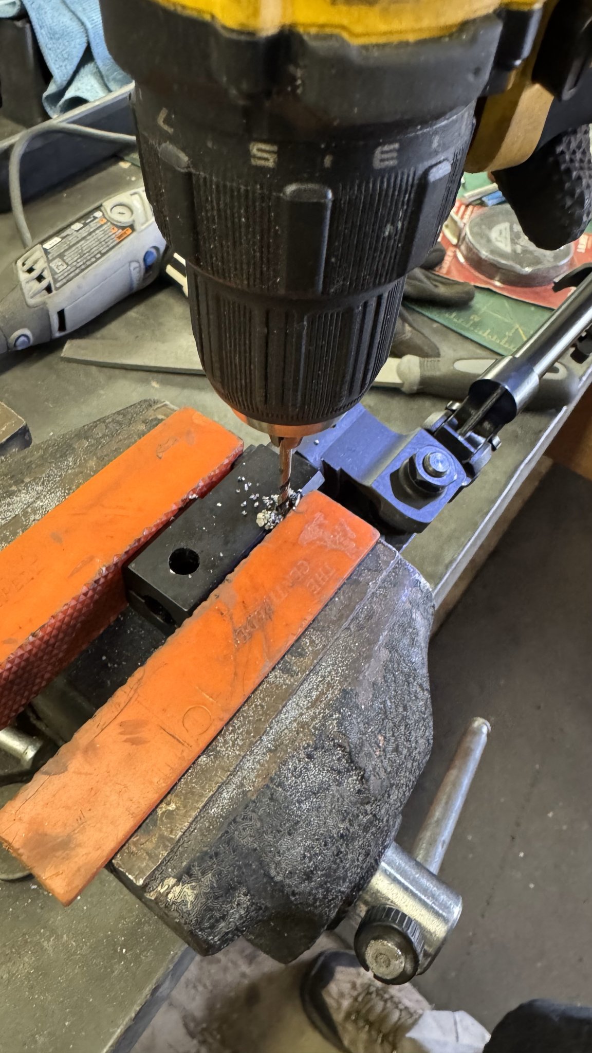

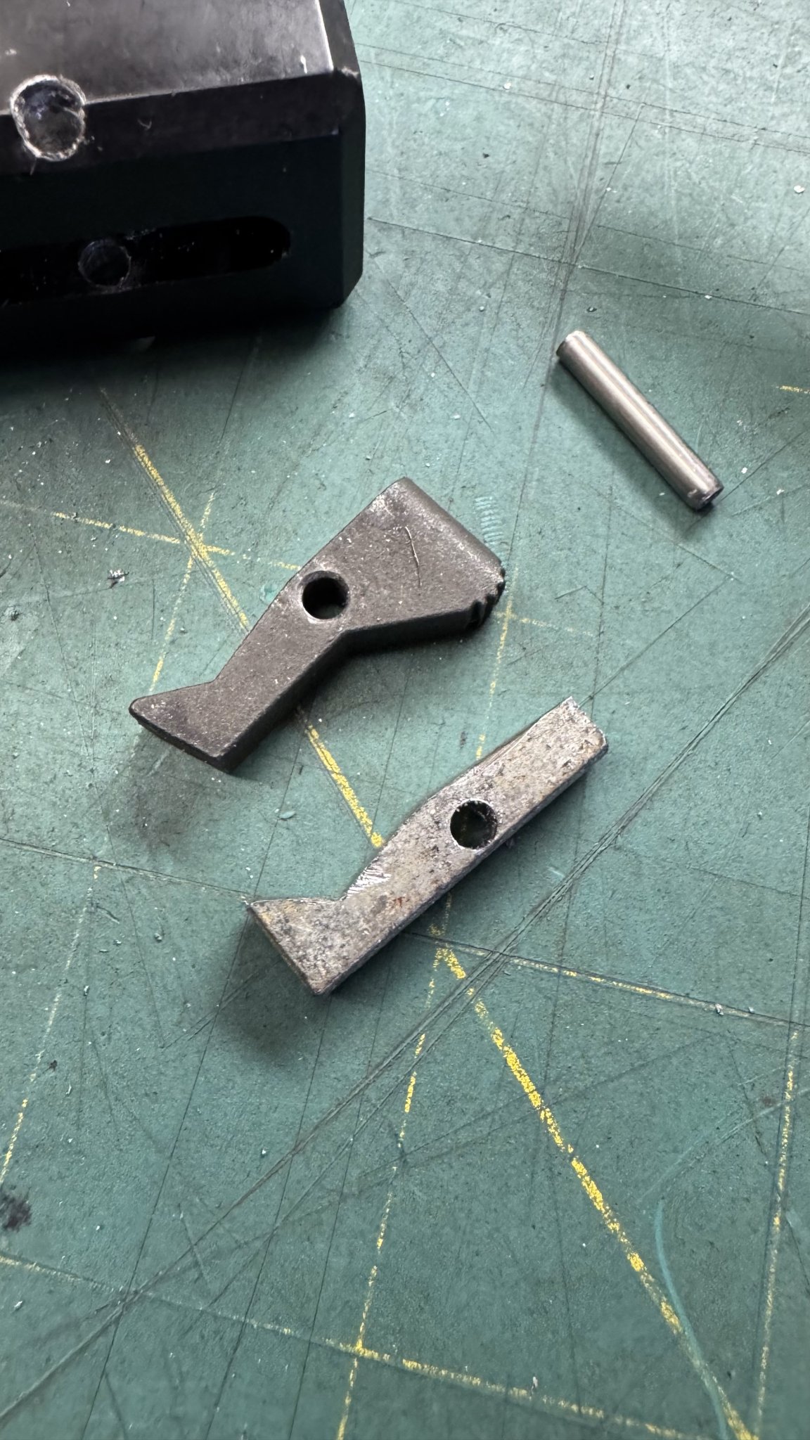

was generous enough to send me a spigot mounting block. I was looking at how it locked on to the Parker Hale spigot and how I might be able to use it with my chassis even thought it lacks the slot for the latch. I got to thinking that if you didn't need to remove the bipod you could make a new latch that would be trapped in place by the bottom of the chassis. So that's what I did; and it worked.

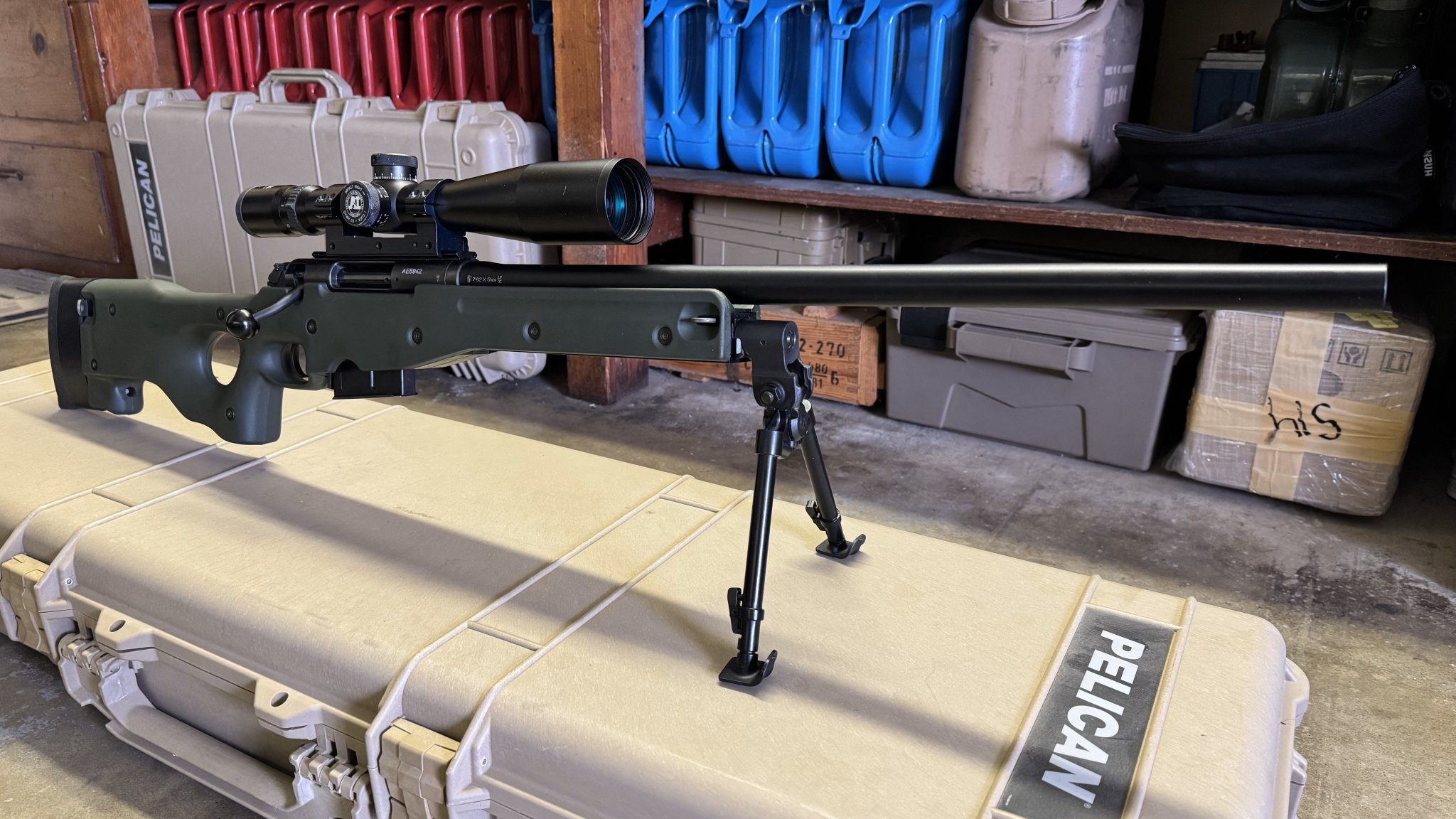

I'm pretty happy with it for now because I didn't alter the rifle and I can even return the spigot mounting block to it's original configuration. I am thinking that in the future I might swap to the spigot adapter for the female Parker Hale and then I would be able to detach the bipod.
