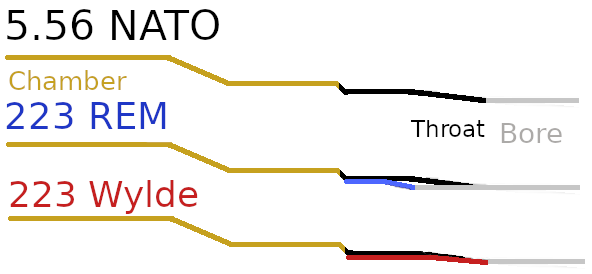

    Fancy picture:
    My train of thought is this:
    My present rifle is in 556 chamber and shoots plenty fine.
    But I cannot know how the next barrel shoots and apparently wylde gives inherently more precision.. And it never hurts to have more of it.

    Correct, the Wylde will give you better accuracy with no downsides. Anyone that says the 5.56 chamber is larger clearly cannot read chamber prints. The throat is not part of the chamber where the brass sits.
    Reactions: Jsp556
    You should pull up a print of the specs on the Wylde chamber. You haven't included any of the chamber differences in your fancy drawing.
    That said... there's no accuracy problems provided all the rest of the chambering was done reasonably well...
