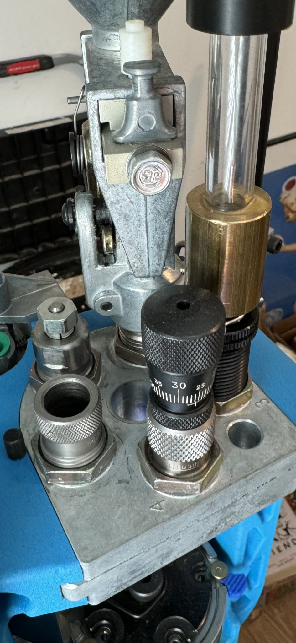

Hi Guys, Im having some minor issiues on the XL650, when loading 9mm Luger I get lot of bullets not fitting the case gauge, Im using once fired winchester brass that I pre clean in a wet tumbler with stainless steel pins and some lemi shine. I then place all into a dehumidifier to dry. I fill the case feeder and before I start to load I run some dummy loads so I can adjust if required. When running I find that out of 100 bullets 10/20 dont fit my wilson case gauge and Im constatly readjusting the seating die. If this has been discussed can somebody point me t the thread or if you have some information you can share.
Is the case hanging up because of the bullet or the brass? Possible it could be either or both maybe?
I assume your sizing die is not working loose and you have it properly adjusted down, machine adjusted proper etc. Also assuming case gauge is good to go.
Do the rounds that fail case gauge chamber ok? You may not need them to be minimum spec... though personally I like them to be so they run in EVERYTHING.
Mixed brass can do this as well as brass fired in loose chambers even if it's the same lot of brass. Glocks can do some fun things to it as well without being "loose" by factory standards.
Something like a small base die or a glock bulge remover may help? I wanna say the one I got is called an undersize die.
My Dillon dies do a nice job, but my 1911 is tight. I get the same thing happening if I don't use that undersize die. My glocks and carbines eat all the regular stuff, but not that damned 1911 lol.
Looking at the bullet and you having to move the seating die.... assuming it's not working loose and your bullets are consistent. Is the case mouth belling consistent as well as the crimp at the end? Is the case VERY full of powder causing the bullet to bottom out on powder in some cases or even pushing it back up a little?
Some measurements and photos would be helpful on the good vs problem cartridges. Can you sharpie or soot up a dummy cartridge and maybe see where exactly it hangs up?

Ok, I re adjusted my shell plate to have little or no play now after reading your reply,
  • Im using a wilson case gauge
  • Im also using the dillon sizing die
  • The rounds in question fail to chamber but fit in the case gauge flush, but they do not just drop out when I invert the case gauge
  • loading 124grs using RN HPCB copper plated bullets
  • Using all the same brass (winchester)
  • Now the Pistol I own is the Colt 1911, I only recently purchased this and started loading for it, I also tried these in one of my friends 1911 and they also jammed.
  • what I did last night was take your advice and tighten the shell plate slightly, so I have little or no rocking motion but still travels smoothly and then re ran the a few rounds that did fall out of gauge in the die and now they fit and dropped out nicely.
  • The seating/crimping die specific for the 1911 from double Alpha.
  • I will over the weekend give it another go and check 20 rounds one by one and then check to see if the chamber.
  • I may also order one of the undersize die you mention.
Thanks a lot for the help much appreciated.
Will let you know how i go once i get the new die

Great Idea, we definetly try this first, I have purchassed deprimeing and Undersize die (havent uased it yet) but will try your advice re stop after the sizing and check that.

ok, I also have the Mr. BF powder funnel for the 9mm and the Mr.BF, the DAA seating and crimp and I just cant seem to dial that last station in properly and have replaced that with an RCBS 20562 tamper crimp seating die over the week end but had some family comitments and could set it up.

I havent had any luck with the first 50 odd rounds, like I said some fit the gauge but then dont chamber correctly or very tight, others get stuck in the chamber.
Those DAA 2-in-1 dies are notoriously hard to setup and get to work properly (if this is what you're talking about: https://www.doublealpha.biz/us/daa-2-in-1-seating-and-crimping-die). I can't help you with that one...
