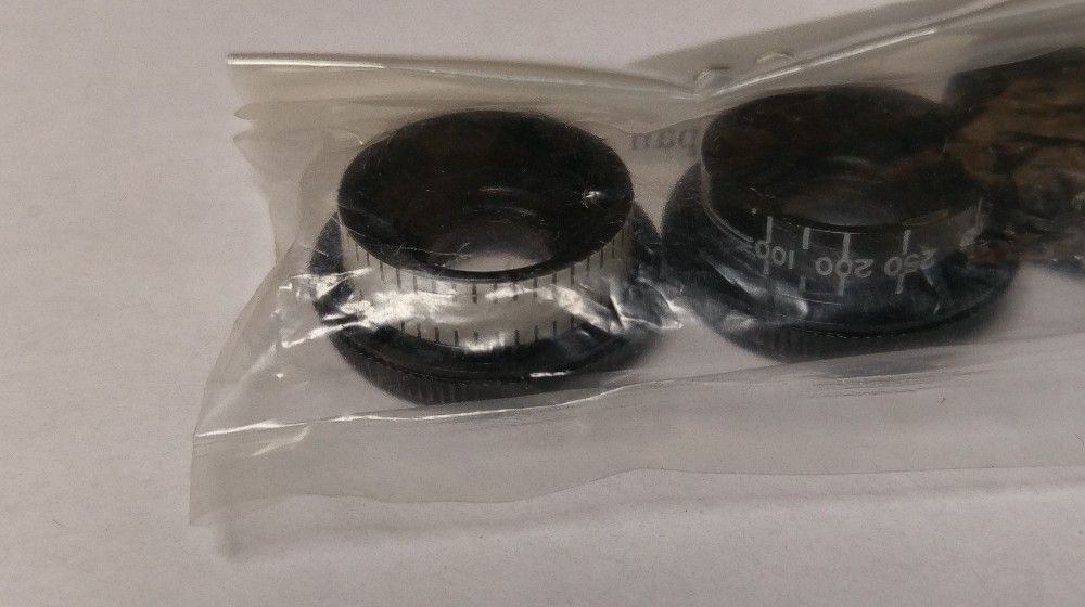

    So Burris has the XTRIII coming out soon, and for me personally having a bunch of the XTR2s, I think they have been a good scope for the money.
    With that, I was looking at the new XTR III and saw the Race Dial,
    I think this is a good idea, especially for comp people and those who handload among other uses.
    It's an optional thing,
    You don't have to use it, but I like the idea of it
    So is it like a dope card for the turret? Figure range to each target on a stage. Indicate adjustments on the scope "ring". Erase and GTG for next stage?
    Put your own yardages on the dial. Tailored to your exterior ballistics. Instead of mils. It can say 200-300-400-500 and so on to whatever you wish. Count clicks when you need to adjust for a follow up shot.

    This will be a replaceable turret. Loosen the screws, remove the existing turret, drop the new one on. Tighten the screws.
    The windage turret is also replaceable with either the capped or uncapped turret version.

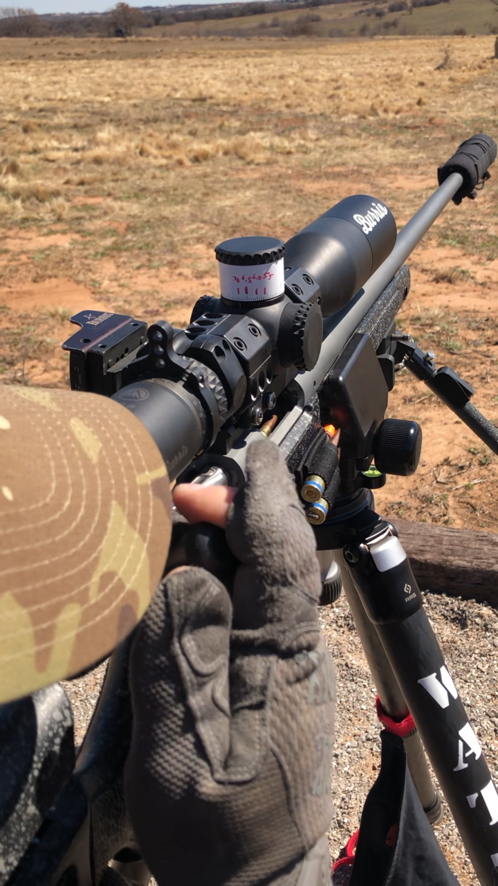

    First race dial in action last weekend in OK. You can mark the target distances, then write the target indicator or wind above the distance...
    Very impressive feature.
    and you don't have to use tape. use wet erase and it acts as a wet erase board. if that saves you 3 seconds a target not wasting time looking at your arm band or dope card per target and you shoot 10 targets, that's 30 seconds you saved to continue shooting...in other words, Priceless!

    the knob isn't tape. Its a whiteboard that's also impervious to acetone incase some other PP uses perma marker instead of wet erase.
    you only use tape if its raining. not needed 99% of the time.
