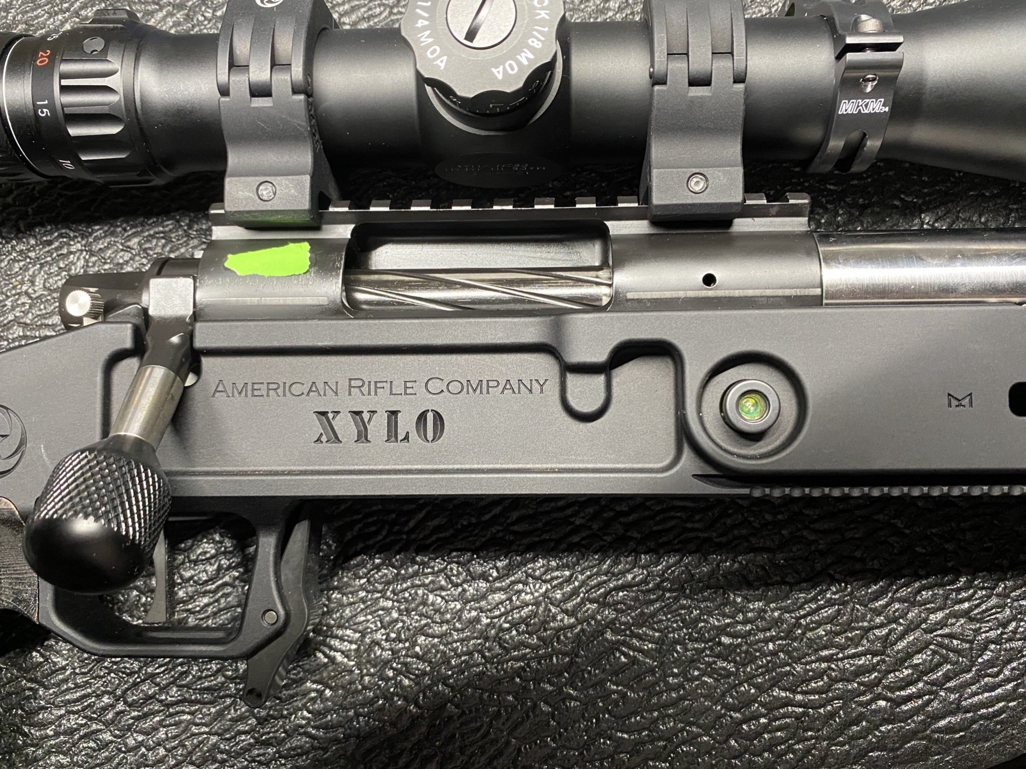

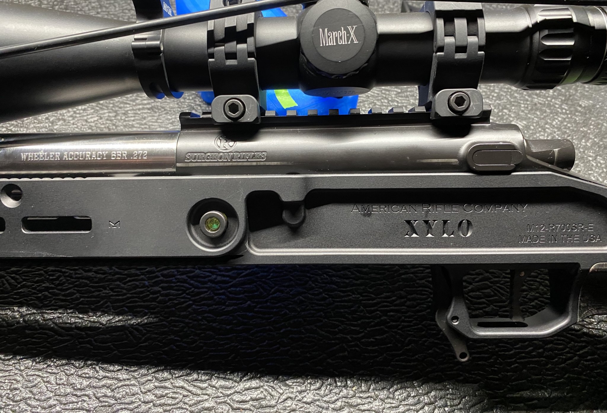

Is anyone running a Surgeon 591 action in a xylo chassis. I'm wondering because the side bolt release is large and low on the action. I called American Rifle Company and spoke to Justin. He wasn't sure if it fit. If anyone is running this action in a xylo please let me know and post a picture.
Hope these pictures help. No alterations were needed on the action or chassis.
Here is your FYI:
These stock use a M12 recoil lug clamp. The standard (and what came on mine) has a thickness of 0.185”. For the Surgeon action you need the 0.25” thick model. So, ask for yours to be swapped before it ships or purchase the .250 lug clamp.
