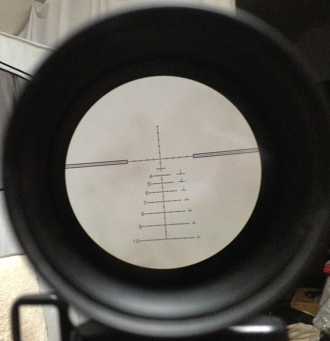

It is best to use one rifle, load combination with the scope, otherwise if you plan on switching ammo or moving the scope around, as suggested stick to straight Mils or MOA. With that your dope is the same whether you hold or dial, they work together every bit as accurately not separately as in the past. (Understanding and Proper Instruction on the Use helps)
Here is one that was put together for the military. (Mk11 Mod 0, 175gr 308) it has mils and the BDC and on my 16" GAP 10 is spot on.
