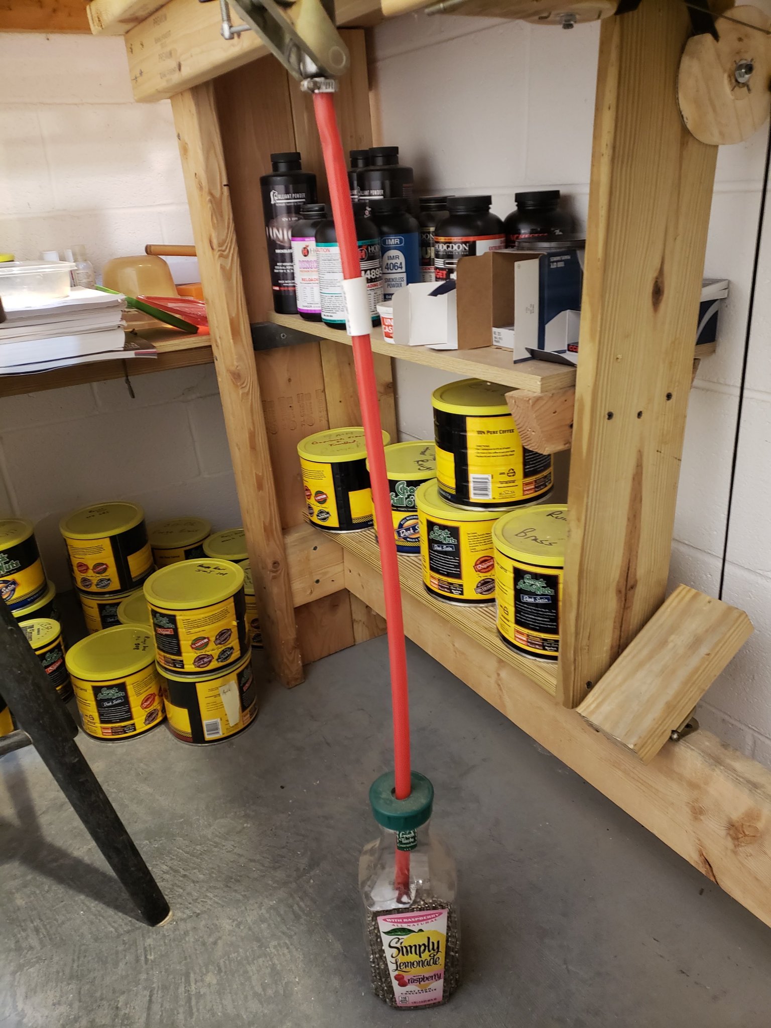

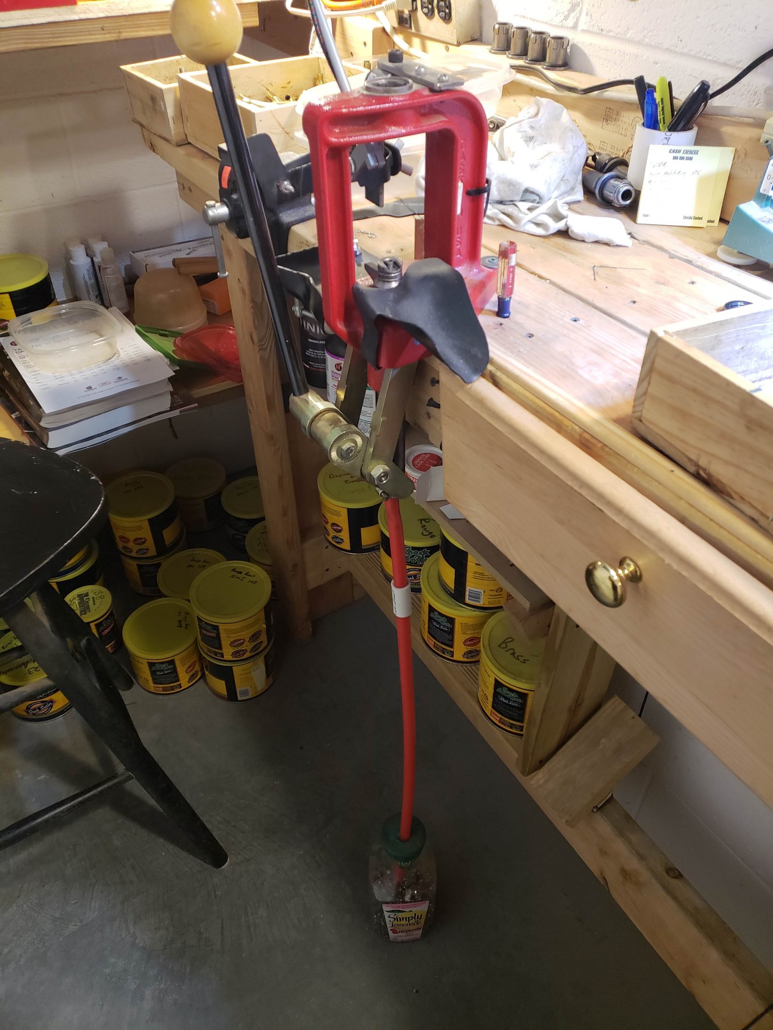

    I'll probably get laughed out of here, but I have my press set up to do autopriming, primer colllection on deprime/resize, autoeject on operation. I think I have about $80 and maybe 6-8 hours in it.
    Let me know if the video link doesn't work.
    I thought it might give someone some ideas.
    I like to tinker/craft/hack, so I'm one of those guys. I know there are the other type of person out there too, the type that just wants it to work on day 1. No problem with that. I'm just cheap and love chasing a solution to a mechanical problem. It's in my nature.
