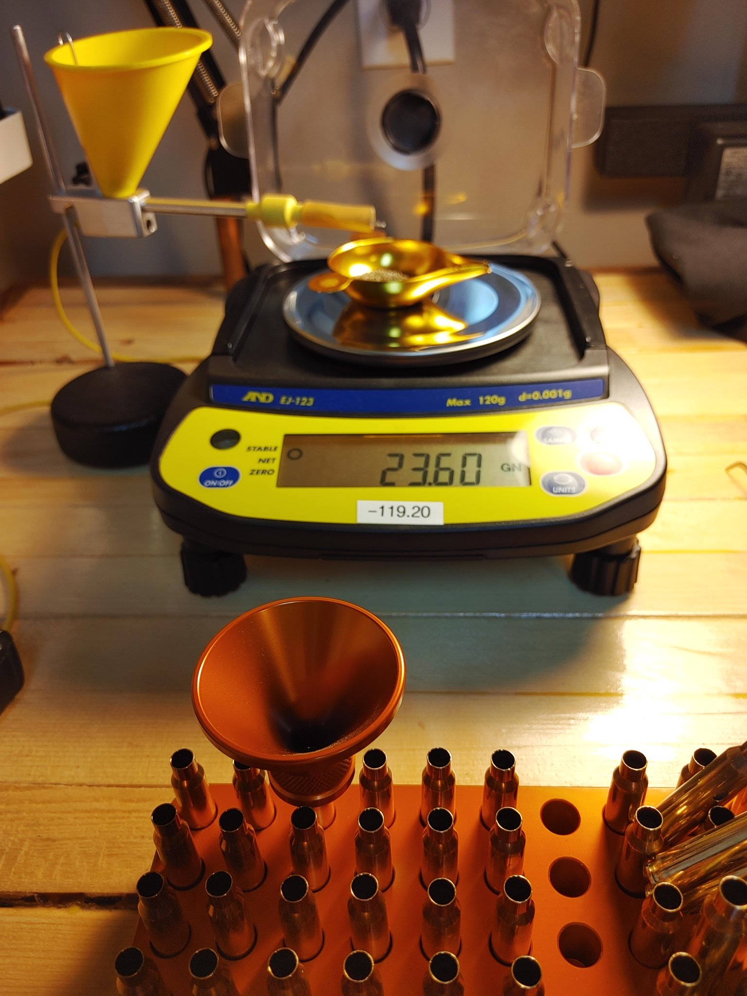

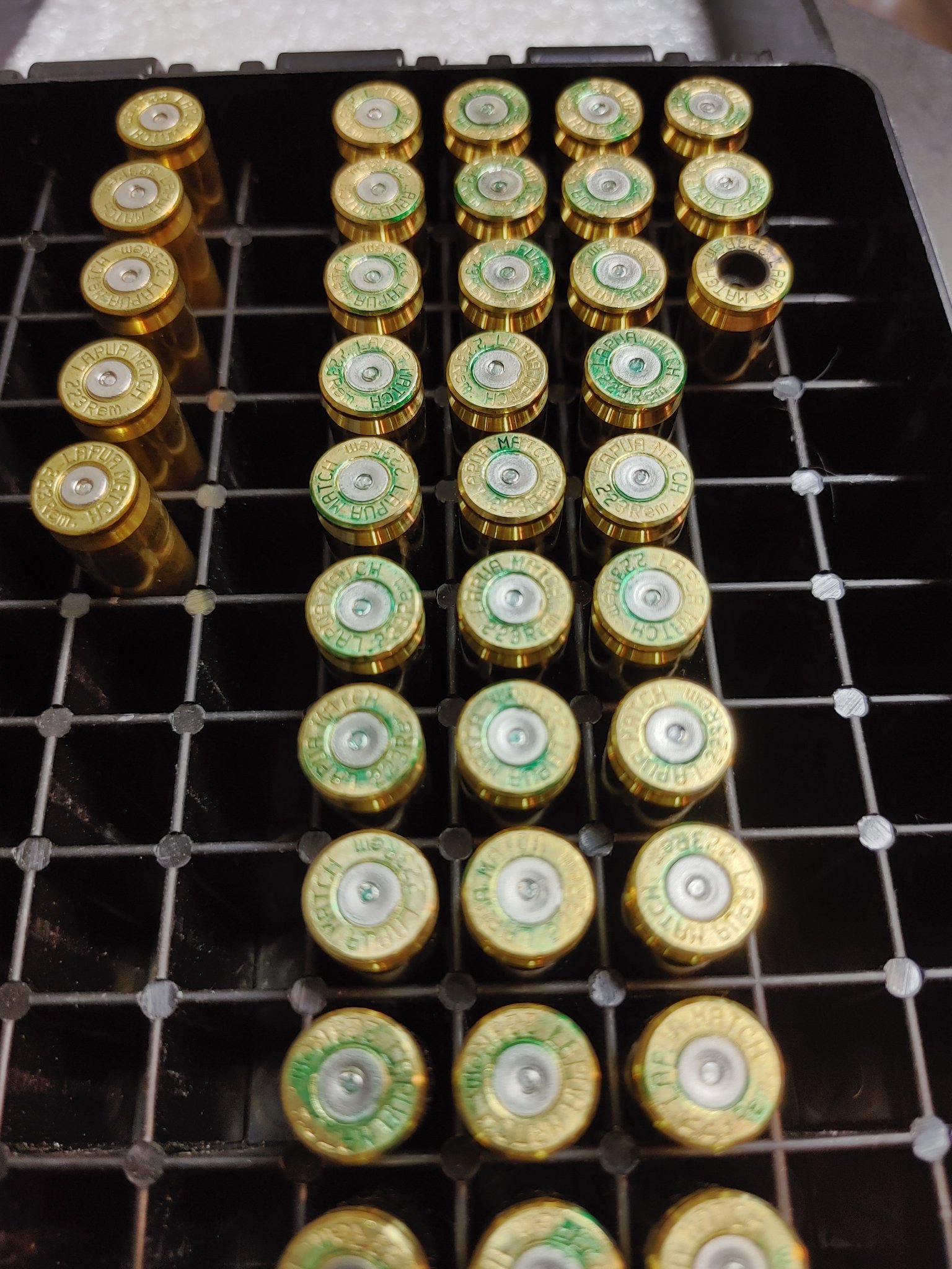

michaelkirkland
Feb 18, 2017
16
5
Rifle is surgeon action 223 Wylde.
25" Bartlien bull barrel 1/7 twist
24.0gn Imr8208 powder
Lapua virgin brass
CCI 400 primers
Hornady 88 eld
At 24.00gn of powder I get a velocity of 2834f/s. But I'm seeing over pressure signs, in fact 1 blown primer. See attached pic. It may have been a damp round that blew the primer, but all the rest look like cratering as well.
Am I pushing this too much? It's a fantastic group .3" , SD=2.
My next lower node looks to be at 23.60gn haven't shot it yet to see pressure signs. I really wanna maximize this for PRS.

Primers are all cratered and from what I can see, they're trying to blank the primer on every single one. Your load is definitely too hot. Do you have the option of extending your COAL a bit? That'll help pressures to come down a bit. If you can't go longer COAL then drop a half grain or so and you should probably be fine unless it's stupid hot out.
Blown primer.
Flattened corner with flow radius.
Flow and re-flattened indent.
The focus is too soft to see the heads clearly, but I imagine we would also see ejector marking.
Are all signs to stop and re-examine your situation.

I wouldn't think that you'd be too hot with that load but you sure do look to have too much pressure. Are you jambing the bullet or something or have a carbon ring or something? There's others on here that can help you figure this out.
I'm my experience with that long a barrel and that much pressure you'd be seeing a faster bullet too. Seems odd to me but I'm no expert. Definitely need to figure it out.
Thanks a bunch for your thoughts. I'm jammed into the lands. Currently dropping .4 GN and will test tomorrow. What do you mean by "blank the primer" flatten?
I opened the iPad Kindle with the previous Hornady Manual version 10 and it only goes up to 75 gr with the 8208 at 22.8 grains and 2700 fps.
Your heavier bullet, going to more powder and higher velocity, could only come from even higher pressure that cause them to stop at 22.8 gr/2700 with the lighter bullet.

Blown primer.
The "blank" refers to what happens to the material over the firing pin hole.
It is a more severe form of cratering in instances where the diameter of the pin hole are not the cause but instead it is due to very high pressure. In this case, your bolt face is not the cause.
When the pressure is too high, it appears as if a die punch is trying the shear material though a hole, a fabrication step we call blanking when done on purpose so the term was applied to that flow on the indent area.

Nice, I pluged your numbers into GRT and it was over 80K psi. Standard 223 chamber.

Have you tried TAC. I didn't initially see that you were shooting an 88gr bullet. I've always gotten really good speed with TAC without pressure. It's tough to get that big of a bullet running that fast though without getting up there in pressure.

If you are determined to push velocity I would suggest not be using 8208XBR. Looking at the Sierra data for the 90SMK you can gain velocity by going to CFE 223 and 2000MR. Both are quite a bit slower than 8208 and do give better velocity. But 2800 fps is absolutely ridiculous for a 223 with that weight of bullt over 1500 ft-lbs). I would think 2600 would probably be the max.
I would check those cases for ejector marks. I would also go with a CCI #41, CCI450 or Remington 7-1/2 for your primers.

I would try a 7.5 or cci 450 primer. Back the powder charge down about 3 grains and work up. My 88 grain load works good with Varget. If all else fails have your smith ream your chamber to a 223 Ackley Improved. That will get you the velocity you are looking for.

You are over 80,600 PSI, it predicted 2803 fps for the rest of your info so is likely an accurate estimate.
Not a good powder choice for that weight bullet.
