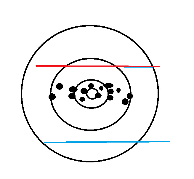

Crude rought painting of 9 mil setting string (I can see the diff in 8.6 (blue) vs 9.0 vs 9.2 (red) on the target:
Excellent. So you are getting bullet velocity at 1k off the scoring system? Do you have a chronograph you can get MV at the muzzle? Have you told the kestrel that the MV value you are using is at 1000? Not sure that’s a thing…it would be a “chronograph distance from the muzzle” type option. My guess is that your Dope for 200-900 probably is off. You know 9 is good at 1000 but until you shoot the others again, it’s just a wag. We can put your values into our calculators all day but it’s an exercise in guessing.
The “Why” is a different qustion. Maybe a change in muzzle velocity…new powder lot?…big change in temps?…f-open off a rest using essentially a free recoil vs something else at the intermediate ranges last summer… barrel changing as it broke in?
It’s probably a few subtle things all together. A few tenths here and there, a slightly off MV value, a BC thats not holding up quite as well as the box suggests as the distances increase. If you‘re mostly shooting at 1000, you‘re good to go until you have a chance to shoot at 4, 6, and 8 again. What cartridge are we talking about?

Writing this out as a Statistician and "Beleive the bullet" seems I should weight the new data more heavily until I get some feedback on the earlier intermediate ranges. I can wish all I want, but everything I have experienced says 9.0 is my dope at 1k, despite earlier data that says 8.5

9 mil at 1000 under the typical atmospherics you are shooting in is THE ONLY THING you know for certain. Your previous dope is likely pretty close but I wouldn’t bet the championship on a single shot at a small target at 700 yards based on it.
