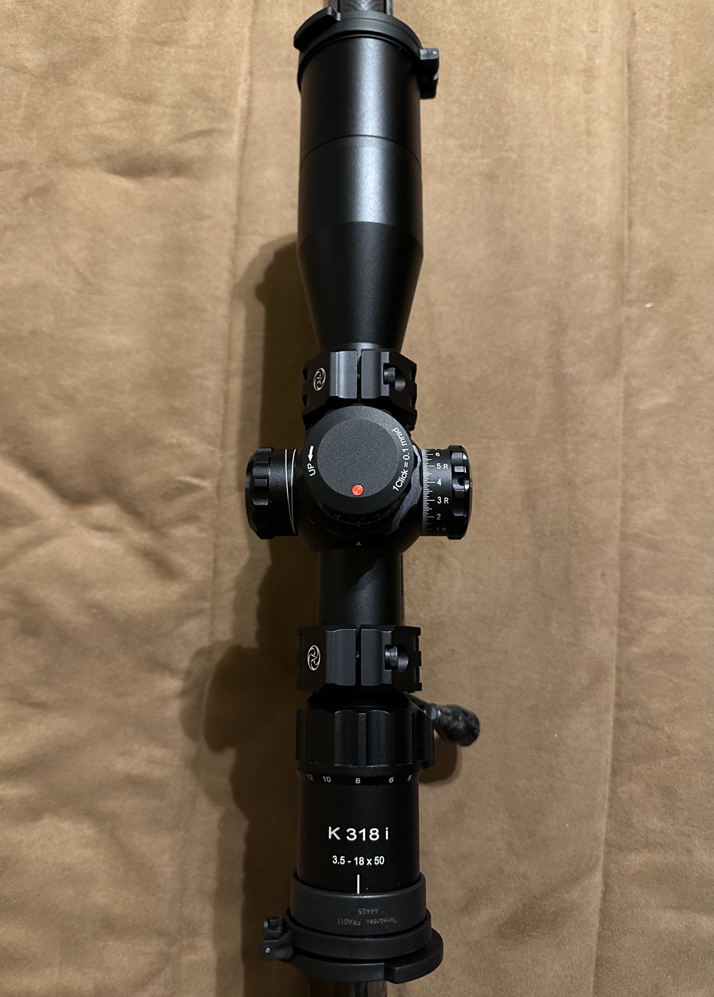

Kahles K318i or K525i, Nightforce ATACR 5-25x56, Tangent Theta, ZCO 420, Burris XRT-III 3.3-18x50, Zeiss LRP S3 4.5-25x50, etc...
I run a Kahles K318i CCW RSW SKMR3 scope on my main hunting rig... It has plenty of elevation and adjustment, and the glass is phenomenal. More than enough scope to get you to 1,000 yards, with tons of elevation travel. The turrets are amazing, and the zero stop is the most simple thing you've ever reset (runs on a cam system so it's a hard-stop that won't slip).
