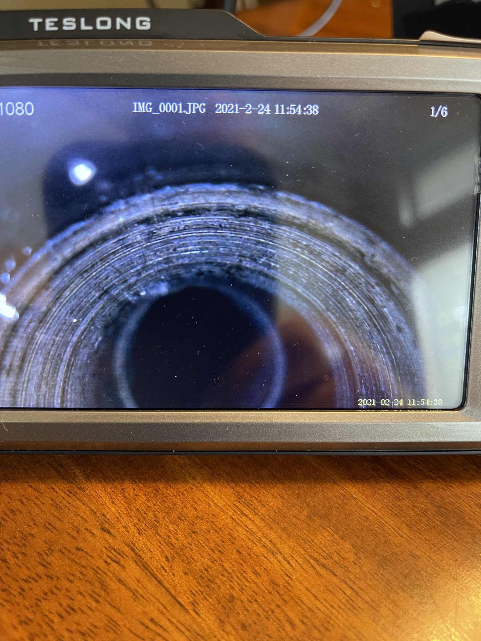

Coming from the rimfire side. I’m pushing a dry patch down it to remove loose debris. I’m borescoping it. Checking headspace. Finally step is I’m taking whatever kind of ammo you’re using down into our tunnel and shooting it to see for myself.
