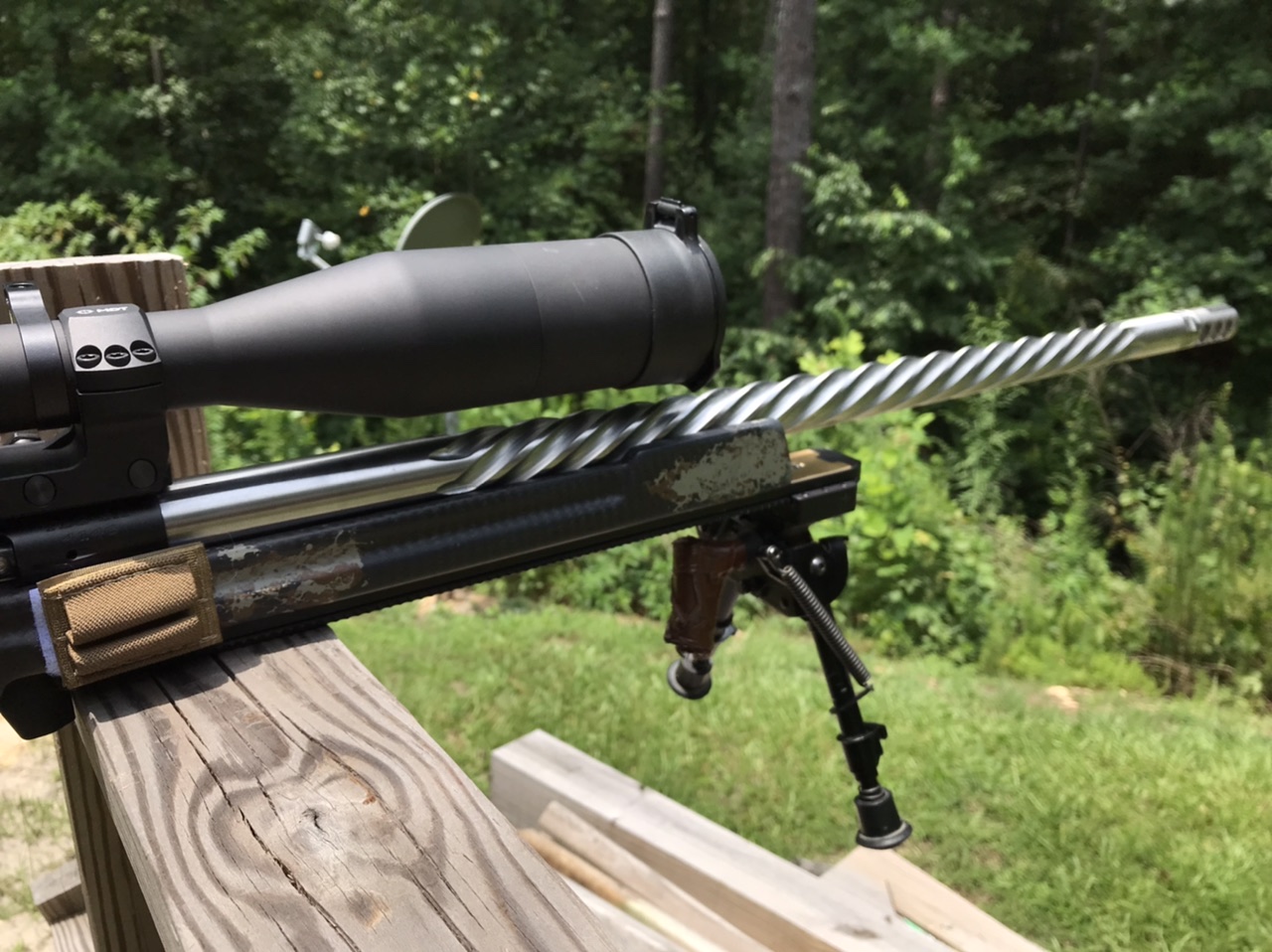

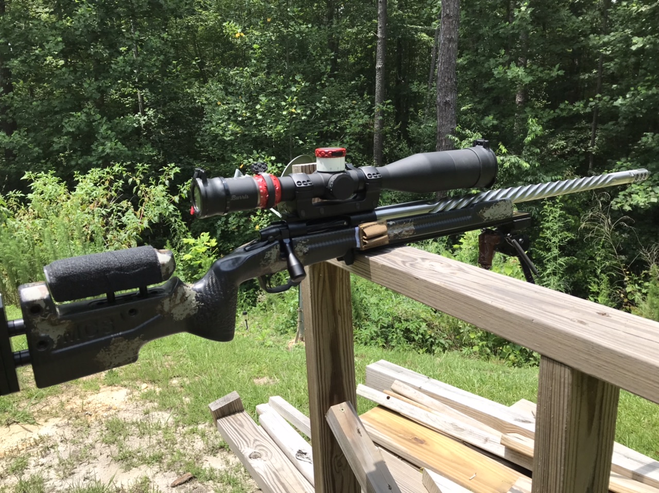

My 6mm ARC Osprey barrel showed up and it’s awesome! The fluting is very cool. From my other Ospreys I know it will shoot as good as it looks.

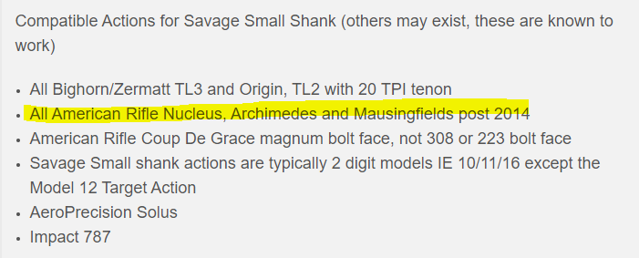

I'd like to know this as well.
I asked the same question a few weeks back and the answer is yes, it's just not on the drop down menu. It's a .284 reamer set up for LA and apparently some people were ordering it expecting it to work for a SA, so there was some confusion. He said you just need to call and place an order for that particular reamer.

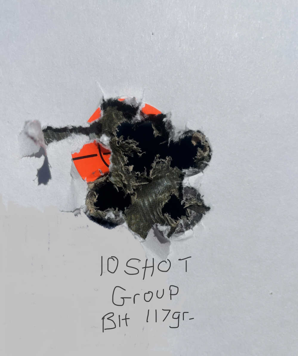

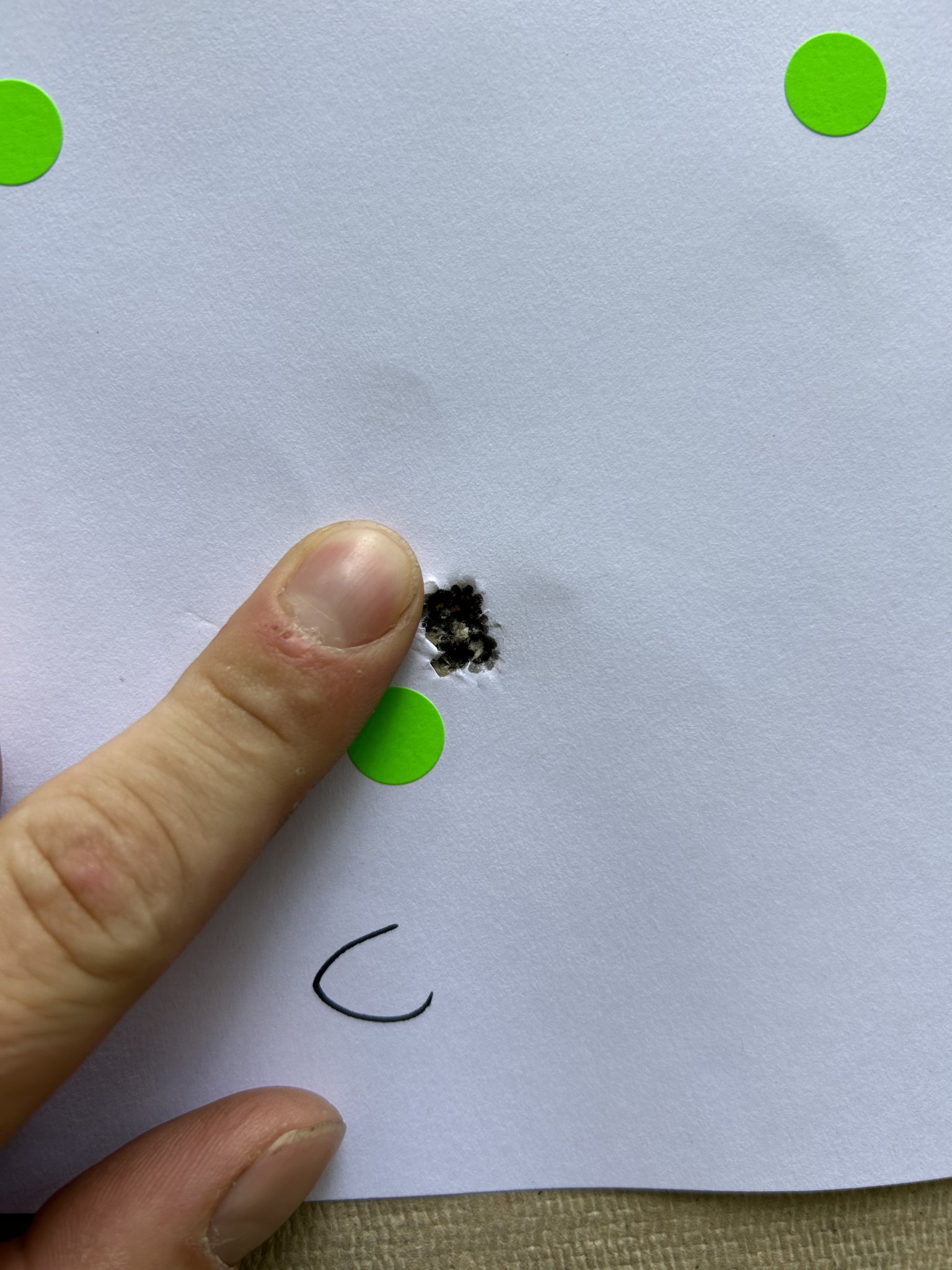

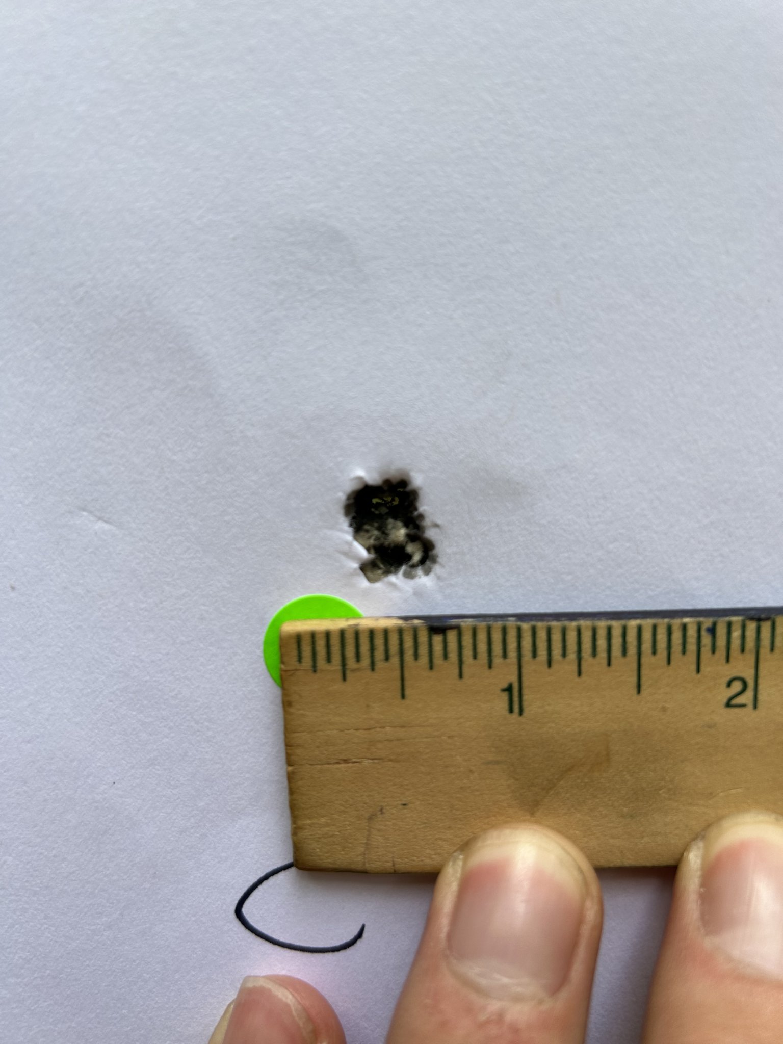

Got out today to shoot some groups at 100 with chrono and shoot a little longer distance with my 20" Marksman contour 6 creed. Factory ammo I bought for brass. Figured I'd chrono since I'm around 100 rounds through the barrel.
100 yards 95gr berger classic hunter
Avr 2837fps SD 21 over 10 rounds
Hornady Black 105gr
Avr 2834fps - SD 10
Shot some 103eld-x that has always shot bad and it might be a bad lot. 5shot goups were 1.25" and around 2"
Avr 2913fps with SD of 75 over 10 rounds. Even when I threw out the top two and bottom two I still got a SD of 43. Contacted hornady about maybe i got a bad lot.

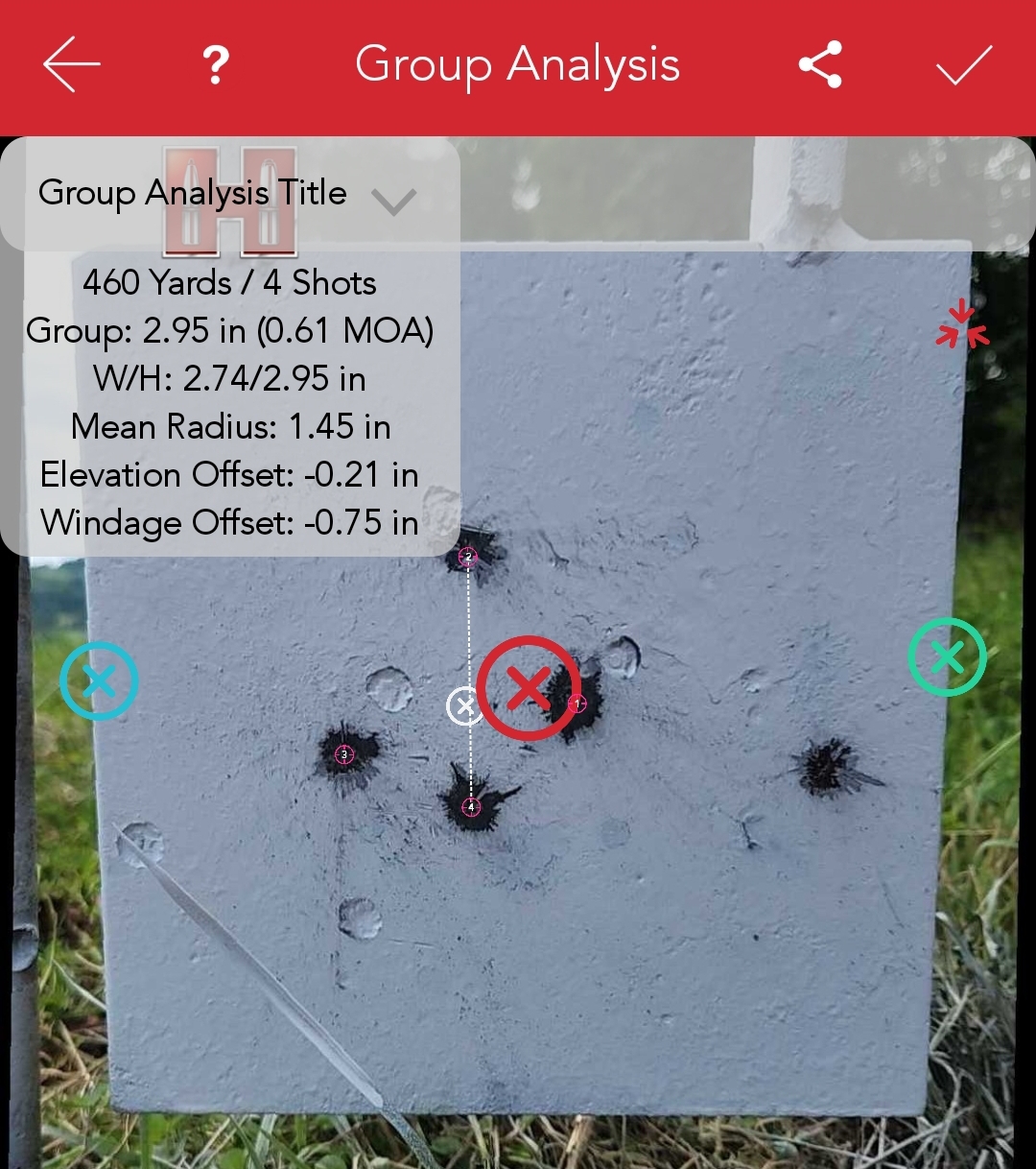

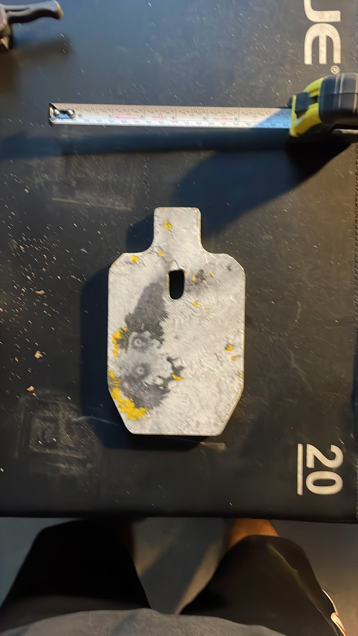

Was short on time but I had a 10" plate at 460yards. Setup on bipod and favored toward the right edge for first shot cause I wasn't sure of wind. Shot hit where I was aiming. So held center and shot 4 more and am thrilled with results. 95gr Berger.
Hornady Black 105gr
Avr 2834fps - SD 10

First is 55g or 50g v max blaster ammo loaded with wc844 in 1x wolf gold brass.
PVA remage 223. This is shots 5-10 after zeroing it for the first time.[
75 a max load worked up for another barrel. The shot farthest out I think was me forcing gun on target. The two little holes are my 17hmr.
Had to iron a few thing out with my stock, but Now we’re getting somewhere… .223 pva 75gr eldms with 2520 5 shot group. All charges shot except 1 were all under a half inch at 100 yards. Small group was this morning confirming a few charges. Last picture was initial ocw two days ago. 1 sighted to get on paper, and then 9 shots, each of different charge weights just checking for pressure.

Anyone have any luck with getting PVA to cut their "CDM" sales barrels for the Nucleus? They have every other action offered, but not any ARC builds. Was going to pull the trigger on another barrel.

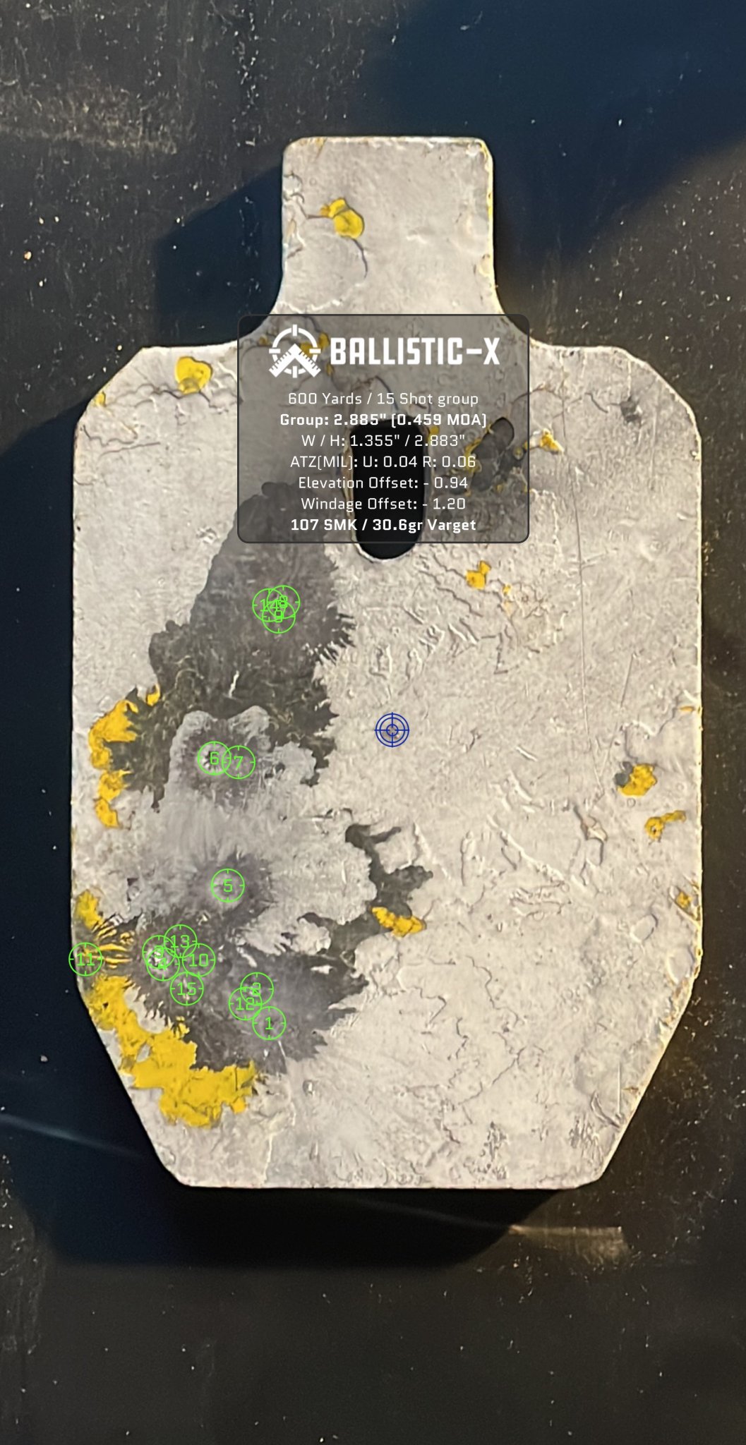

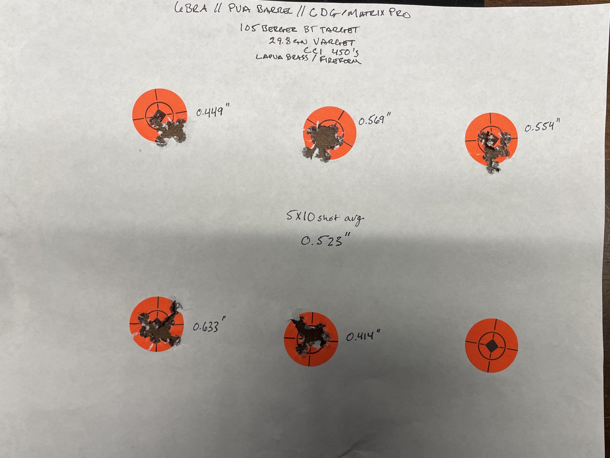

my LP Fuzion has a PVA Rock Creek prefit in 6 BRA with 1,650 rounds on it. I decided to do a tune up at 600 yards since the season finale is coming up for my local club. After checking zero and truing I proceeded to shoot this 15-round group on a 4”x6” IPSC at 600 with my left over ammo. Kind of amazing because I’ve been struggling to shoot 1/2 minute at 100 then print this at 600 😂 not sure where all the impacts are 100% but I definitely hit it 15 times in a row in about ~2.5” group
  • Ballistic-X-Export-2023-09-19 07:50:47.855795.jpg
