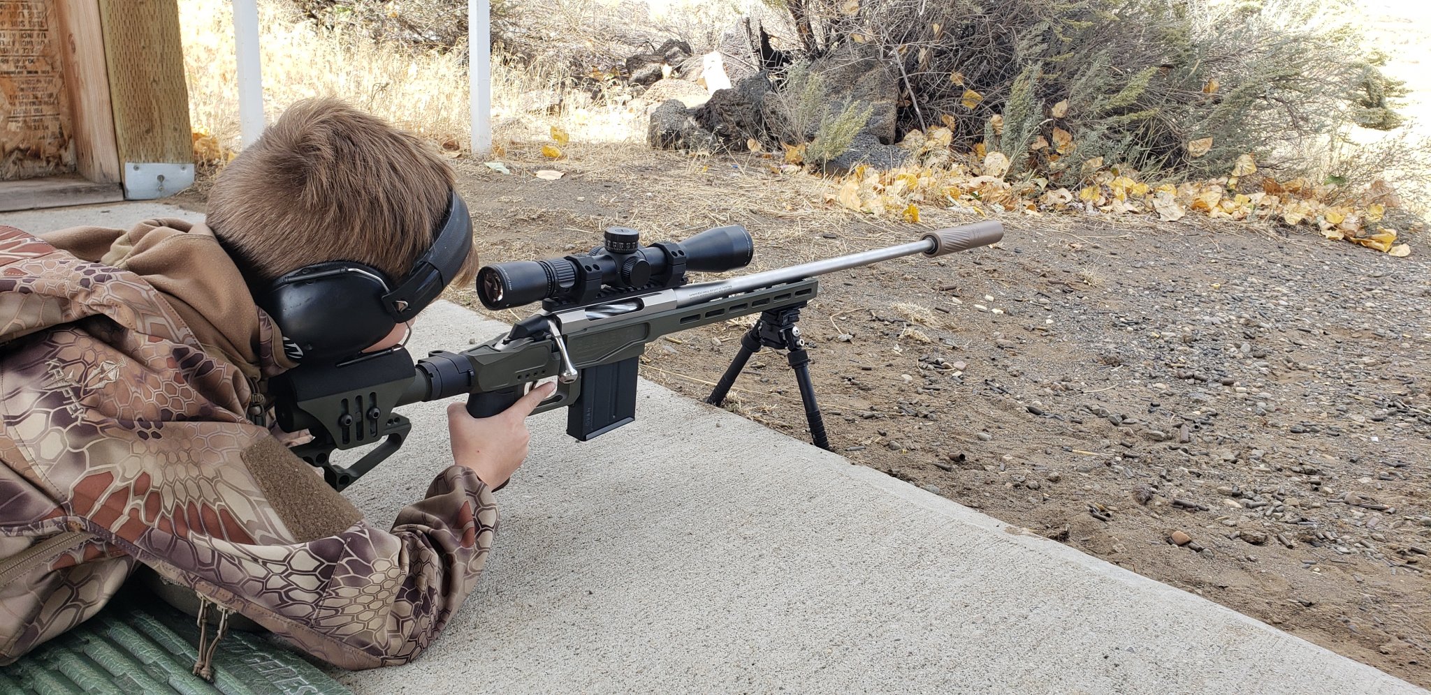

My 9 year old can start hunting big game next year and wanting to build him a rifle. (Plus this is a good excuse to put build a light rifle for my backpacking trips) He has a 260 he shoots very well and plan on using that for deer and antelope. Want something a little bigger for elk and bear though. Was pretty set on a 7saum after some research but thunderbeast recommends a 20" barrel, they do however say a 7wsm will be fine in a 18" barrel as well as 300wsm which I am also considering.
Have a ultra 7 and plan on getting a ultra 9 too so want to the 18" barrel to keep overall length down with a suppressor
Is there other efficient calibers that would work well in that barrel length? Sorry not interested in shooting a elk or bear with 6.5 prc. Would like to stick with 7mm or 30 cal of some sort
Keep debating on building off a tikka action or defiance anTI, plan on putting it in a XLR magnesium chassis, his tikka 260 is in one already and he shoots it well. With another tikka build I was thinking I could swap him stocks and save me a grand over buying another chassis.
Figured there would be more guys on here with experience shooting suppressors and would have some good advice, so how would you build a gun trying to keep it as light and compact as possible but still be efficient
Pic of him shooting his 260

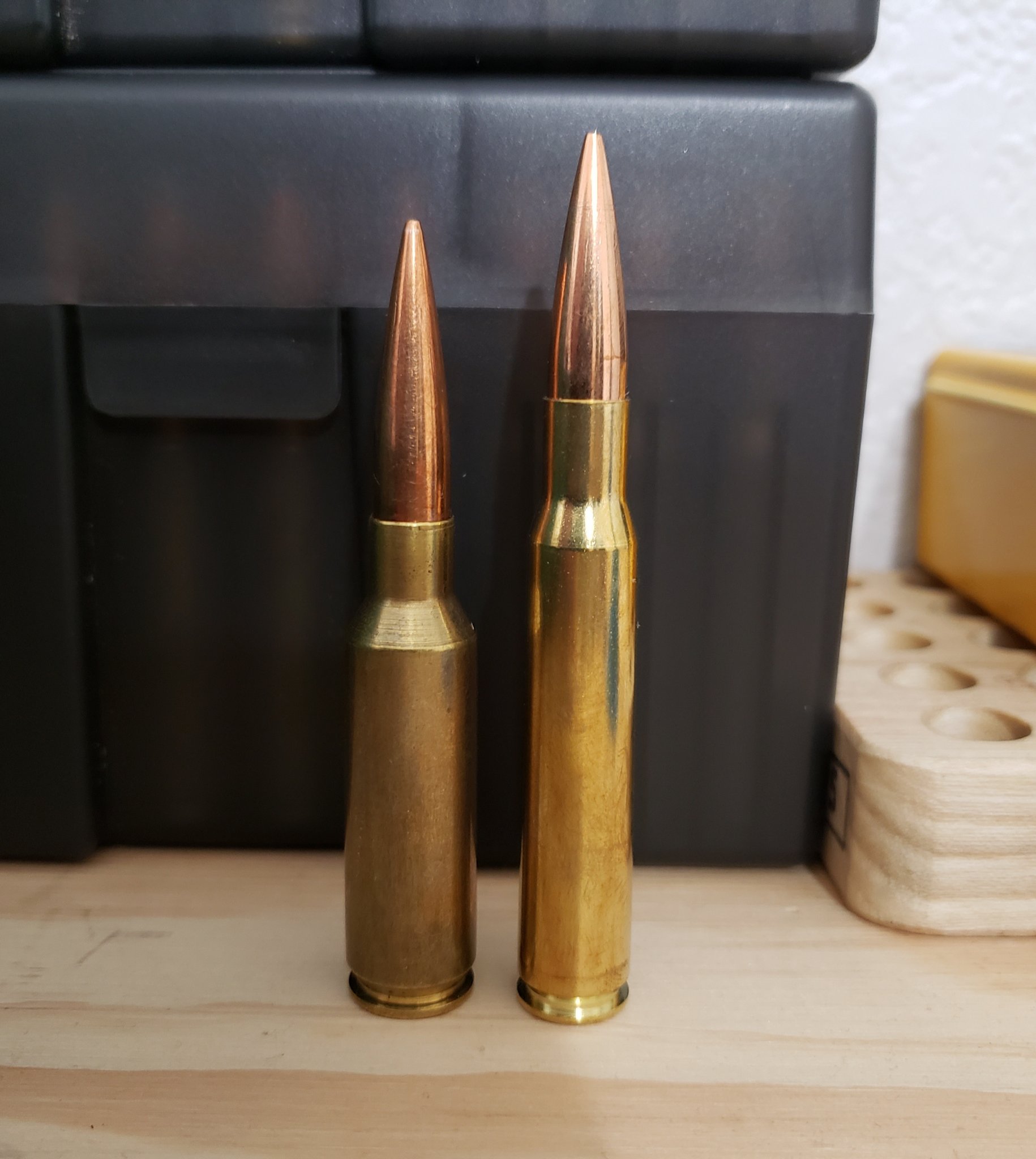

Do you handload? If so the 7Sherman is probably going to be tough to beat for efficiency/performance balance in that configuration.
My buddy went through this with his hunting area (high pressure Utah public land), and he came to me for help. We started with the bullet, 155 Scenar, and put together a 300WSM rifle with a 22” barrel that drove those Scenars at 3250 IIRC. First hunt, 530 yards, one shot (high shoulder) heavy 5x5 DRT. Looked like the finger of God touched it. He said the best part was the look on his Dad’s face, who was saying it was too far. My buddy is now helping his dad put together a rifle.
Yes I hand load, in searching last night I came across the sherman cartridges and read up on them. They definitely are an interest as well.

I worked through a similar situation last year and also run a suppressor. As you shorten the barrel the larger bore makes up for some lost velocity by allowing faster burning powders. I was looking at the 7 SAUM/7SS with 180 Berger or 300 SAUM with the 185 or 200 Berger.
7 SAUM does best with slower powders in the H4831SC or RE26 range, which really need a 24-26 inch barrel. Of course you can make them work in a 20, just not ideal.
The 300 SAUM runs best with H4350 and RE17 which get a more complete burn in an 18 inch barrel.
Where you make up velocity, you lose a few points on your BC.
7 SAUM with 180 Bergers and 300 SAUM with 200+ Bergers really need a long action. 300 with 185 Bergers or less is fine in a short.
If you go long action there is very little difference in performance between the SAUM and the 30-06. Shoot both, just wanted to go SAUM this time for something different.
Pictured: 300 SAUM with 200.20X Berger @ 3.088" and a 30-06 with Berger 185 Hybrid @ 3.430"
Edit to add: If you are traveling to hunt, go 30-06 just incase ammo goes missing at the airport. It happens.
