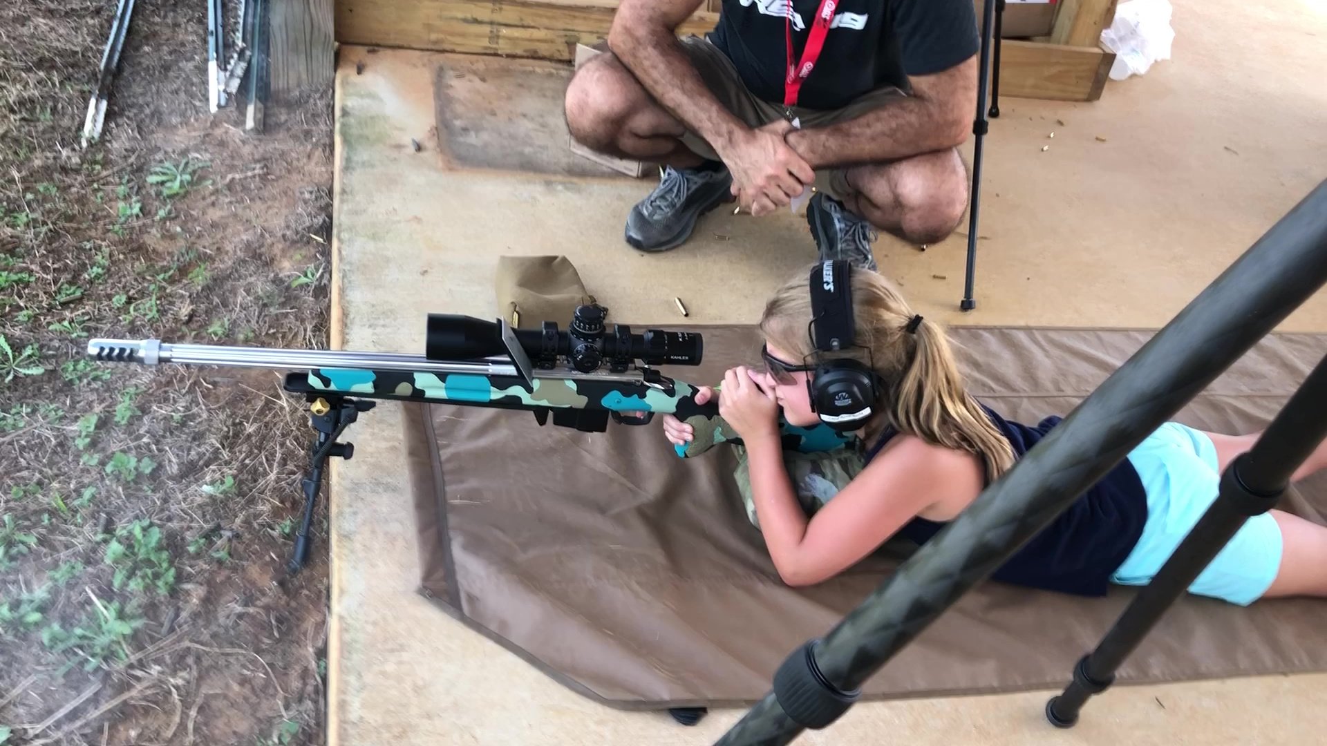

My 80 lb, 9 YO daughter at the Precision Rifle Expo shooting one of Jon @ Area 419's "Shop Rifles" in .308.
She has taken a liking to my Savage 12 LRP in 6.5 CM and was down right offended when I mentioned selling it to finance my Tikka.
I may be putting a chassis on the LRP for her to shoot...
When I get my lathe set up and start making accurate parts, there's no telling what she may talk me into building her...
