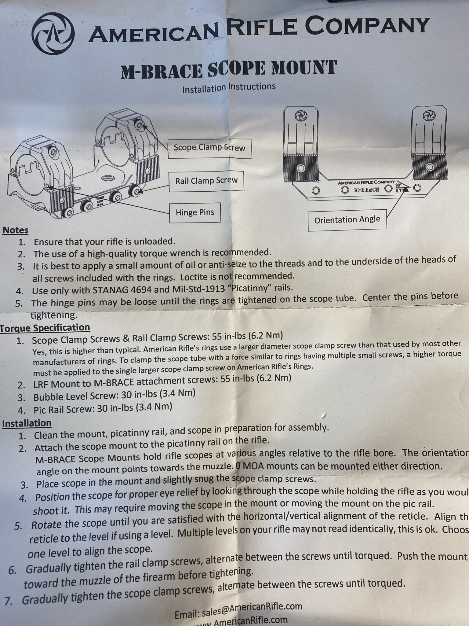

So I just received my first truly nice scope, a ZCO and I’m afraid to mount it…. I purchased a ARC M-brace (I like the lower height than the Spuhr) and the torque specs are freaking me out. ZCO clearly says 20 inch pounds but ARC says 55 inch pounds because it only has 1 larger screw per ring. I’m sure it’s correct but that is a lot more torque, some one please tell me it will be ok!
You are perfectly fine :)
You will be fine. But what do you mean you like the lower height of the ARC? The Spuhr option is lower (1.18") than the lowest Mbrace (1.26"). I prefer the Mbraces now too, just curious what that meant.
I was in the same boat last week...double and triple checked the specs before I mounted my NF at 55inlbs......but all is good! Really pleased with the mount as well!! (y)
