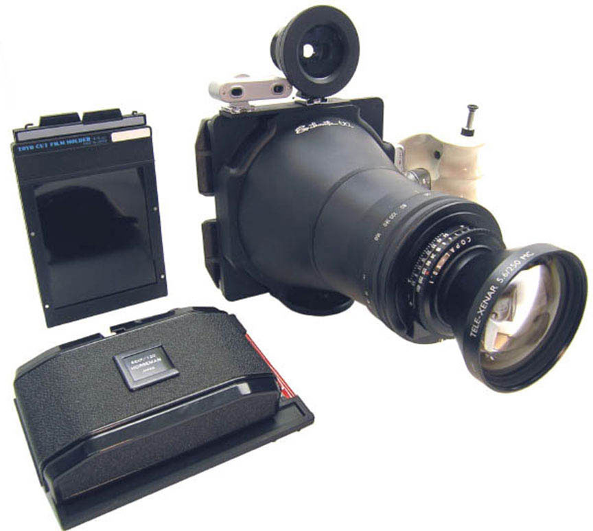

The Silhouette 612
Camera/optical system which took me 6 years to create. Specifics are in my about section near the bottom. Know all about what you said B4 U said it.
