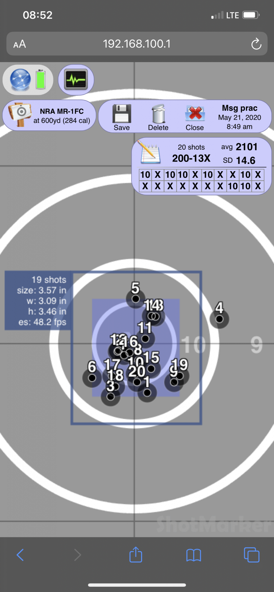

Defiance still does not guarantee tolerances tighter than zermatt so that’s myth. A floating savage style head is not inferior in lock up (no idea where you got that from or why raceways is relevant) You left out the most popular f class option by and far. The panda.
Ignition systems are not better the farther they protrude and I shoot es that are comparable to other actions so any ignition reliability arguments are out the window.
Pictured is my tl3 I actually shot in f class. That said, if you’re going all in on f class get the panda or bat.
