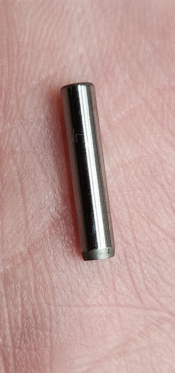

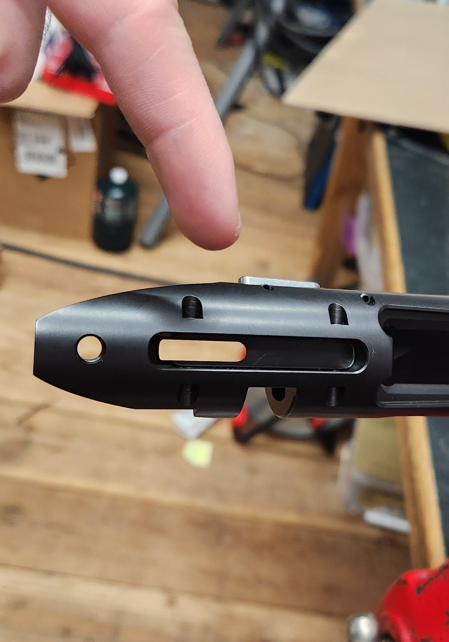

I'm building a custom rifle with a left handed zermatt origin action and have a couple of questions with installing the trigger (triggertech special left handed trigger). The trigger pins shown in the picture are tapered on one side and im not sure which side goes in first? And which side am I supposed to hammer the pins into the side I'm pointing at in the picture or the other? Thanks for your help,

The tapered end goes in first so you don’t have a squared corner catching on every edge.
Doesn’t matter what side, I’d probably start the side opposite the safety just for space availability but it makes no difference as far as actually being installed.
