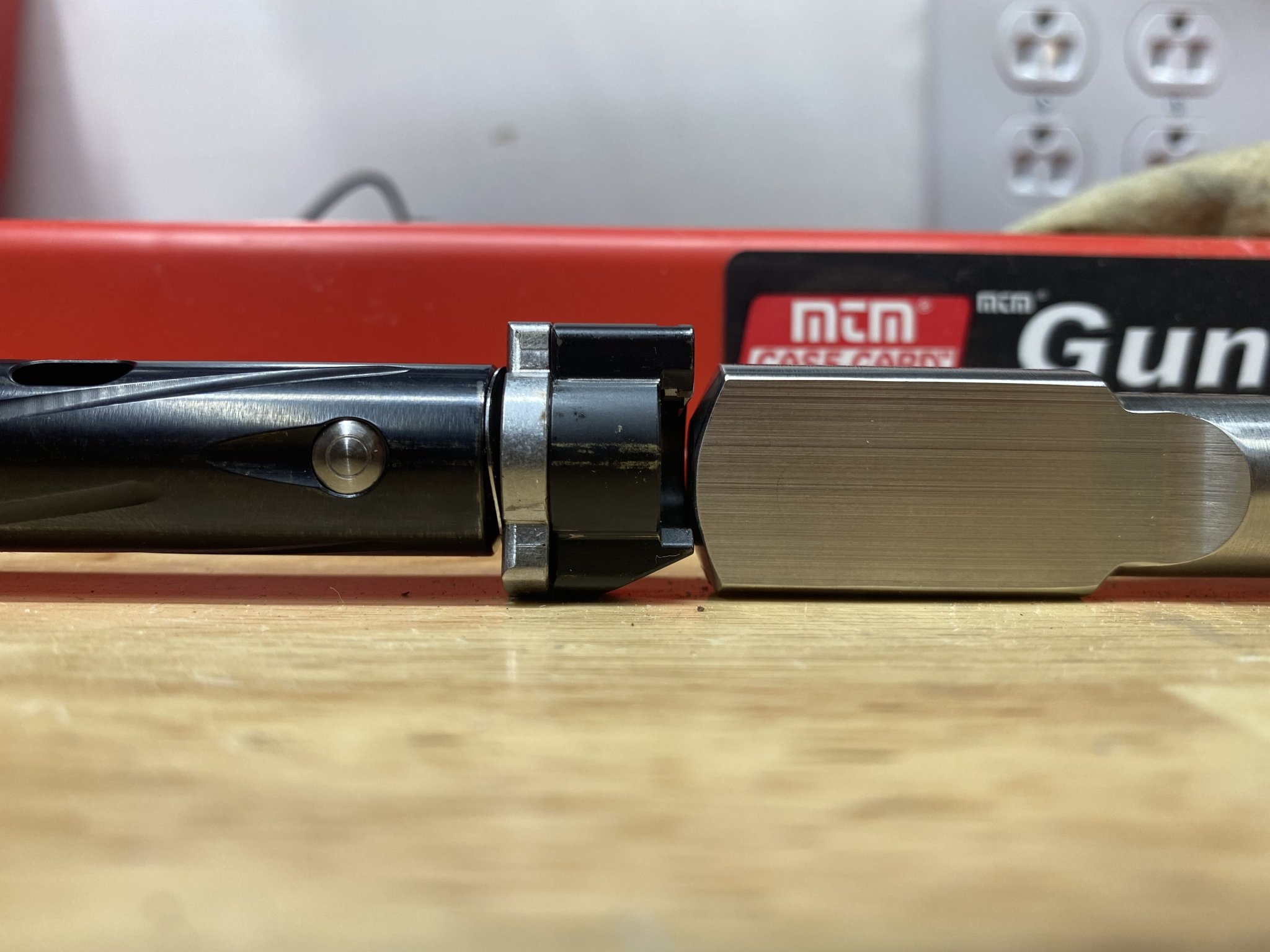

This wrench from PMA is advertised for Remington 700 actions. Consequently, one is told that a Rem 700 action wrench will work in a bighorn action or most 700 clones. Either this wrench is way off or a regular Remington action is smaller (I don’t have access to one to find out)
What's the scoop on the dimensions? Did they cut this wrong or it's just a lousy fit for a zermatt? I need a solution to remove my barrel from my Bighorn.
Apparently a very loose fit for Zermatt. I sent it back. Short action customs is supposed to have their heads in stock in a couple weeks. I’m going to wait unless something else pops up

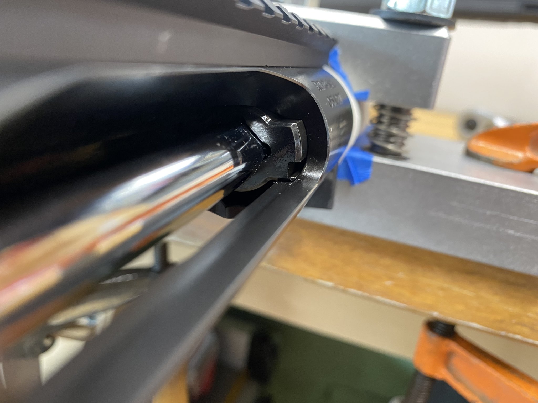

The Ebay wrench worked great! No grinding or sanding required. I did have to take the ejector out, which is super easy. Otherwise it fit perfectly, just a touch less slop than the bolt has. I torqued the barrel to 100 ft/lb without any issues. Well worth the $48, and it was to my door in less than a week.

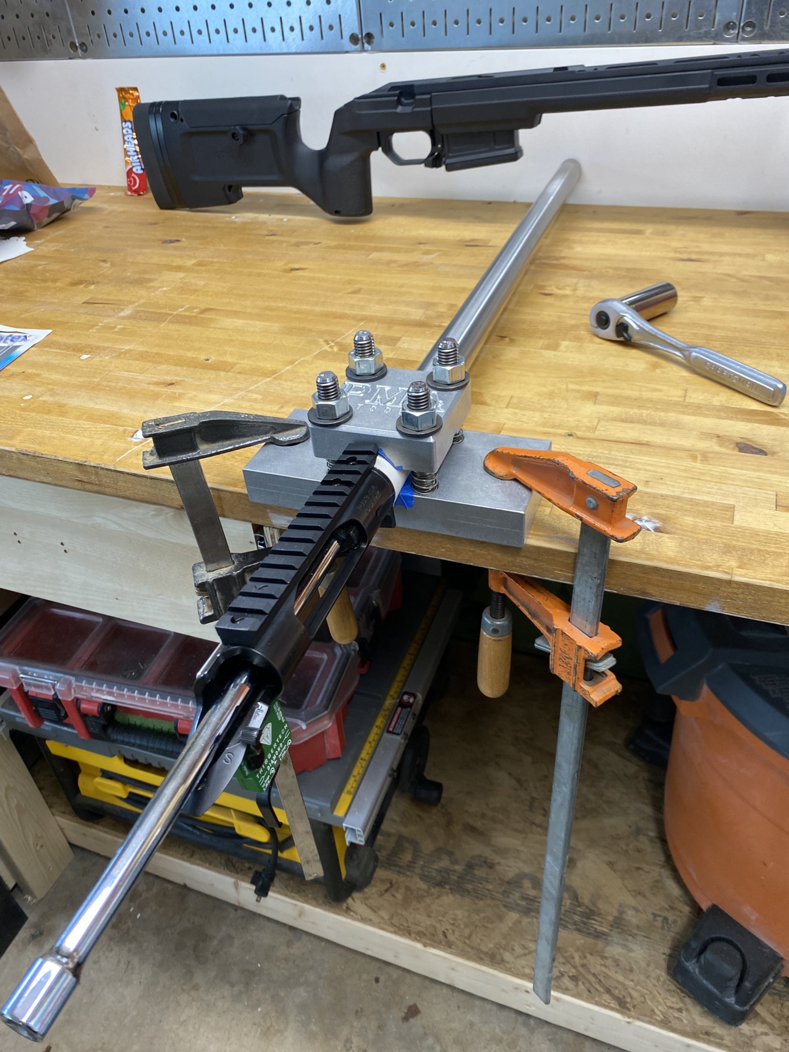

Bought the action wrench you guys got off of eBay and it came today. Worked out pretty good. I thought it was a little tight, it did slide in but there’s almost no play at all. Pretty much a perfect fit. I may try to hit it with a belt sander on the sides real quick to make it a little easier to slide in. 3/8 socket extension clicks in real nice, it has the detents for the ball bearing, also a perfect fit.
Also got the PMA barrel vise. The channel is more of a v shape than circular. Those with the Viper vise, is the channel more rounded?
Edit: btw, the Airheads in the background came with my package from Snyder precision. My kids saw it and completely didn’t see the rifle, only the candy
The viper is more rounded, yes, but it’s not completely circular and does press more on the edges than the entire surface. My business card barrel wraps come out with 4 distinct contact points just as your more angular vice opening would impart.
That’s how’s mine is. I used drywall tape and it left 4 distinct lines/marks from the points of contact. I guess that’s ok? I was looking at a bushing style vise on eBay that looked pretty good, comes with 5 different bushings. Probably overkill but it looks solid

View attachment 7865399So talked to a guy from Rokslide, his Bugholes wrench is tight, no slop. I’ll call PMA on Monday to see what’s up with this. It’s 3cm smaller than the raceway (is that what it’s called?). Checked it in my Bergara B14 action and the same thing.
Did PMA eventually answer you why? I think usually the wrench width is made to match the bolt head diameter. I'm thinking to purchase a wrench from PMA but your post concerns me a bit.
Being about 2 years ago I don’t remember the exact conversation I had with them but I ended up returning it as that’s just the way they made them. At the time they didn’t have an origin bolt head to reference but they may have fixed that since then. Give them a call. If it’s the same specs as when I bought it there’s no way I’d use it on a Zermatt action. I have the bugholes wrench and it’s perfect
