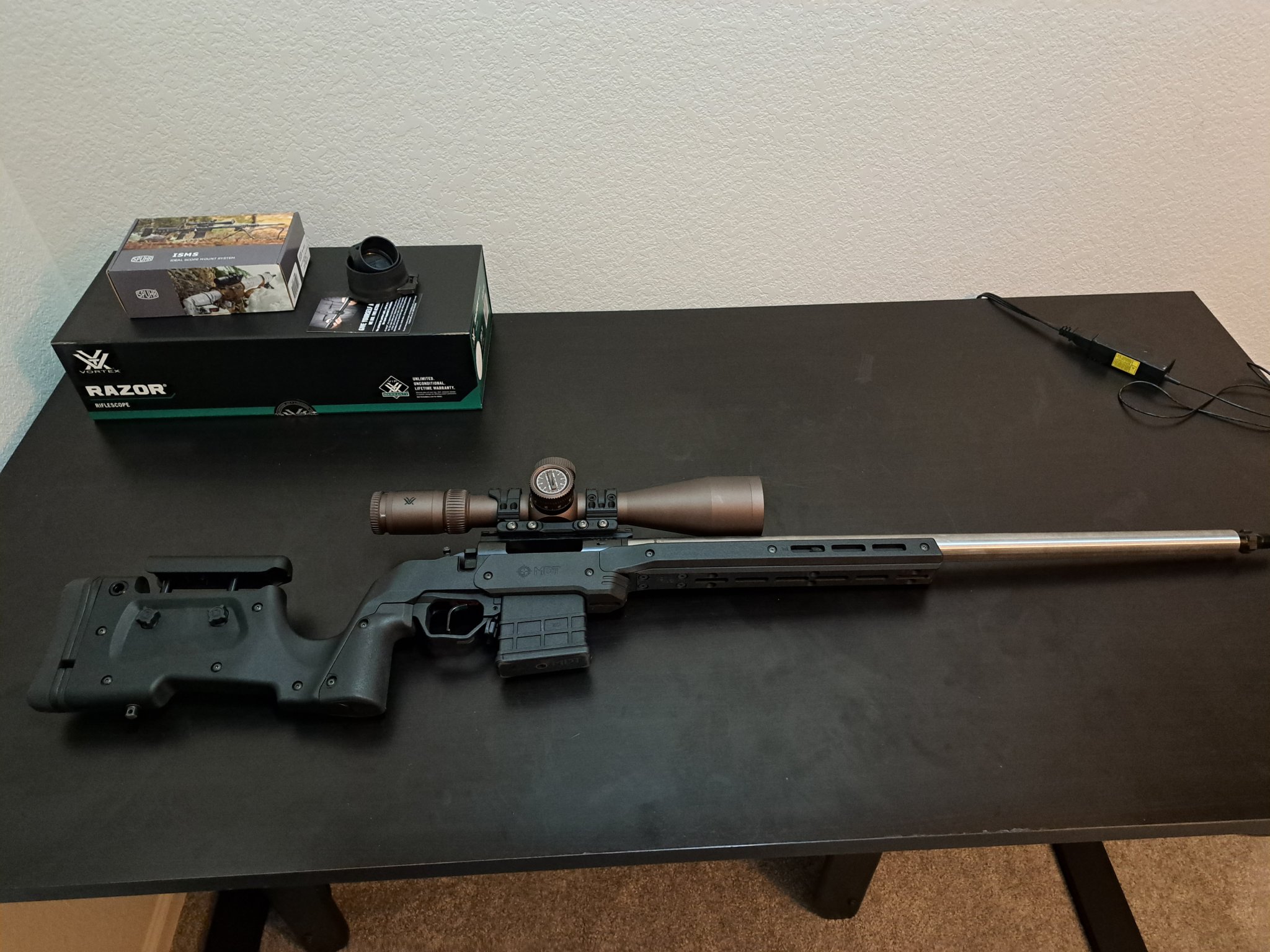

I have a Zermatt Origin in a Mdt XRS with a Proof 223 barrel and Vortex Razor Gen 3
I'm looking to get a 6.5 cm barrel and standard bolt head for it so i can swap barrels and cartridges.
My question is when switching barrels and bolt heads, how close is the POI between the two?
I've read that some on here don't torque the barrels to the 75 ftlbs that is called for, any problems with not torquing the barrel each time?
I have the viper barrel vise and action wrench so i do have the proper tools but if i can get away with just hand tightening between swaps that would be convenient.
Eventually i would like a second rig but until then this is the plan.

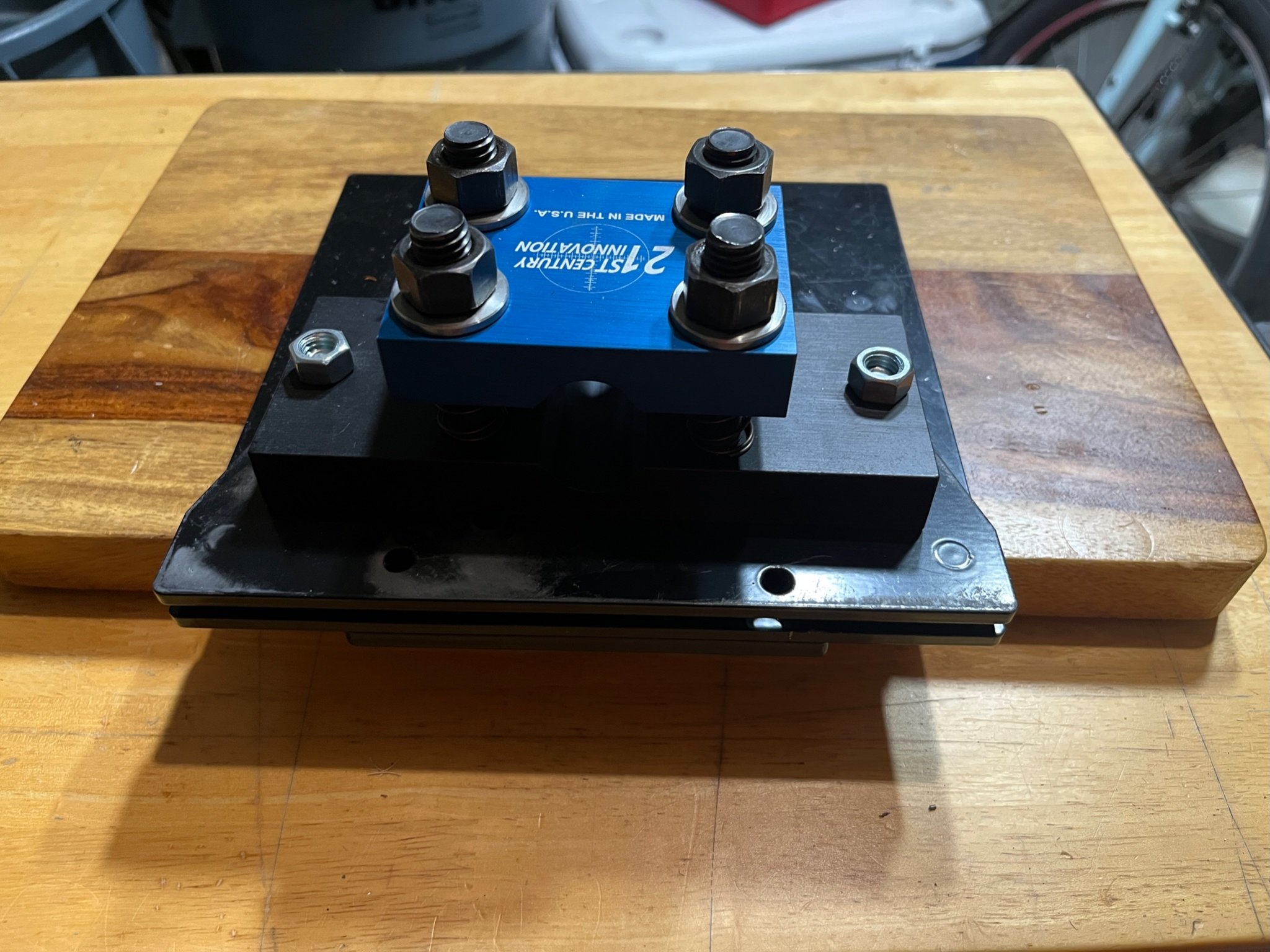

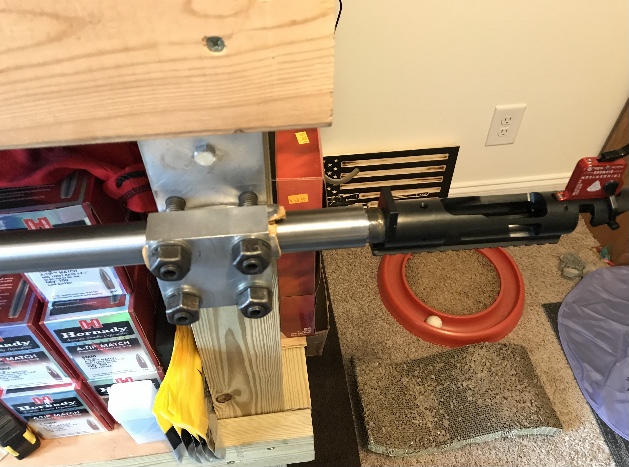

I've been thinking about using a piece of 2" tube steel to go into a hitch to mount the vice, then when I need it on the bench I can clamp it in the bench vice.

I’ve never mounted a barrel vise. I clamp it with c clamps or trigger clamps to use it. That way it’s out of the way when I’m not using it and I can take it to the and clamp it to a bench the same way if I need to.
Same here, I just clamp my barrel vise into my normal garage bench vise for the 5-10 minutes swapping a barrel takes.

You can also mount a barrel vise to a short sawhorse (can be bought at HD). This keeps it handy, but can then be tucked under the workbench when not in use (I also mount a vise to it as well).
Lots of different ways to save space in small spaces...
