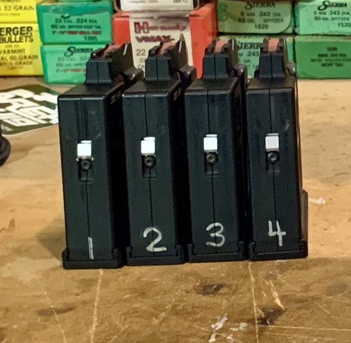

Was your RimX chamber modified with a slight ramp cut at 6:00? I tried experimenting with raising the mag latch on my two magazines late yesterday afternoon, and found that mine won't feed at all unless the mag latch is adjusted for no more than the recommended max of 1/16" play. After that, I decided my next move will be to pull the bbl again, and set it back at least .050", then run a new JGS carbide M52D Match reamer in, which I hope will smooth feeding a bit.

Jesse,
No ramp cut:

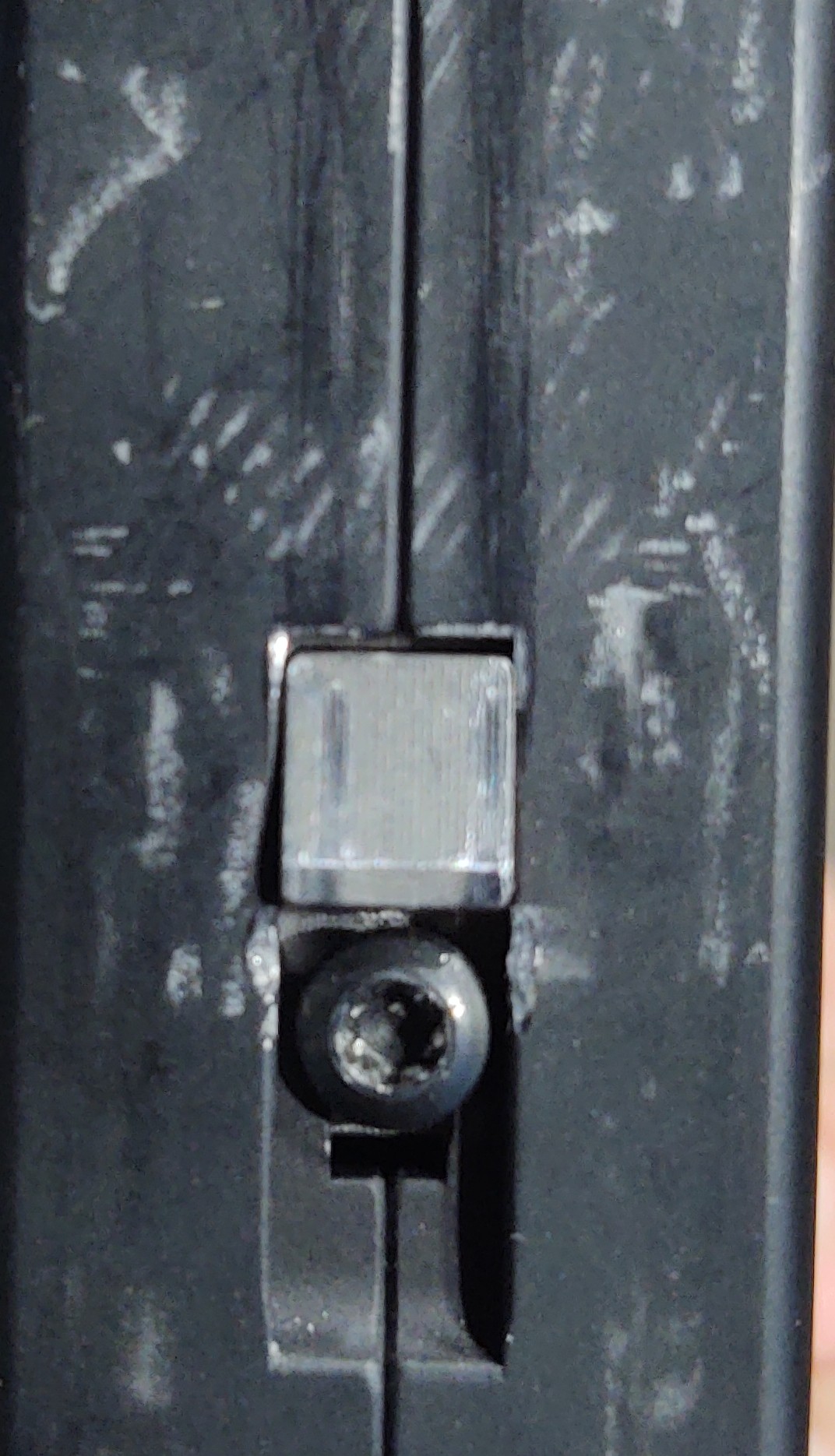

I put a dial indicator on the magazine in 3 spots front, middle, and rear and found right now it is at the 1/16" of vertical play. This is where I left it the last time I was messing with it at the range when I didn't have a way to measure it. The magazine catch is almost all the way up. I am still getting a few rounds to chamber poorly causing a flyer, like 3-4 out of 50.

No ramp cut:
That’s completely opposite of mine and might just be the difference in the bottom metals. I’ve got mine set with the mag as high as it will sit in mine and still lock up on the mag catch. Only thing on mine that makes it a bit hard to close is the tensioner but it’s not that bad I’m just nitpicking.

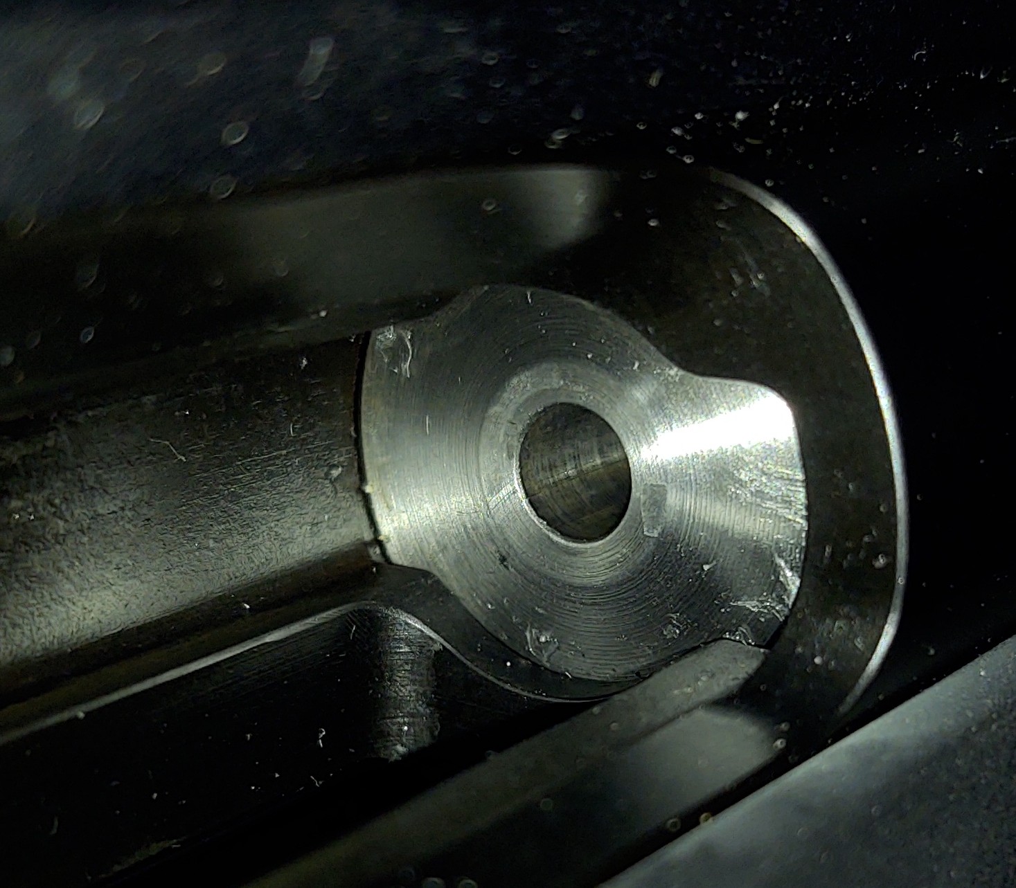

I had time this afternoon to pull the Bartlein from my RimX and get it dialed-in again on the lathe so I could set it back .050". Since I'd already CeraKoted the bbl & then engraved '22LR' on it, I wanted it to index so the engraving would still be right; 1 divided by 20tpi = .050", so that's how far I set it back. I'd decided to go with a Win M52D Match reamer to see if the taper from .2273" at the rear to .2259" at the throat would improve feeding. Borescoping after I'd finished the chamber revealed that .050" set-back had also allowed the 52D reamer to completely re-cut the previous EPS chamber. The wind had been fairly strong at 20-25mph most of the day, but by the time I'd finished the job and got the rifle back together, it'd died down to 10-15mph out of the north. I just had time to take it out to my smallbore range and put it on steel at 100yds - it's normal to move the POI a bit after taking a rifle completely apart, cut a new chamber, and then put it back together, but that wasn't as important to me as finding out whether switching to the 52D chamber would improve feeding. I put a quick two magazines of some old Wolf Match Extra that normally doesn't shoot very good through it to get a feel for feeding, and was pretty pleased - it fed quite a lot smoother and it seemed to be off my normal 100yd come-up by only .1 mil in windage, with elevation being pretty much unchanged.
This 52D Match reamer doesn't have the radius at the body/rim transition that my EPS reamer does, so I cut a 45* bevel at the edge of the chamber that was about .020" wide, then polished the corners of it pretty thoroughly with a cratex rod. Hard to say if the dimensions of the reamer or the bevel was most responsible for the improved feeding, but when it comes down to it, I was happy with it, and at this point, don't really care - pending a day with decent conditions so I can shoot groups at 50yds and compare them to the ones the EPS chamber produced.

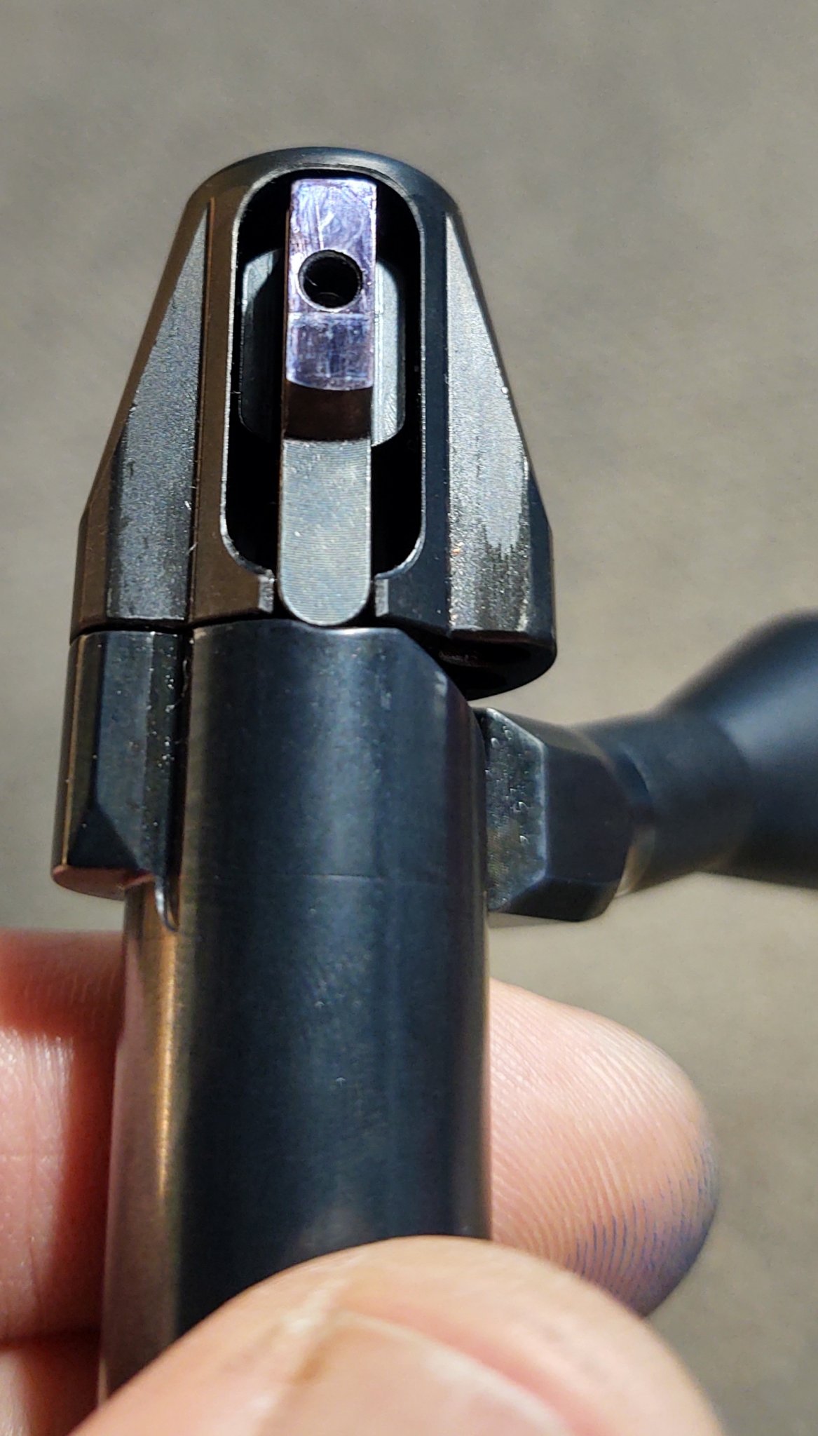

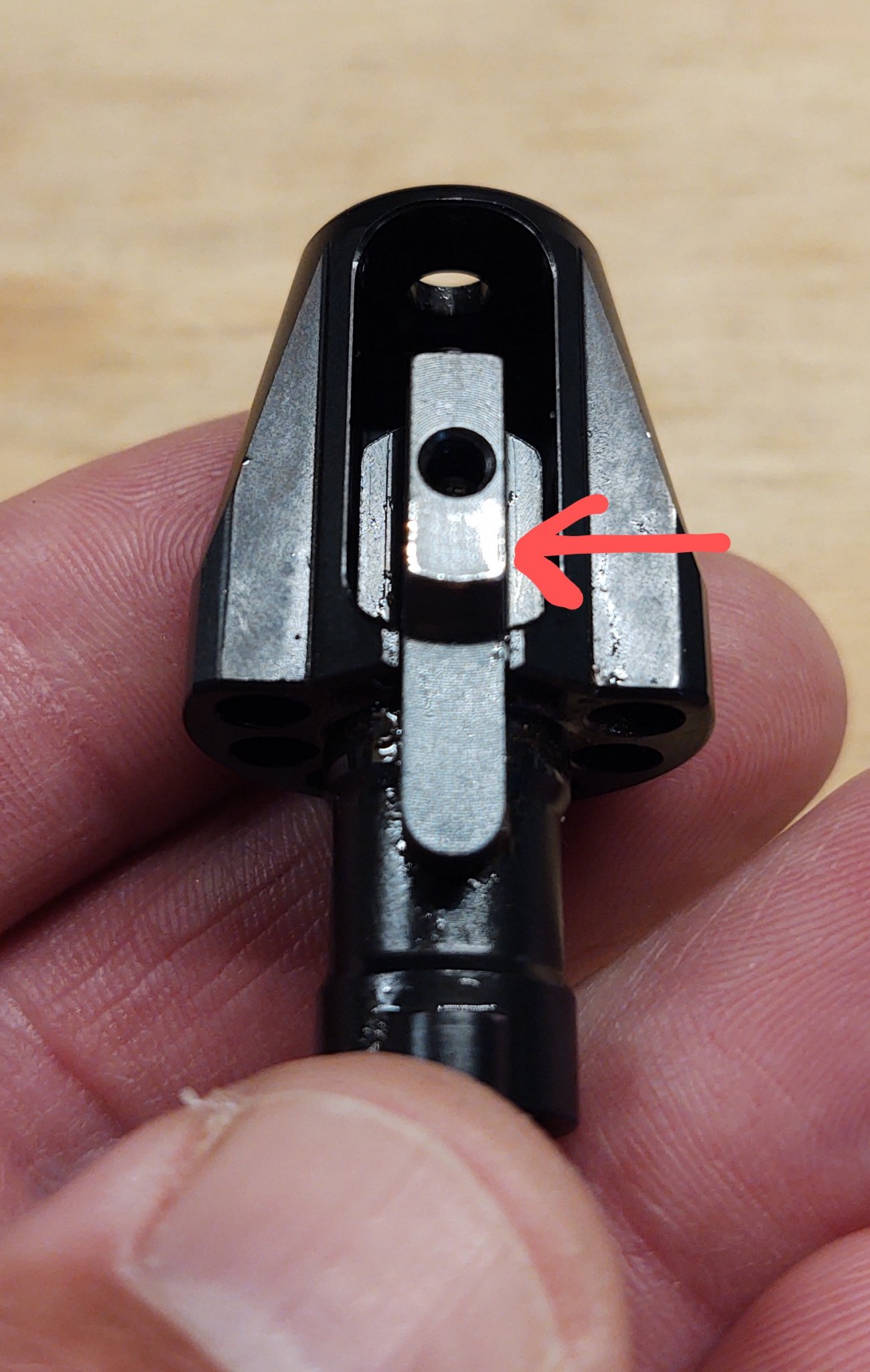

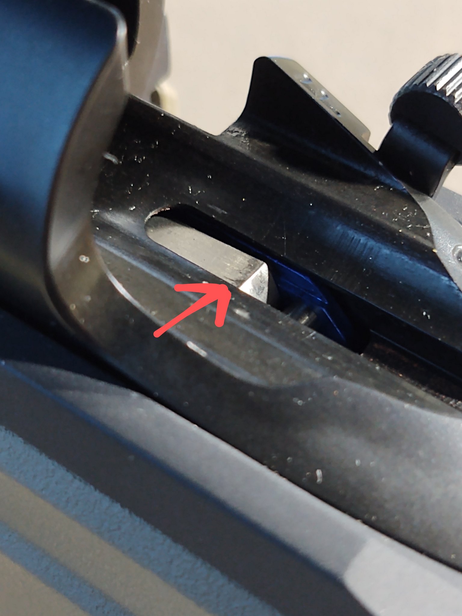

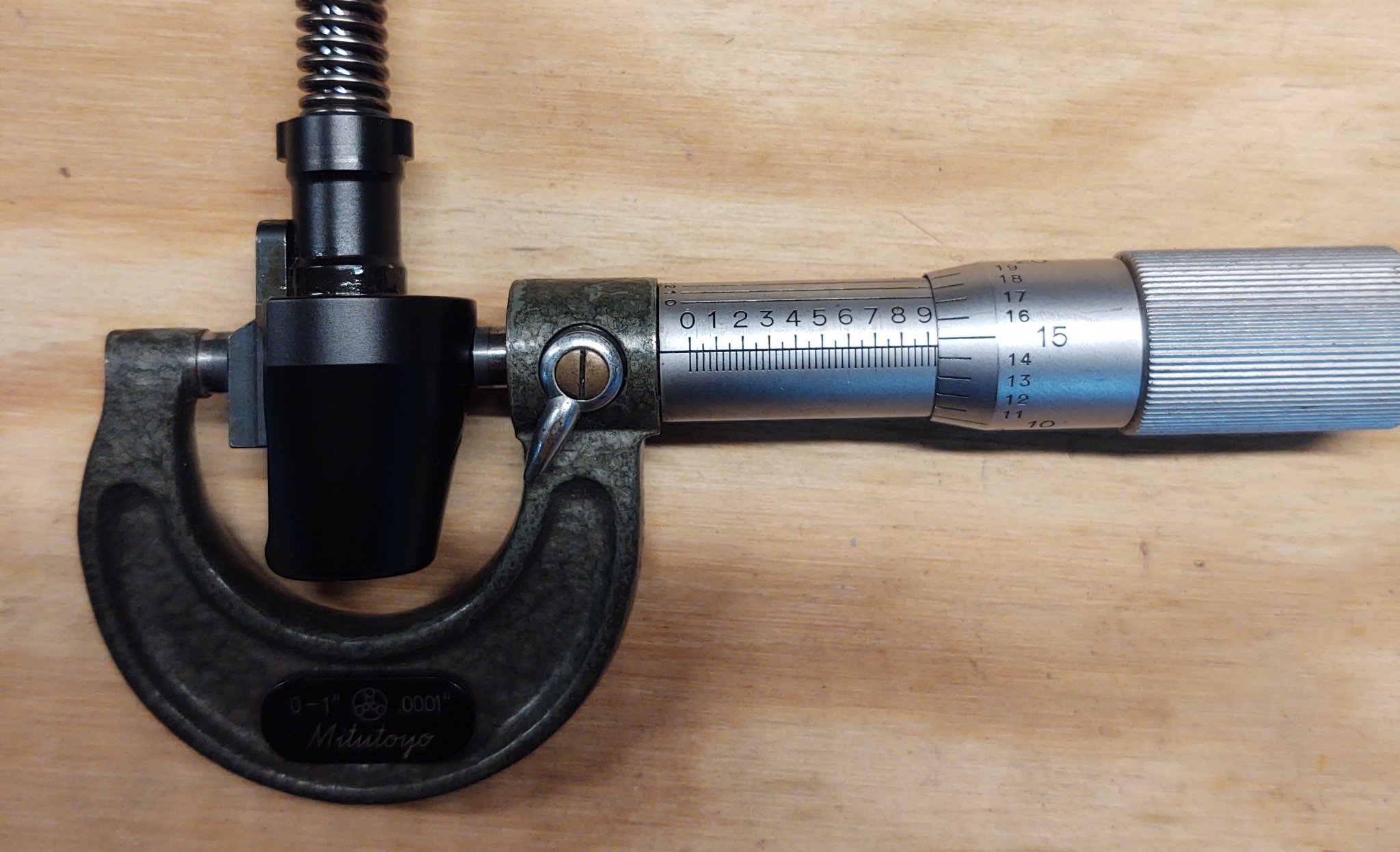

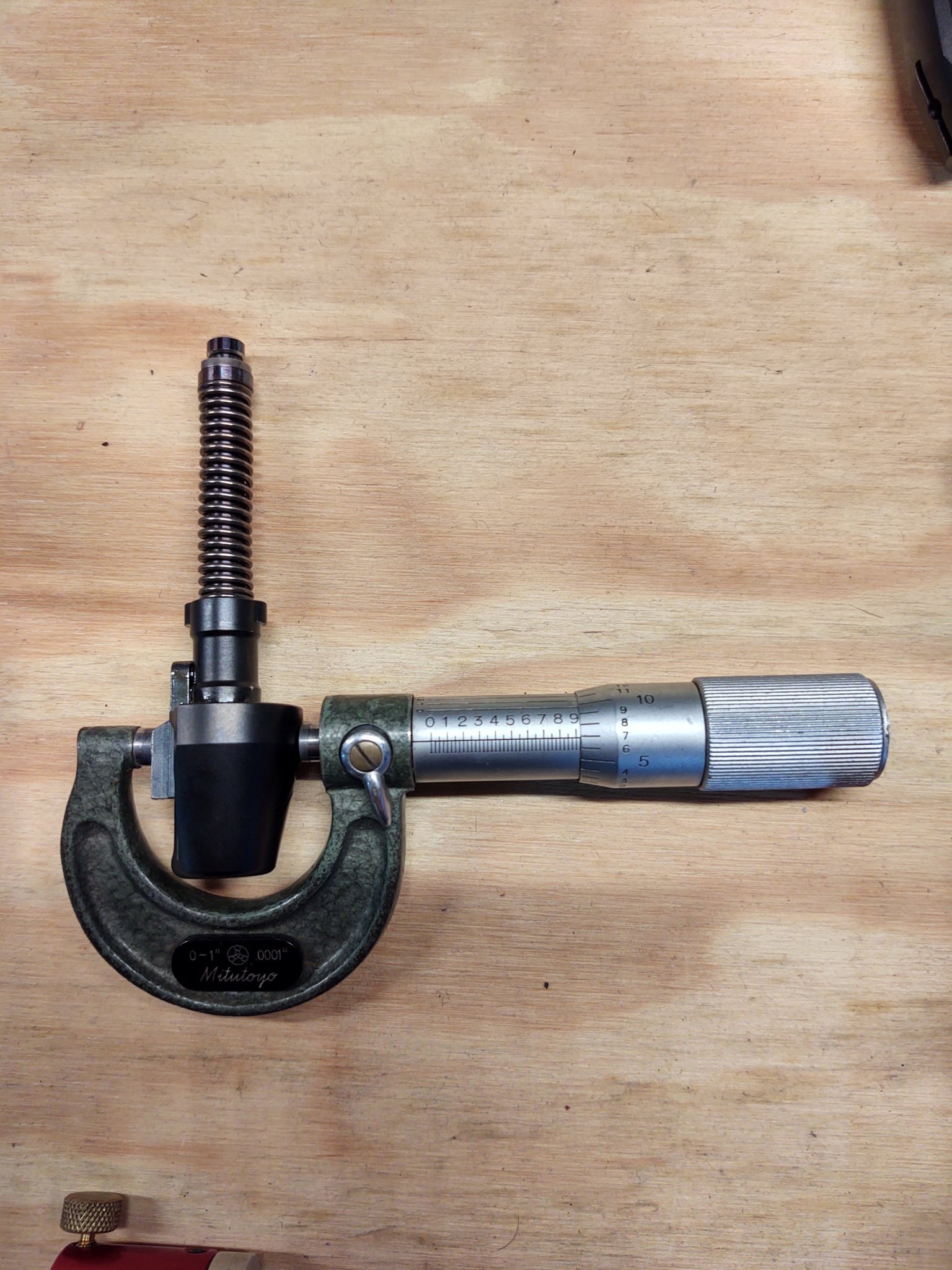

I started down the road of fitting the trigger to the action today. First I measured the current cocking piece height to the top of the shroud directly adjacent from the cocking piece (using the fixed anvil of my mic and the round portion of the cocking piece as a reference, to be repeatable).
First measurement before starting:

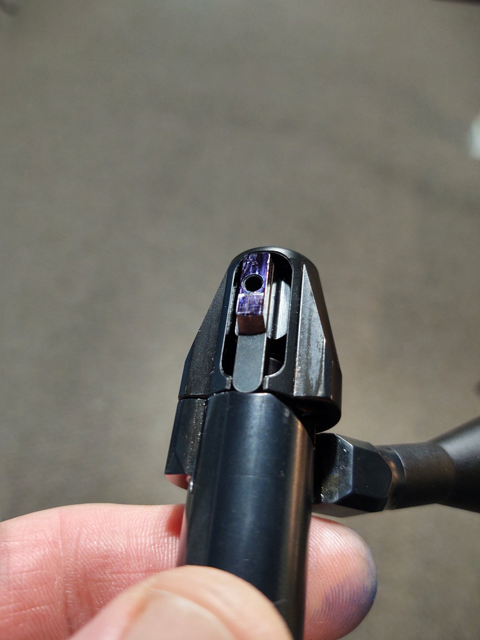

Witness marks of dragging on the sear:
Witness marks on the cocking piece:

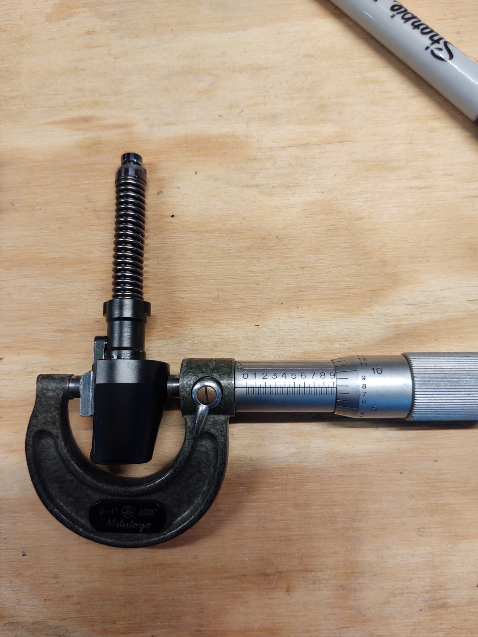

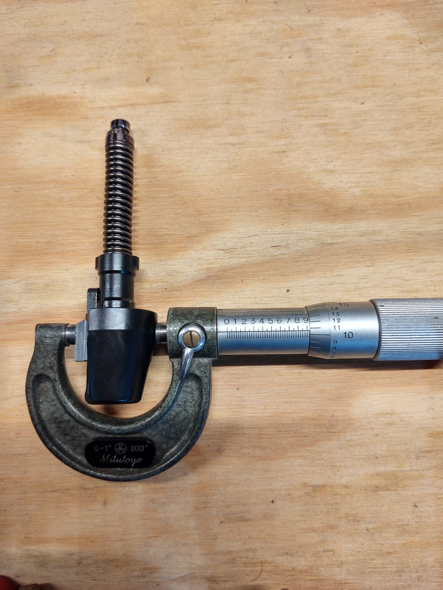

First round of fitting, honing the cocking piece on a flat diamond stone:

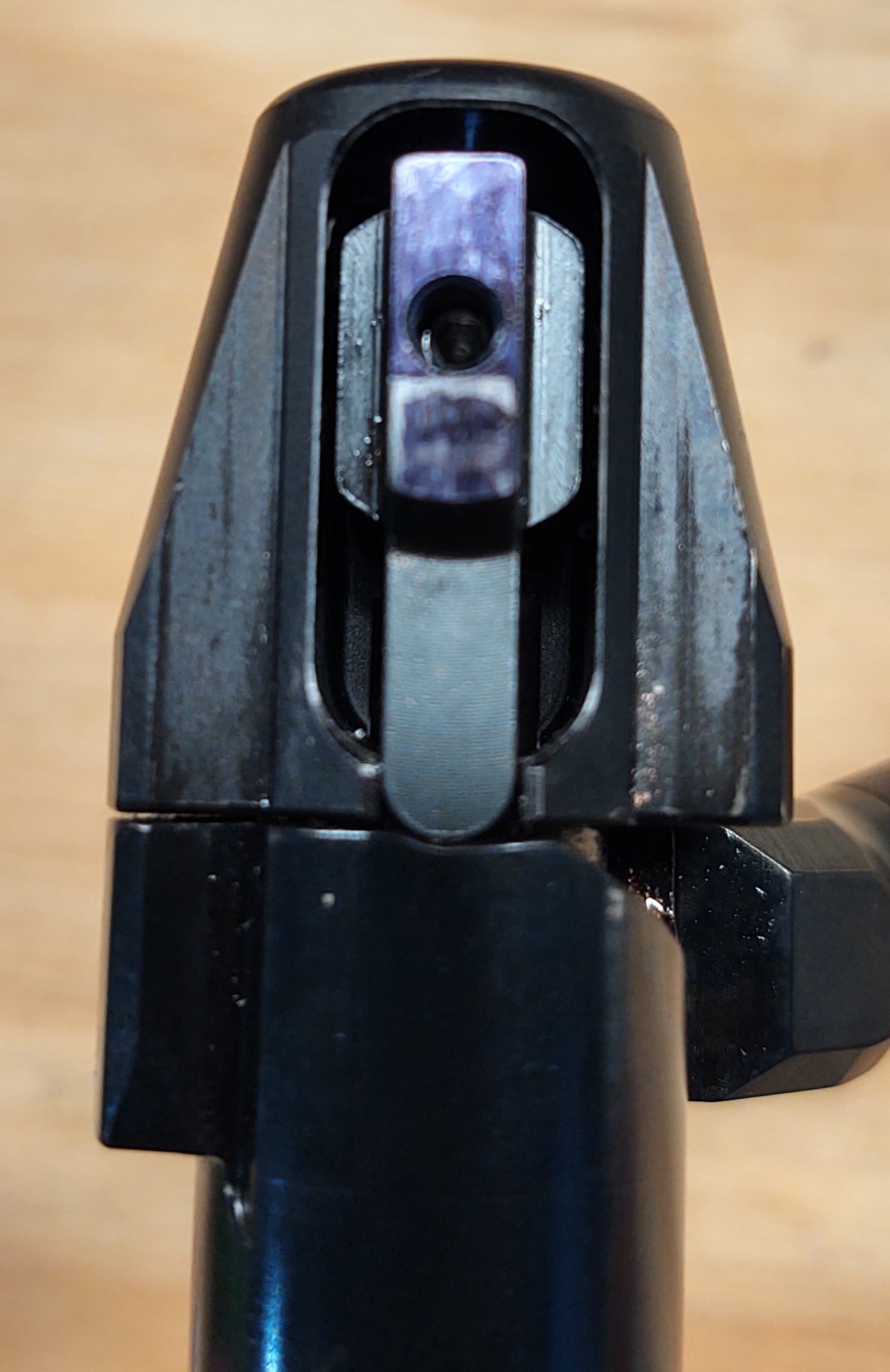

Testing the fit using a sharpie and a few dry firing, still dragging:
Remove a bit more:
Still too much contact:
Removing a little more:
Looking pretty good:

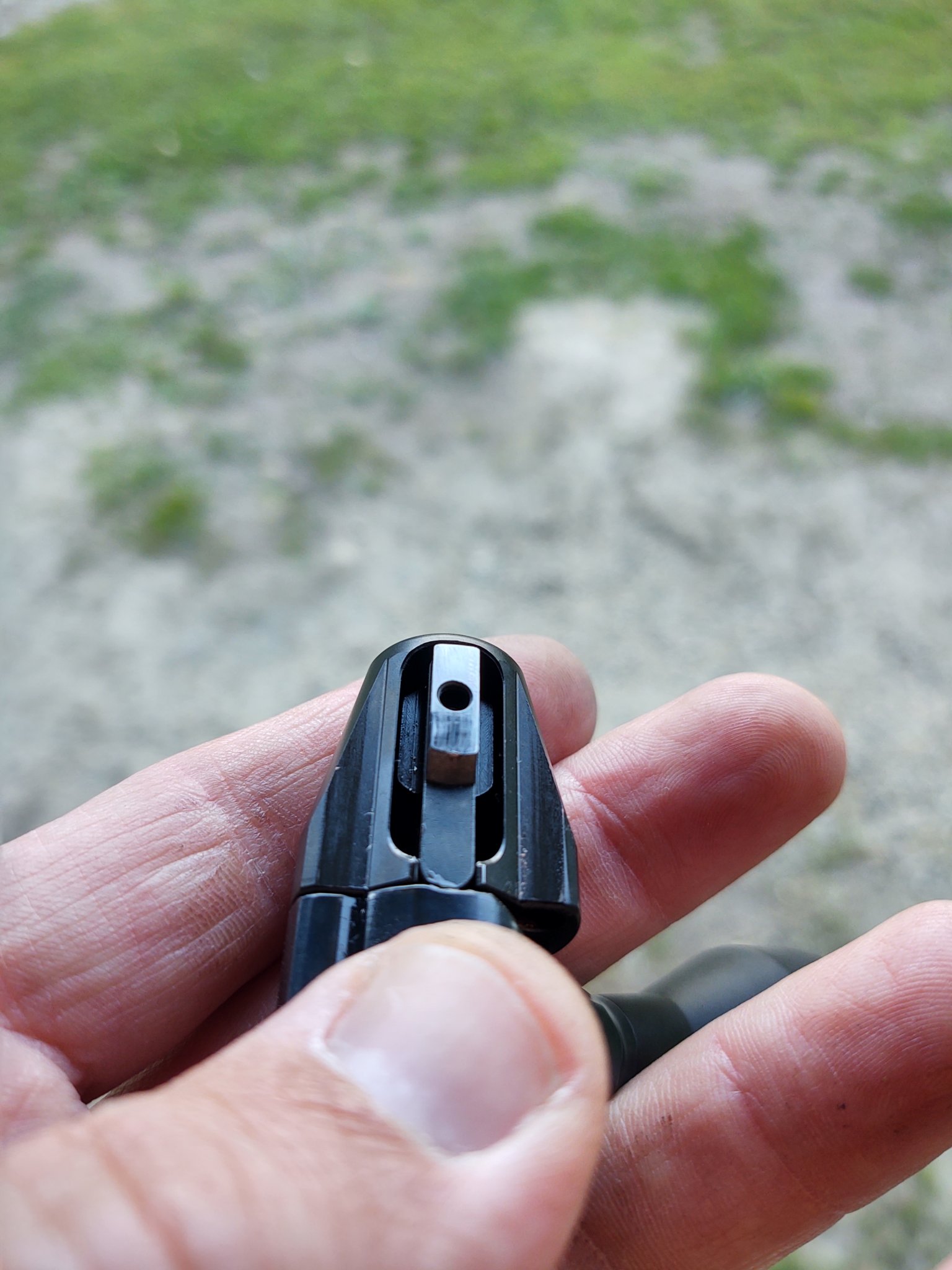

We went to the range and put 160 rounds through it with no FTF! There bolt lift and close was much easier, not as easy as the Vudoo but much better! The accuracy seems pretty good but after 160 rounds I think there is a little room for improvement, still slightly dragging (it was polished to a mirror finish on my ceramic stone, you can clearly see the witness marks):
I’m having FTF issues on WSM. Do I hone the entire colored area on the slide?
