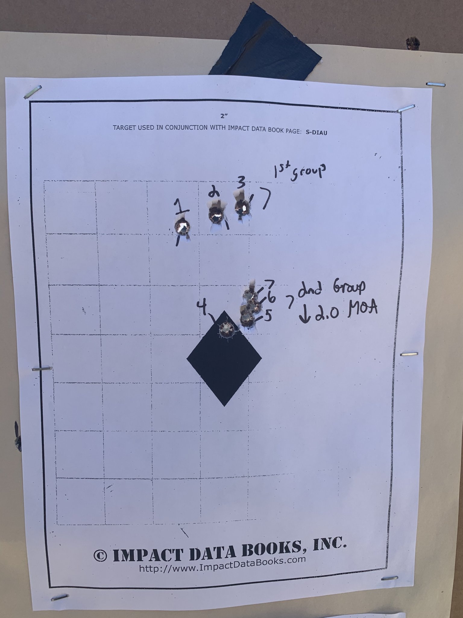

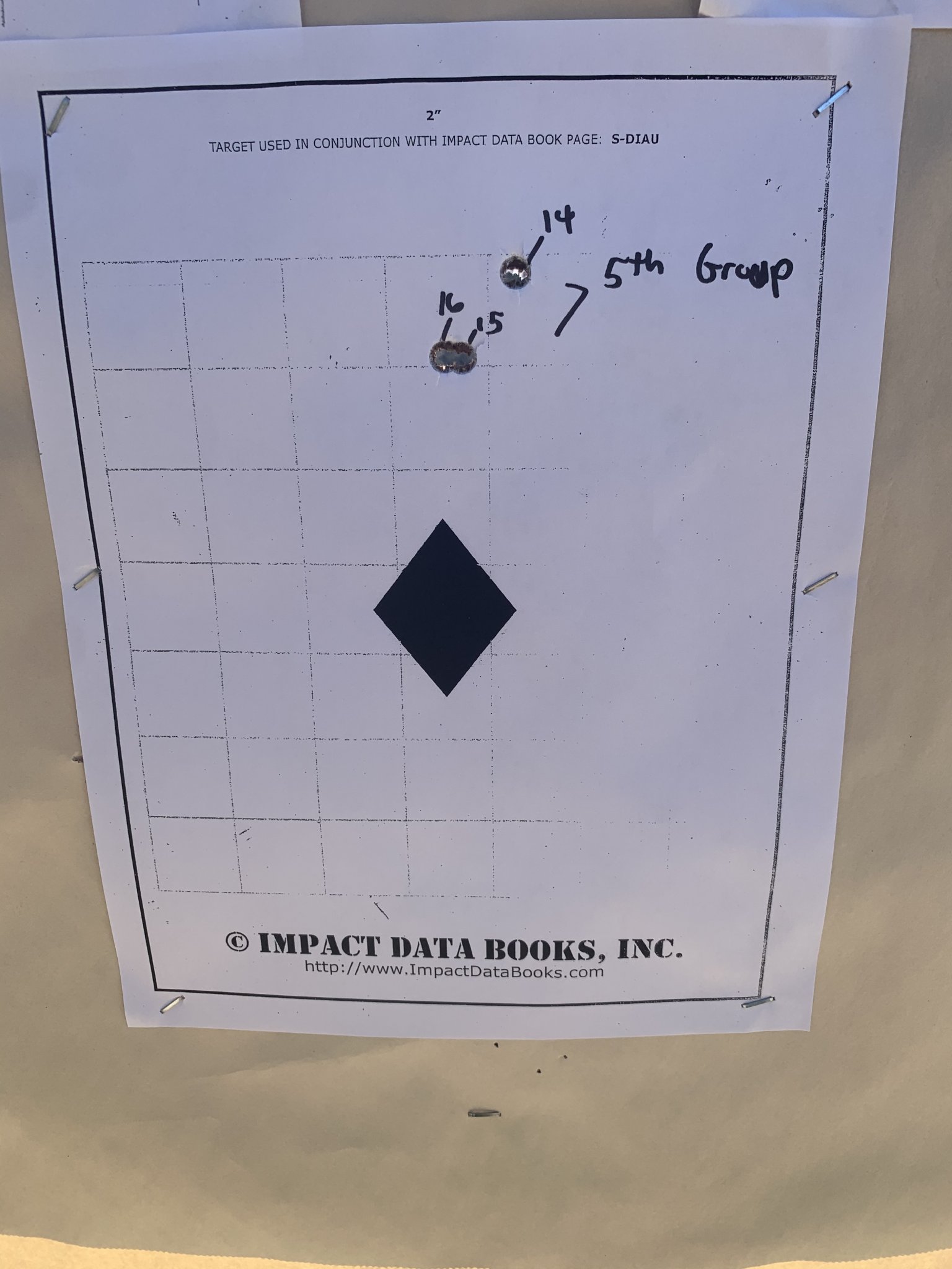

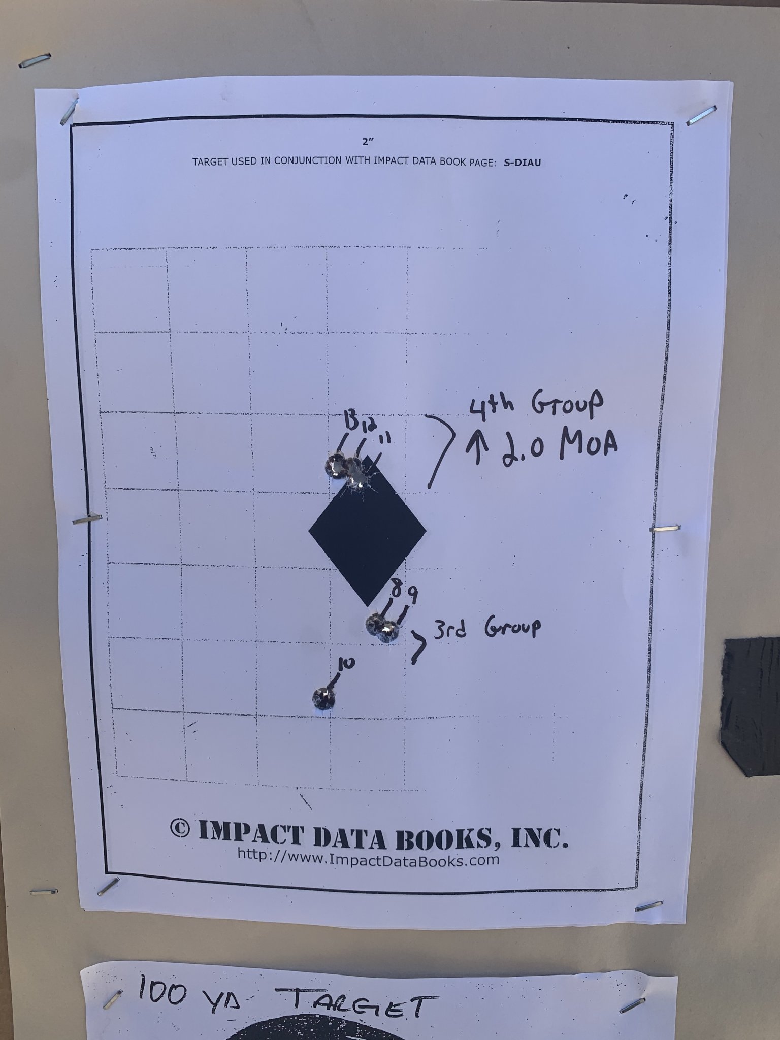

My zero keeps shifting with an occasional flyer. I’ll post pics. My point of aim was the top of the triangle. My first group was about 2 inches high and after making my correction (2.0 MOA) my second group was 1/4 inch right but otherwise pretty on. I waited about 10 mins and shot my third group which had 2 rounds that were 2 inches low with a flyer. I made my correction (2.0 MOA) and shot a forth group which was pretty dead on. My fifth again was about 2 inches high with a flyer again. I haven’t gotten a chance to torque down my scope but does anyone else think this could be any other problem then my scope? I’m pretty new to precision rifle shooting so I’ve never had this happen to me before.

you breaking position between shots/groups? square behind the rifle? rear bag/rest doing funny things? sight picture clear or are you seeing shadows? shit scope? what's your equipment? more info needed. triangle is actually a diamond.
