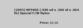

Found this size Nylon Flat washer on Non-Ferous Fasteners Inc. - You would need to bore your I.D and do some filing to get the thickness right.
Reactions: spife7980
