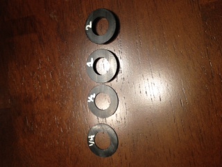

The parts. The shims are in thicknesses of 3 revolutions, 2, 1, 1/2 and two of 1/4 revolution. The three rev shim may not be necessary.

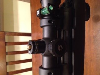

Cap off, shims in place.
Cap going back on over the shims.

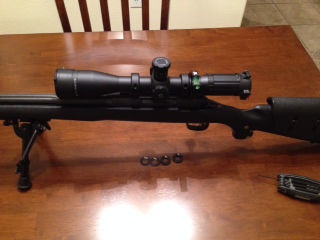

Just received a test set of Zero Stops for my SWFA 3-15x42 from Skullybones and TimK. I followed the instruction video at the beginning of this thread, and everything went together super easy and took no time at all. Works like a charm, wish I could say more, but it just works. Good product and it will definitely make it an easier faster scope to use!!!
